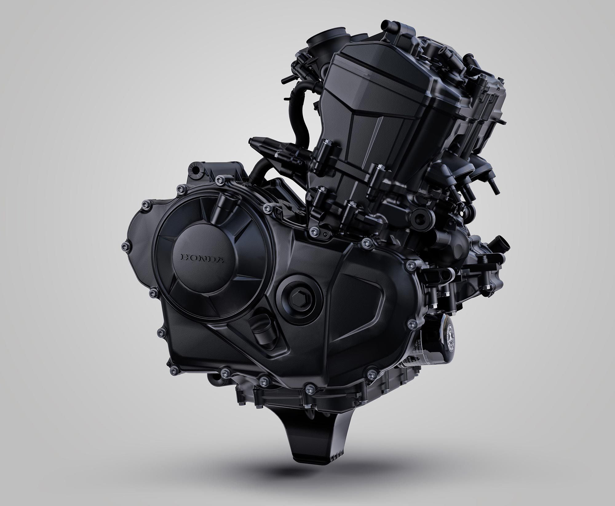

The new parallel-twin powering the Hornet is said to produce more than 90 horsepower.
The new parallel-twin powering the Hornet is said to produce more than 90 horsepower. (Honda/)
Earlier in September, Honda confirmed that the Hornet will be powered by a 755cc twin making 90.5 horsepower at 9,500 rpm and 55.3 lb.-ft. of torque at 7,250 rpm. Those numbers make it stand out in contrast to the company’s existing 745cc twin, used in the NC750 range, which manages only 57 hp and 50.9 lb.-ft. thanks to a design aimed at economy rather than performance.
The new Hornet’s engine is much higher revving, providing that substantial increase in power, and promises to be an extremely lightweight and compact design. The engine concept borrows from the Africa Twin and the CRF450R, with a Unicam SOHC cylinder head design, and as a result manages the sort of output that would normally require a bulkier, heavier DOHC layout. A 270-degree firing interval, increasingly becoming the norm for parallel twins, gives it a V-twin-style throb and power delivery. In the European market, a second version of the bike, with just 46 hp, will also be offered to bring it within the A2 tiered-license category that new riders are initially restricted to before graduating to a full-power machine. The full-power bike tops out at 127 mph, while the restricted version can only manage 106 mph.
