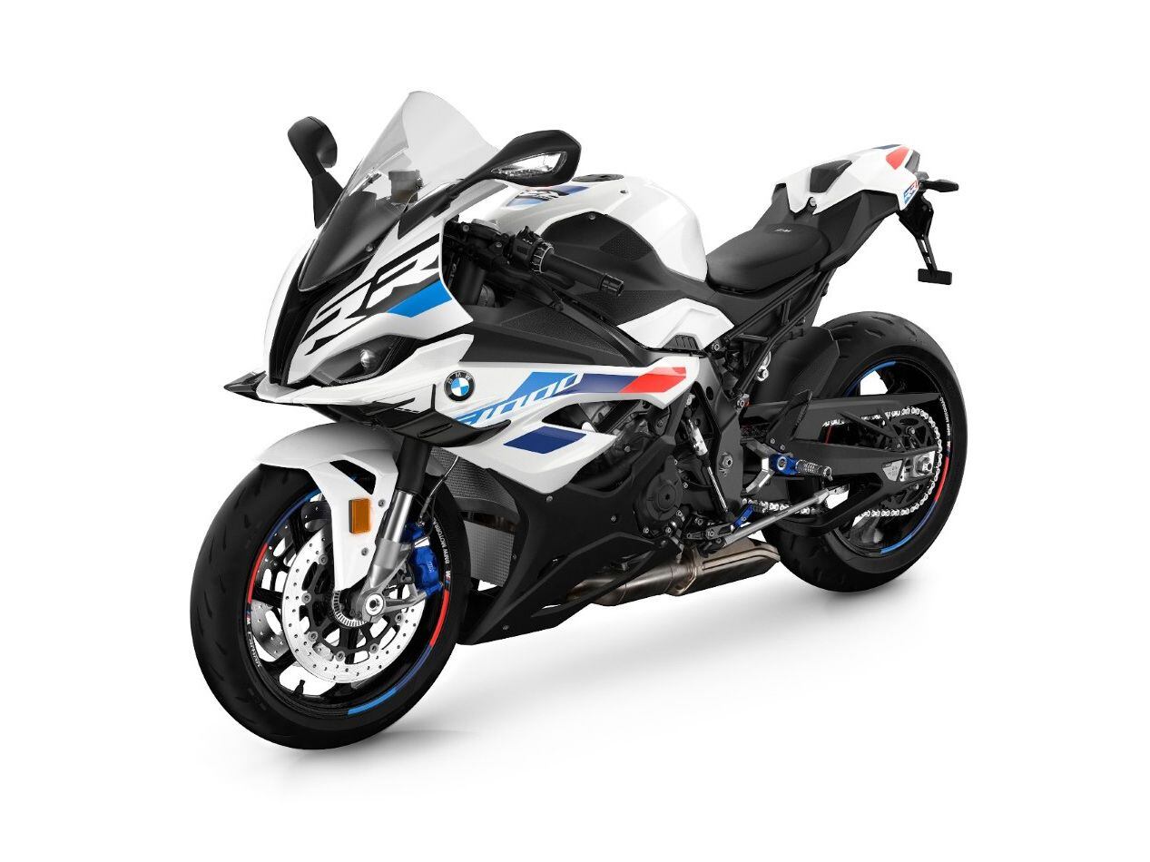

BMW’s 2023 S 1000 RR is more track focused, with modifications to the chassis, engine, and aerodynamics.
BMW’s 2023 S 1000 RR is more track focused, with modifications to the chassis, engine, and aerodynamics. (BMW/)
It was only a few weeks ago that the first hard evidence of a new 2023 BMW S 1000 RR emerged. Now the bike has been officially announced, largely matching our expectations but also showing a few US-specific differences to versions seen elsewhere in the world.

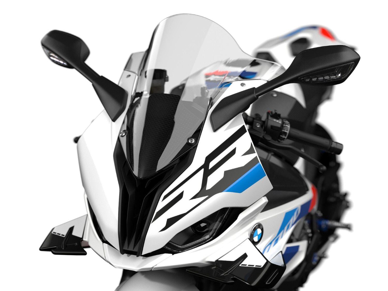

M 1000 RR–inspired winglets make their way down to the S 1000 RR.
M 1000 RR–inspired winglets make their way down to the S 1000 RR. (BMW/)
It’s perhaps easiest to start with the most visible update: a set of M 1000 RR–inspired winglets on the nose, applying up to 22 pounds of front-end downforce at high speed. They’re not quite as large as the versions used on the homologation special M 1000 RR, which can manage as much as 36 pounds, but they mean the standard S 1000 RR has now caught up with its winged rivals from Japan and Italy. Further back, and less immediately obvious, is a restyled tailsection with less bodywork than before, helping to give the impression that the bike’s mass is hunched around its front wheel.

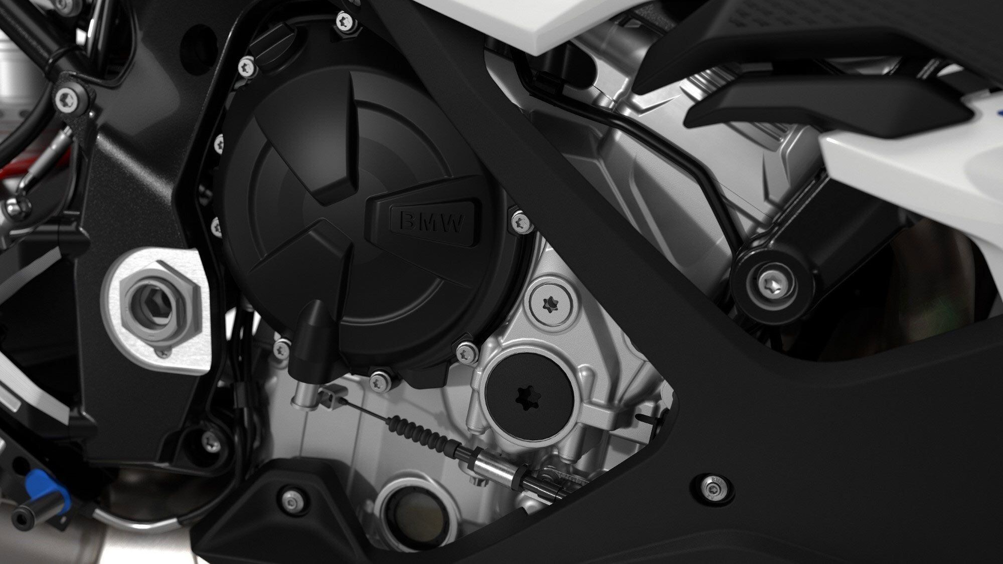

That effort is aided by a revised version of BMW’s 999cc ShiftCam four-cylinder engine. The US model has no change in its peak power or torque, making a claimed 205 hp at 13,000 rpm and 83 lb.-ft. at 11,000 rpm, while the European model gains a couple of horses and a higher peak of 13,750 rpm. Even with unaltered power, the US version has the same mechanical changes as the European bike, with new intake ports based on those from the M 1000 RR, a new airbox, and shortened variable-height intake funnels, again borrowed from the M-bike.

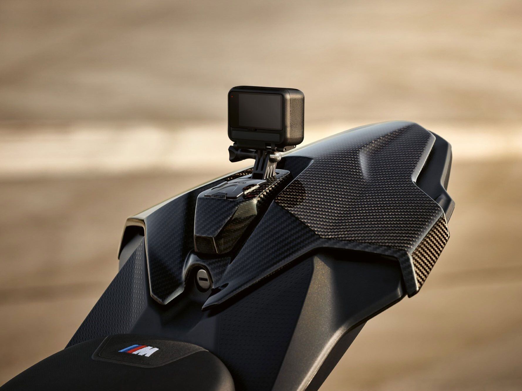

Other tweaks to the 2023 S 1000 RR include a lightweight battery, a USB port in the rear section, an optional GoPro holder, and a redesigned wiring harness to make removing the license plate bracket easier. The Shift Assistant Pro quickshifter has also been updated for improved gear changes, and there’s a simple process to swap the conventional one-down-five-up shift pattern for a reversed version as preferred by racers and track rats.

Rider’s view out of the S 1000 RR cockpit. (BMW/)An optional GoPro mount is available.
An optional GoPro mount is available. (BMW/)
