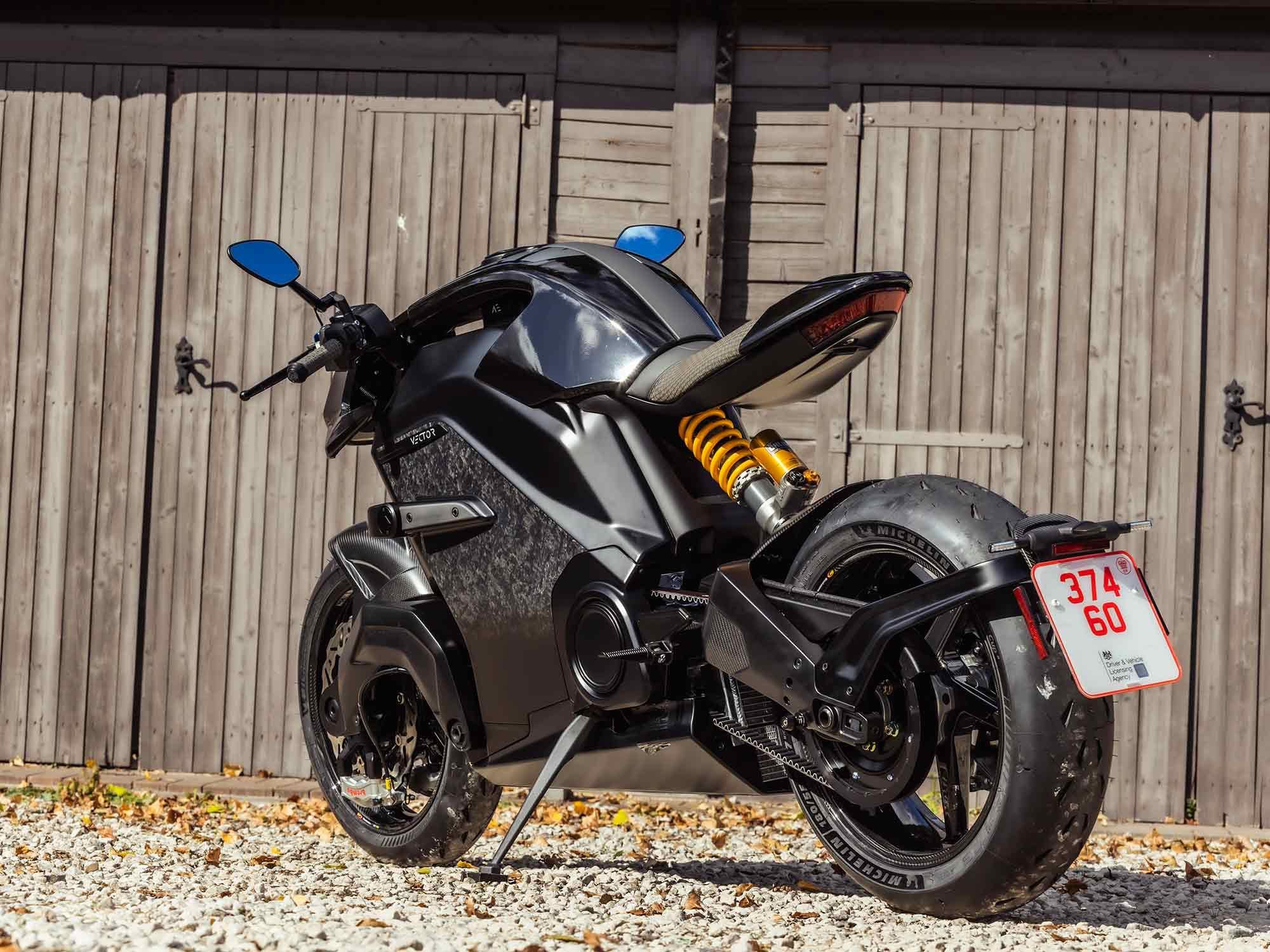

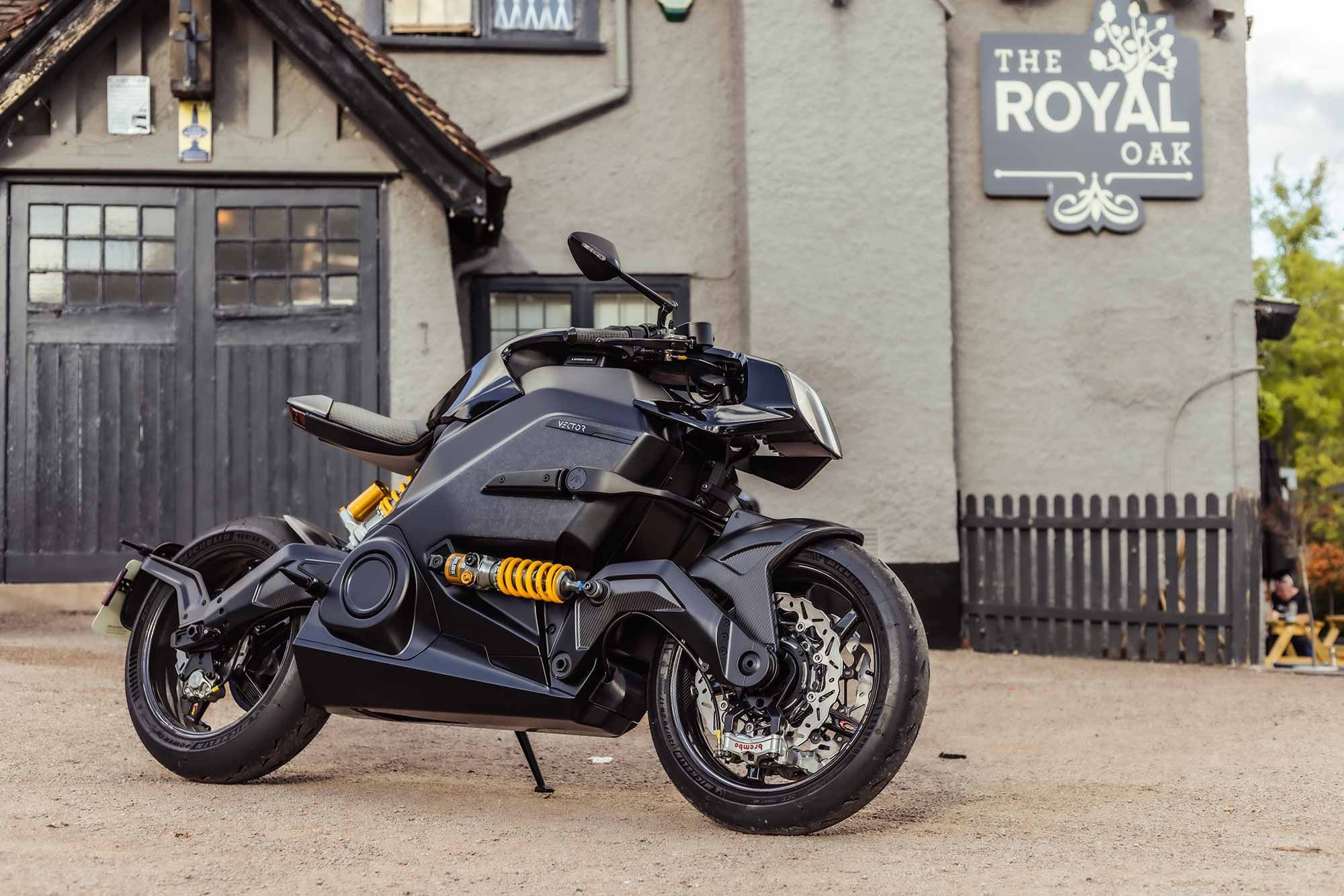

For 90,000 pounds sterling, you get loads of carbon fiber, two swingarms, high-end suspension and brakes, and plenty of performance.
For 90,000 pounds sterling, you get loads of carbon fiber, two swingarms, high-end suspension and brakes, and plenty of performance. (Arc/)

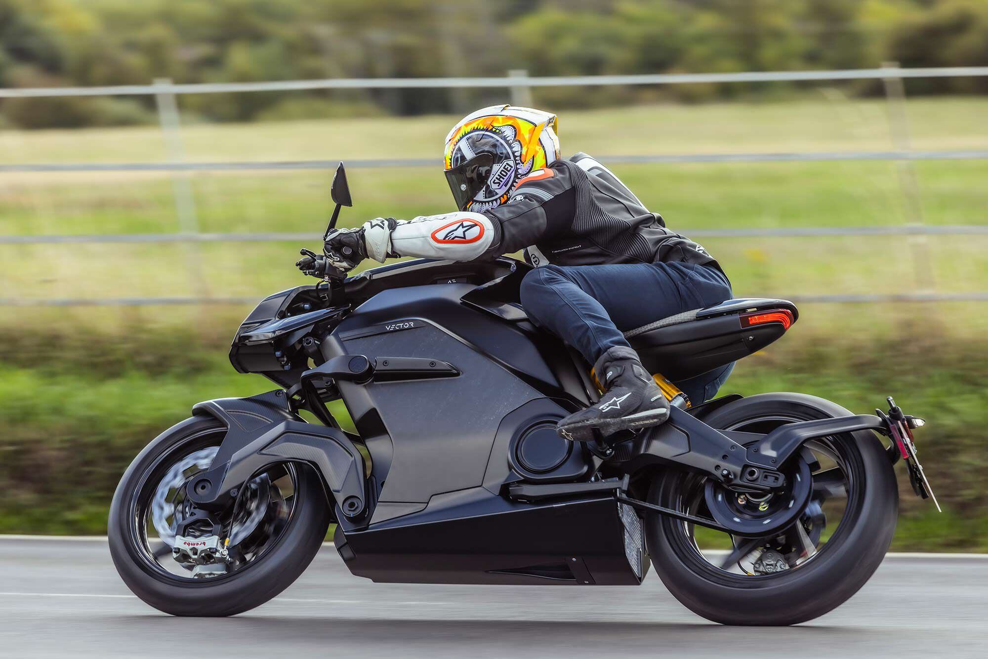

Arc claims the Vector has 117 hp, 128 lb.-ft. of torque, and a range of 271 miles.
Arc claims the Vector has 117 hp, 128 lb.-ft. of torque, and a range of 271 miles. (Arc/)

The Arc seriously challenges convention at every turn. There is no frame as we know it; instead, the chassis is a carbon monocoque housing for the 16.8kWh battery cells and motor. One of the benefits of its hub-center steering compared to telescopic forks is that it separates braking, suspension, and steering forces, which allowed Arc to run a relatively light spring in the front Öhlins TTX shock along with a dramatically steep head angle of 20 degrees (compared to a normal sportbike’s 24 to 25 degrees) without compromising stability. The pivot point of the front shock is located below the front wheel spindle, which, unlike most other hub-steered bikes, allows the front to dive slightly like a conventional telescopic fork, creating a familiar sensation of weight transfer when braking.
Related: The Arc Vector, Undressed

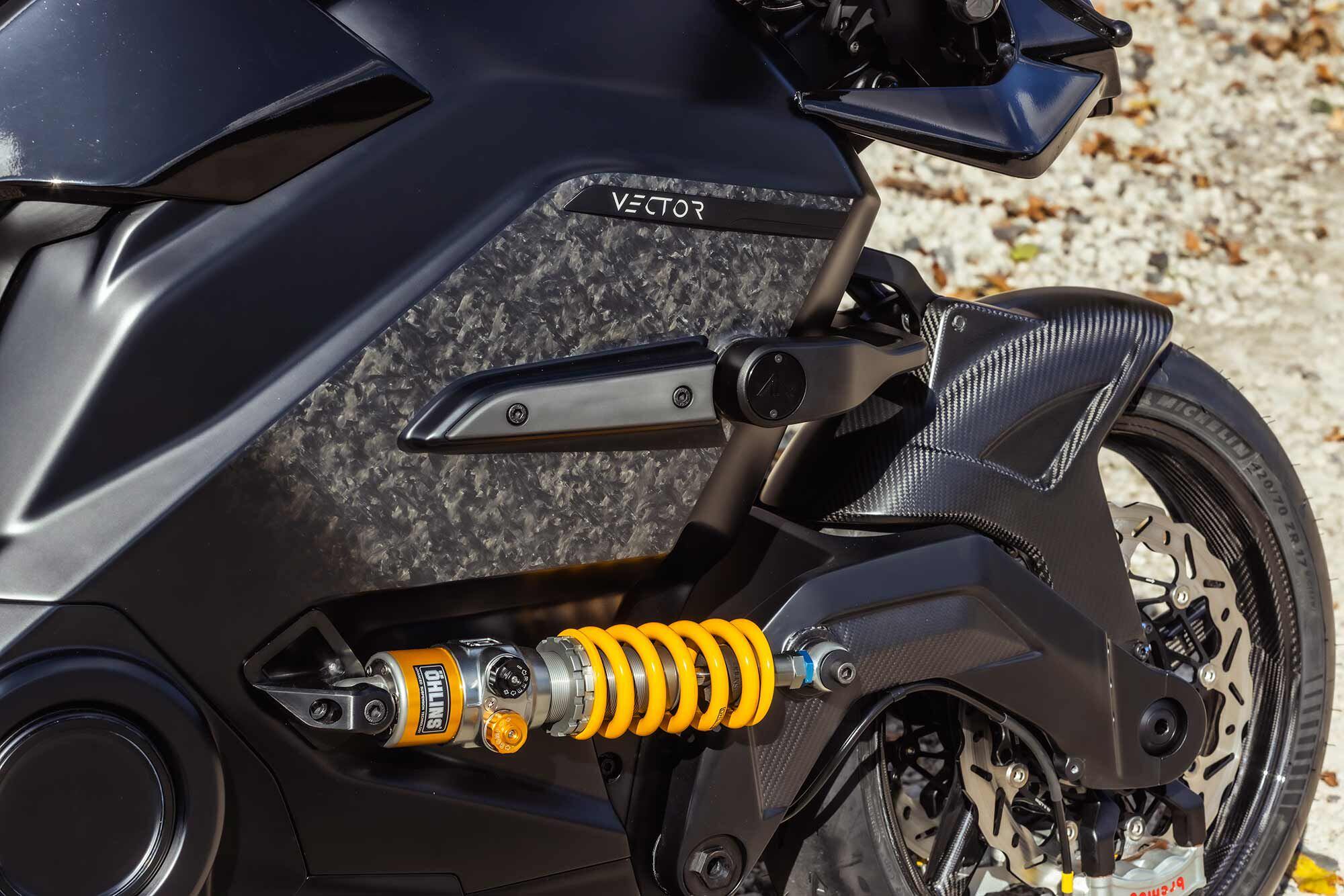

Locating the front shock pivot point below the front suspension spindle gives the Vector a more familiar and traditional steering feel.
Locating the front shock pivot point below the front suspension spindle gives the Vector a more familiar and traditional steering feel. (Arc/)
Both front and rear arms are carbon fiber, bolting directly to the carbon monocoque, as are the beautiful BST wheels. In a rare instance of conformity there are Brembo Stylema brakes up front, plus a full carbon seat unit, keyless ignition (via a wrist strap key), and belt drive. A digital dash on top of the dummy fuel tank houses the charging ports.

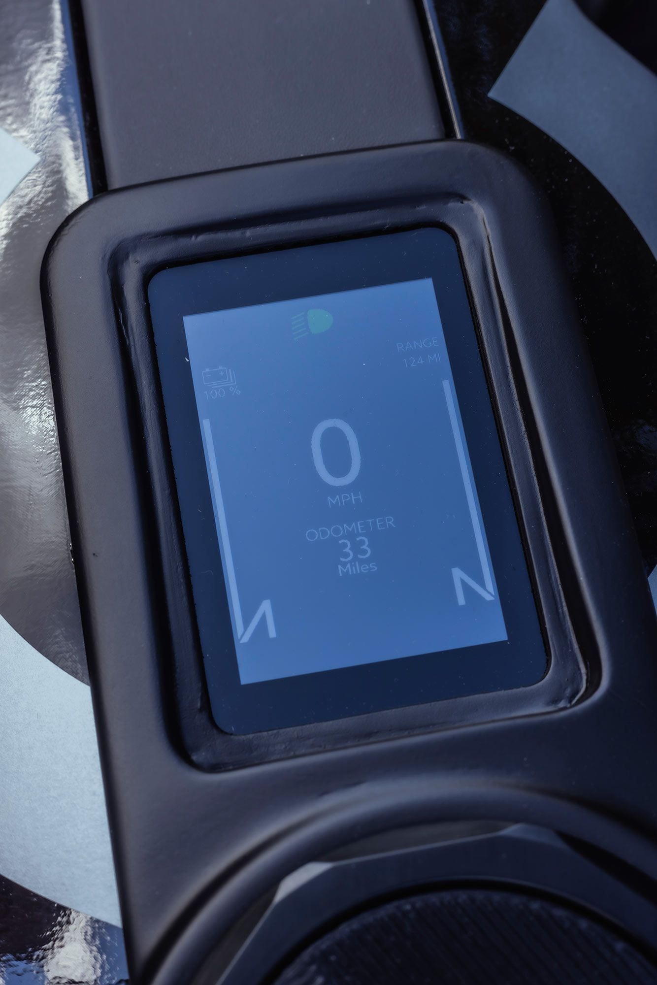

A digital dash reports the battery charge, range, speed, and riding modes. It is difficult to read in direct sunlight.
A digital dash reports the battery charge, range, speed, and riding modes. It is difficult to read in direct sunlight. (Arc/)

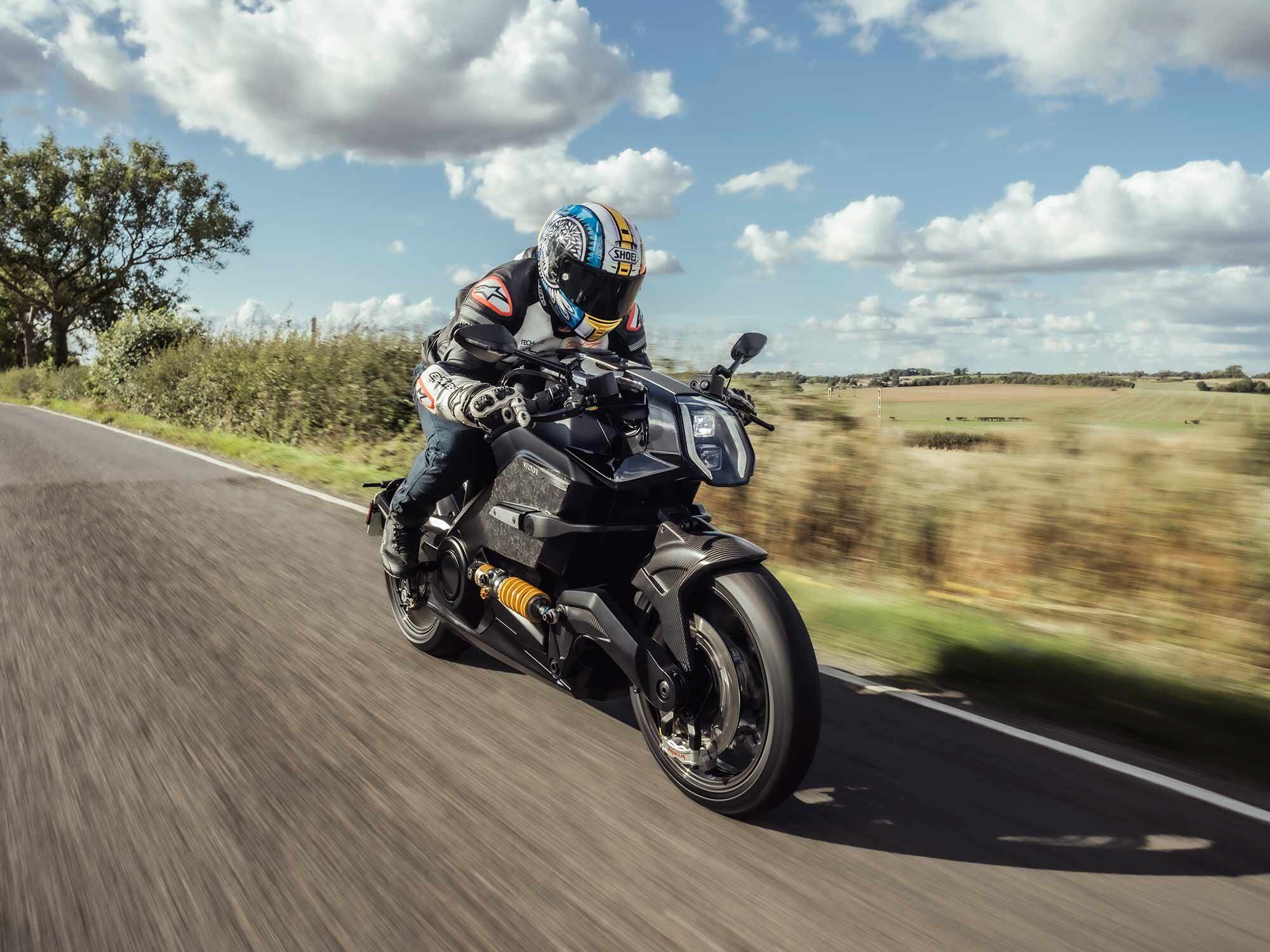

Once underway, there are no gears, of course, and no significant engine noise—and the instant response of the torque-rich motor can easily take first-time electric riders by surprise.
In fact, engine response off small throttle openings is a little abrupt compared to a typical petrol-powered superbike, even in the Vector’s low-torque Urban mode. But once accustomed it’s an incredibly easy bike to ride.
From a standing start or accelerating from 50 mph, it’s simply a case of twist and go. Overtaking is effortless, with no gears to worry about and no revs to manage. Just direct torque on demand.

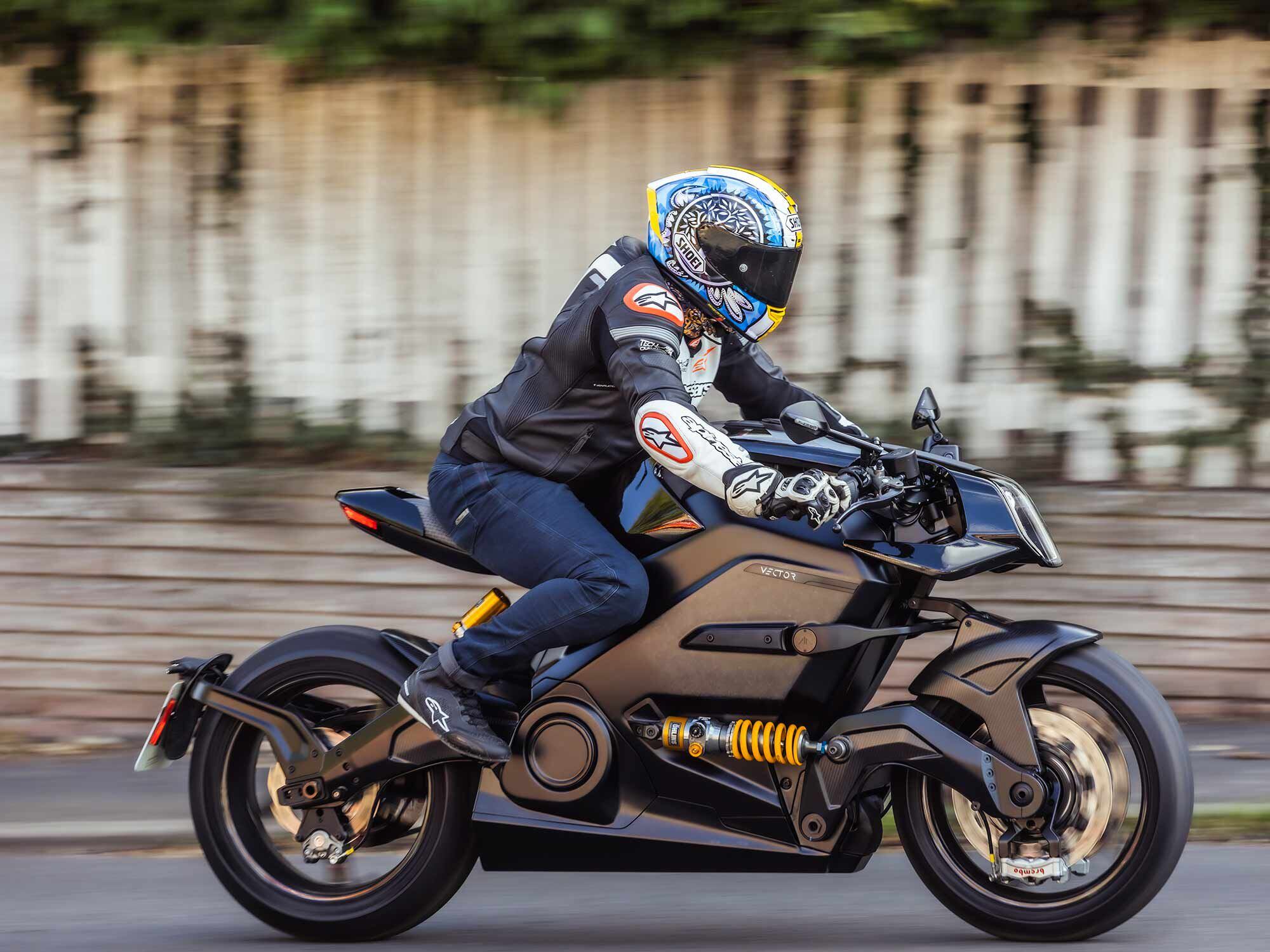

On the road it feels as quick and full of energy as, say, a BMW S 1000 RR. It is a mighty performer. To help it run into turns and carry lots of corner speed, Arc has deliberately dialed in minimal engine-braking. This means there’s relatively little regen in the powertrain, which in turn gives the Vector something of a two-stroke feel, helping the rider flow into corners.

The Vector weighs in at 529 pounds (240 kilograms), about par for an electric bike with sporting intent but about 40 or more kilos overweight for a 2020 superbike. Arc’s development team knew that a hub-center steering system would manage those extra kilos better than traditional tele forks, and allow a steep and sporty steering head angle to boot. The team was also unconstrained by the need to design around the usual fixtures and fittings, like a radiator, water pipes, and exhaust, as well as having no significant engine heat to worry about.
The Vector does feel heavy when pushing it around—there’s no crawler or reverse gear—but once a leg is thrown over the 825mm (32.9 inches) carbon seat for the first time and those carbon BST wheels are turning, that weight simply falls away.

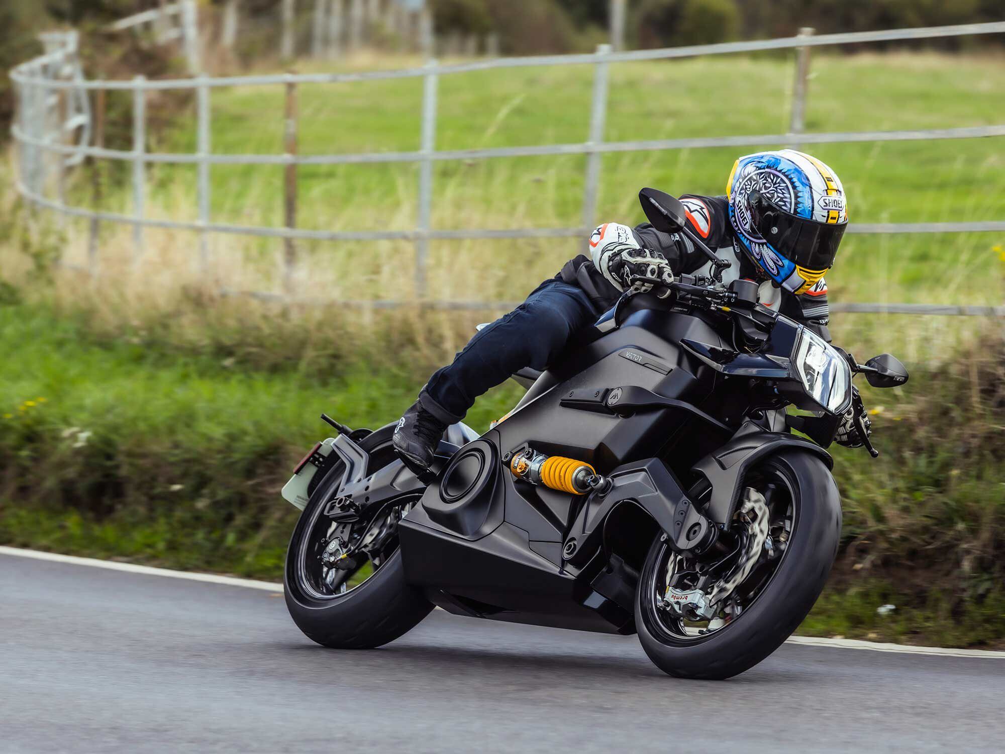

That steep 20-degree rake angle makes the Arc feel like a much lighter machine. It turns so quickly that it took a few miles to recalibrate as I was constantly steering too soon and hitting the apex too early, before picking up the bike and having a second stab at it.

Within a few miles on twisty roads I found myself using less input at the bars and pegs to make it turn. I’d say that the Vector steers faster than any other electric superbike I’ve ridden, including the Energica I raced at Isle of Man TT. But it remains planted and super stable as the pace gets serious.
With suspension and braking forces separated and a relatively light spring controlling the ride, you can feel the supple front end tracing road imperfections. There’s no sense of detachment, which can happen with some funny front ends. The rear suspension uses a directly mounted TTX Öhlins unit, which is on the firm side and only comes into its own when the road opens and the traffic clears.
Like a racebike on the road, the Vector doesn’t want to be ridden slowly. It needs a bit of speed to bring its suspension into its ideal operating window, and ideally a bit of space too. Its natural habitat is flowing ribbons of asphalt where it can settle into corners, front tire tracking to the millimeter, rear driving the immense wave of direct torque into the road as the bike surges, like no other bike can surge, from one set of bends to the next.
Stopping duties fall to two Brembo Stylema Monoblock calipers gripping 320mm discs. The rear is also a Brembo item, a 240mm disc operated from the handlebar and leaving the bespoke footpegs looking slick and lever-free. Our testbike didn’t have ABS fitted but customer bikes will have (non-lean-sensitive) ABS.
As with many HCS machines, braking is immense but takes a little getting used to, especially with so little engine-braking. Unlike some HCS systems, you can feel the front tire loading as weight transfers forward onto the front tire’s contact patch, and you feel the stopping power build. Meanwhile the rear brake lever on the handlebar performs like a scooter’s and is very effective.

Cruise control is standard; so as long as you plan your journey with a DC fast charger along the way, you could cover some decent miles on the Arc. Range and battery usage are displayed on the dash, which is on top of what we’d normally describe as a fuel tank. This also shows speed, riding mode, etc., but it’s hard to read, especially when the sunlight is directly behind you. Mind you, that issue will disappear when the information you need is displayed in the head-up display.
