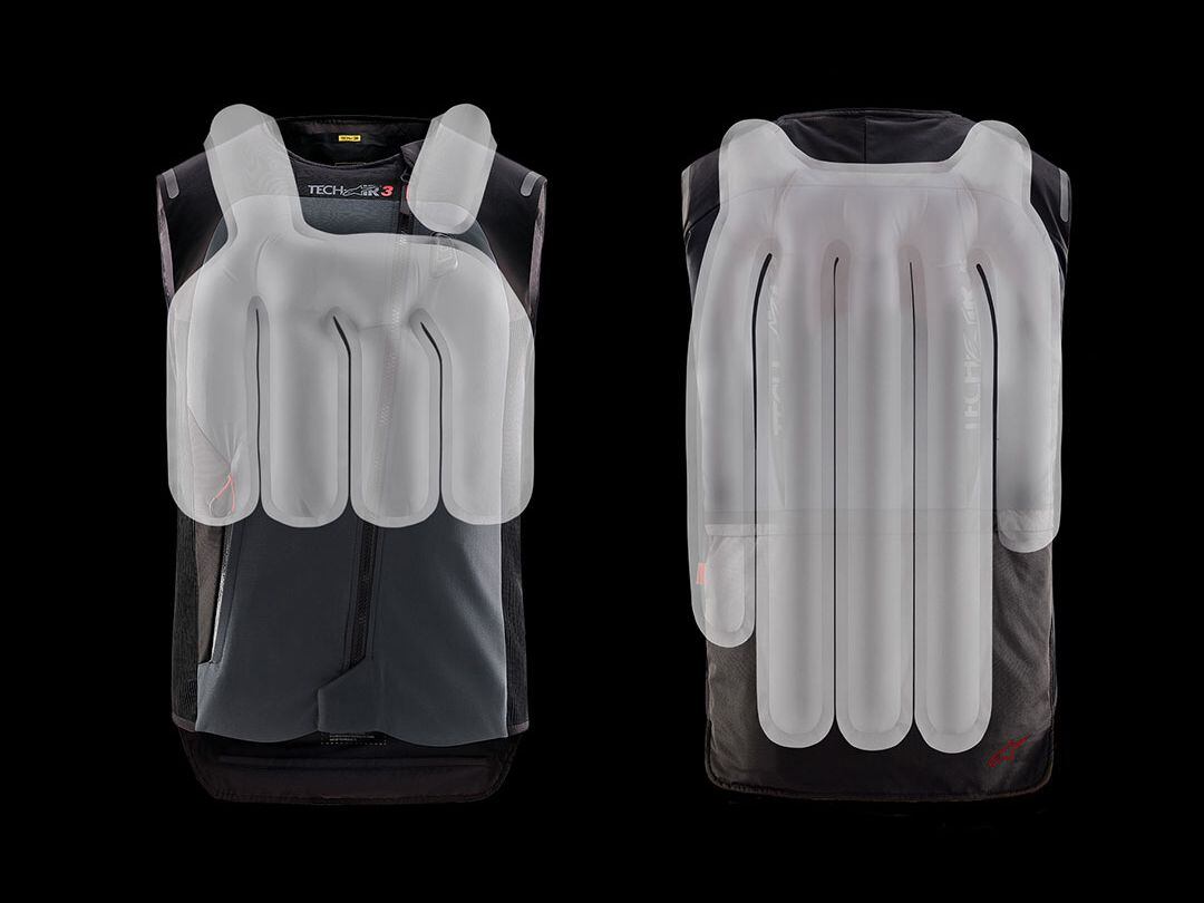

The airbag inside Tech-Air 3 covers a rider’s full chest, full back, and collarbones. Shoulders and elbows remain unprotected, which is why Alpinestars recommends also wearing a padded jacket. A small argon canister at the back left of the vest holds the gas required to inflate the system. A total of six sensors inside the vest, three accelerometers and three gyroscopes, work with a complex road-tuned algorithm to control when the airbag is deployed. When an impending crash is detected, the system inflates in 50 milliseconds and remains fully inflated for five seconds.
Coverage of the airbag inside Alpinestars’ Tech-Air 3 system.
Coverage of the airbag inside Alpinestars’ Tech-Air 3 system. (Courtesy of Alpinestars/)

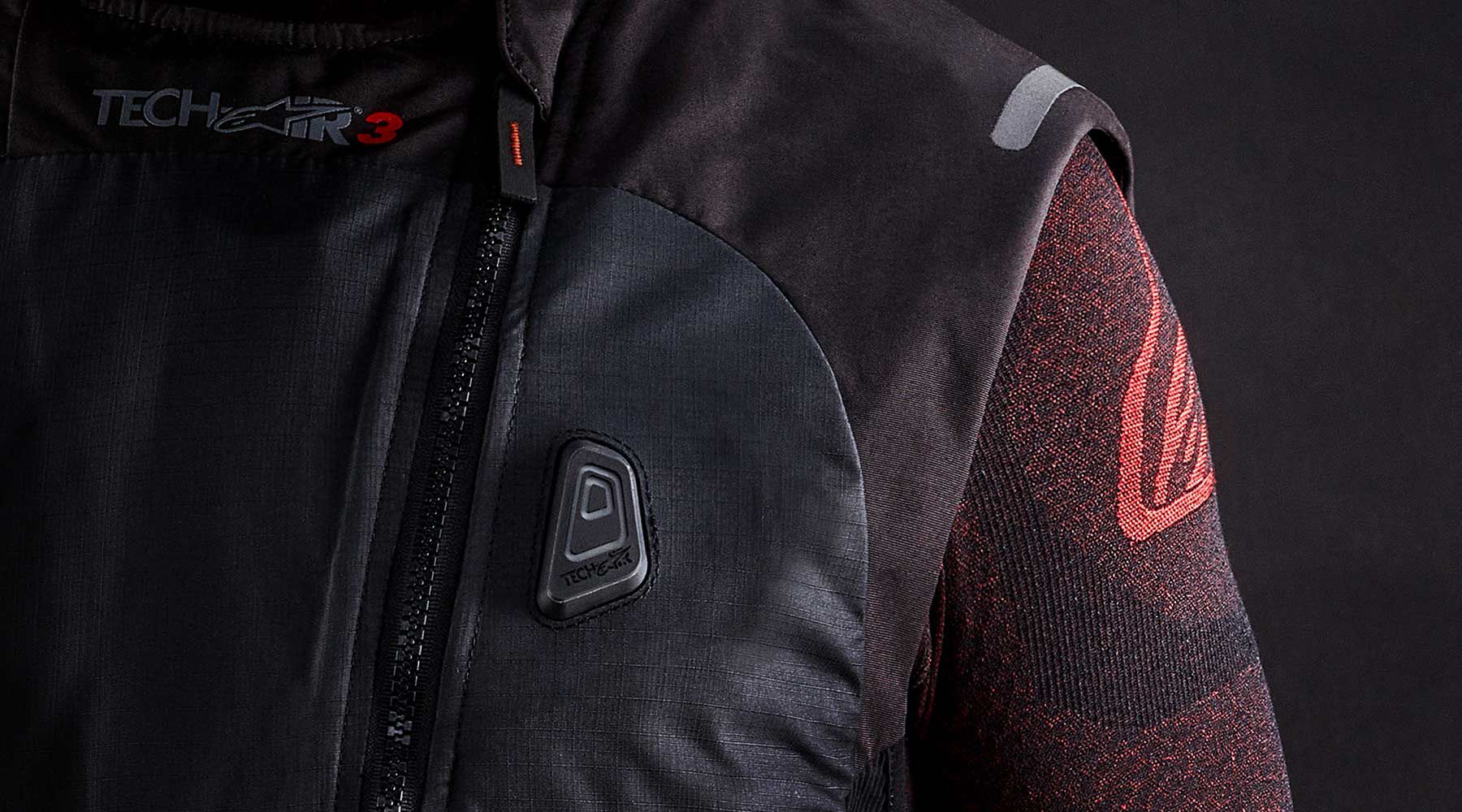

An LED light on the chest of the Tech-Air 3 displays the system’s status and haptic alerts communicate with the rider while the vest is worn.
An LED light on the chest of the Tech-Air 3 displays the system’s status and haptic alerts communicate with the rider while the vest is worn. (Courtesy of Alpinestars/)

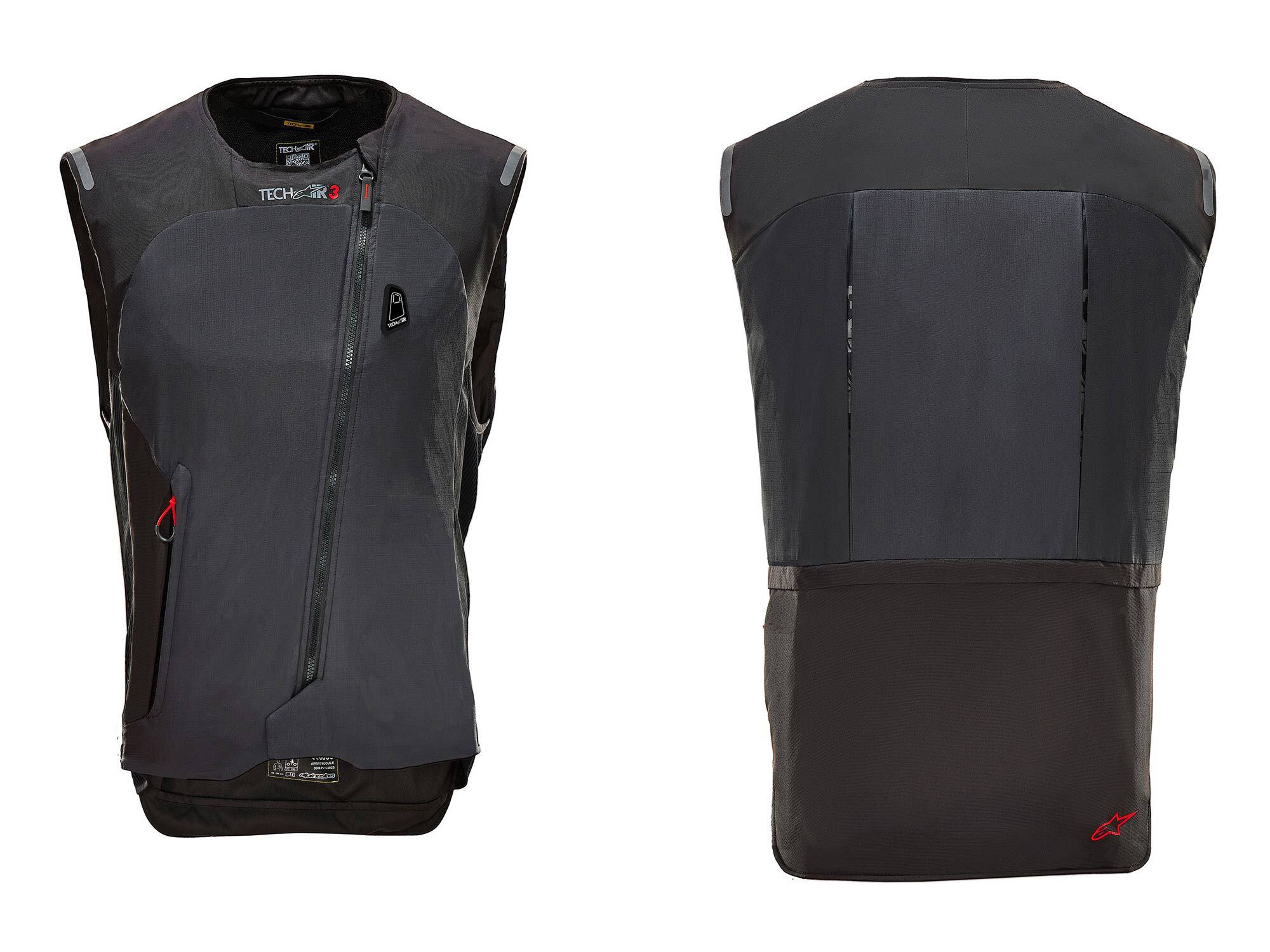

Front and back of Alpinestars Tech-Air 3 autonomous airbag system.
Front and back of Alpinestars Tech-Air 3 autonomous airbag system. (Courtesy of Alpinestars/)
