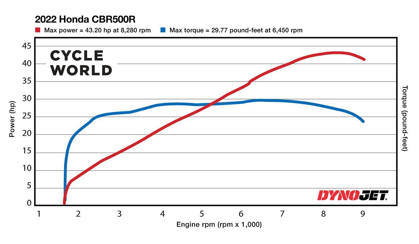

As a “global” model, intended for sale in numerous world markets, Honda’s 471cc parallel-twin-cylinder powerplant was designed to make just enough power to slide under the 47 hp limit, therefore qualifying for Europe’s and Southeast Asia’s mid-level A2 learner licenses. The nearly square bore/stroke figures of 67 x 66.8mm enable the engine to pump out decent torque (29.77 lb.-ft. at 6,450 rpm, with 43.2 hp at 8,280 rpm) while still being revvy enough to generate a very linear power curve: “There’s enough power and a nice, flat torque curve to scoot through city and highway traffic swiftly and easily without constantly rowing through the gearbox,” we said in our CBR500R/CB500F test review.
The six-speed transmission is equipped with a very short first gear, which helps avoid stalling for new riders but also requires a little throttle/shifter coordination to achieve smooth upshifts to second gear. A power-assist/slipper clutch was added in 2019, and allows easy lever effort with surprisingly good feel.
Those interested in overall engine performance can reference Cycle World’s dyno run here.

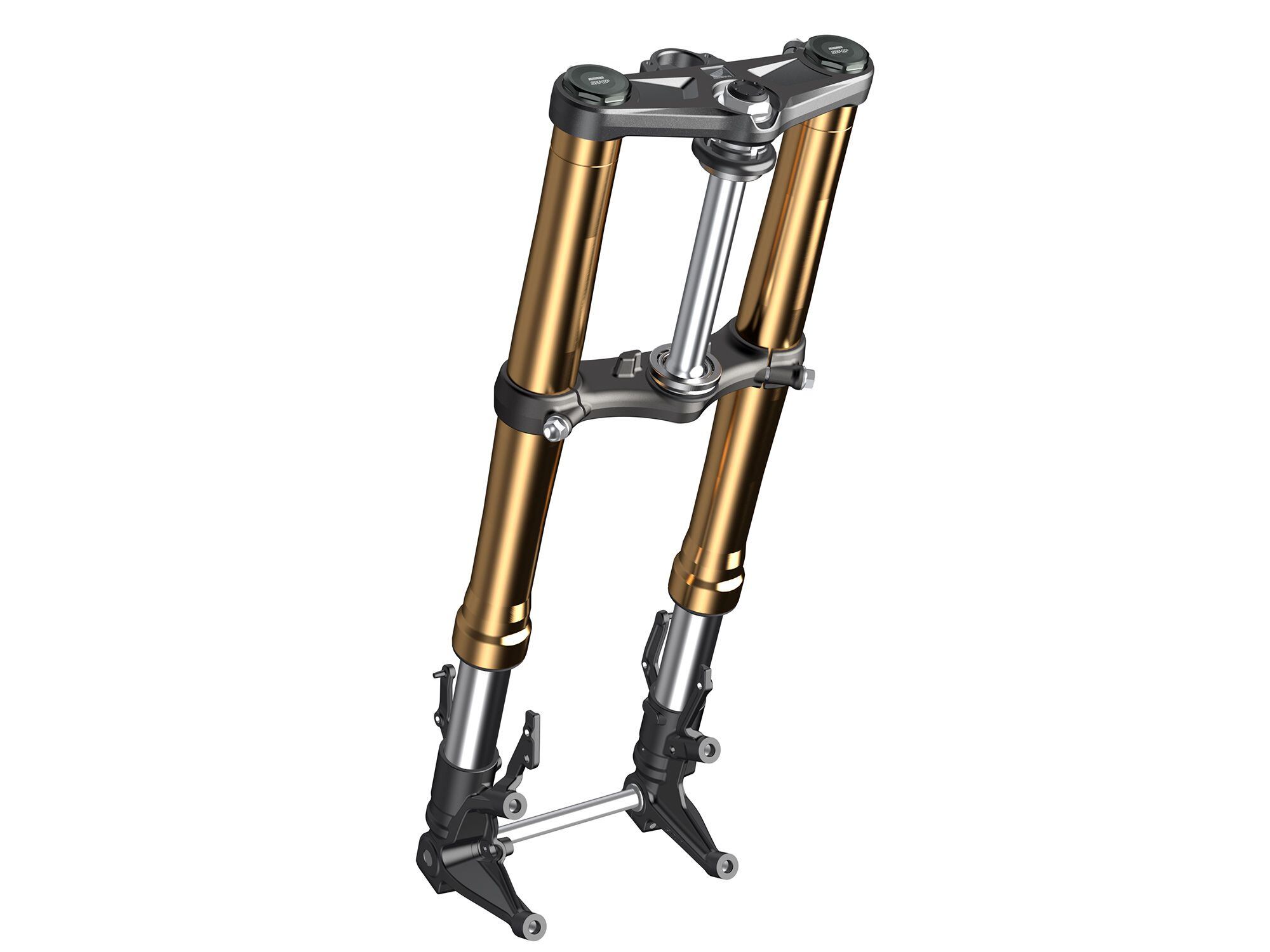

While the CBR500R’s suspension always felt on par for an entry-level machine, Honda upgraded to a Showa 41mm SFF-BP fork for 2022. The result is much improved feel during spirited riding.
While the CBR500R’s suspension always felt on par for an entry-level machine, Honda upgraded to a Showa 41mm SFF-BP fork for 2022. The result is much improved feel during spirited riding. (Honda/)
While the previous CBR certainly wasn’t terrible in the handling department, the budget-conscious build of the suspension could be felt anytime the pace ramped up or the front brake was applied with any authority. Midcorner bumps would upset the chassis; front-end dive while braking was excessive. The new Showa SFF-BP fork and reworked rear shock have eliminated those concerns, working with the excellent Michelin Road 5 tires to transform the CBR into an agile entry-level bike that can carve tight and twisty roads at a pace that would make many sportbikes sweat.

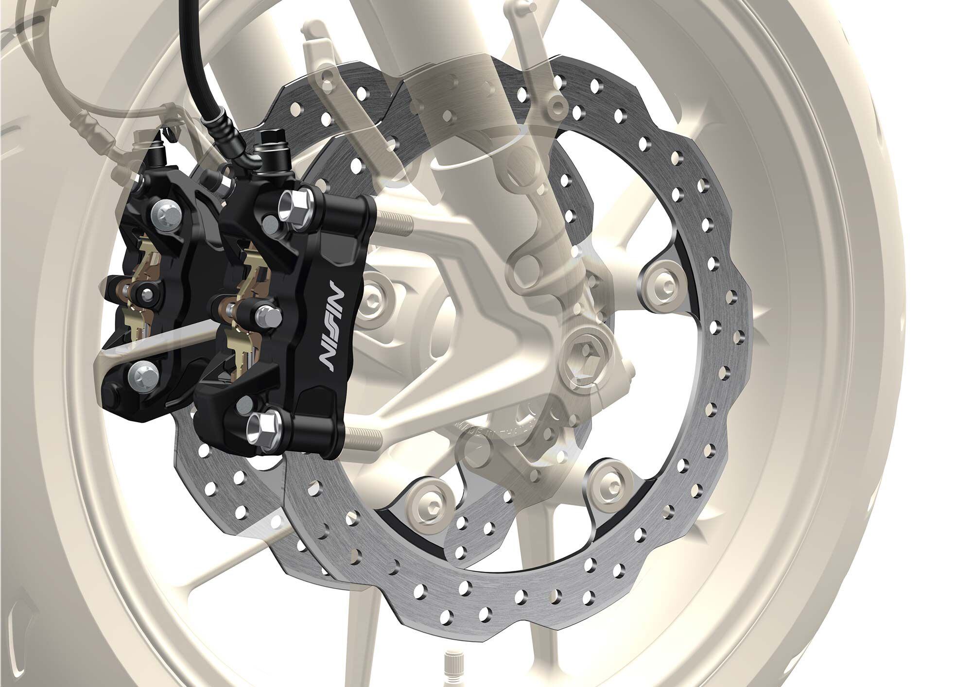

Dual 296mm front brake discs with radial-mount four-piston calipers increase stopping power for 2022.
Dual 296mm front brake discs with radial-mount four-piston calipers increase stopping power for 2022. (Honda/)
Similar to the suspension upgrade, the new dual front disc brake setup (dual 296mm discs with radial-mount four-piston calipers) replaces a single 320mm disc and two-piston caliper combination that wasn’t terrible to begin with. But the new braking system allows you to brake harder and with more control while expending less effort; that pays dividends everywhere from city streets to twisty canyon roads.

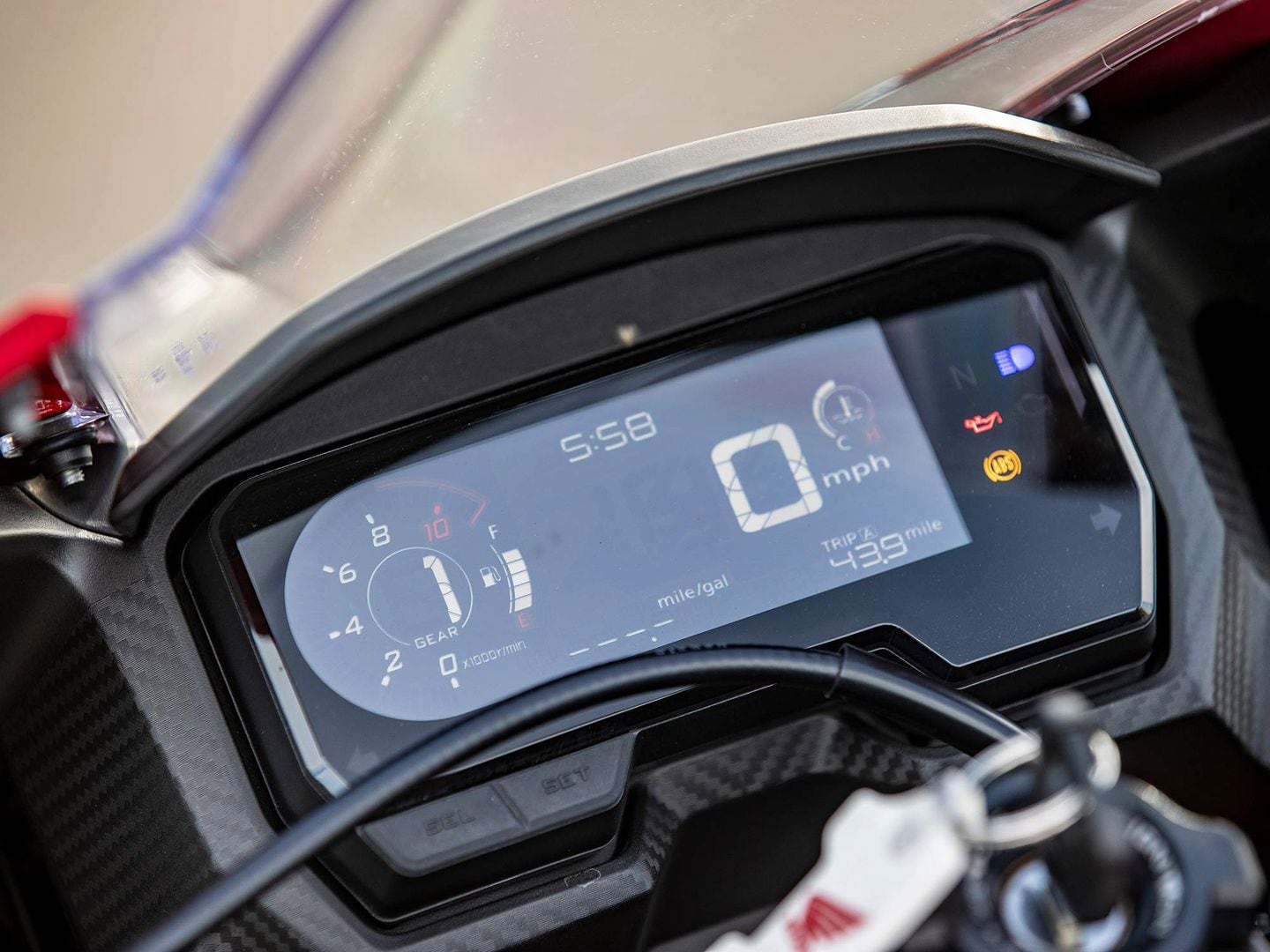

While the CBR500R does feature all-LED lighting, the LCD dashboard looks dated when compared to the full-color TFT displays that come standard on many of today’s bikes.
While the CBR500R does feature all-LED lighting, the LCD dashboard looks dated when compared to the full-color TFT displays that come standard on many of today’s bikes. (Honda/)
Other than standard ABS, the CBR has no electronic rider aids. Its LCD dashboard looks dated in the age of full-color TFT displays, although the lighting is now all-LED, with the headlights getting a more powerful setup for 2022.
