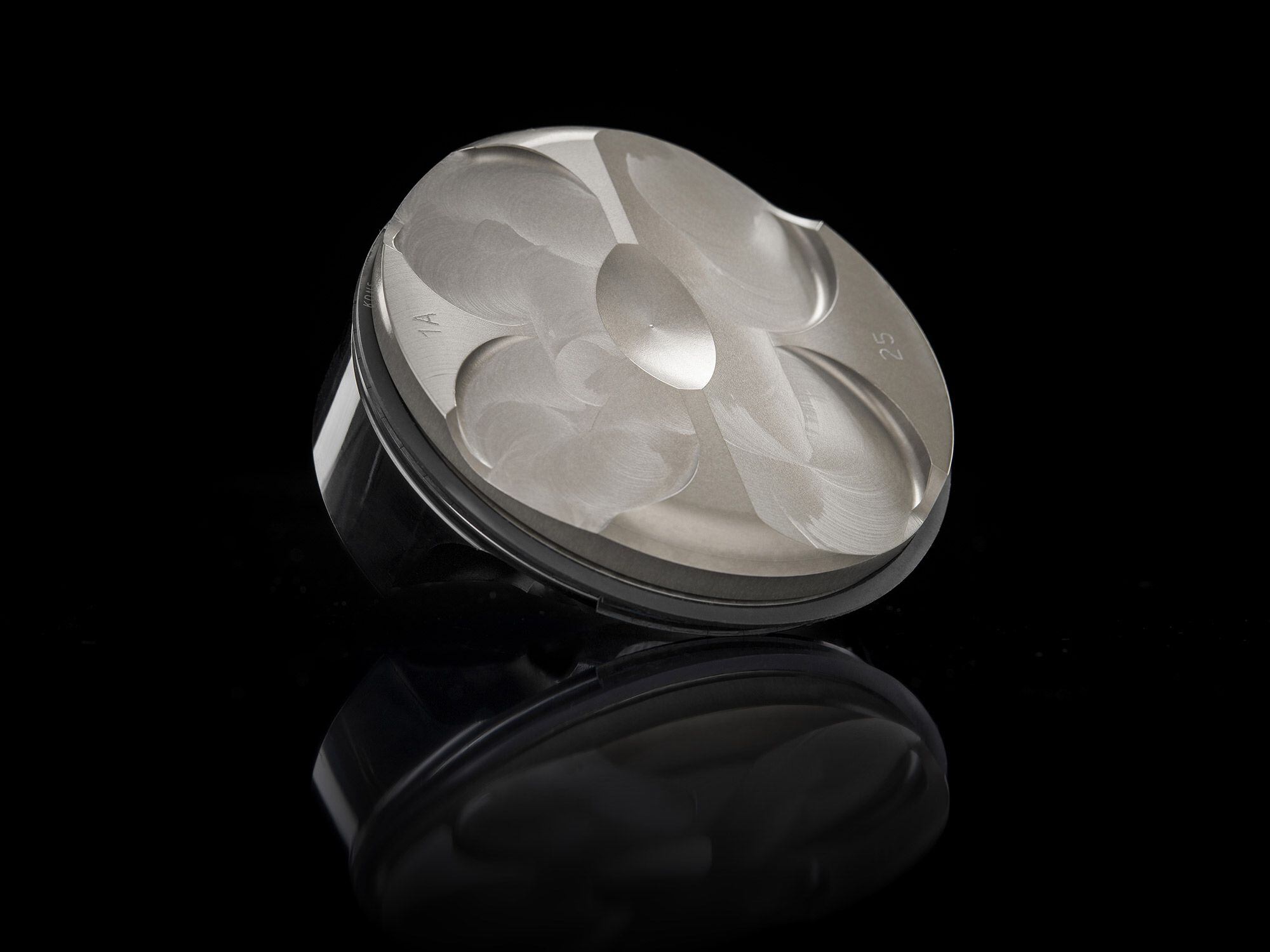

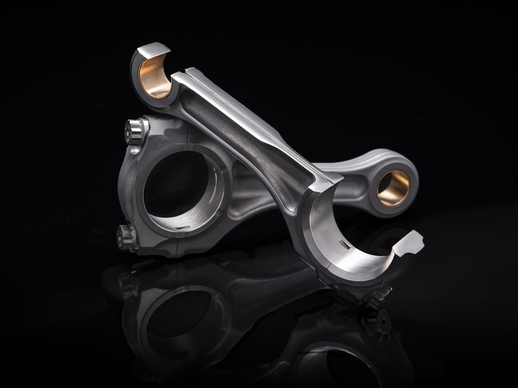

The new forged crankshaft retains the original’s 70-degree splined crank throws for superior primary-order balance when combined with the engine’s 90-degree V layout. Titanium connecting rods measure 104.3mm center to center for a fairly healthy 2.134:1 rod-to-stroke ratio, helping to meaningfully reduce secondary imbalances. The rod stems are “gun drilled” inside to ensure adequate oil feed to the wrist pins for lubrication and cooling, while the pistons themselves are a race-type design with a single top ring, and with skirt and crown thickness reduced to shave weight and consequent inertia loads at extreme engine speeds. The DLC skirt treatment further reduces frictional loads.
Intricate piston designs, now even lighter to move at extreme reciprocating speeds.
Intricate piston designs, now even lighter to move at extreme reciprocating speeds. (Ducati/)

Drilled titanium connecting rods for improved flow of cooling oil.
Drilled titanium connecting rods for improved flow of cooling oil. (Ducati/)

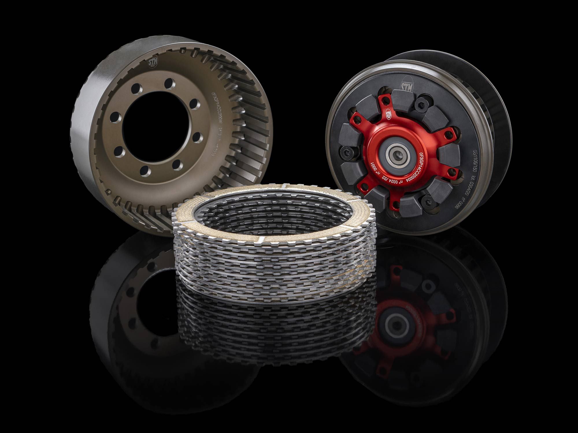

The new 800-gram dry clutch in a photo you can almost hear.
The new 800-gram dry clutch in a photo you can almost hear. (Ducati/)
The transmission holds a new, lighter (by 800 grams) dry clutch that’s both thinner and smaller in diameter. The gearbox contains the same ratios as the World Superbike racers, as in the 2022 Panigale V4 S.
