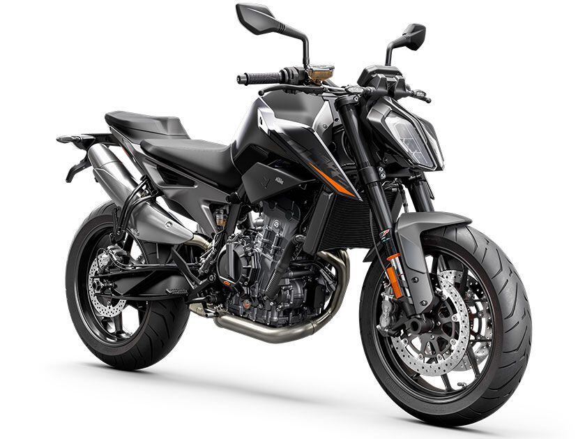

Love the 890 Duke R but looking for something that prioritizes comfort over track-focused performance? The 890 Duke uses a more street-oriented engine map, more modest hardware, and a relaxed rider triangle.
Love the 890 Duke R but looking for something that prioritizes comfort over track-focused performance? The 890 Duke uses a more street-oriented engine map, more modest hardware, and a relaxed rider triangle. (KTM/)

The 890 Duke sits at the opposite end of the lineup and is more street oriented. The parallel-twin engine is the same as the R’s, but power is reduced thanks to its own mapping. Nonadjustable WP Apex suspension is better suited to relaxed highway riding, and the ergonomics have been adjusted for everyday comfort.

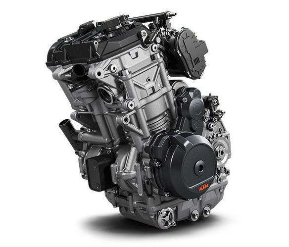

The 890 engine is based on the 790 Duke’s powerplant with a larger bore and stroke, higher compression ratio and rpm ceiling, larger valves, a new piston design, new connecting rods, and a new crankshaft, all wrapped in new engine cases. The crankshaft has 20 percent more rotating mass for added character and improved cornering stability.
The 890 engine is based on the 790 Duke’s powerplant with a larger bore and stroke, higher compression ratio and rpm ceiling, larger valves, a new piston design, new connecting rods, and a new crankshaft, all wrapped in new engine cases. The crankshaft has 20 percent more rotating mass for added character and improved cornering stability. (KTM/)
KTM’s 889cc DOHC parallel-twin engine is a bored/stroked version of the 790 Duke’s powerplant, which earned ample praise during its somewhat short two-year life span. As expected, the 890′s larger engine is everything it should be, especially the uniquely tuned 890 Duke R variant, which KTM claims is good for an extra 5 hp compared to the 890 Duke and 890 Duke GP.
Cycle World has not tested the standard 890 Duke, we can say that when strapped to the Cycle World dyno, the 890 Duke R recorded 106.2 hp at 9,900 rpm and 60.4 lb.-ft. of torque at 8,700 rpm, 11 hp over the 790 Duke. While the 2 lb.-ft. torque gain doesn’t sound like much, there’s an increase between 3,500 to 6,000 rpm that adds to the KTM’s low-to-midrange grunt: “Horsepower figures enjoy a bump throughout the powerband, most notably matching the 790′s peak power 1,000 rpm earlier, then smashing it all the way until its increased redline,” CW’s Michael Gilbert said in his First Ride Review of the 890 Duke R.
A buttery initial power delivery sets the bike in motion, building to an addicting punch in the midrange. At 7,000 rpm, the 890 Duke R lofts the front end to the air in the first three gears. Power builds fast and quickly makes its way through the rev range, pulling strongly into high revs and just tapering off before redline.

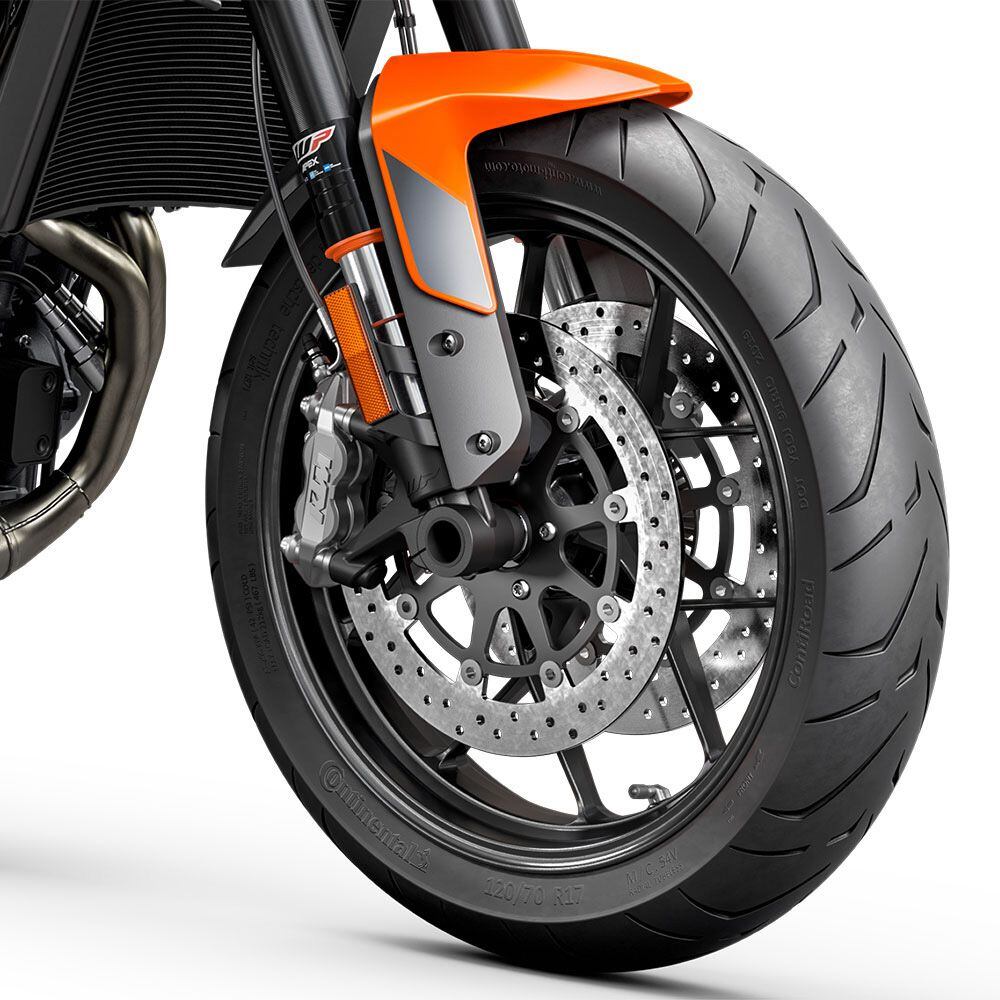

Tires play less of a role in overall handling, though it’s important to mention that the R model rolls on Michelin Power Cup tires, while base 890 Duke is fitted with street-oriented Continental ContiRoad rubber.
Even more differences between R and standard/GP models: While the 890 Duke R is fitted with Brembo Stylema Monoblock calipers and 320mm discs, the standard model uses KTM-branded J.Juan four-piston radial-mount calipers biting on 300mm discs.
Even more differences between R and standard/GP models: While the 890 Duke R is fitted with Brembo Stylema Monoblock calipers and 320mm discs, the standard model uses KTM-branded J.Juan four-piston radial-mount calipers biting on 300mm discs. (KTM/)
The standard 890 Duke and 890 Duke GP feature KTM-branded J.Juan four-piston radial-mount calipers biting on 300mm discs, a slightly less performance-oriented setup than what’s found on the R.
R models take a next step in terms of components, with Brembo Stylema Monoblock calipers and 320mm discs combining for great feel and braking performance in track riding. Meanwhile, a Brembo MCS master cylinder with adjustment for lever ratio and brake feel results in superb braking action, in addition to dropping 2.6 pounds of unsprung weight that surely plays a role in the improved fork action.

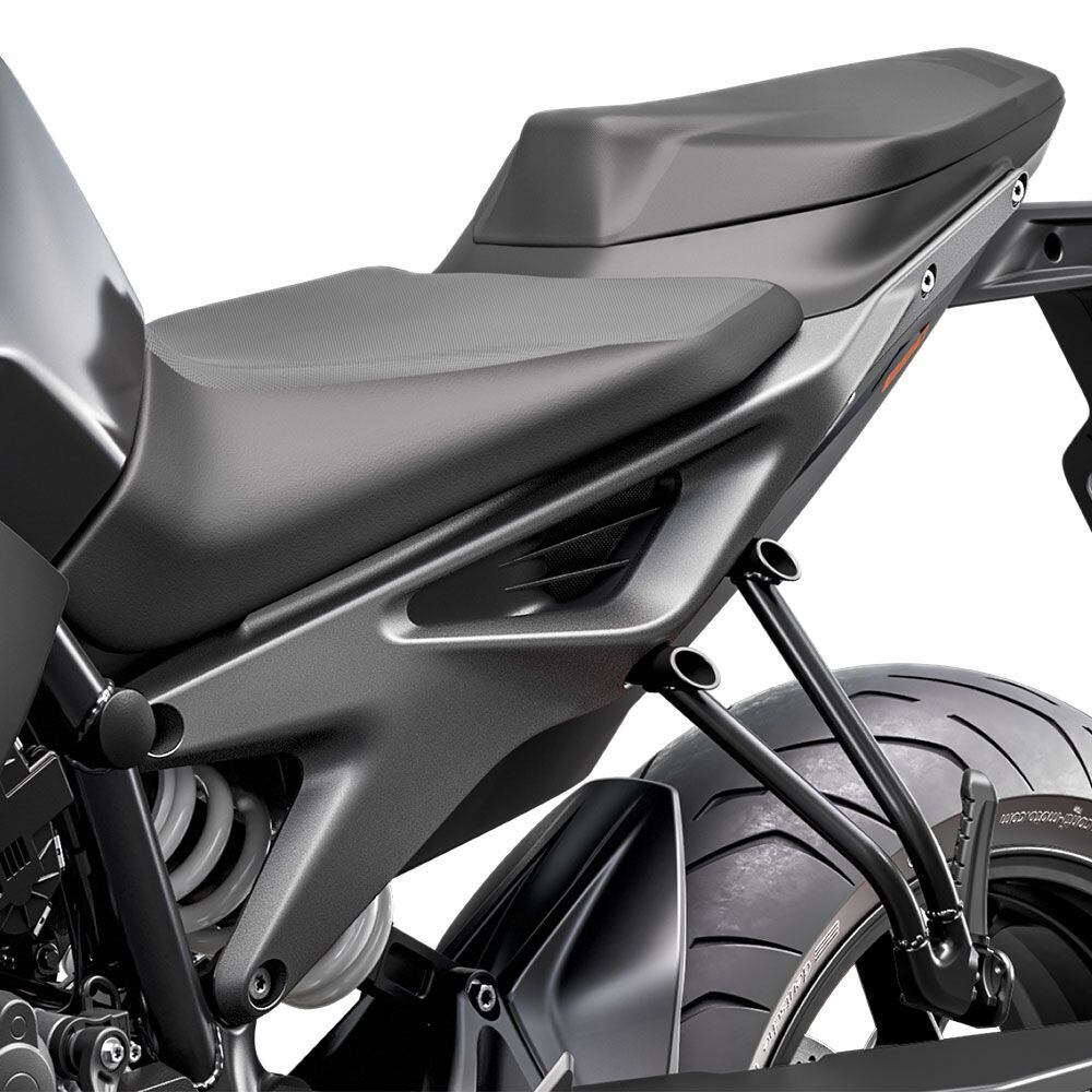

The 890 Duke has a 0.6-inch-lower seat height compared to the R model, and the pegs are lower for more legroom. The result is a more comfortable motorcycle for street riding, but slightly less ground clearance.
The 890 Duke has a 0.6-inch-lower seat height compared to the R model, and the pegs are lower for more legroom. The result is a more comfortable motorcycle for street riding, but slightly less ground clearance. (KTM/)
Although the 890 Duke’s riding position is a bit aggressive, with a longer reach to the handlebar that puts your torso farther forward than most naked bikes, it doesn’t put excessive pressure on the wrists.
The 890 Duke R’s ergos are decidedly racier, with a lower handlebar and rearset footpegs that reflect its higher-performance intentions, but the riding position is still comfortable enough to handle everyday riding. The R and GP models also do away with the passenger seat, while the R goes a step further by also doing away with the passenger footpegs.
Riders who prioritize comfort may want to look at the base-model 890 Duke.
