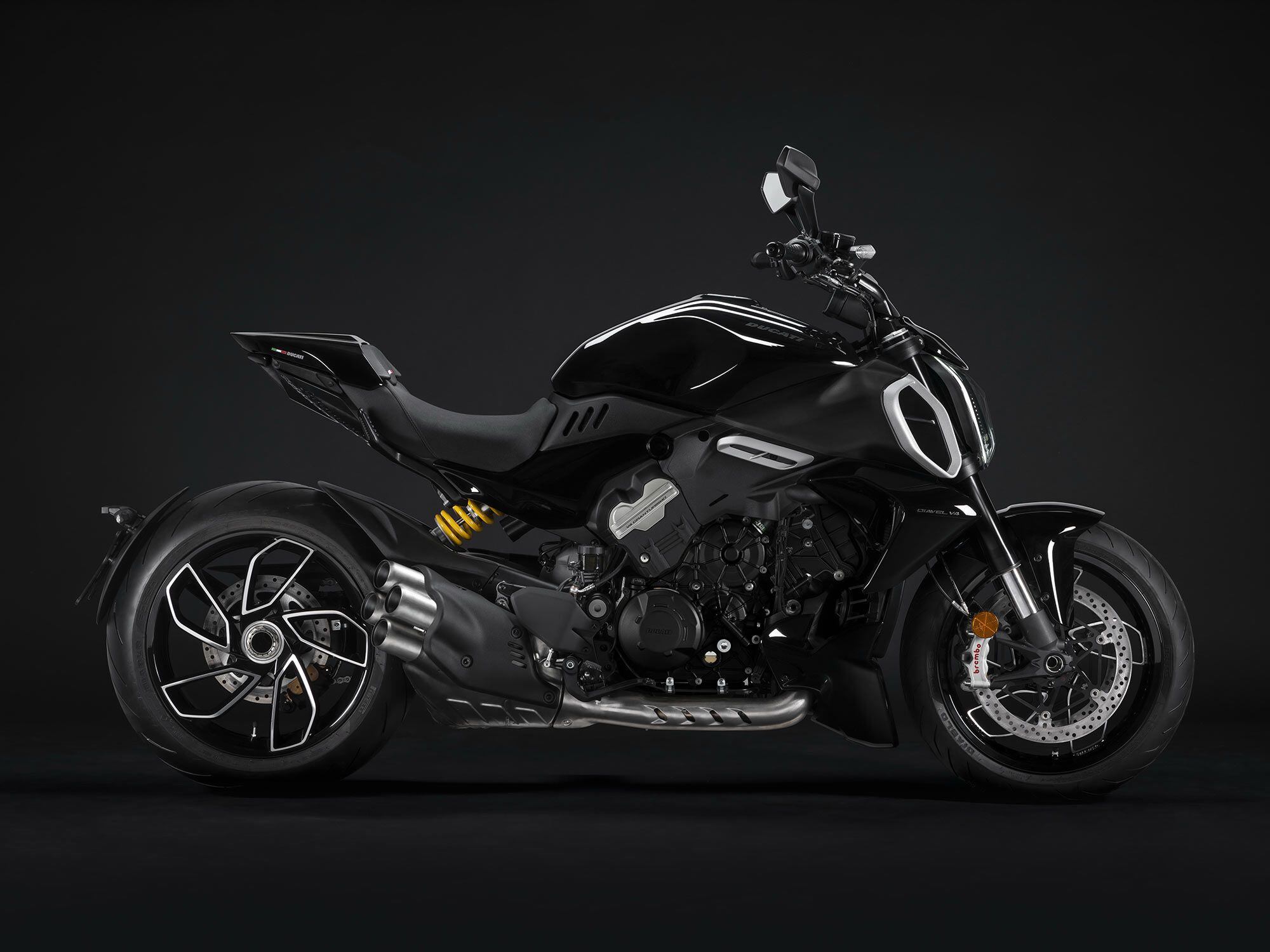

Ducati’s Diavel now gets the Granturismo V4 along with other significant changes and updates.
Ducati’s Diavel now gets the Granturismo V4 along with other significant changes and updates. (Ducati/)

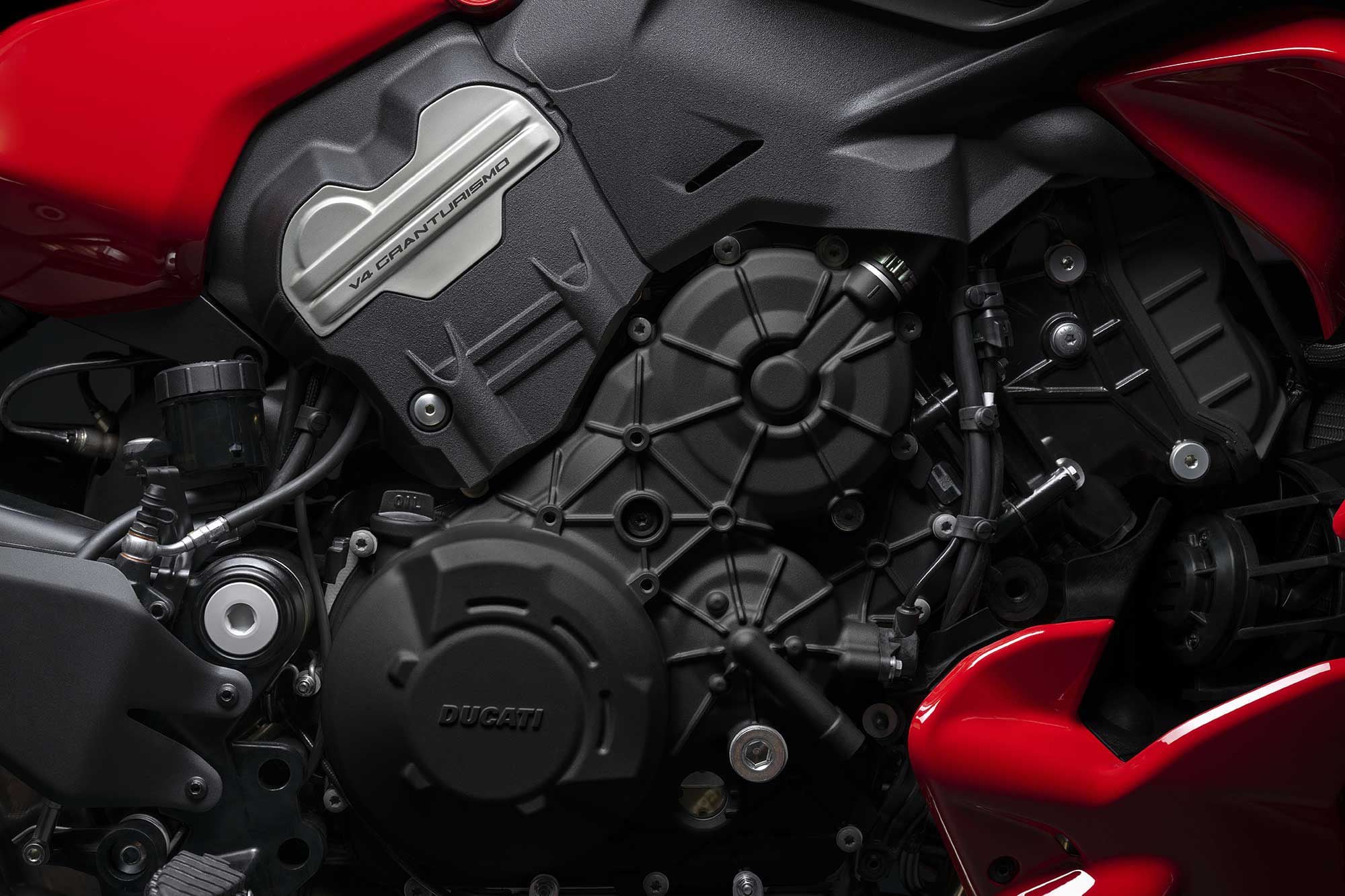

I’ll be the first to admit it: We all were wrong. The Ducati Panigale V4 desmo and Granturismo V4 are proving that the four-cylinder is a state-of-the-art engine, one that is not only capable of class-dominating power, but which is also quite versatile. In its spring-valve (non-desmo) Granturismo version, valve-clearance checks jump to an astounding 37,000 miles—a world record for just about any bike producing power at this level, and an astounding accomplishment for a Ducati.
A 1,158cc DOHC V-4 powers the Diavel V4 with a claimed 168 hp.
A 1,158cc DOHC V-4 powers the Diavel V4 with a claimed 168 hp. (Ducati/)
This 1,158cc 168 hp unit is a monster of flexibility, delivering peak power at 10,750 rpm and peak torque—93 lb.-ft.—at 7,500 rpm. That gives the engine a 3,250-rpm-wide band of full performance for breathtaking throttle response. And just as on the Multistrada Rally, when cruising at low speeds and in traffic the V4 can switch off its two rear cylinders to reduce fuel consumption and minimize heat buildup under the seat

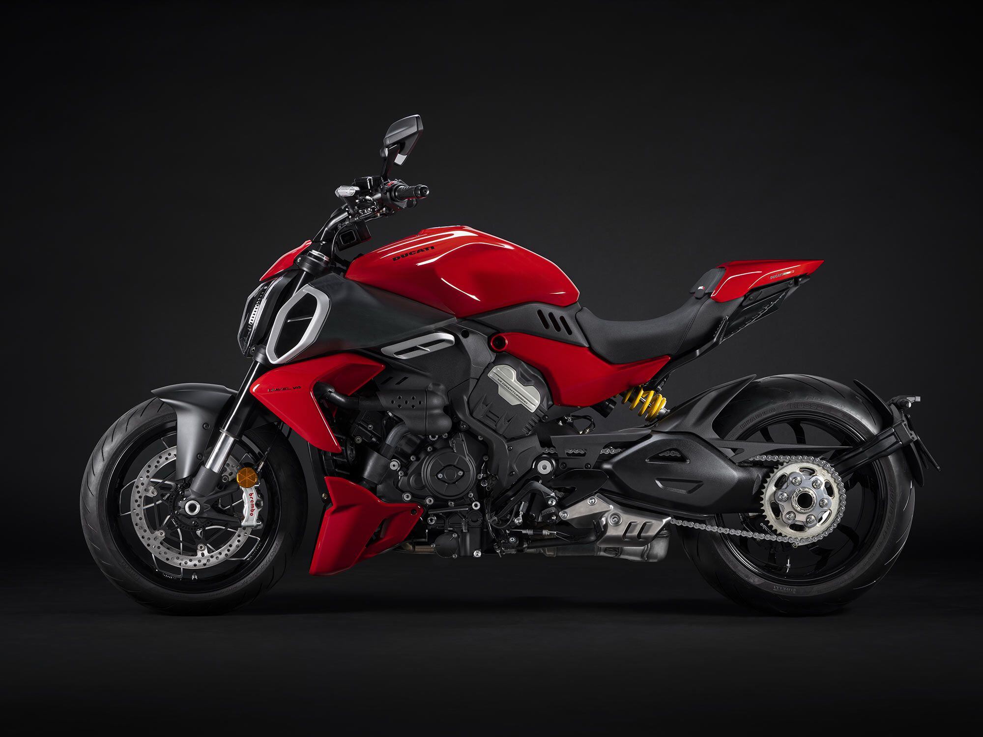

The V-4 Granturismo engine also mates up with an equally versatile and innovative frame, a sheet-aluminum monocoque structure. Combined with the engine, the construction gets the whole Diavel package down to 465 pounds, 29 pounds less than the twin-cylinder Diavel 1260 S. For the latest bike, this same frame has been altered (should we say upgraded?) not only in its structure, but also in its geometry, with a steeper steering rake (down from 27 degrees to 26 degrees); consequently the trail is now 4.4 inches (an improvement), while the wheelbase shortens from 63 inches to 62.7 inches.
A steeper steering rake and shorter wheelbase promise a more nimble Diavel than before—not that we complained about the previous model.
A steeper steering rake and shorter wheelbase promise a more nimble Diavel than before—not that we complained about the previous model. (Ducati/)
Those numbers may look modest, but the V4 hides a bigger change: Thanks to the engine’s more compact design when compared to the 1260 V-2 Testastretta, there’s a substantial alteration to the bike’s weight distribution. The front wheel moves closer to the bike’s center of gravity, while the single-sided swingarm’s center-to-center measurement has grown slightly longer to make a better use of the huge rear 240/45-17 Pirelli Diablo Rosso III radial tire. The rider’s seating position has moved forward by 20mm as well, while the seat height has increased slightly to 31.1 inches.

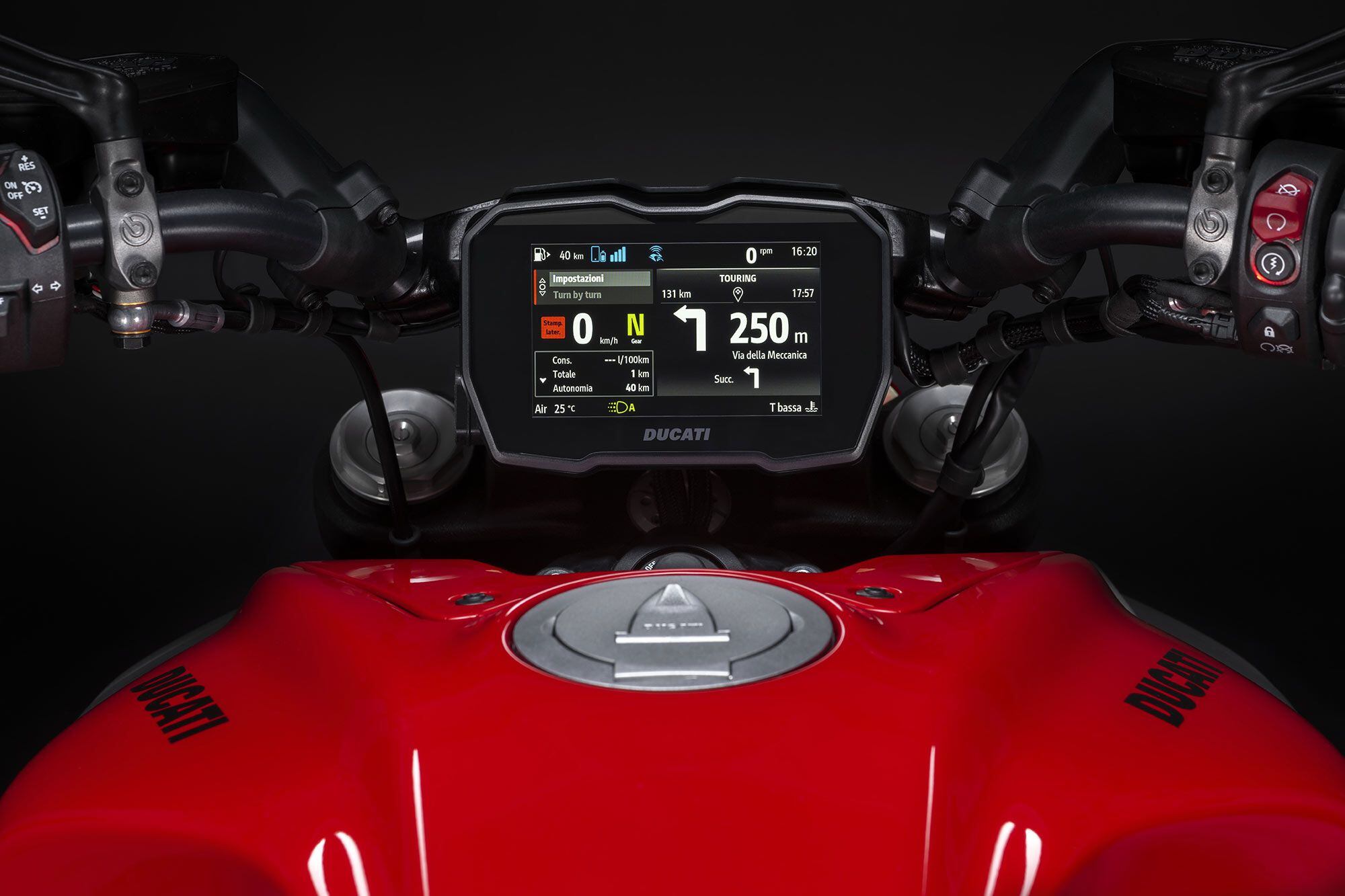

As usual, Ducati doesn’t cut corners on the electronics suite. In addition to the ABS cornering management, the engine offers three selectable power modes, and the rider can select from four riding modes. The Diavel V4 includes Ducati traction control (in its cornering version), wheelie control, launch control, and—equally important for a power cruiser—cruise control. Ducati’s quick-shift technology is also standard (both upshifts and downshifts). The 5-inch TFT instrumentation display offers Bluetooth smartphone connectivity, and when the optional navigation system is present, it presents detailed “turn-by-turn” directions.
Turn-by-turn navigation is now available on the Diavel’s TFT screen.
Turn-by-turn navigation is now available on the Diavel’s TFT screen. (Ducati/)
