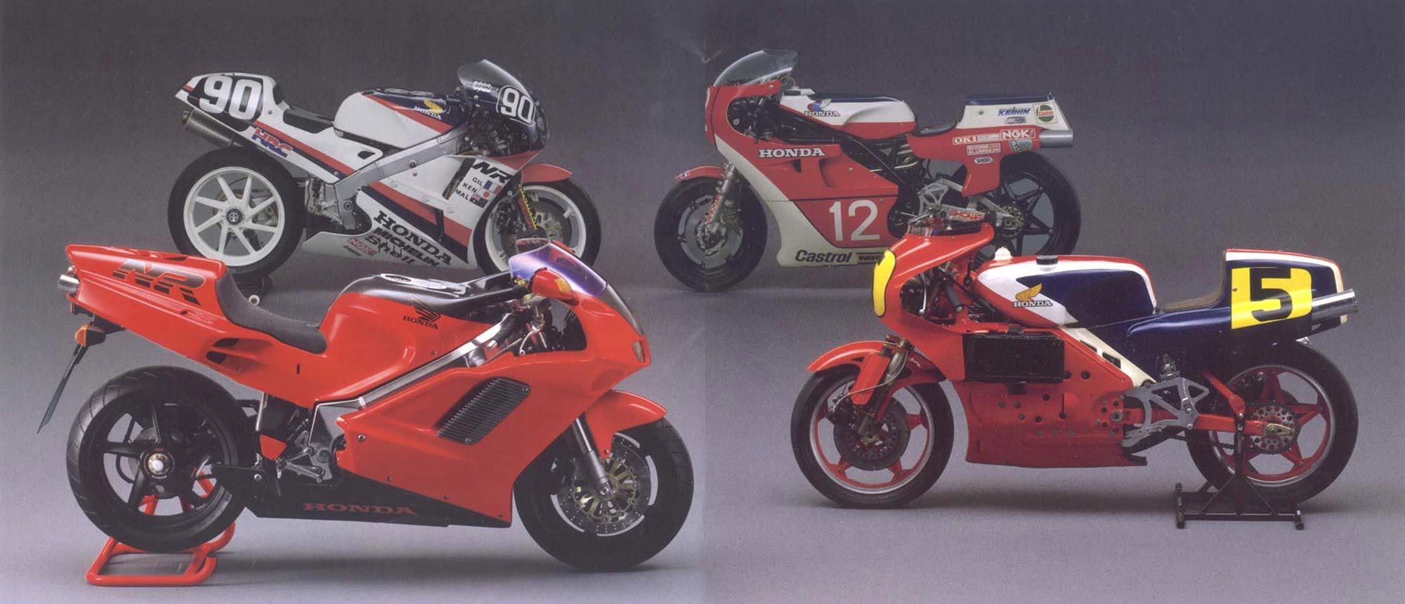

From the original NR750 brochure, the bike is pictured with V-4 family members: the NR750 Endurance Racer (left rear) and 1979 NR500 (right front) and Kengo Kiyama’s NR500 (2X) racer that won the 1981 Suzuka 200-Kilometer Race (right rear).
From the original NR750 brochure, the bike is pictured with V-4 family members: the NR750 Endurance Racer (left rear) and 1979 NR500 (right front) and Kengo Kiyama’s NR500 (2X) racer that won the 1981 Suzuka 200-Kilometer Race (right rear). (Honda/)

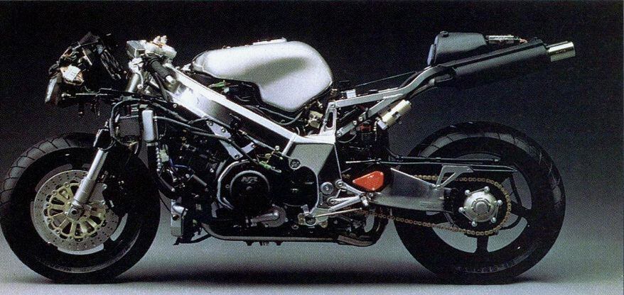

This body-off shot shows the complexity hiding under all that plastic.
This body-off shot shows the complexity hiding under all that plastic. (Honda/)
With all of this complexity, EFI was essential to feed the air-fuel mixture to the cylinders precisely. Honda’s PGM-FI fuel-injection system, as mentioned, had twin throttle bodies for each cylinder with a single injector in each bore. The system had a 16-bit ECU, a big deal for 1992, monitoring seven different sensors to optimize delivery.

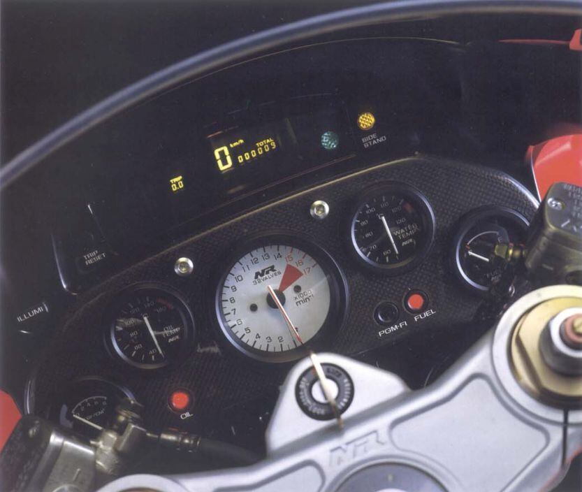

The NR750’s dash, with its mix of digital and analog gauges, was like nothing else on a production bike back in 1992.
The NR750’s dash, with its mix of digital and analog gauges, was like nothing else on a production bike back in 1992. (Honda/)
Other items that were either production firsts, or adopted early before they became the norm, were a 45mm upside-down fork, twin four-piston Nissin brake calipers with 310mm discs up front, carbon fiber bodywork, side-mounted radiators, underseat exhaust, cassette-style transmission, a hybrid digital/analog dash, magnesium wheels measuring 16 inches in front and 17 inches at the rear, and cat-eye headlights with a projector-beam lamp on the left and a halogen flood on the right.
