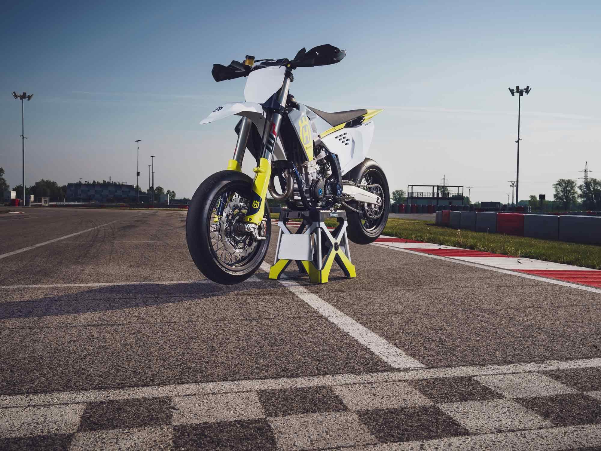

The 2023 Husqvarna FS 450 enters the new model year with a number of changes focused on improved handling and an updated engine.

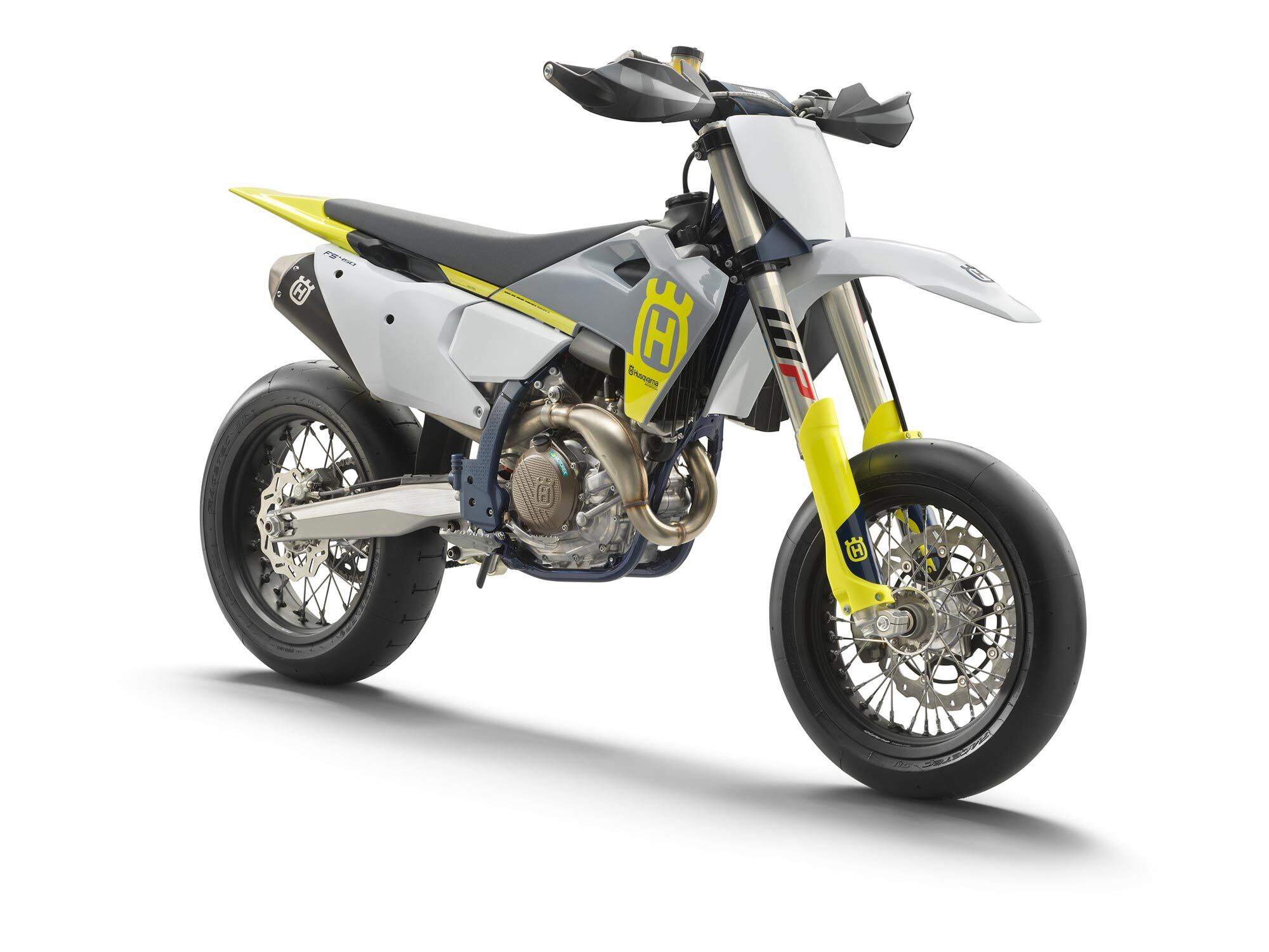

An all-new laser-cut hydroformed steel frame headlines the changes to the FS 450. Longitudinal and torsional flex characteristics have been tailored for improved rider feel and feedback while improving overall balance and straight-line stability. The frame’s wall thicknesses have been changed to improve overall strength and reliability in high-stress areas, such as the head tube. A new shock tower is mounted to the frame’s side spars, not its backbone, allowing the FS to have a perimeter frame-style mount without perimeter frame rigidity.

An all-new polyamide-reinforced aluminum subframe, constructed of 60 percent polyamide and 40 percent aluminum, complements the new frame for optimized rigidity. Also new to the rear end is a cast aluminum swingarm with a 22mm rear axle designed to match the chassis’ updated flex characteristics.
The WP Xact front fork and rear shock have also been updated for 2023. The split damping function fork now features a new “hydrostop” that is said to improve bottoming resistance deep in the suspension stroke; the new component provides a more progressive damping force in the last 40 millimeters of travel, rather than the final 10 millimeters as in the previous iteration. Internal rebound damping has also been updated. The Xact rear shock has been redesigned with a shorter body for less weight, while retaining the same travel length. A new Computational Fluid Dynamics (CFD) optimized main piston is claimed to provide feel and support. The shock’s redesigned compression and rebound damping adjusters can be easily changed without tools.
