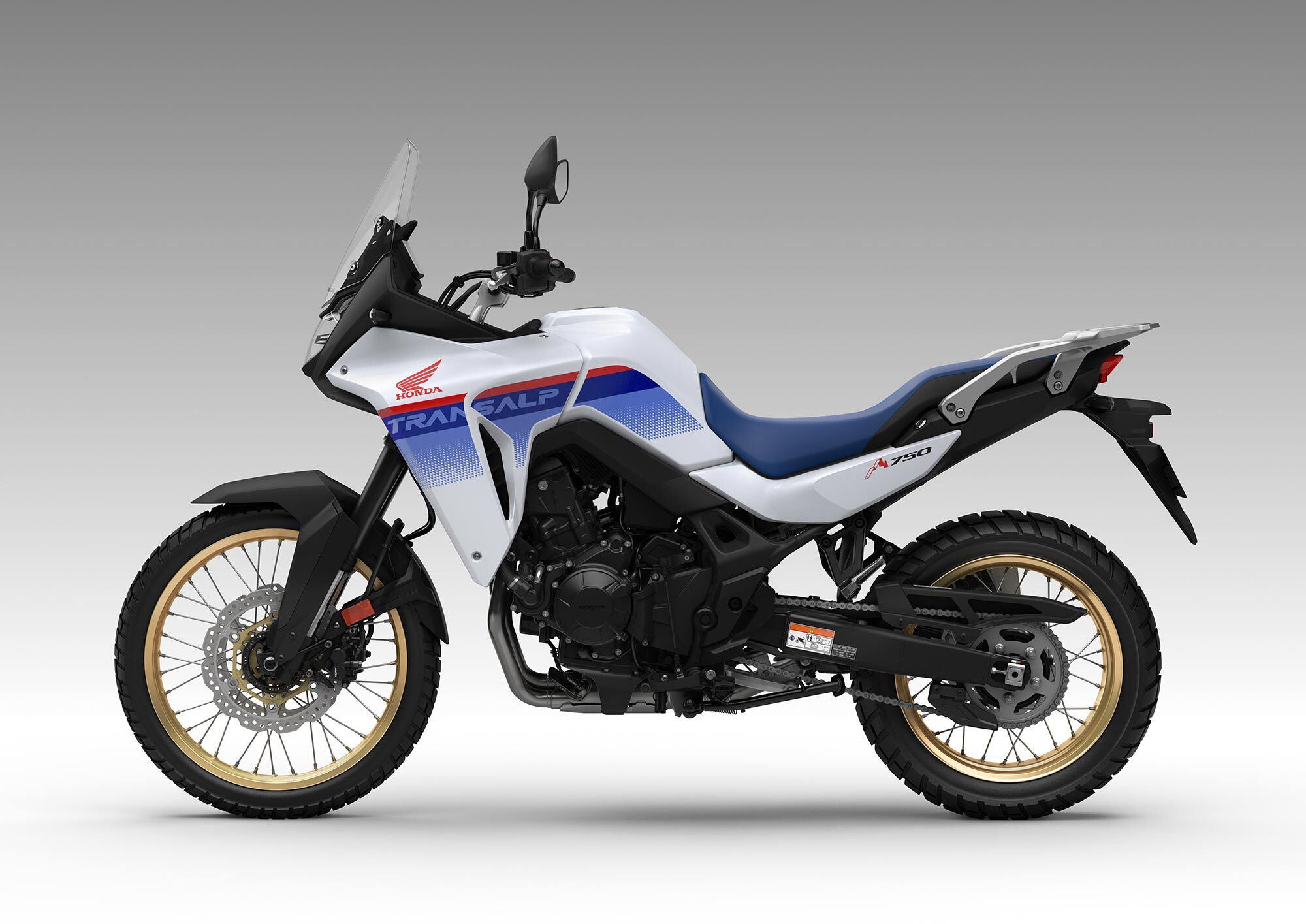

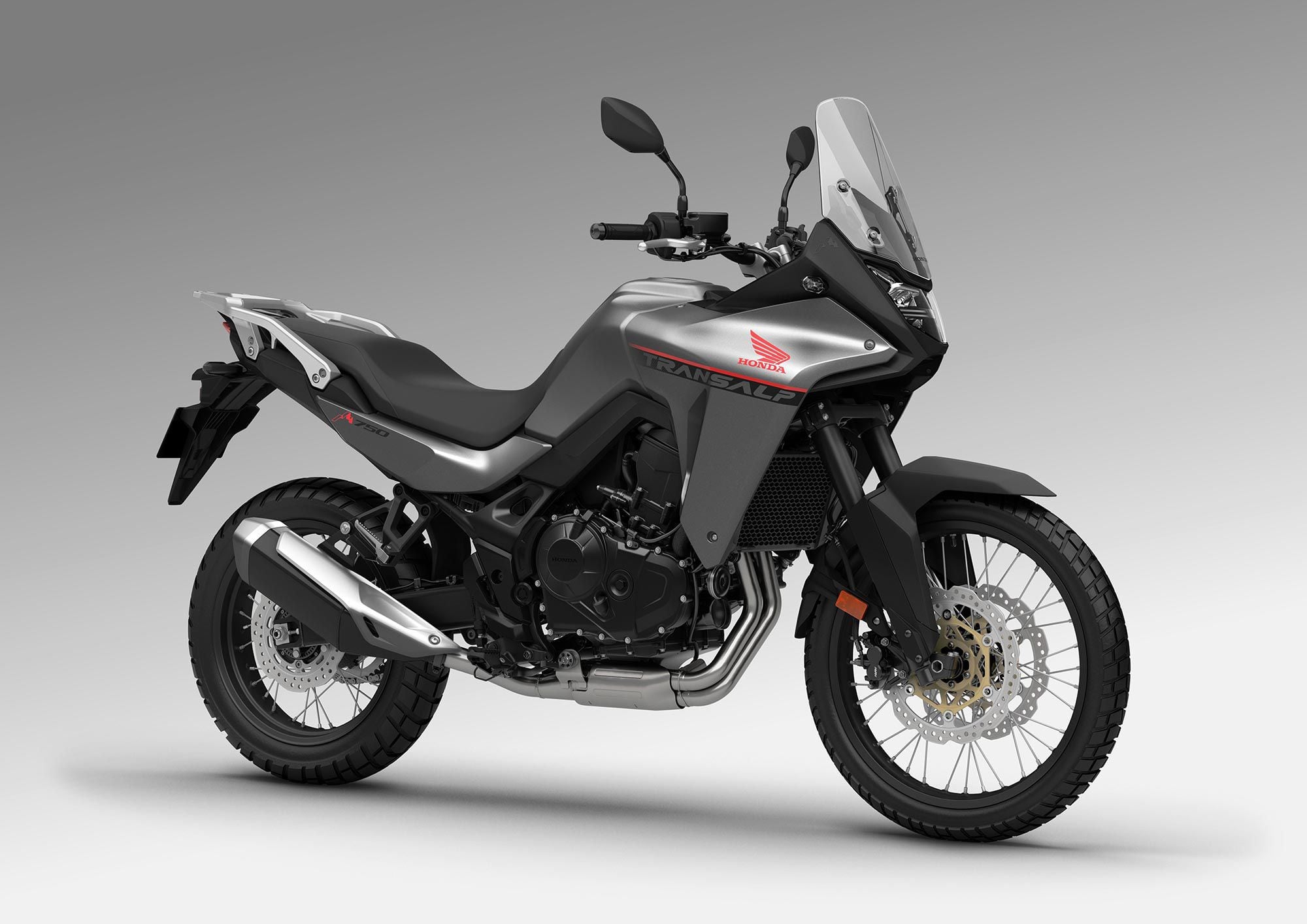

Honda has revived the Transalp name with the new XL750.
Honda has revived the Transalp name with the new XL750. (Honda/)
It’s been 10 years since Honda discontinued the last Transalp after a quarter of a century building middleweight adventure bikes bearing that name. For 2023, the Transalp is back, and unlike its slightly soft forebears, the new bike’s on-paper specifications give it everything it needs to dominate its category.
There’s no better way to track the changes in how the adventure-bike market has developed over the last few decades than to trace the way the Transalp has mutated. In 1986, the original Transalp was launched as the 583cc XL600V, sporting a three-valve V-twin with 50 hp and predating the more hardcore original Africa Twin (a Euro model, unlike the current open-class Africa Twin), which would initially arrive in 1988 with a 647cc twin before a hike to 742cc in 1990. Over the years, the Transalp would get capacity hikes to 647cc in 2000 and 680cc in 2008, but it never topped the 60 hp mark.

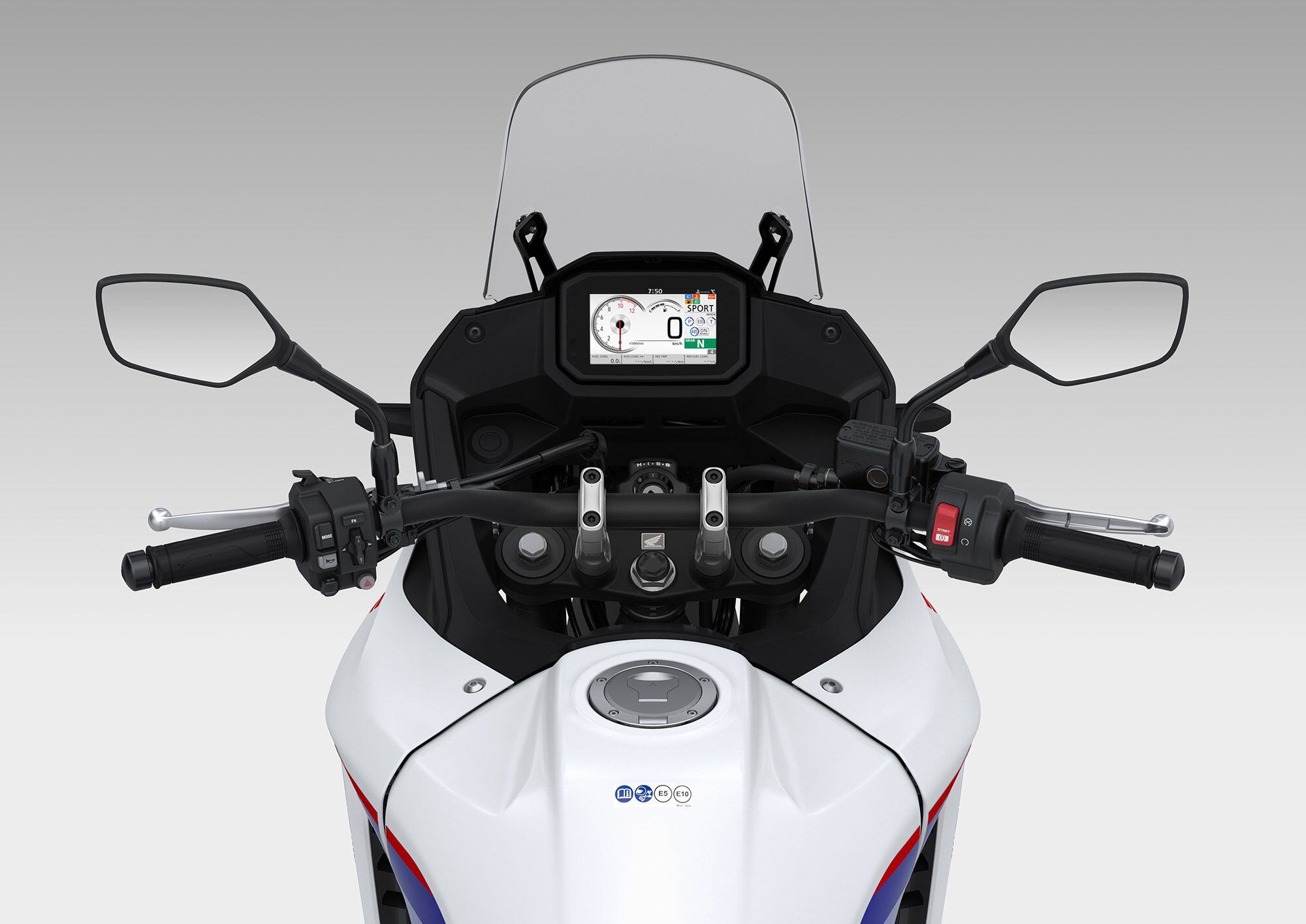

The cockpit view shows the new TFT display that allows riders to optimize the riding modes to their liking.
The cockpit view shows the new TFT display that allows riders to optimize the riding modes to their liking. (Honda/)

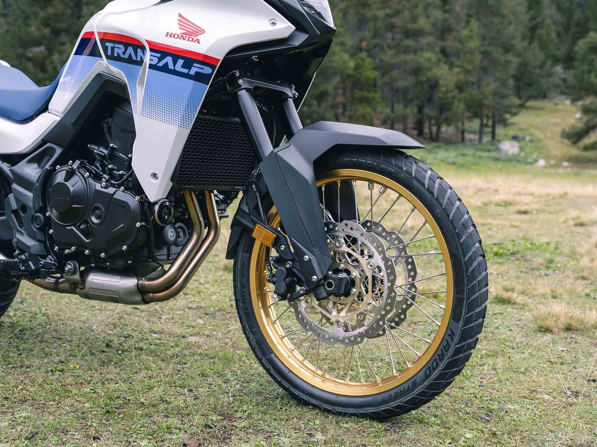

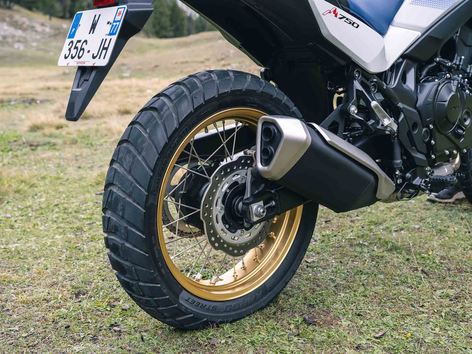

The engine sits in a frame that’s essentially borrowed from the Hornet, but with revised geometry to suit its off-road purpose. The steel “diamond” chassis weighs a mere 40 pounds, helping to keep the whole bike down to an impressive 459 pounds complete with fuel. The frame features a 27-degree steering head angle with 4.4 inches of trail. A Showa 43mm inverted SFF-CA (Separate Function Fork-Cartridge) fork provides 7.8 inches of front travel, while a Showa remote-reservoir monoshock at the back has 7.5 inches of travel. That’s a little less than the rival Suzuki or the Ténéré 700, but still enough for some gentle dirt road riding. Cost savings show in the lack of suspension adjustment; it’s limited to preload only. Braking duties are completed via Nissin two-piston axial-mount calipers at the front with dual 310mm rotors; a single 245mm rear disc and one-pot sliding caliper sits out back. ABS is standard with two selectable levels of intervention, and the rear ABS can be disengaged for off-road use.
The steel diamond frame is host to a Showa SFF-CA fork, while a pair of two-piston calipers and 310mm handle front-braking duties.
The steel diamond frame is host to a Showa SFF-CA fork, while a pair of two-piston calipers and 310mm handle front-braking duties. (Honda/)

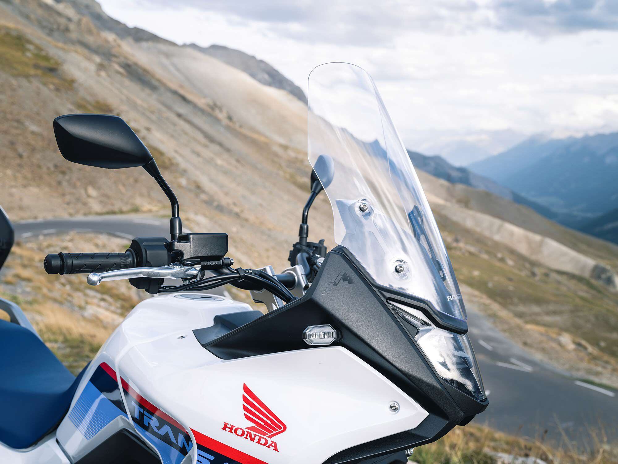

The Transalp’s styling is the work of Honda’s Italian R&D department in Rome; it’s a clean-looking machine but with some signs of cost-cutting. The screen isn’t adjustable, for instance, and the headlight is an off-the-shelf unit also used on the Hornet, the CB500F, and the CB500X. It’s still LED, though, along with the rest of the lighting which includes tech such as an emergency stop signal that flashes the hazard lights if you brake harder than a preset threshold. The turn signals are also self-canceling, using front and rear wheel speeds to determine whether a maneuver has been completed.
The windscreen is not adjustable, and there aren’t standard hand guards.
The windscreen is not adjustable, and there aren’t standard hand guards. (Honda/)

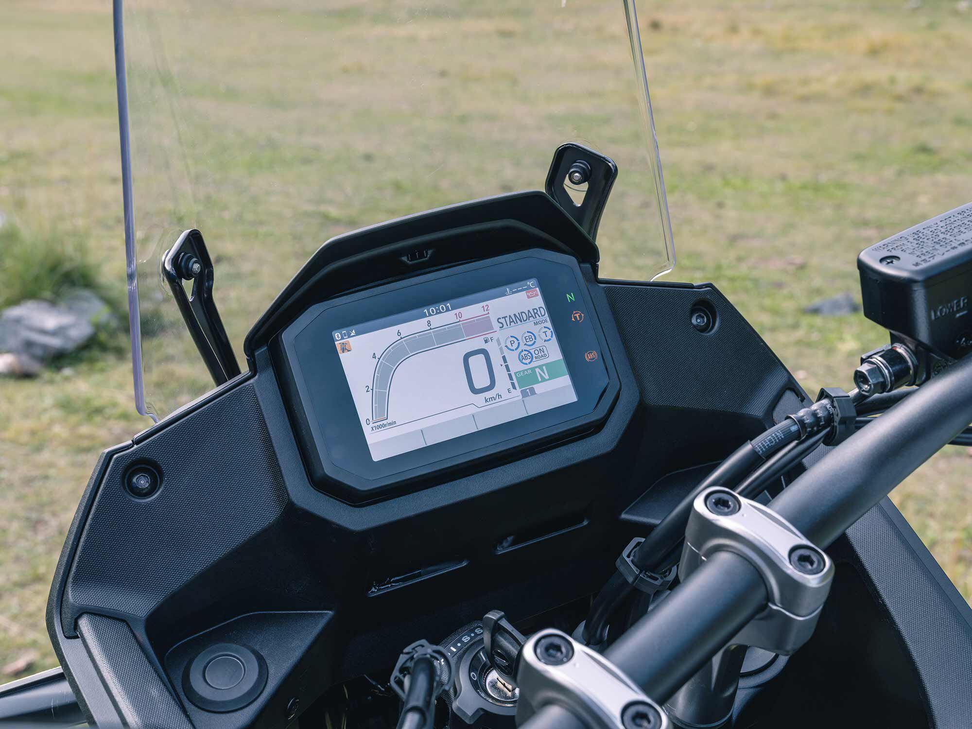

On-board, there’s the same TFT color dash that appears on the CB750 Hornet, incorporating Bluetooth connectivity for phones and, when allied to a headset, a voice control system for Android to manage calls, messages, music, and navigation. The same controls can also be achieved via switch gear on the left-hand bar.
A closer look at the TFT display.
A closer look at the TFT display. (Honda/)

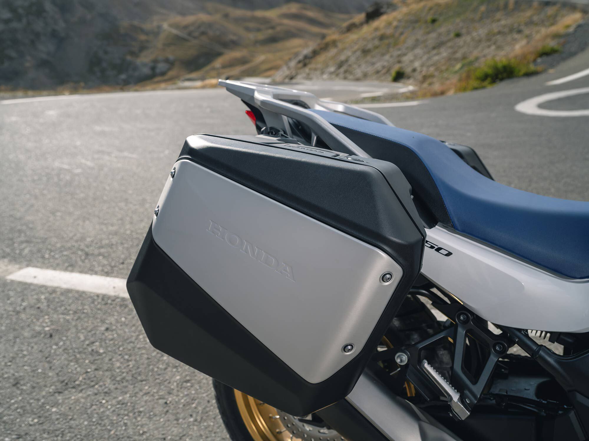

Optional side case.
Optional side case. (Honda/)The rear suspension has provisions for preload adjustment.

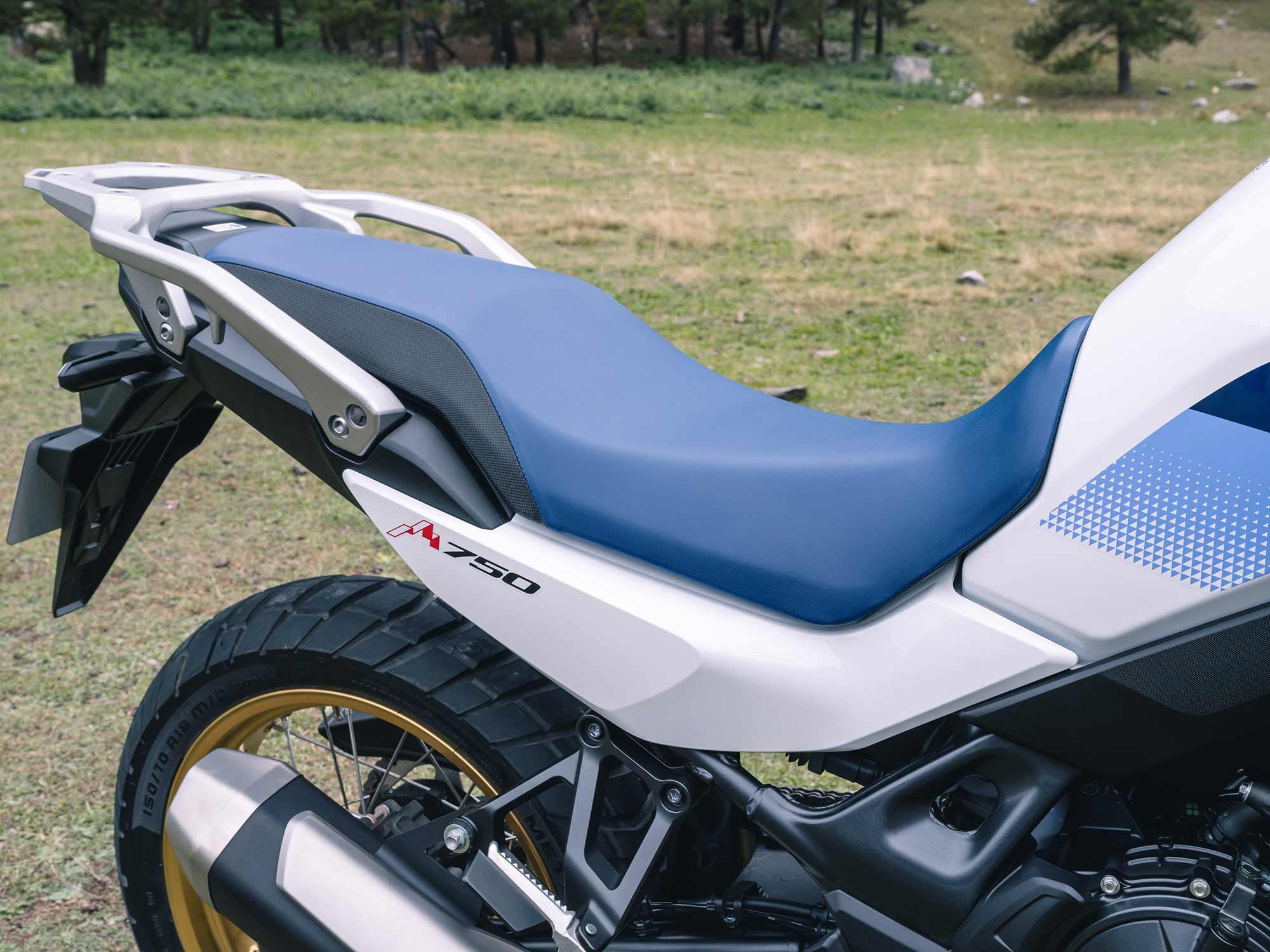

The rear suspension has provisions for preload adjustment. (Honda/)Seat height is set at 33.5 inches.

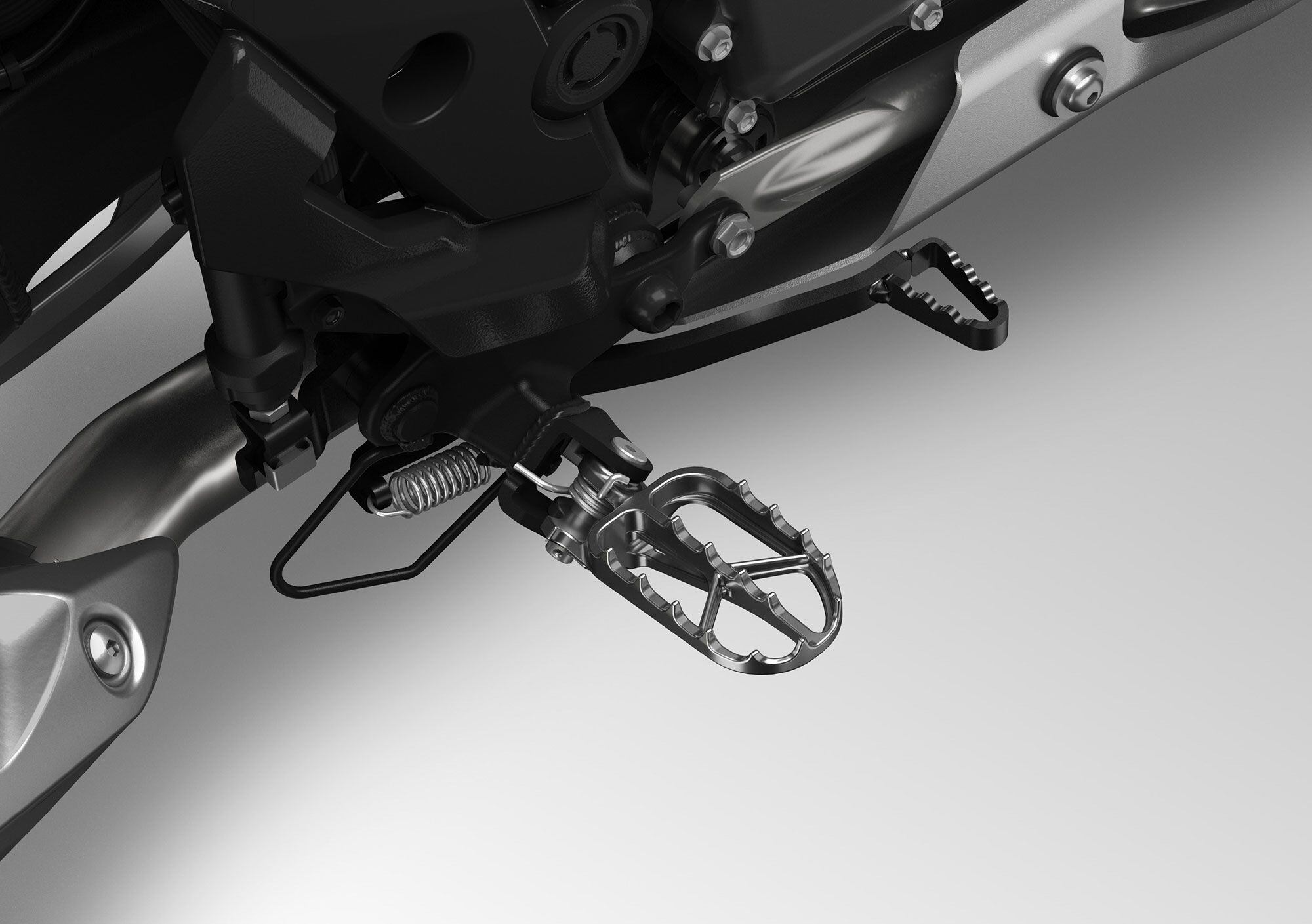

Seat height is set at 33.5 inches. (Honda/)Footpegs are ready for off-road riding.

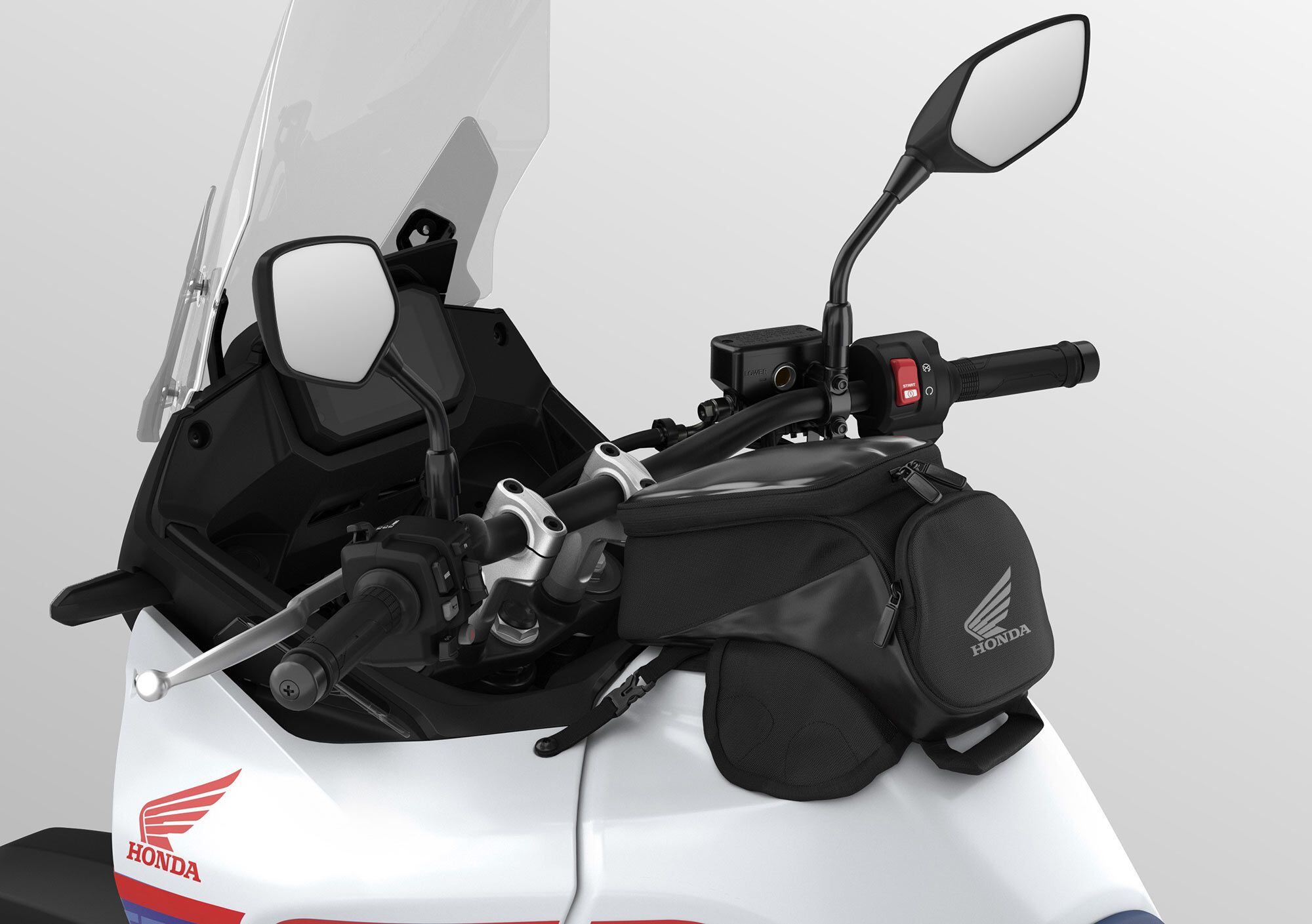

Footpegs are ready for off-road riding. (Honda/)Tank with optional tank luggage.

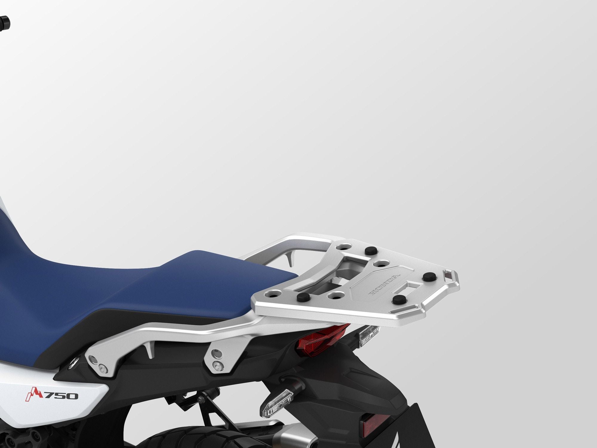

Tank with optional tank luggage. (Honda/)Rear rack to accommodate optional top case.

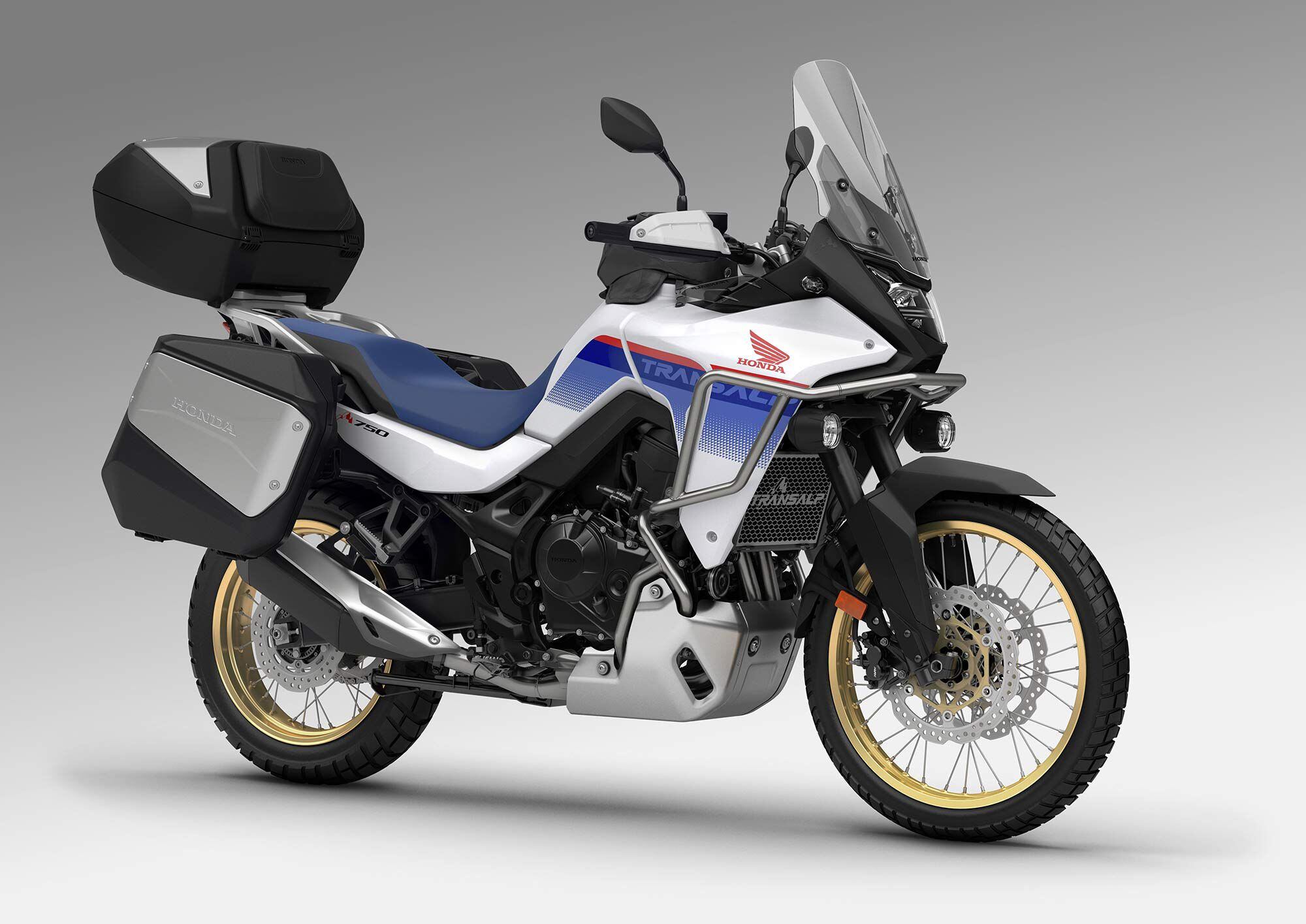

Rear rack to accommodate optional top case. (Honda/)2023 XL750 Transalp with optional luggage.

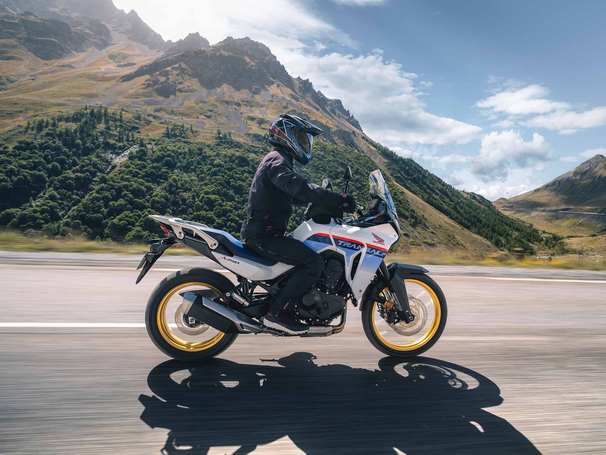

2023 XL750 Transalp with optional luggage. (Honda/)2023 Honda XL750 Transalp in action.
2023 Honda XL750 Transalp in action. (Honda/)

Rear Brake: 1-piston caliper, 256mm disc w/ ABS
Wheels, Front/Rear: Wire-spoked wheels; 21 in./18 in.
Tires, Front/Rear: 90/90-21 / 150/70-18
