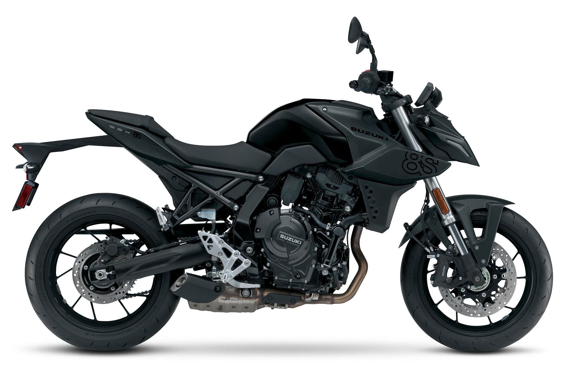

Here is the Suzuki GSX-8S stripped of its bodywork.
Here is the Suzuki GSX-8S stripped of its bodywork. (Suzuki/)

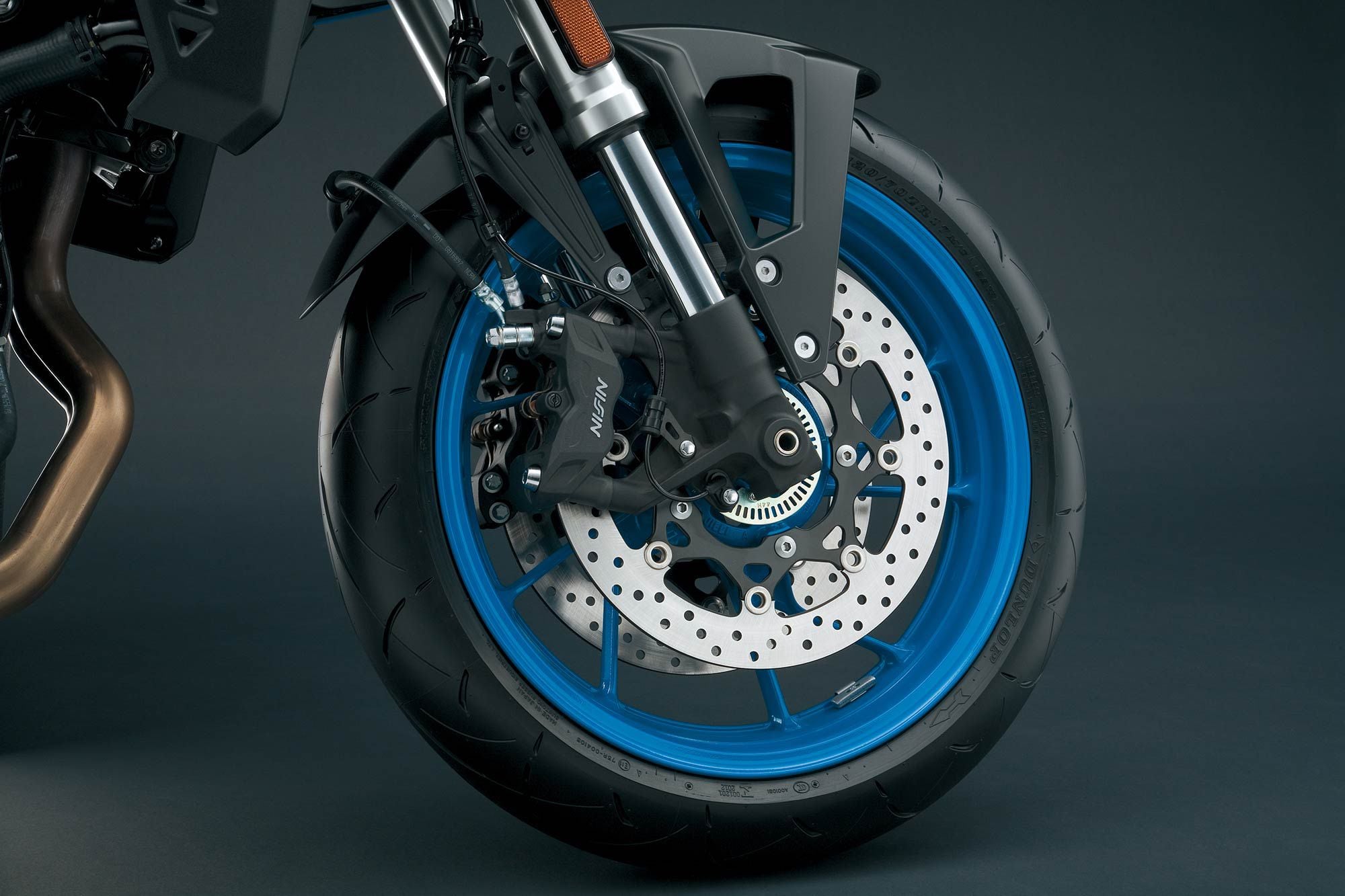

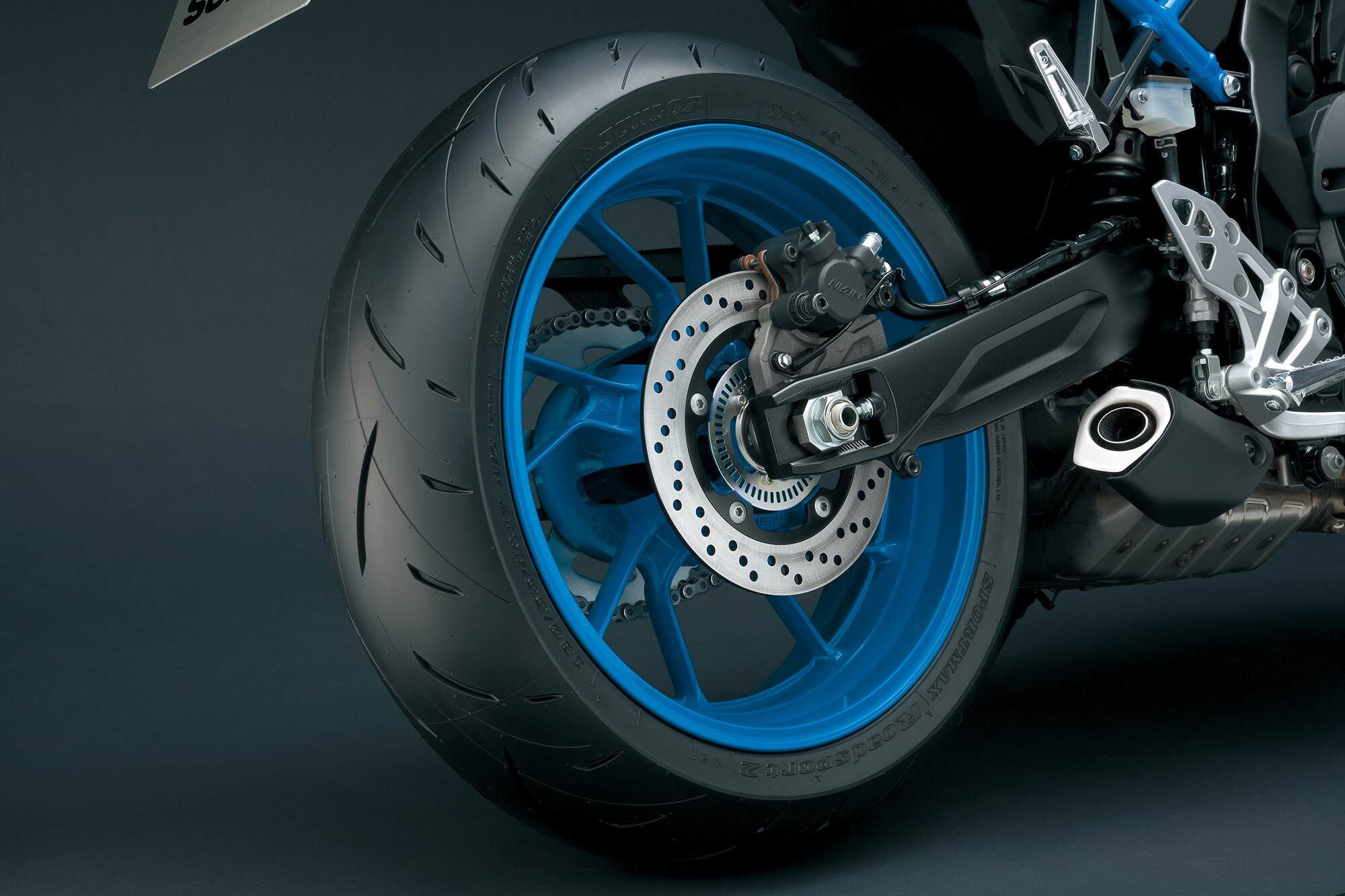

All that is mounted in a steel frame using a tubular front section and welded pressings around the swingarm pivot. A bolt-on subframe, again tubular steel, suggests that future models could be spun off using the same main frame but a different rear end. The swingarm is alloy, bolted to a KYB shock with mechanical preload adjustment; KYB also provides an inverted fork with 130mm of travel. Radial-mounted Nissin four-piston calipers grip dual 310mm rotors at the front, allied to a single 240mm rear disc with a single-piston caliper. Cast-aluminum wheels, 17 inches in diameter and wearing 120/70-17 rubber at the front and 180/55-17 at the rear, complete the chassis setup.

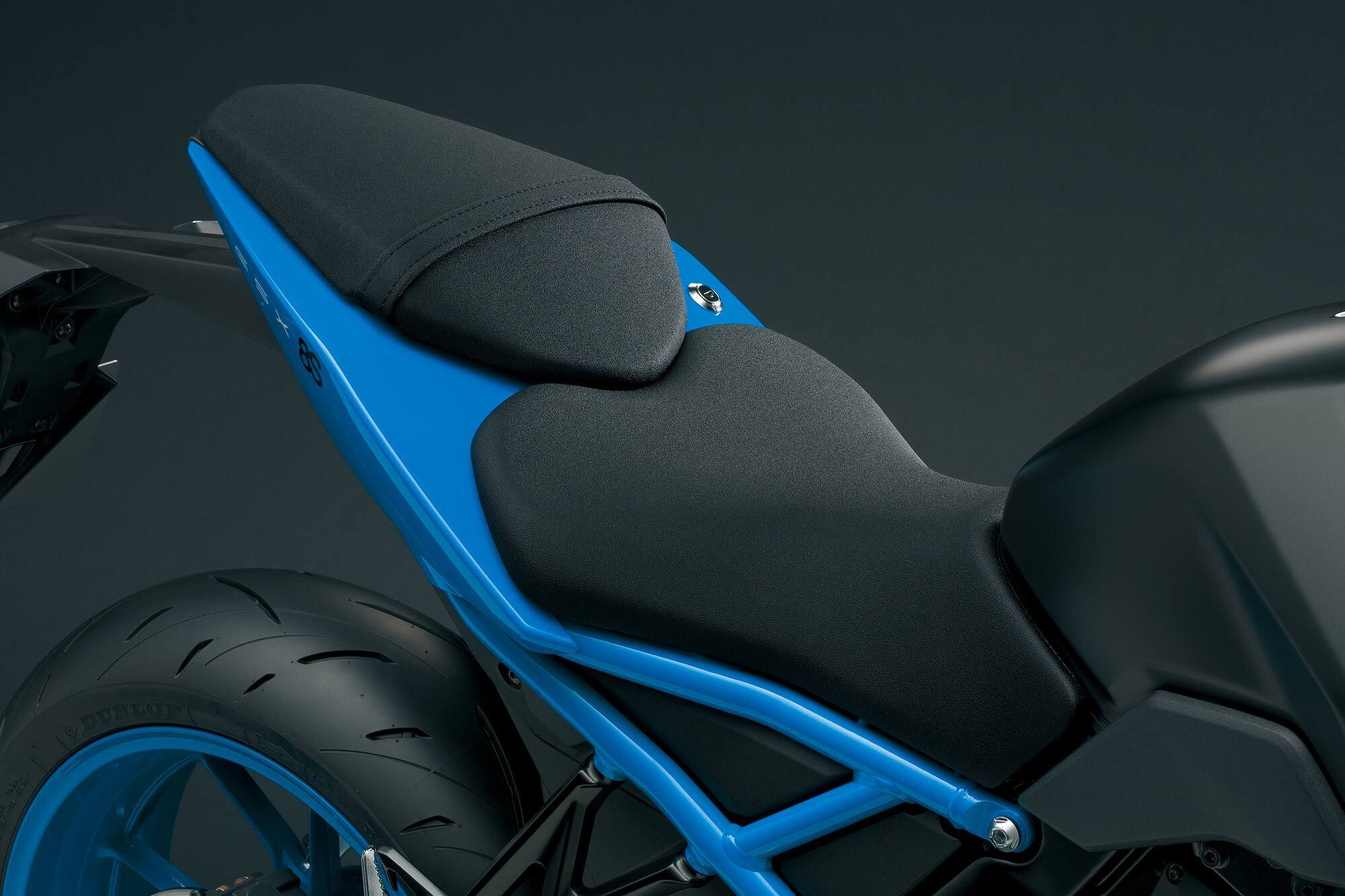

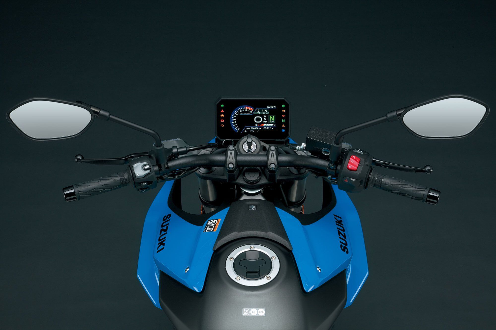

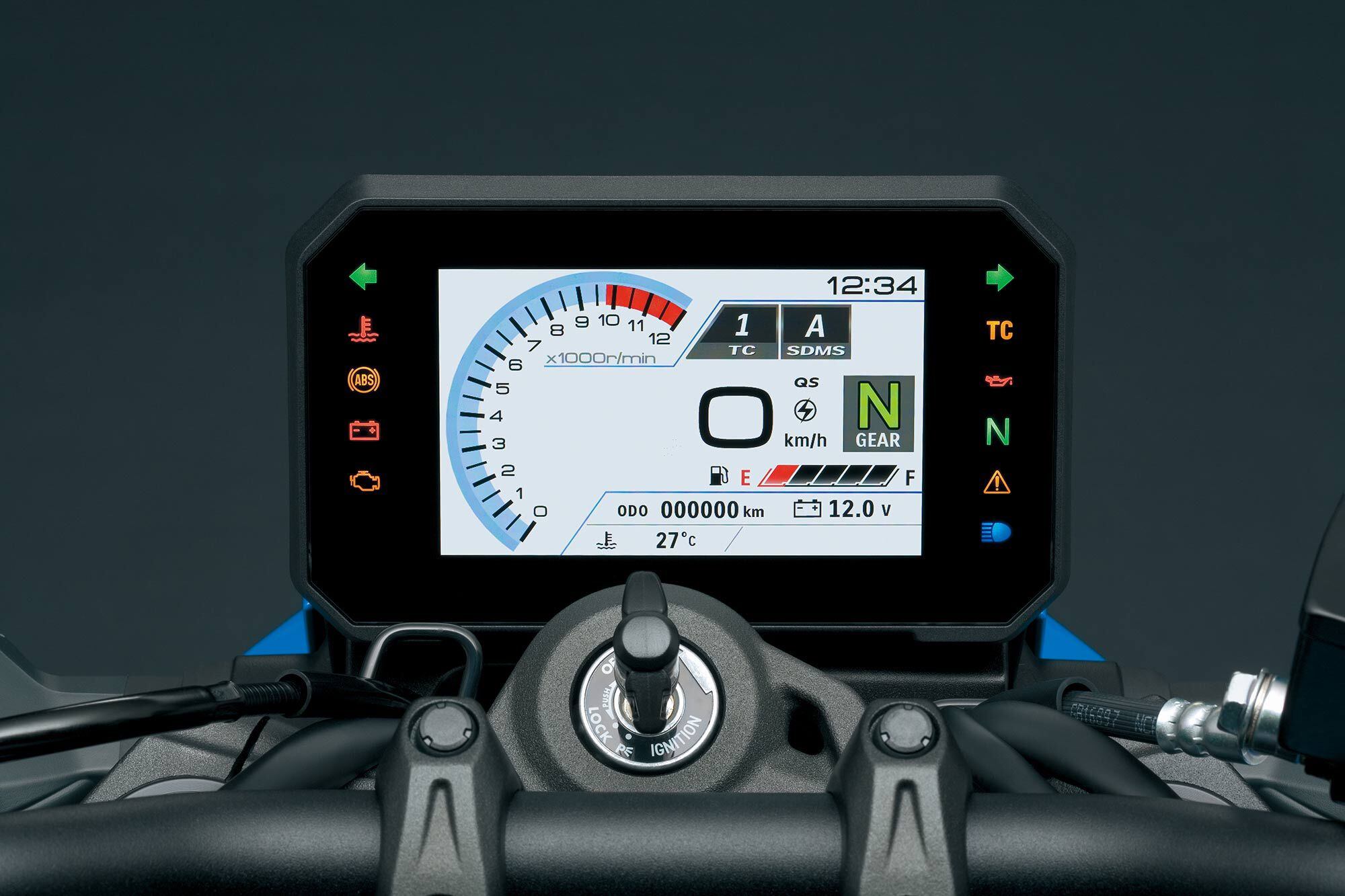

The rider’s view is dominated by a 5-inch TFT dash, with a choice of day or night modes and an adjustable gear-change indicator, with bar-mounted controls to access the menus and settings. At 31.9 inches, the seat height should make the GSX-8S accessible to a wide variety of riders.
Up front is an inverted KYB fork, and a pair of four-piston Nissin calipers.
Up front is an inverted KYB fork, and a pair of four-piston Nissin calipers. (Suzuki/)Out back is a preload-adjustable shock, while a twin-piston Nissin caliper handles braking.

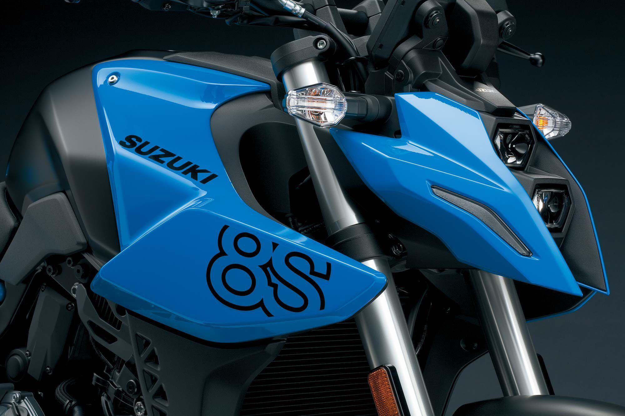

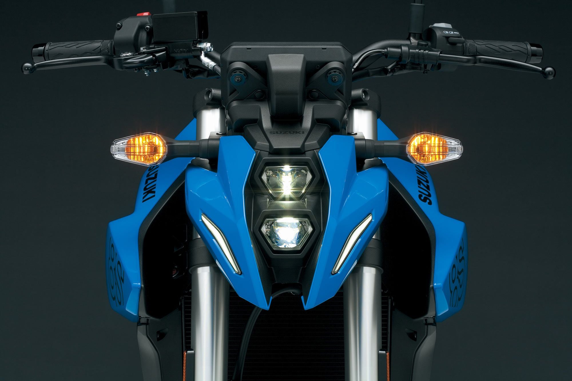

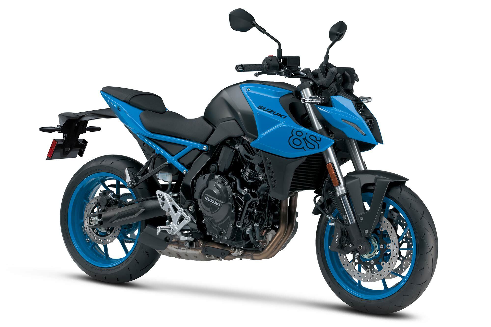

The bike’s styling is clearly influenced by the latest-generation GSX-S1000, with similar stacked LED headlights and bold, angular styling for the tank and minimalist tail unit. Three colors, white, blue, or black, are the 2023 options; the former pair are combined with blue wheels and seat subframes while the black version is color-matched throughout. Suzuki’s confidence in the styling is reflected by the relative lack of graphics, simply a Suzuki badge and a simple “8S” logo.

A closer look at the new TFT display.
A closer look at the new TFT display. (Suzuki/)Seat height is a reasonable 31.9 inches.

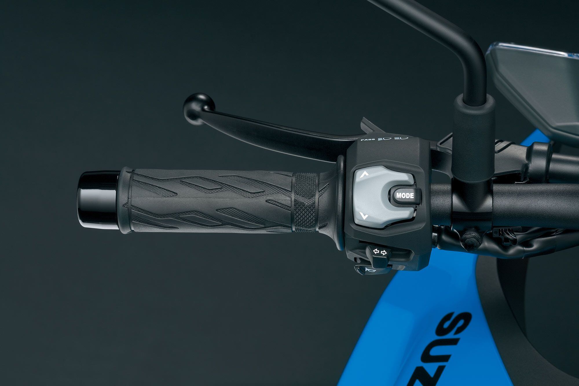

2023 Suzuki GSX–8S styline. (Suzuki/)View of the left handlebar switches to control the dash.
View of the left handlebar switches to control the dash. (Suzuki/)
2023 Suzuki GSX-8S Specs
MSRP: TBA
Displacement: 776cc
Bore x Stroke: 84.0 x 70mm
Compression Ratio: 12.8:1
Claimed Horsepower: 82.0 hp @ 8,500 rpm
Claimed Torque: 57.5 lb.-ft. @ 6,800 rpm
Fuel System: EFI
Clutch: Wet, multiplate
Frame: Steel backbone style
Front Suspension: KYB inverted fork; 5.1 in. travel
Rear Suspension: KYB shock, preload adjustable
Front Brake: Nissin radial-mount 4-piston calipers, 310mm discs w/ ABS
Wheels, Front/Rear: Cast-aluminum alloy; 17 in. / 17 in.
Rake/Trail: 25.0°/4.1 in.
Wheelbase: 57.7 in.
Ground Clearance: 5.7 in.
Seat Height: 31.9 in.
Fuel Capacity: 3.7 gal.
Claimed Wet Weight: 445 lb.
