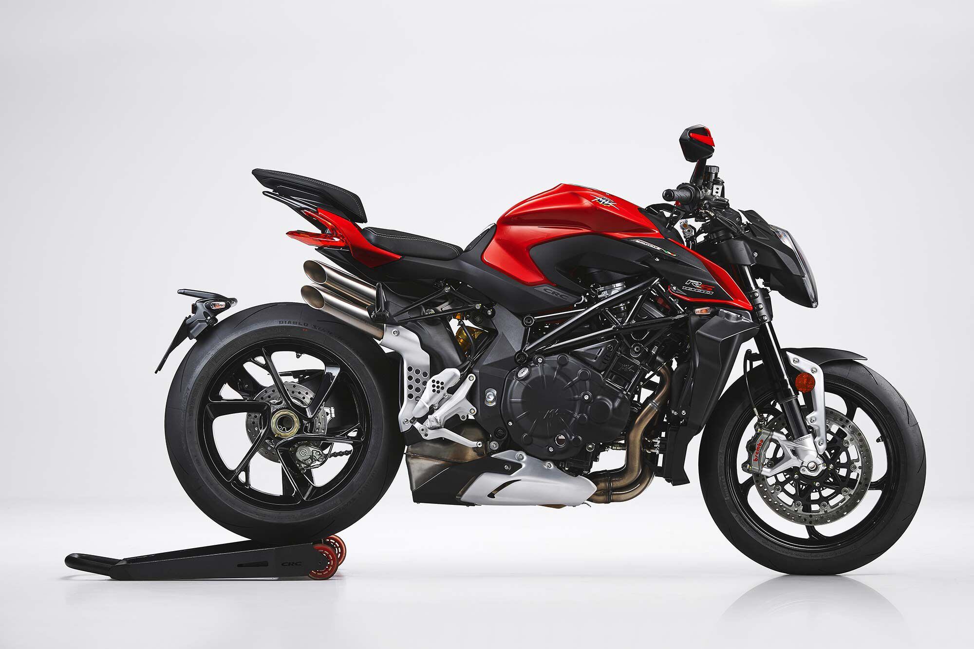

At a time when other OEMs are abandoning their inline fours, MV Agusta doubles down on their Brutale RR and RS by updating the engine with a new balance shaft.
At a time when other OEMs are abandoning their inline fours, MV Agusta doubles down on their Brutale RR and RS by updating the engine with a new balance shaft. (MV Agusta/)

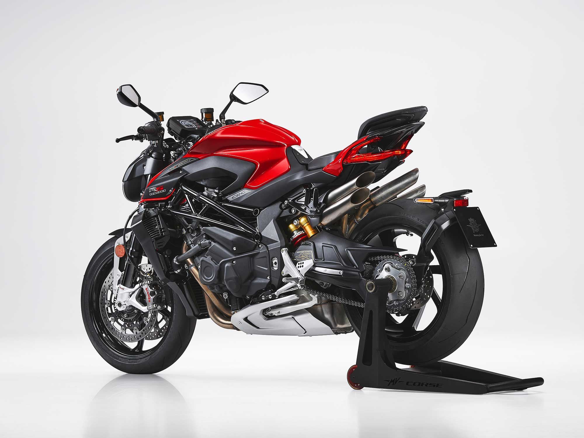

Along with the engine updates, the Brutale gets a new upswept four-pipe exhaust.
Along with the engine updates, the Brutale gets a new upswept four-pipe exhaust. (MV Agusta/)
In a time when so many manufacturers are abandoning inline fours due to tightening emissions standards, the 2023 Agusta 1000cc F4 engine is being evolved with the goal of making it one of the most refined and advanced engines of its type, both powerful and smooth. Both the 2023 Brutale 1000 RR and RS will use the new engine. In addition, both bikes have received minor aesthetic updates, most notably the new high-mount four-pipe exhaust.
