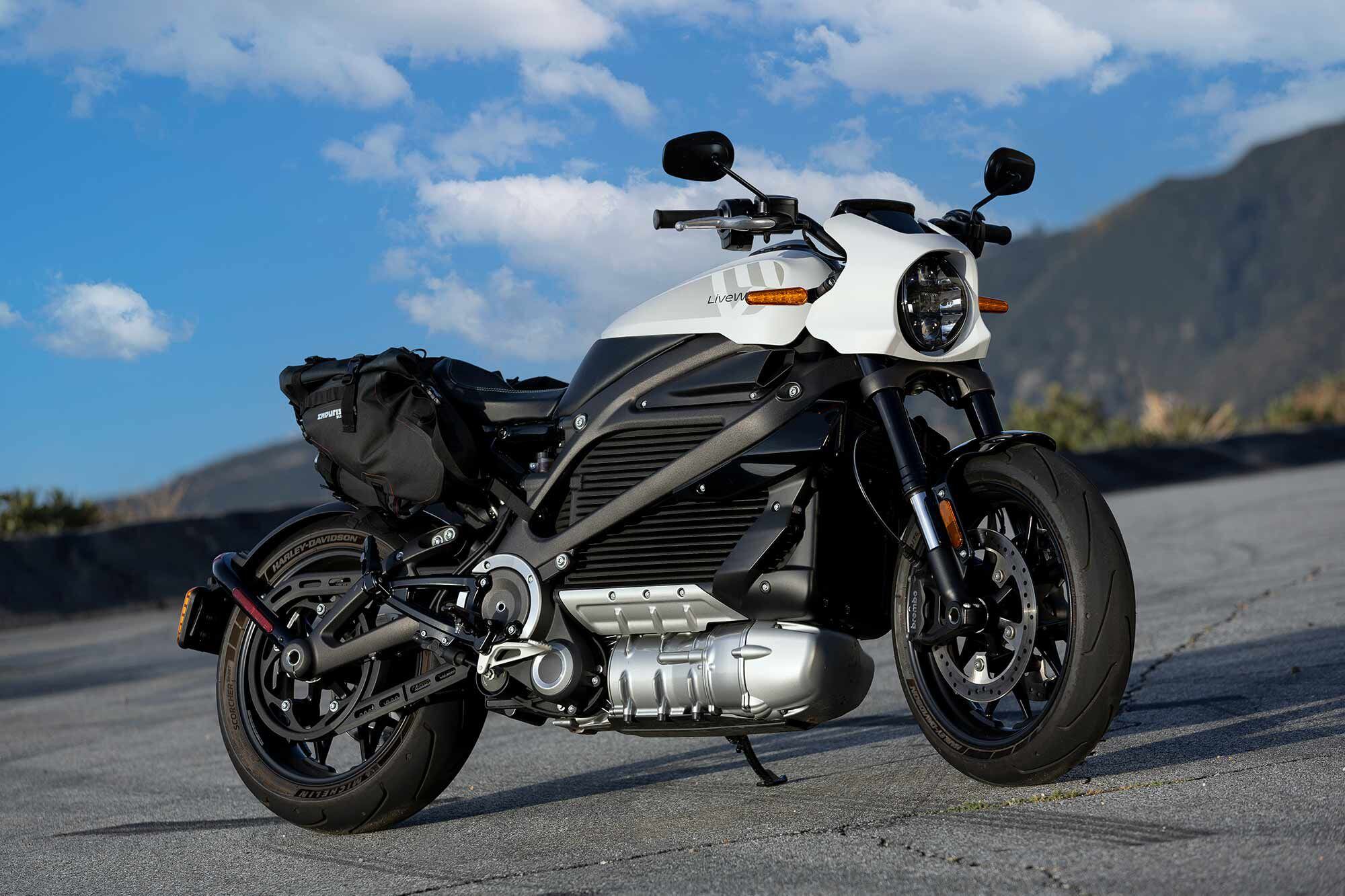

LiveWire claims the 15.4kWh battery can provide 146 miles of in-city riding power.
LiveWire claims the 15.4kWh battery can provide 146 miles of in-city riding power. (Adam Campbell/)
So here’s the thing: LiveWire claims the LiveWire One gets 146 miles of in-city range and 95 miles in mixed highway/city riding, although those numbers are greatly affected by factors like temperature, wind, and elevation changes. The company also claims the bike can fully recharge in as little as 60 minutes. So the bike is a known, or at least knowable, quantity.

The LiveWire One, or LW1, is essentially a naked electric sportbike. Ergonomics are not terribly aggressive, but with rearsets and low bars, the rider leans slightly forward over the not-a-gas-tank. A small cowl surrounding the headlight is all but aesthetic and does little to shield the rider’s body. A clearly laid out and highly customizable full-color 4.3-inch LCD screen serves as the bike’s instrumentation. Ride modes are clearly displayed and easily switched. The manufacturer suggests a retail price of $22,799.
The LiveWire is incredibly easy to ride and can change personality with the push of a button. There is no clutch, as there are no gears, or only one, depending on how you look at it. Sport mode gives the bike rapid acceleration; the One clocked our 0–60 mph test in 3.1 seconds every time without variation. Rain mode slows down power delivery and maximizes traction control. Eco and Road modes feel similar on acceleration, with a little more engine-braking in Eco. In any mode, throttle response is perfectly consistent and launches are predictable.

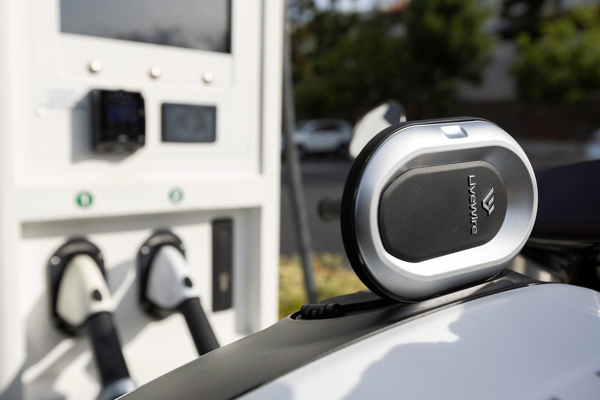

LiveWire claims the One can reach 80 percent charge in as little as 40 minutes, and a full charge in 60 minutes, which our testing confirmed.

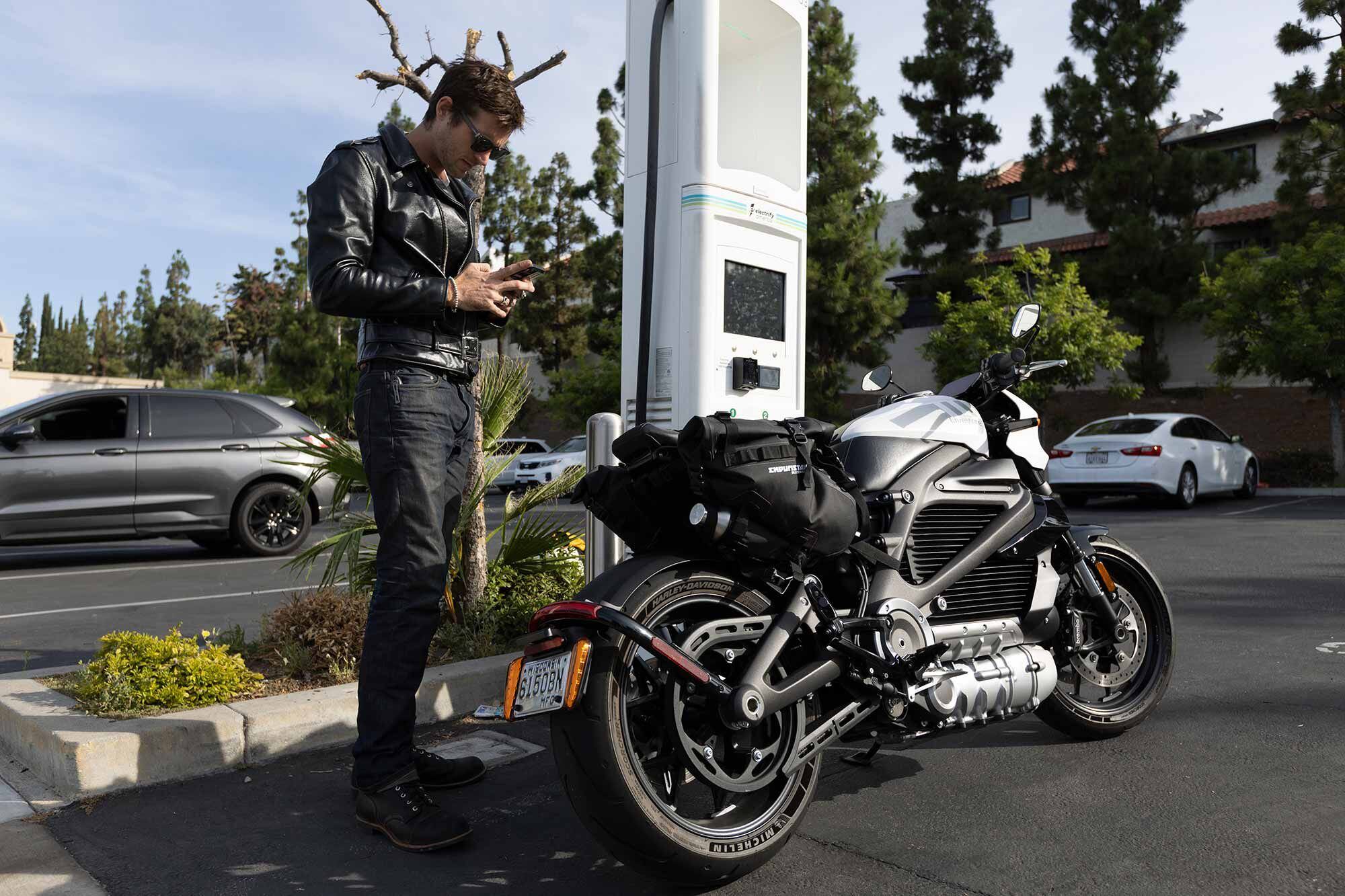

As I branched out and went for longer rides, I encountered the first harsh reality of EV ownership: Not all chargers are created equal. Many of them are very slow. Some don’t work at all. There are several smartphone apps to locate chargers, some of which feature reviews that let you know if they’re currently working or not, but you can ride to a location and use up whatever energy it takes to get there, only to arrive at a nonoperable charger.
Electrify America charging stations are often found in the parking lots of shopping centers and outlet malls.
Electrify America charging stations are often found in the parking lots of shopping centers and outlet malls. (Adam Campbell/)
I used a few different apps to try and avoid this. I downloaded PlugShare, A Better Route Planner (ABRP), and Electrify America’s app. ABRP is a navigation app that takes things like elevation changes and estimated range of your specific vehicle into account while planning your route. PlugShare is a user-based mapping system that shows where the chargers are and their current state of operation, but it’s based on user reviews and therefore not always current; it’s a bit of a gamble. Electrify America supplies many of the fast-charging stations along highways 1 and 101, and the company’s app updates as the units are in use. This last app was the most consistent and therefore the most trusted, but that was largely because of where I was going. On another highway, fast chargers from another manufacturer may be more common, making this app much less effective.

Charging is rarely, if ever, as simple as plugging in the bike and waiting. Charging errors were common until I developed a meticulous system that I had to repeat every time. I would pull into a charging station and first make sure that the charger and payment system were working as intended, no bashed screens or clogged ports. The most common failure among Electrify America chargers, I found, was broken card readers. Then I would turn the LW1 off completely and wait for the screen to go black. Once it was fully powered off, I would power it back on and wait for the screen to wake up, then plug in the fast charger and wait for communication with the charger to begin. Assuming this all worked, I could finally pay and charging would begin.
At this point I was using ABRP to plan my route, which suggested I leave Oxnard with a minimum of 64 percent state of charge and head to Santa Barbara 47 miles away. I cautiously charged the bike up to 95 percent before leaving. I was soon very glad I did, as I pulled into Santa Barbara with only 18 percent battery left. Cruise control was still locked at 65. Surprise, surprise: The Santa Barbara charger was in the parking lot of a bank across the street from a mall. I went to a familiar burger joint and got some onion rings and an iced tea to kill the time.

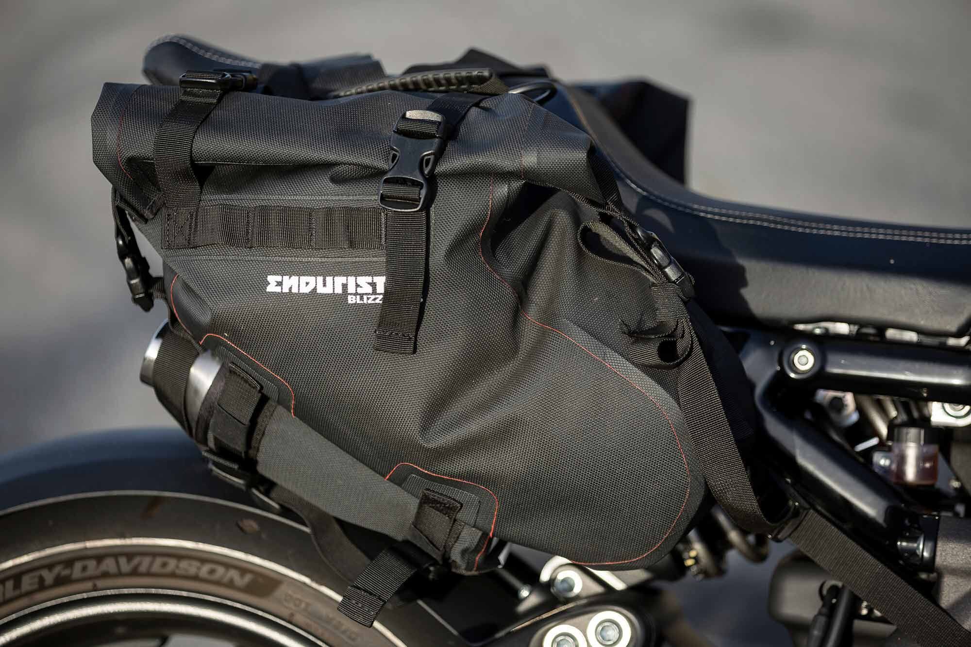

Blizzard saddlebags from Enduristan fit the LiveWire One like they were made for it and provided much-needed storage on our journey.
Blizzard saddlebags from Enduristan fit the LiveWire One like they were made for it and provided much-needed storage on our journey. (Adam Campbell/)

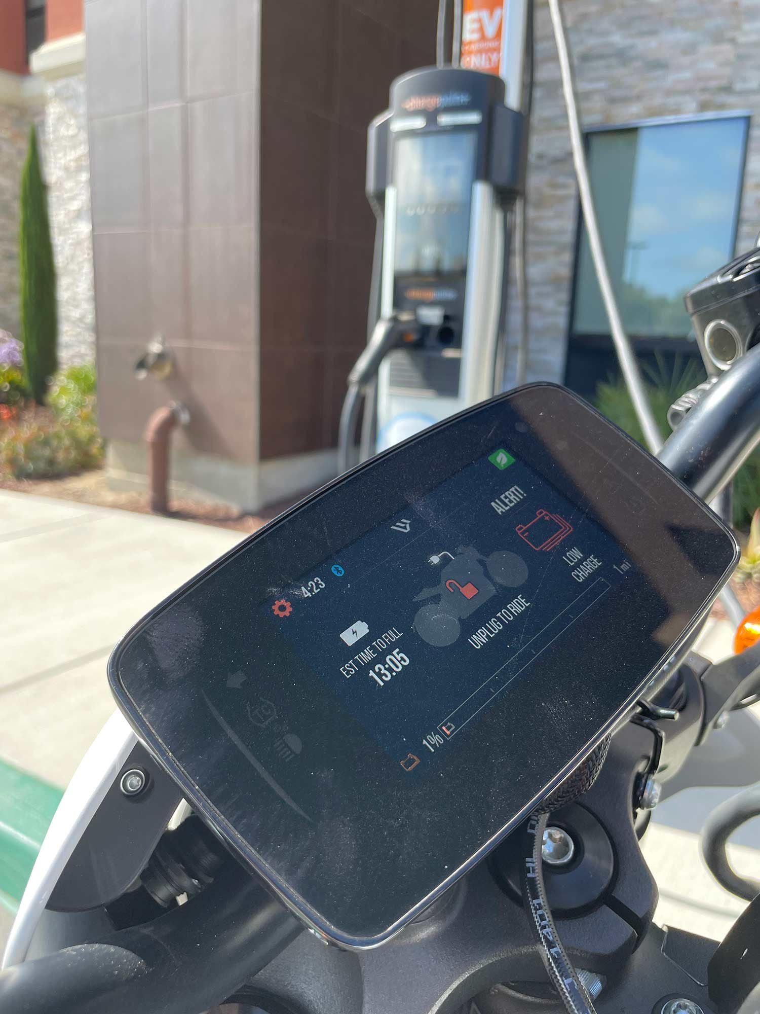

I had traveled 69 miles and had 13 to go, but the bike was displaying only 10 percent battery life remaining. If I didn’t make it to Pismo Beach, I’d be forced to find a wall outlet and spend hours waiting for the bike to even get enough charge to make it to a fast charger. I decided to turn around and head about 5 miles back into Santa Maria, where a slow charger is available outside of a Best Western.
Stuck outside of a Best Western with a nearly dead battery.
Stuck outside of a Best Western with a nearly dead battery. (Staff/)
It was now after 5 p.m. With only 1 percent battery, I pulled into the Best Western hotel and jumped through the hoops to start charging the bike. This was a very slow charger, estimating over 13 hours until a full charge. I waited 30 minutes until the bike had 9 percent and rode to a nearby fast charger I’d found in a Target parking lot. After another 59 minutes, the LW1 was at 93 percent. With 50 miles to my destination, I was confident it would be enough, so I loaded up and once again continued on my way.
I had been calling my uncles along the way, so they knew not to worry. They also knew I would be tired and frustrated, as anyone would after spending 10 hours on a three-hour journey. David opened up the garage and showed me to the wall charger, then handed me a beer. Bob had dinner in the oven. A fire was already burning in the fire pit out back. I showered, enjoyed the lovely company and the delicious meal, then slept like a damn baby. I should have double-checked the bike first.
When I woke up the next morning I immediately went to make sure the LiveWire had achieved a full charge. At some point in the night the garage circuit breaker had tripped and shut off current to the charger. I was at 30 percent, not enough to make it to the Pismo Outlets but enough to make it north to the fast chargers in Paso Robles. I was exhausted just thinking about another 10-hour day, but it seemed that’s what I was in for.
