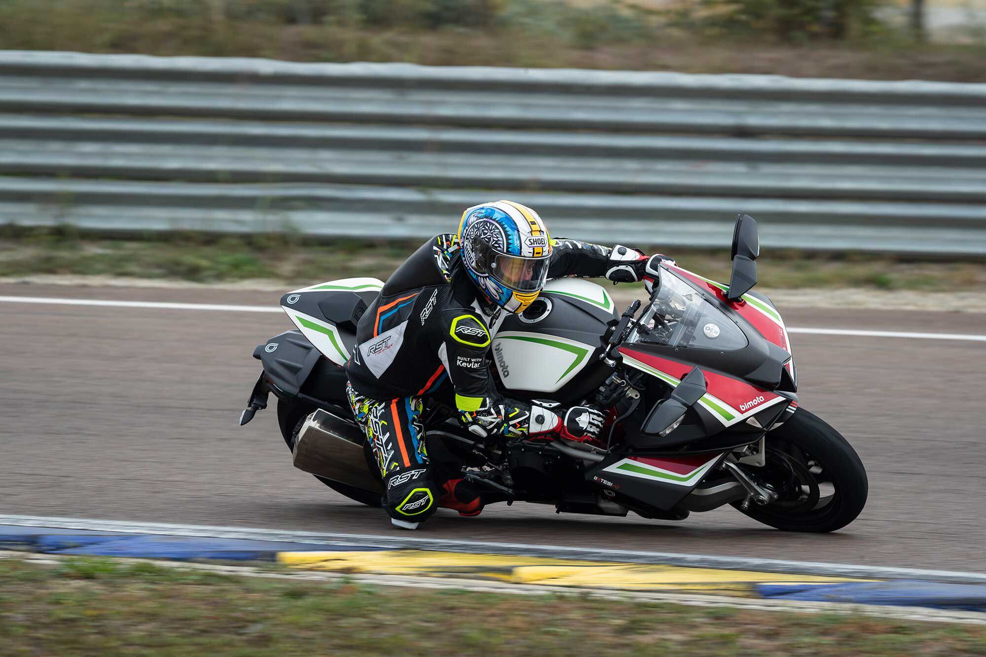

The Tesi H2 on track at Modena.
The Tesi H2 on track at Modena. (Ula Serra/Felix Romero/)
Because Kawasaki has already done all the work on fueling, electronic development costs, Euro 4 compliance, and so on, Bimota’s focus has been centered on what it does best: chassis and design. And the result is stunning.
Kawasaki has tweaked the motor since 2015 to comply with Euro 4 regulations but it’s still as fierce as ever, and I approached the first laps of the Modena test track in northern Italy with immense caution.
We’d ride the ‘22 bike, updated to Euro 4 spec but still as fierce as ever, at Modena, a fun track but much too tight for a bike bursting at the seams with excess horsepower. The track was damp initially, meaning the focus during the early laps was on bringing the carbon bodywork home in one piece. Immediately, though, it was obvious that the grip the Tesi H2 was generating from its Bridgestone RS1 tires was consistently high, far better than expected, with the traction control intervention effective. A mild fueling glitch aside, the 228 hp beast was actually easy to ride steadily.

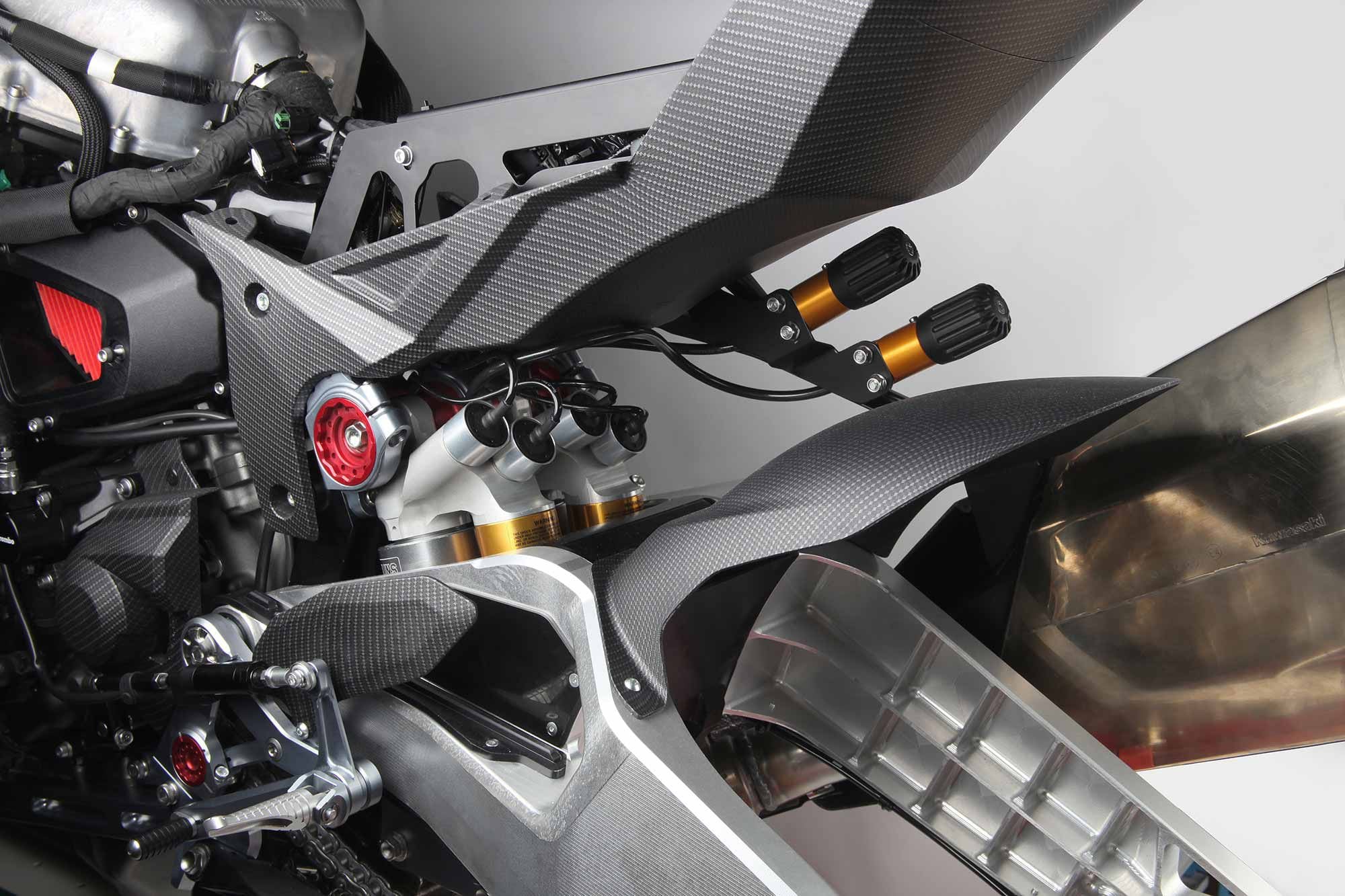

Tesi H2 rear swingarm with wheel dismounted, allowing a clear view of the fascinating side-by-side arrangement of the front and rear shocks.
Tesi H2 rear swingarm with wheel dismounted, allowing a clear view of the fascinating side-by-side arrangement of the front and rear shocks. (Ula Serra/Felix Romero/)

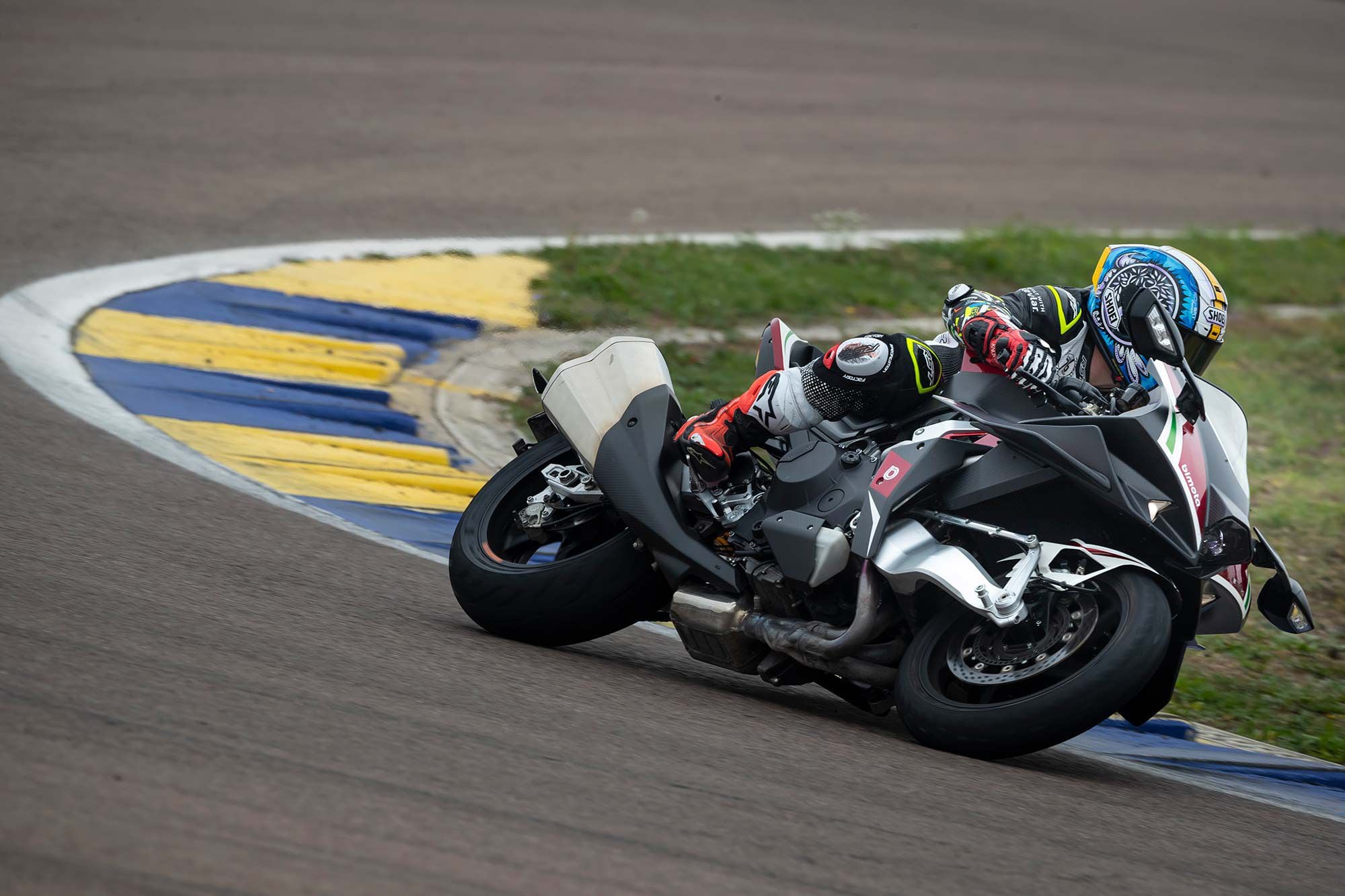

Tesi H2 brazenly shows off its undercarriage. Until you learn what to look for, hub-center front suspension often doesn’t look like it’s doing much at all. It is.
Tesi H2 brazenly shows off its undercarriage. Until you learn what to look for, hub-center front suspension often doesn’t look like it’s doing much at all. It is. (Ula Serra/Felix Romero/)
The way in which the chassis sits flat and responds to throttle, brake, and steering inputs takes some getting used to, and initially the front tire contact patch feels a bit vague. It doesn’t take long, however, to connect and trust the front-end grip rather than feel for it as one would with teles. Within a few laps, the Tesi started to feel natural and knees were dragged on the Ferrari test track with confidence.
By session two, with heat in the Bridgestone rubber and more track familiarity, the Tesi fully clicked. The weight advantage of the Bimota compared to the Kawasaki H2, plus a low center of mass allowed by the HCS, makes flicking the bike from full-lean left to full-lean right blissfully easy. Add a (theoretical) head angle far steeper on the Tesi, 21.3 degrees with 117mm (4.6 inches) of trail and 24.5 degrees and 103mm (4.1 inches) on the Kawasaki, and steering is sharpened  to the finest of points; the Tesi’s inch-perfect attack plan becomes deeply satisfying.
One might expect to feel beaten up by a 20-minute session with all those rampaging horses, but not so; even fast direction changes were surprisingly easy, while the Tesi flowed through Modena’s quicker sections with minimal input.
Braking, meanwhile, is very different from a conventional bike, despite the Tesi sharing the same Brembo Stylema calipers and 330mm discs as the Kawasaki H2. Stopping power is immense, but no matter how hard and late the braking, the Tesi stays flat. The front does not dive, the fork doesn’t run out of travel, and the rear does not lift, meaning braking can be left exceptionally late.

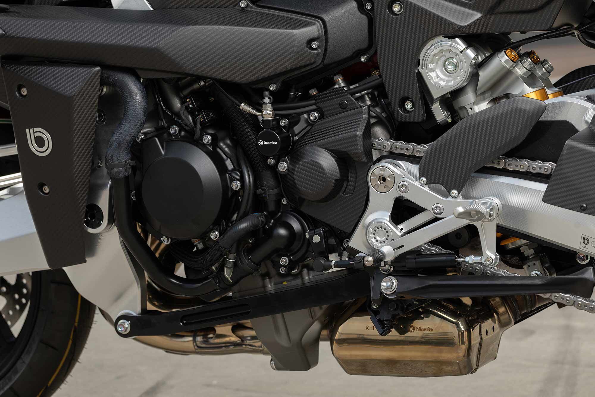

Kawasaki’s brutally supercharged H2 engine in elegant Bimota trim.
Kawasaki’s brutally supercharged H2 engine in elegant Bimota trim. (Ula Serra/Felix Romero/)
Kawasaki’s ABS system (KIBS) is present and correct and is linked to the IMU for lean sensitivity. Kawasaki’s engine-brake control is also carried over to the Bimota. The intervention of the ABS can be changed but not fully deactivated. On track on standard rubber, the ABS was evident but not too intrusive.
