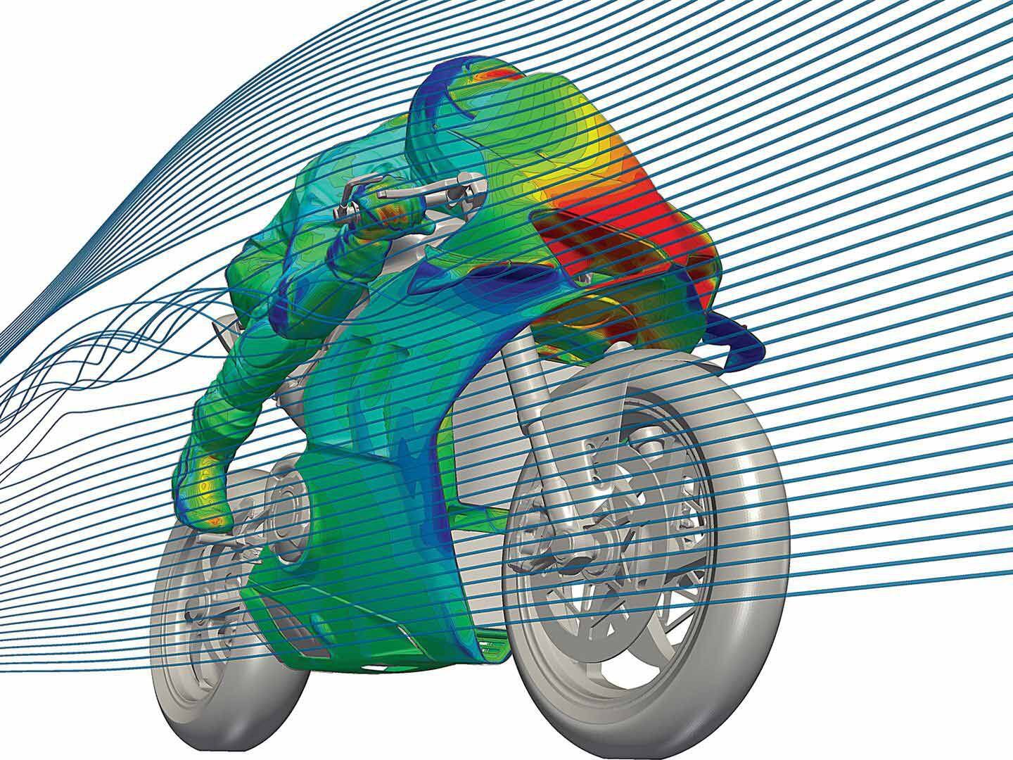

Compare that with the shape of a fish, which tapers smoothly inward all the way to its tail. The fish’s motion through the water pushes water radially away from its central axis, and must supply the force necessary for this push. But after the fish’s maximum cross section passes, the inward pressure of that displaced water acts on the tapering tail much as the grip of a wet hand causes an oval bar of soap to squirt out of its grasp. In effect, much of the energy used by the fish to displace water out of its path is recovered as that displaced water squeezes radially inward on its tapering tail. The result is quite low drag.
Streamlining is a lot more than just making a small hole through the air—it's also about making sure the air closes up back smoothly behind you.
Streamlining is a lot more than just making a small hole through the air—it's also about making sure the air closes up back smoothly behind you. (Ducati/)
