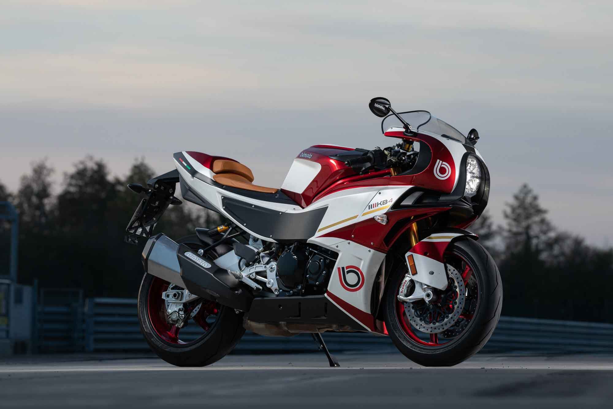

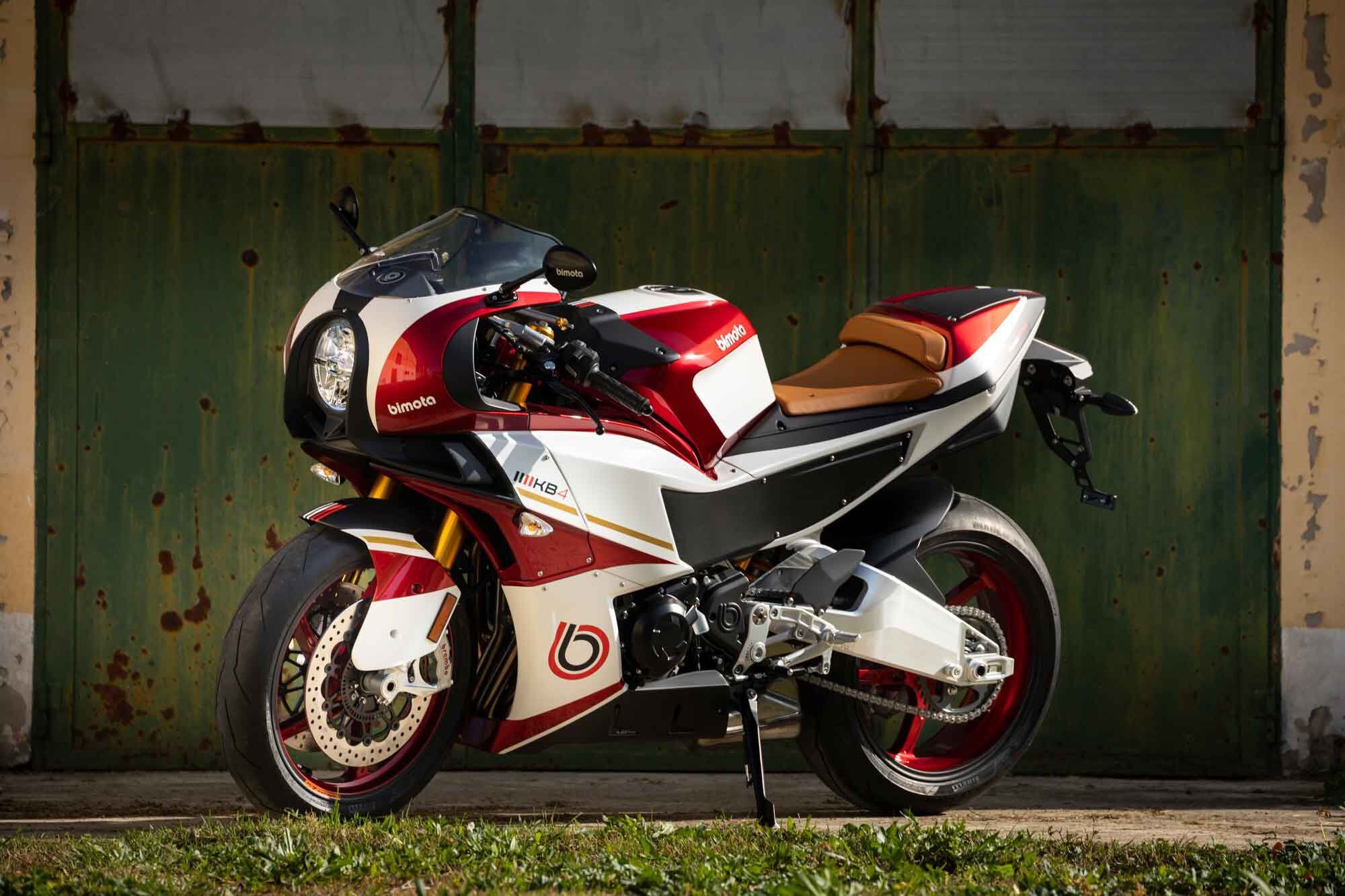

Quiz time, folks. When is a motorcycle with rapier-sharp steering geometry, a wheelbase shorter than a supersport ZX-6R, high-end Öhlins NIX 30/TTX 36 suspension, carbon bodywork, lightweight forged O.Z. wheels, adjustable footrests and ride height, and an extremely racy 53.6:46.4 weight distribution not a sportbike?
Answer: When it’s a Bimota KB4 “sport-tourer,” a seriously sharp piece of kit that the brilliant and enduringly off-piste Italian chassis specialists refuse to call an out-and-out sportbike.

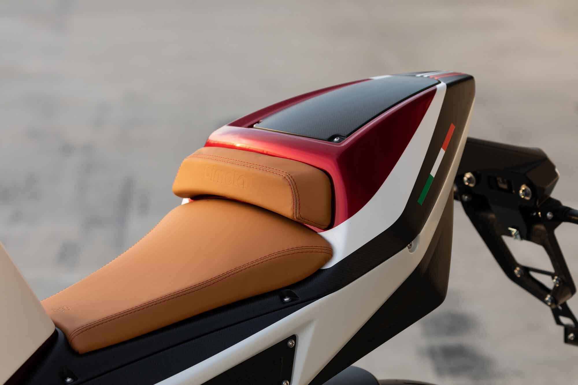

There’s also a soft leather (single) seat cover, which points more toward luxury than lap times and, I grant you, a riding position more chilled and upright than you might find on an uncompromising apex hunter.
Only a single seat is available for the KB4.
Only a single seat is available for the KB4. (Ula Serra/Felix Romero/)

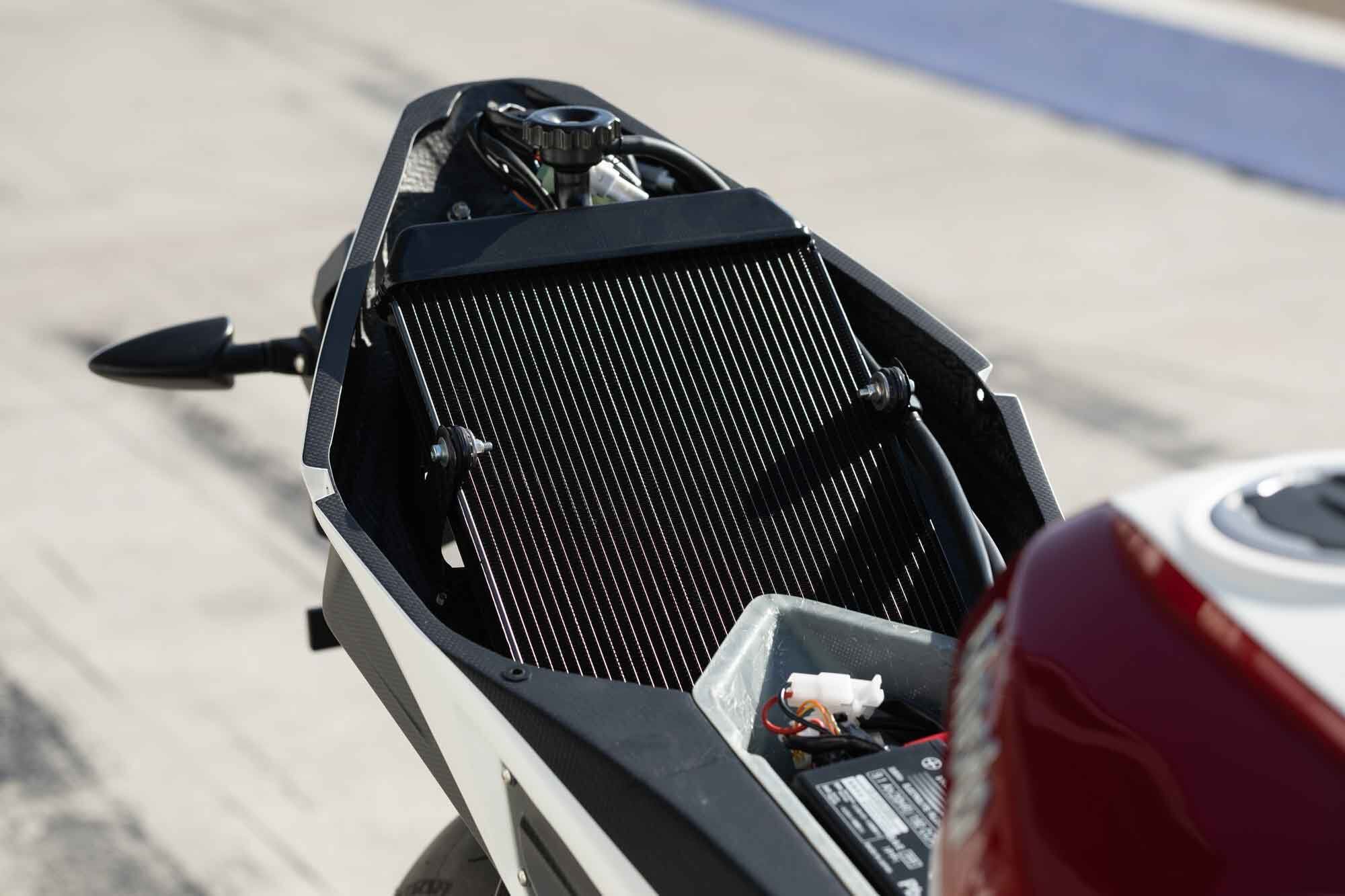

This, in turn, meant there was no room for a conventionally located radiator, which is why it was positioned under the seat unit and supplied cooling air via huge carbon ducts on both sides of the bike.
Tucked under the seat hides the KB4′s radiator.
Tucked under the seat hides the KB4′s radiator. (Ula Serra/Felix Romero/)

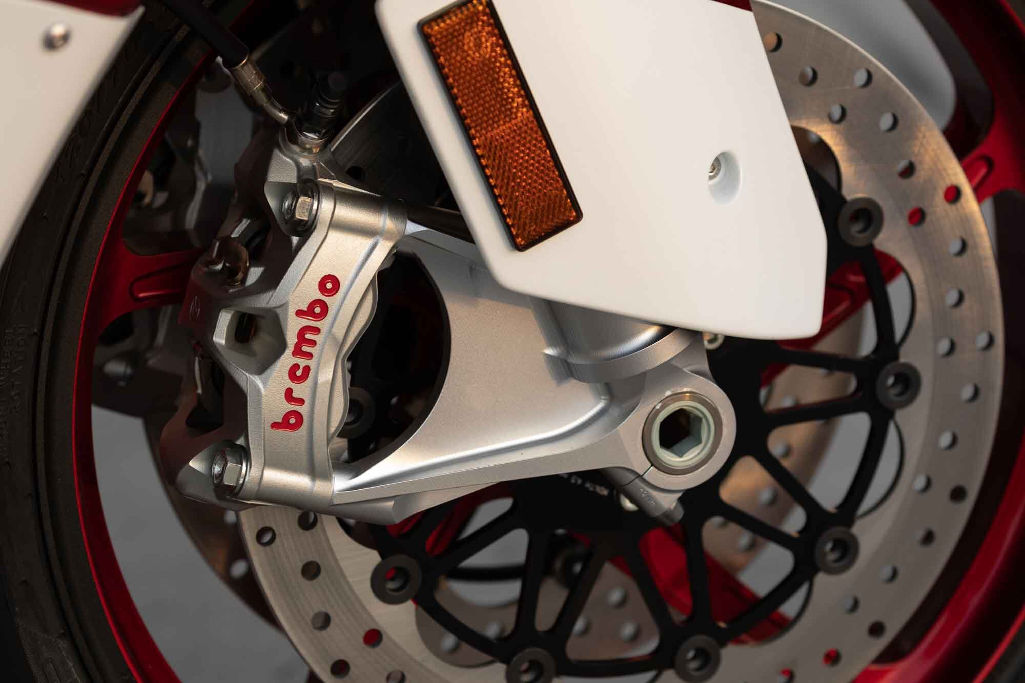

Lean-sensitive ABS is carried over from the Kawasaki but recalibrated due to the lightness of the Bimota. The KB4 also uses 320mm discs, which are 20mm larger in diameter than the Kawasaki’s, plus racy Brembo radial stoppers. On track, the ABS is a little too intrusive but for a sport-tourer it may well have market-leading stopping power.
Brembo radial calipers have top-shelf stopping power.
Brembo radial calipers have top-shelf stopping power. (Ula Serra/Felix Romero/)
