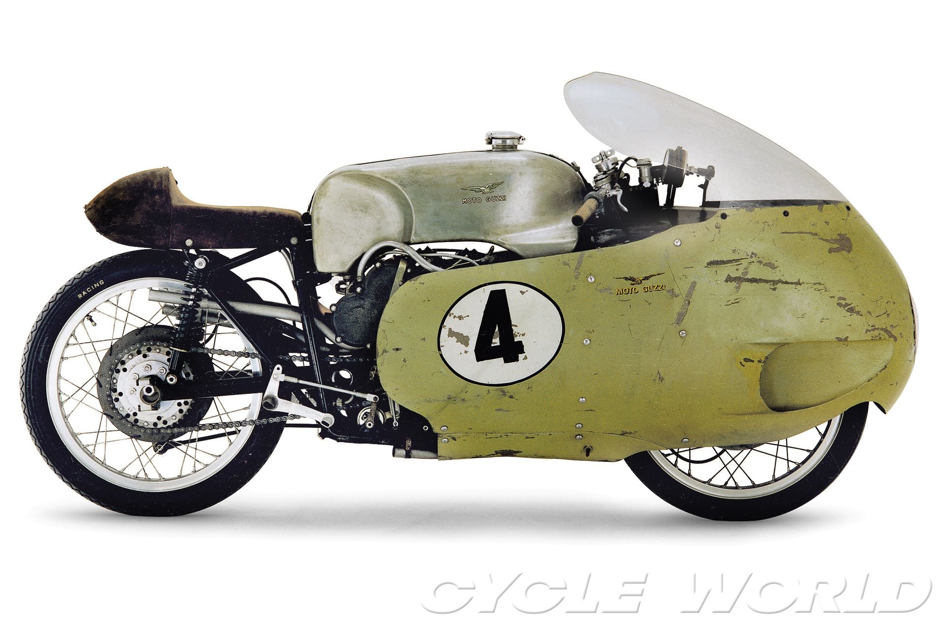

Guzzi was the pioneer in motorcycle aerodynamics then, using its wind tunnel to progress from an earlier “bird-beak” fairing with exposed front wheel to its introduction of full frontal enclosure in 1954.
Moto Guzzi V8 Grand Prix Racer.
Moto Guzzi V8 Grand Prix Racer. (Moto Guzzi/)
Prior to the TT, Guzzi factory rider Fergus Anderson asked Lomas to take over his entries in 350 and 500. On the 500 single he noted, “Normally when you shut off to slow down, [a] bike loses speed fairly quickly. The Guzzi streamlining was so efficient that when you eased off, the bike seemed to go quicker. This would take a lot of getting used to.”

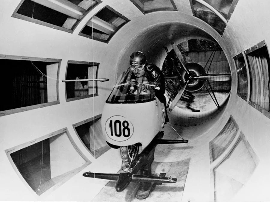

Guzzi had the advantage of being able to test in its own wind tunnel (its interior shown in photos pages 229, 230, exterior page 259) which supported the test article on a central post that may have been capable of stability testing at yaw angles other than zero.
Moto Guzzi’s wind tunnel.
Moto Guzzi’s wind tunnel. (Moto Guzzi/)
Why rehash all this history when relief from such antique boredom is just one click away? Because it shows that Guzzi could engineer stability into a full frontal fairing in the 1950s, and that its competition often did less well.

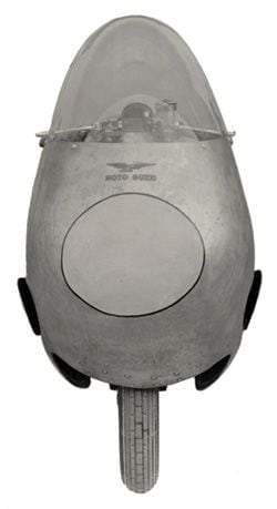

Was front wheel enclosure in the later 1950s a factory-only unobtainium anomaly? A photo (from Mario Colombo’s Moto Guzzi—the Complete History from 1921, page 83) of the 350 start at the 1956 Monza GP des Nations shows 28 starters, of which 21 are on bikes with “dustbin” full-enclosure front fairings. Guzzi pioneered their use in early 1954 and no team or rider wants to be left behind.
Colombo’s book notes on page 92, “In a short space of time all Grand Prix motorcycles, even those privately owned, sported a dustbin fairing. Not all were scientifically designed like the Guzzi models, which were tested in the wind tunnel, but the advantages were considerable for everybody.”
The front of Moto Guzzi’s V8 Grand Prix Racer.
The front of Moto Guzzi’s V8 Grand Prix Racer. (Moto Guzzi/)
He later notes, “At the end of 1957 dustbin fairings were abolished by a new regulation, since the steering difficulties at high speeds were really considerable…”
Yes, they were—at least for MV’s “sugar scoop” fairing.
