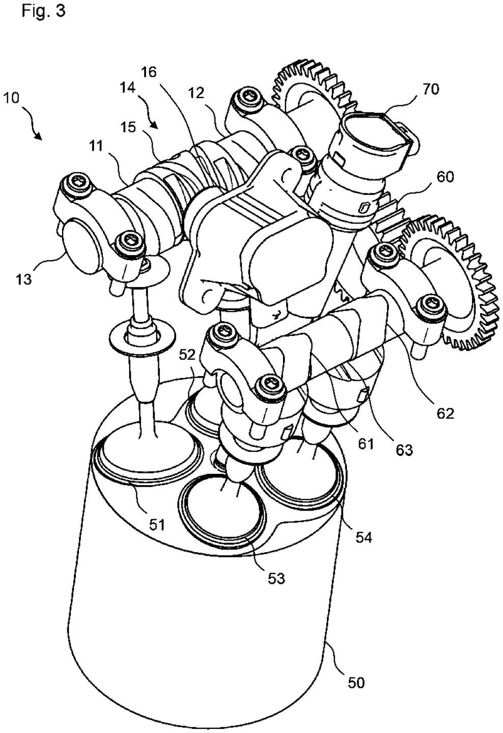

BMW ShiftCam patent drawings show solenoid in the middle of the intake cam, where it works on the spiral grooves to switch between low-speed and high-speed cam profiles.
BMW ShiftCam patent drawings show solenoid in the middle of the intake cam, where it works on the spiral grooves to switch between low-speed and high-speed cam profiles. (BMW/)

The principle is the same as other cam-switching VVT systems, the most famous being the Honda VTEC setup used on the VFR800 first in 2002 and on its cars for more than 30 years, but BMW’s method of achieving the effect—by sliding the camshaft to swap lobes—is unlike other brands’ solutions and unique in motorcycling. It’s achieved by having a slidable camshaft (on the R 1250, the S 1000 version has a slidable sleeve over a splined central section of the camshaft). The movement is controlled by solenoids that push pins into a spiral groove machined into the camshaft. When a pin is engaged, the spiral makes the shaft move to one side. The spiral groove means the cam lobes will swap over when the intake valve is closed, so there’s no chance of a mechanical clash of trying to change the timing during an inlet stroke.

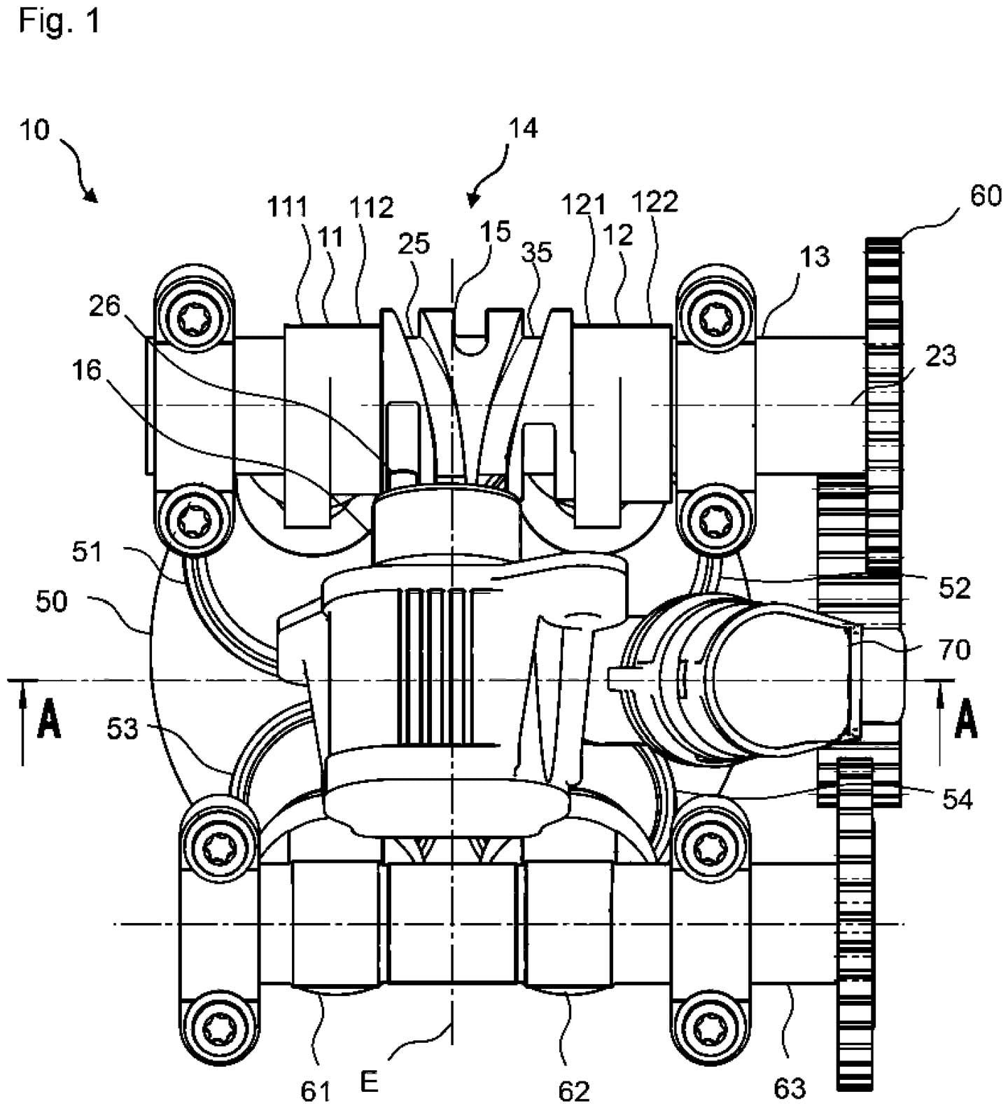

Top view of BMW’s new ShiftCam design for its single-cylinder engines shows the actuation grooves clearly. Also note the gear drive with idler.
Top view of BMW’s new ShiftCam design for its single-cylinder engines shows the actuation grooves clearly. Also note the gear drive with idler. (BMW/)

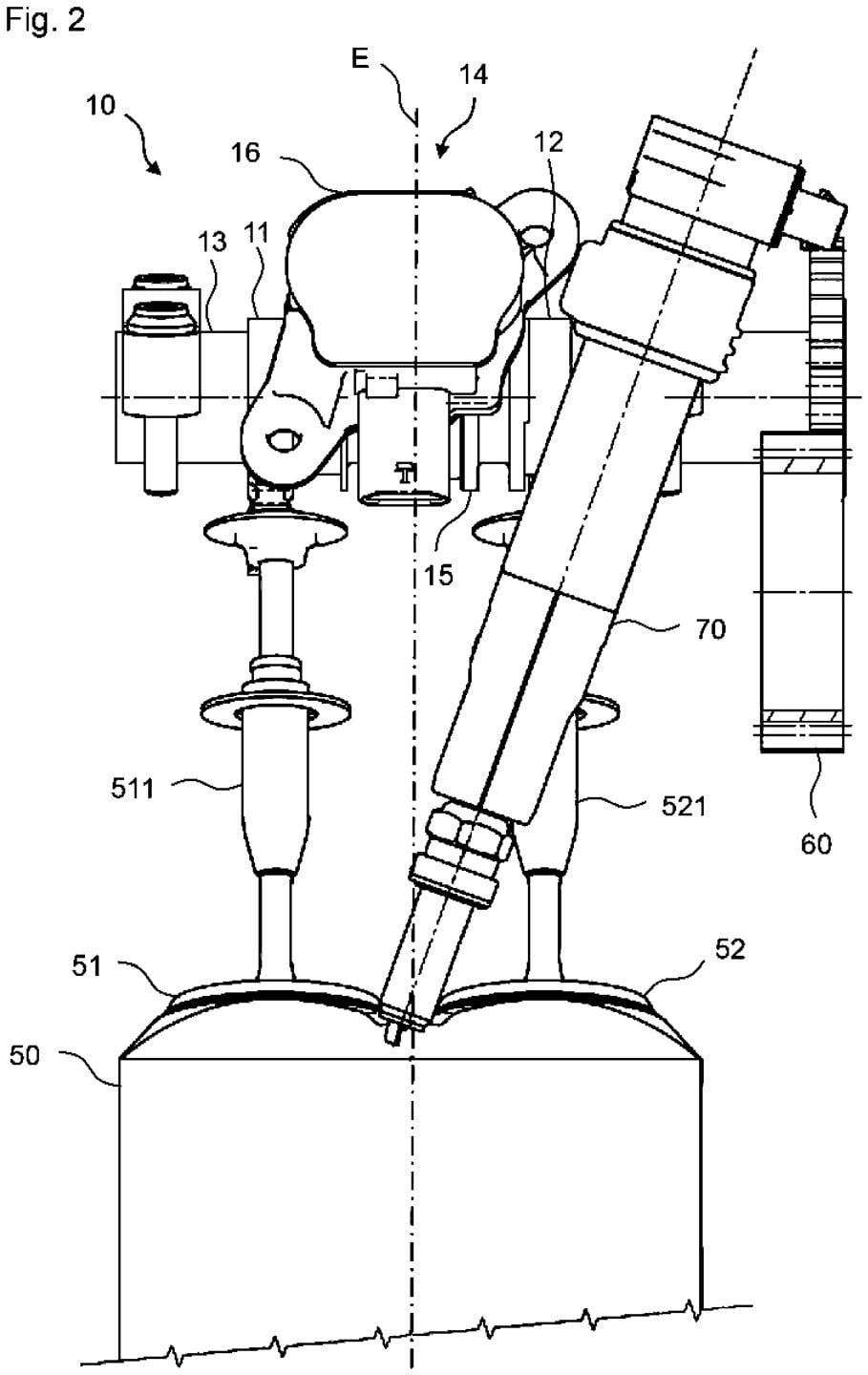

While the overall idea is the same as the ShiftCam system in the latest R 1250 and S 1000 engines, the single-cylinder in the new patent is more compact. It’s made smaller by fitting the solenoid actuator between the two intake valves—it’s a four-valve engine—so the camshaft doesn’t need to be any longer than a conventional design. Putting the actuator in the middle does mean the spark plug has to be fitted at an angle, and because the whole camshaft slides, there’s an additional idler gear connecting the intake and exhaust cams, rather than having a direct chain drive from the crankshaft to the camshafts.
With the solenoid and actuation spiral grooves at the center of the intake cam (rather than end mounted as on the R 1250 GS), the spark plug and stick coil must be angled for clearance, as this patent illustration shows.
With the solenoid and actuation spiral grooves at the center of the intake cam (rather than end mounted as on the R 1250 GS), the spark plug and stick coil must be angled for clearance, as this patent illustration shows. (BMW/)
