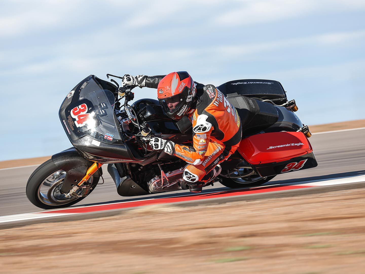

Bikes roll onto the circuit by 1:15 and in time-honored fashion, the two riders—brothers Kyle and Travis Wyman—do laps, come in, consult with crew, then do more laps.
At a point, one of the bikes comes in making a noise. There is consultation. Don’t think of this as a setback. Think of it as something the team infinitely prefers to discover here than in practice or race at Daytona. The purpose of being here is to ask difficult questions of what they’ve created, and maybe to get useful answers. This is definitely worth the cost of fuel (800 gallons!) to run the big truck the 1,800 miles out here and back. And to fly in 10 or more staff. Plus three journalists, myself among them.

Here comes team principal Jason Kehl with a little black suitcase—the borescope. Off with the tank, out with the rear cylinder’s spark plug. They ‘scope the inside of the cylinder and find nothing, replace plug and tank, and restart the engine. Diagnostics continue while the other bike continues to circulate.
Hot coffee comes, and sandwiches. I see laptops displaying multiple overlaid curves—normal trackside stuff. Suspension movement, throttle angle, oil temperature. Among all the obvious effects, where are the causes? There is screen-staring and discussion.
