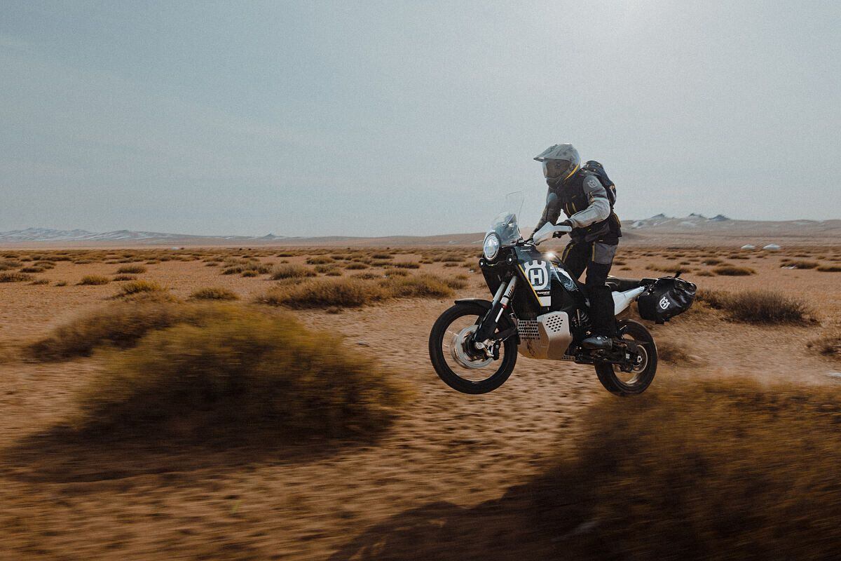

The 2023 Husqvarna Norden 901 Expedition promises more capability.
The 2023 Husqvarna Norden 901 Expedition promises more capability. (Husqvarna/)
For 2023, Husqvarna has added another member to its Travel range of motorcycles. Joining the 701 Enduro and the Norden 901 is the brand-new Norden 901 Expedition. While much of the core of the bike remains unchanged from the standard model, the Expedition comes equipped with upgraded suspension plus a load of standard accessories that equip the bike to set off on an adventure right from the showroom floor. The goal was to improve the Norden in terms of off-highway capabilities, while also stocking it up with comfort features to make the journey more enjoyable.

Top view of the 2023 Husqvarna Norden 901 Expedition. (Husqvarna/)2023 Husqvarna Norden 901 Expedition in action.
2023 Husqvarna Norden 901 Expedition in action. (Husqvarna/)Cockpit view of the 2023 Husqvarna Norden 901 Expedition.
