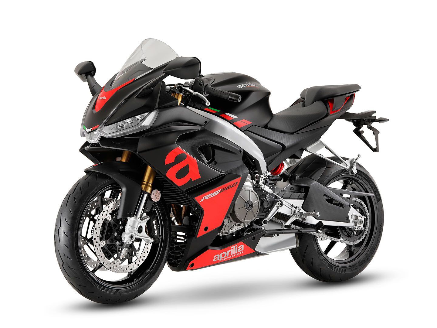

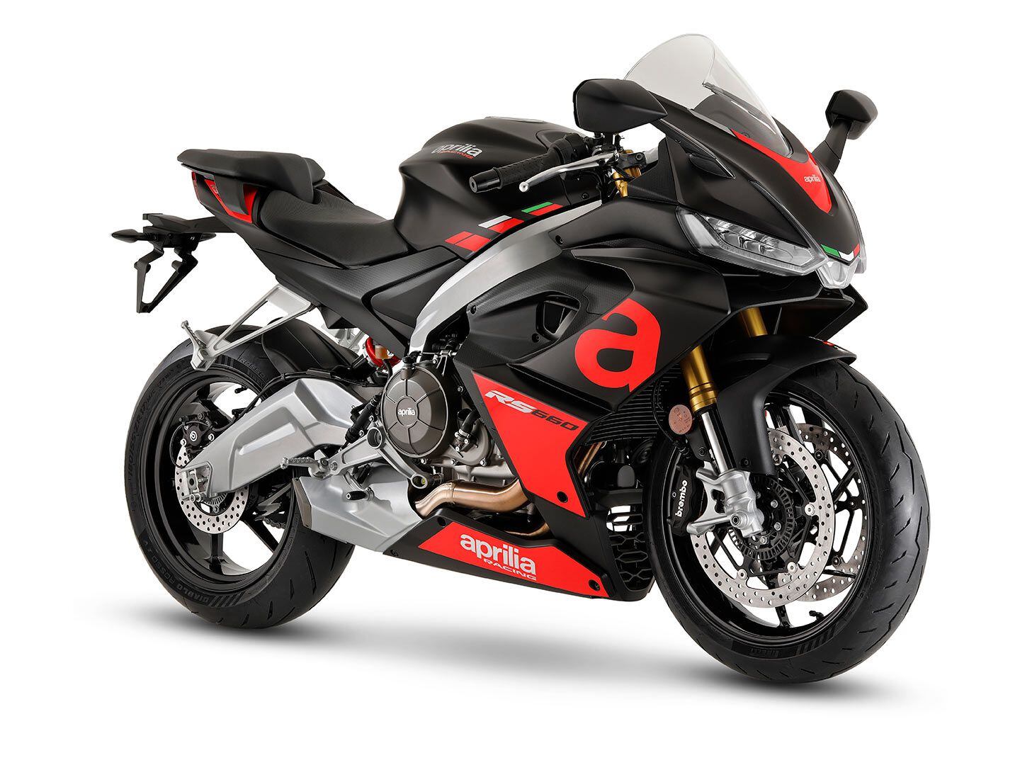

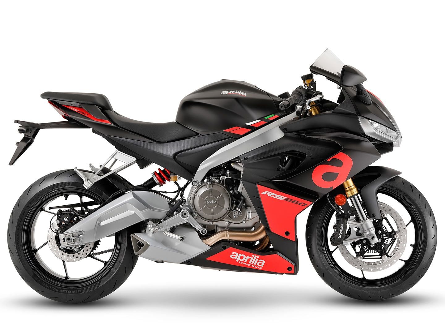

2023 Aprilia RS 660 in Racing Black.
2023 Aprilia RS 660 in Racing Black. (Aprilia/)

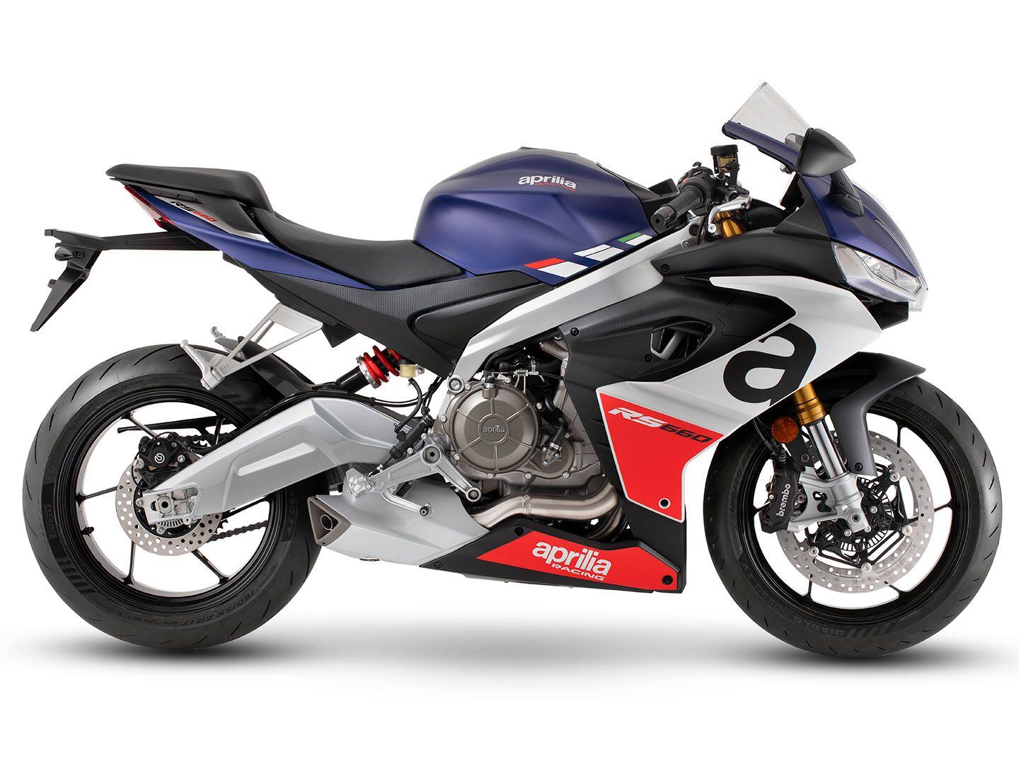

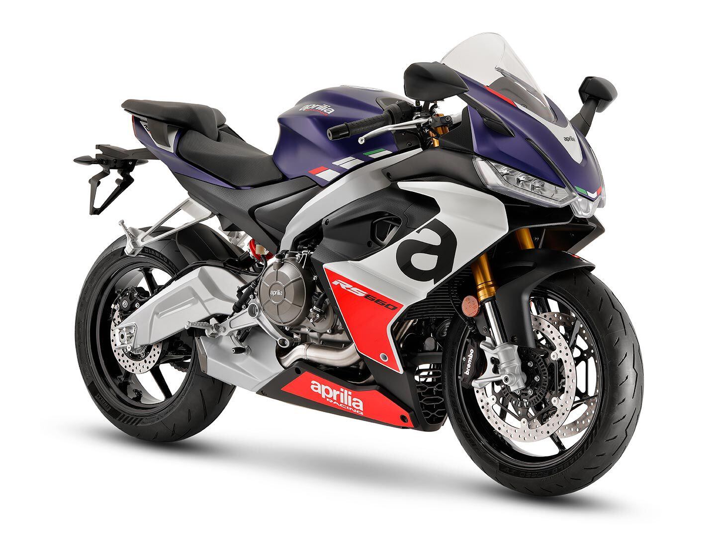

2023 Aprilia RS 660 in Aprilia’s Tribute colorway.
2023 Aprilia RS 660 in Aprilia’s Tribute colorway. (Aprilia/)
