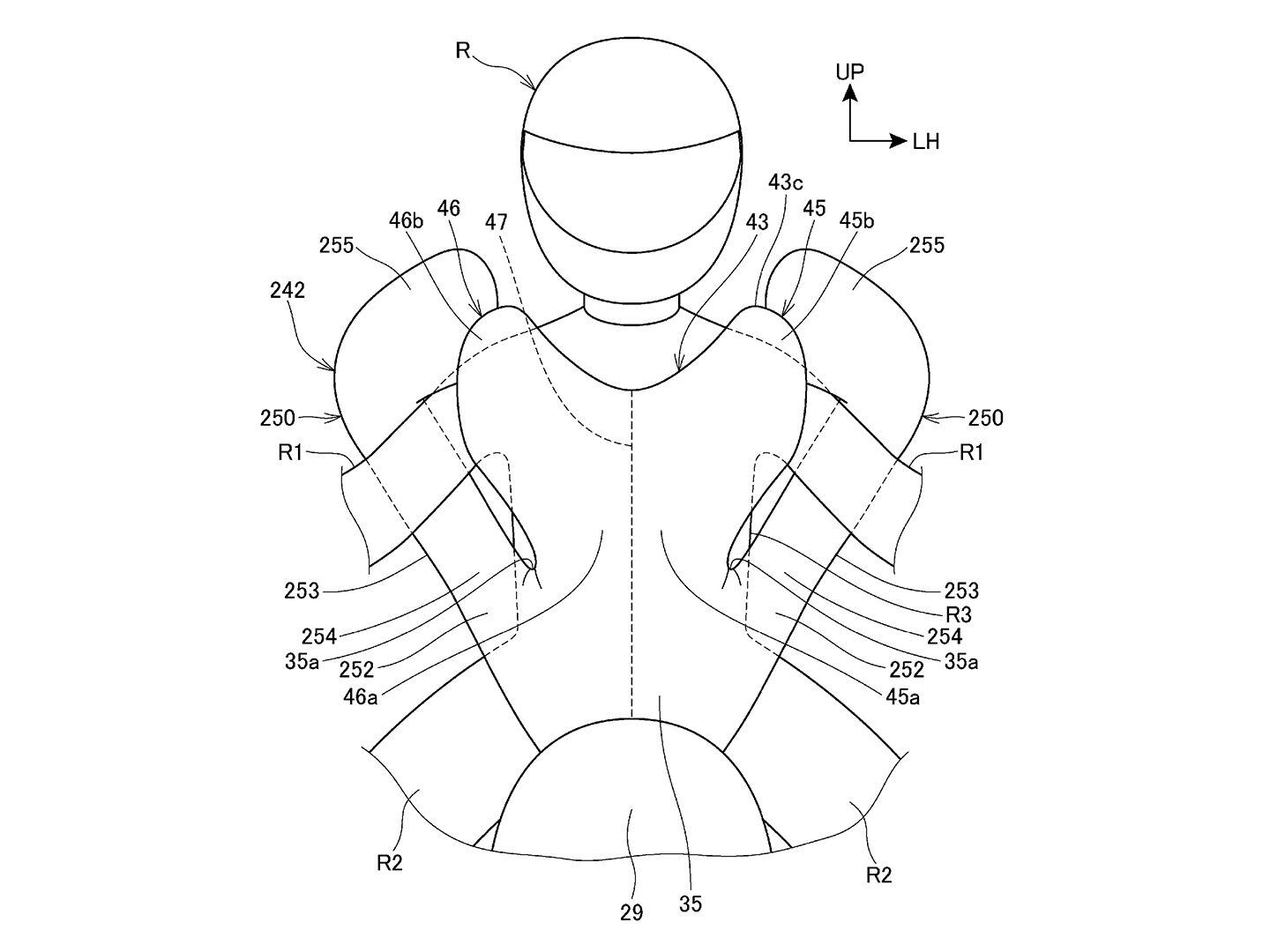

The second variation deploys from behind the rider and wraps forward around the torso, protecting the back.
The second variation deploys from behind the rider and wraps forward around the torso, protecting the back. (Honda/)
The second variant uses the same idea, but puts the airbag and inflator in the rear part of the seat, just behind the rider. From here, the airbag wraps forward around the rider, going under his or her arms and again protecting the chest, while an additional airbag section covers the rider’s back. Again, Honda has suggested several different designs for the shape of the airbag. This version looks both more effective in some respects, particularly the back protector element, and having the explosive airbag behind you rather than between your legs might be preferable…
