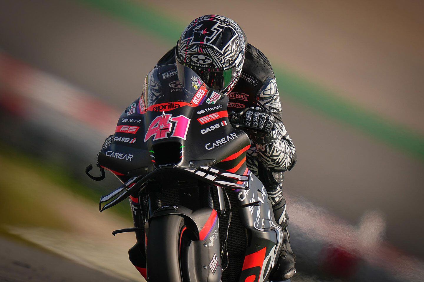

Aprilia’s efforts to smooth the surfaces at the front of its MotoGP racers includes smoothing the flow over fork legs and brakes.

Aprilia currently leads the way in reducing that disturbance by adding flow-smoothing fairings to fork legs and brakes. The blue-blazer boys of the FIM in years past were very strict in enforcing its 1958 rules, so this is something of a departure.

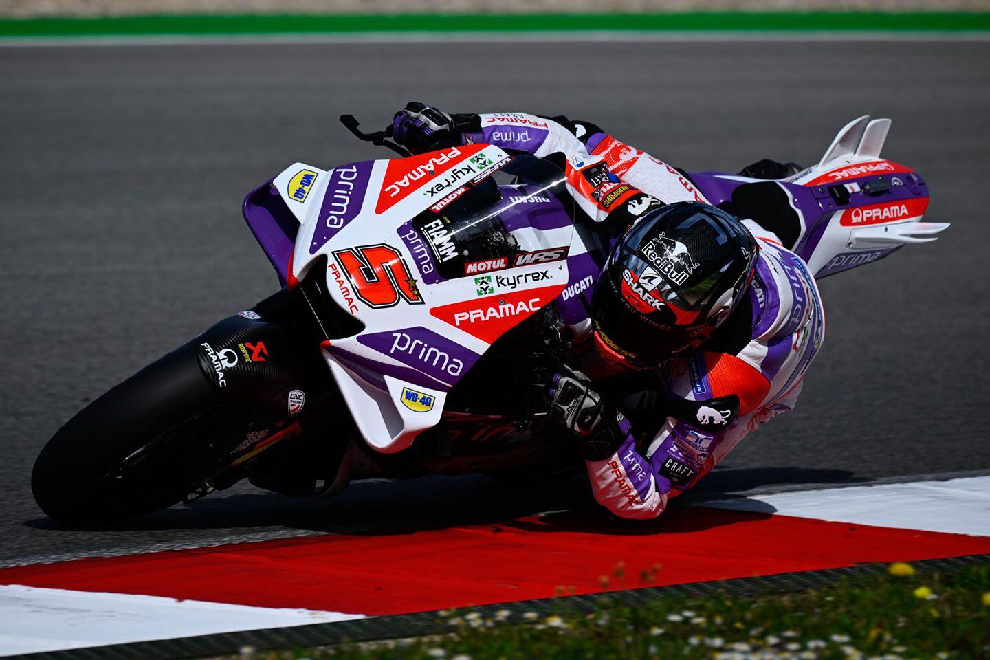

What of those stegosaurus vanes that are showing up on more than just the Ducatis in preseason testing?
What of those stegosaurus vanes that are showing up on more than just the Ducatis in preseason testing? (MotoGP/)
More than one team is now ducting air into the normally low-pressure region behind the front tire.
The “stegosaurus vanes” sticking up and slightly outward on some seatbacks are slotted airfoils whose purpose may be to waste competitors’ wind tunnel time or to guide some higher-energy air into the bike’s wake to prevent or reduce vortex shedding.
