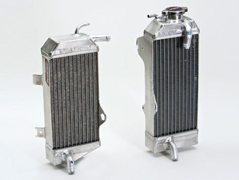

If you look at a modern automotive cooler, you will see that a number of closely spaced flattened tubes join two headers—an inlet header and an outlet header. Pressed onto these flattened tubes endwise are thin ribbons of sheet metal, such that the finished core presents many of these equally spaced thin ribbons edgewise to the airflow, providing the secondary surface mentioned above. Engine coolant, meanwhile, passes from the inlet header, through the many flattened tubes to the outlet header, and then returns to the engine.

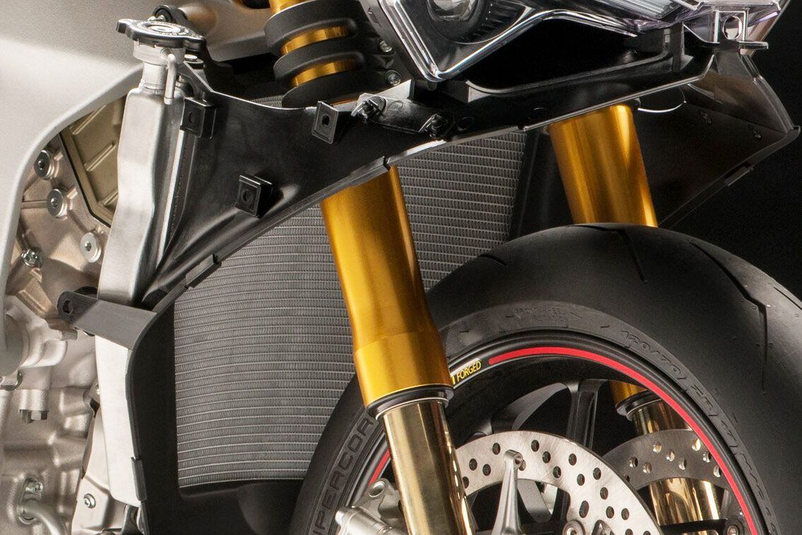

Thin, curved radiators (coolers) are now commonplace on sportbikes.
Thin, curved radiators (coolers) are now commonplace on sportbikes. (Ducati/)
