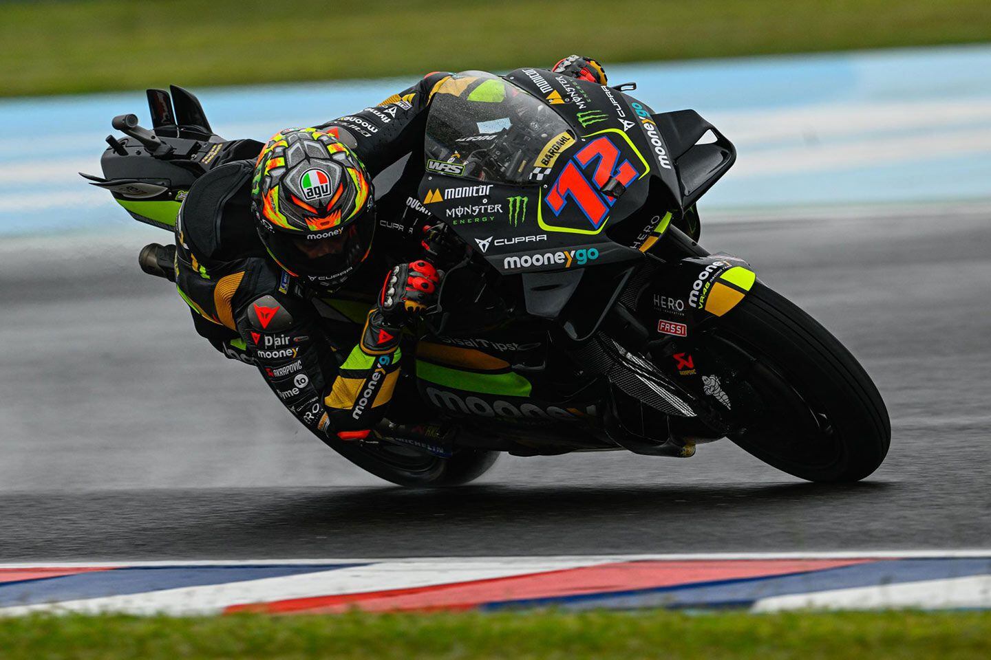

Marco Bezzecch gave Mooney VR46 it’s first-ever MotoGP victory, along with his first premier class win.
Marco Bezzecch gave Mooney VR46 it’s first-ever MotoGP victory, along with his first premier class win. (MotoGP/)

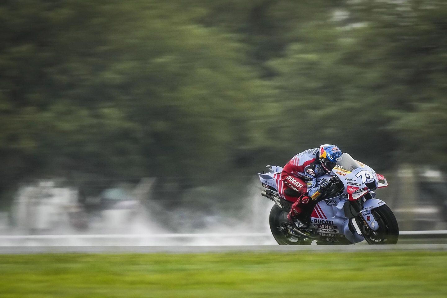

Lots of novelties appeared. Suddenly Franco Morbidelli was fast on his Yamaha, qualifying fourth on Saturday and finishing fourth on Sunday, while teammate Fabio Quartararo remained puzzled in the middle of nowhere. Again the Aprilias were promising—Maverick Viñales was second to then-series-leader Francesco Bagnaia in Saturday’s sprint race—only to come 12th on Sunday as highest-finishing Aprilia. Álex Márquez, now on Gresini Ducati after undistinguished seasons on Honda, is revealed as having real power, qualifying on pole and finishing third.
Álex Márquez finished on the podium in Argentina with a third place.
Álex Márquez finished on the podium in Argentina with a third place. (MotoGP/)

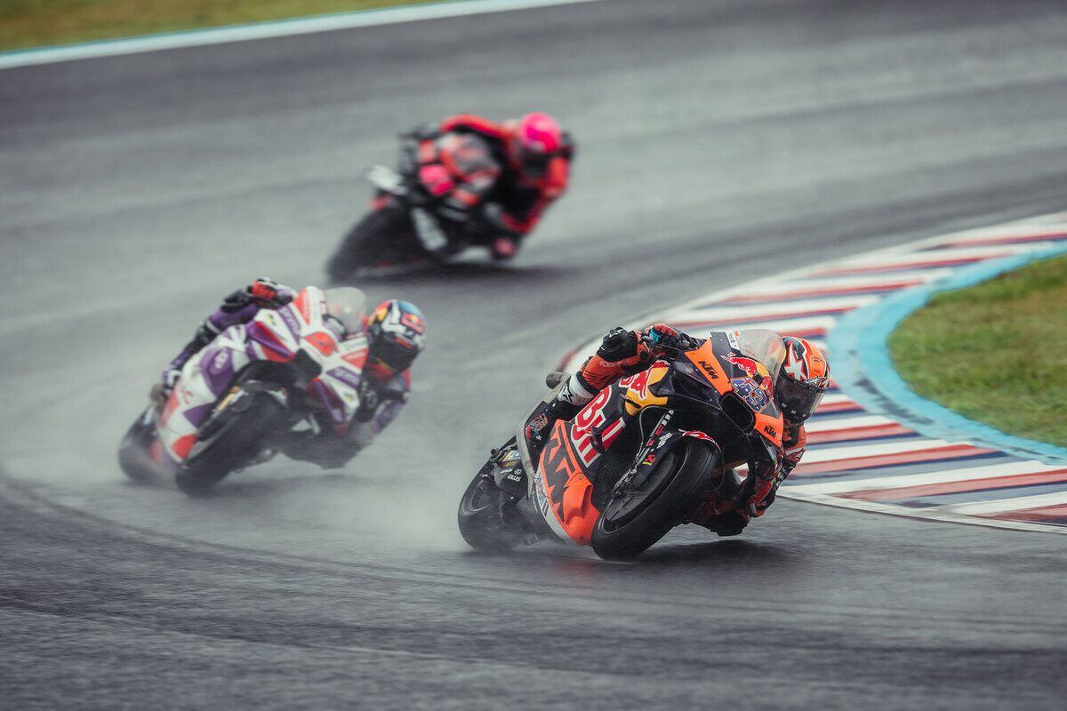

Jack Miller (who finished sixth) had this to say about his KTM: “We’ve made the bike quite a bit shorter. Our wheelbase is a bit longer than it was the last couple of years. But we’ve made it quite a bit shorter this morning; we probably could have gone another step in that direction. Just with the [weight] transfer you get, it’s so much better, a lot better drive.”

Visibility was often nil. Here’s Miller’s tale: “The visibility was shocking the first couple of laps. …the windscreen was filthy (sand from the track, which European riders called ‘dust’)…so you’re sort of sticking your head up down the straight, trying to see.
“After three laps into it I just hit a wall. I don’t know if I cooked the rear tire (all were on med/med wets)…on the drive part of the left-hand side. But I started having moment after moment.
“I tried to sort of scroll through my maps to understand if that was the issue.”
He tried adjusting the power up and down, adjusting the traction control.
“Then eight laps to the end it kind of came good again…was able to come back toward Jorge [Martín].”

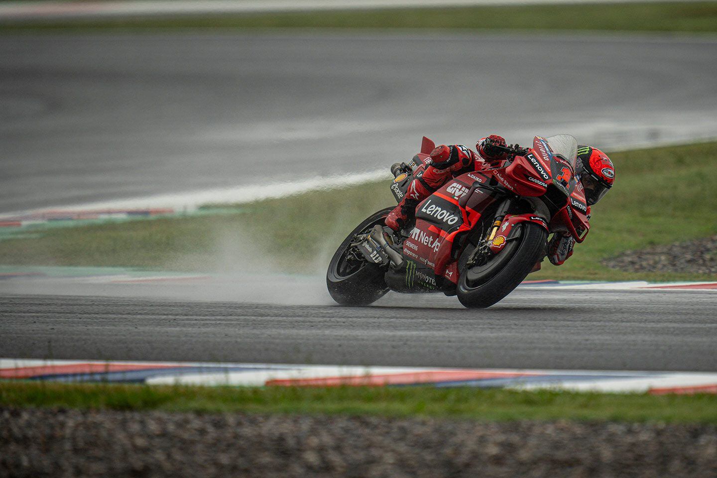

A crash on Sunday removed Pecco Bagnaia from the championship lead.
A crash on Sunday removed Pecco Bagnaia from the championship lead. (MotoGP/)
Bagnaia led the championship until his Sunday crash while second to Bezzecchi: “I had this kind of crash that you don’t understand.
“In those 16 laps I did the same maneuver [every lap] but in this lap I crashed. …normally when you lose the front it’s because you braked too much or you released the brakes too early. Today I lost the front touching the gas.
“I was just controlling the gap with Álex [Márquez, behind him]. I was pushing at that moment. I thought it was all under control but I was probably at the limit and ended up falling.”

Bezzecchi now leads the championship. He had no master plan but just used the strengths at hand to do his best—good enough to win. “…when I saw the rain this morning I was really sad because I said, ‘No, I was so good in the dry, for sure it will be difficult in the wet.’ But when I jumped on the bike this morning (in warmup) it was amazing. I started believing again and thought I could do this.
“Everything went well. It was a long journey.”
