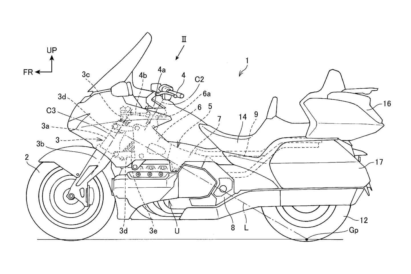

The firm has filed a patent application for a system that doesn’t aim to be quite as advanced as the entirely self-balancing Riding Assist concepts but uses the same technology to take the risk and effort out of pushing a bike. The Riding Assist bikes, which have since evolved into Honda’s most recent ESV (Experimental Safety Vehicle) based on an NM4 Vultus, balance using the same technique as trials riders when balancing on obstacles, moving the steering left and right to fractionally shift the bike and keep the center of gravity directly above the contact patch with the ground.
Honda’s patent is aimed at helping maintain balance while pushing a bike from the side.
Honda’s patent is aimed at helping maintain balance while pushing a bike from the side. (Honda/)
While Honda has proved it can use this system to make a bike completely self-balancing, the patent document shows a more modest version of the idea that aims only to make sure that the weight that the rider is supporting while pushing it doesn’t become too much to hold up. The main component is a steering actuator that’s already been the subject of several patents relating to the next-generation Gold Wing and other models. Honda has plans to use this servo system for a variety of rider assistance systems, including lane-assist and obstacle avoidance. The idea in the latest patent is less ambitious than some of those goals but much more achievable in the short term.

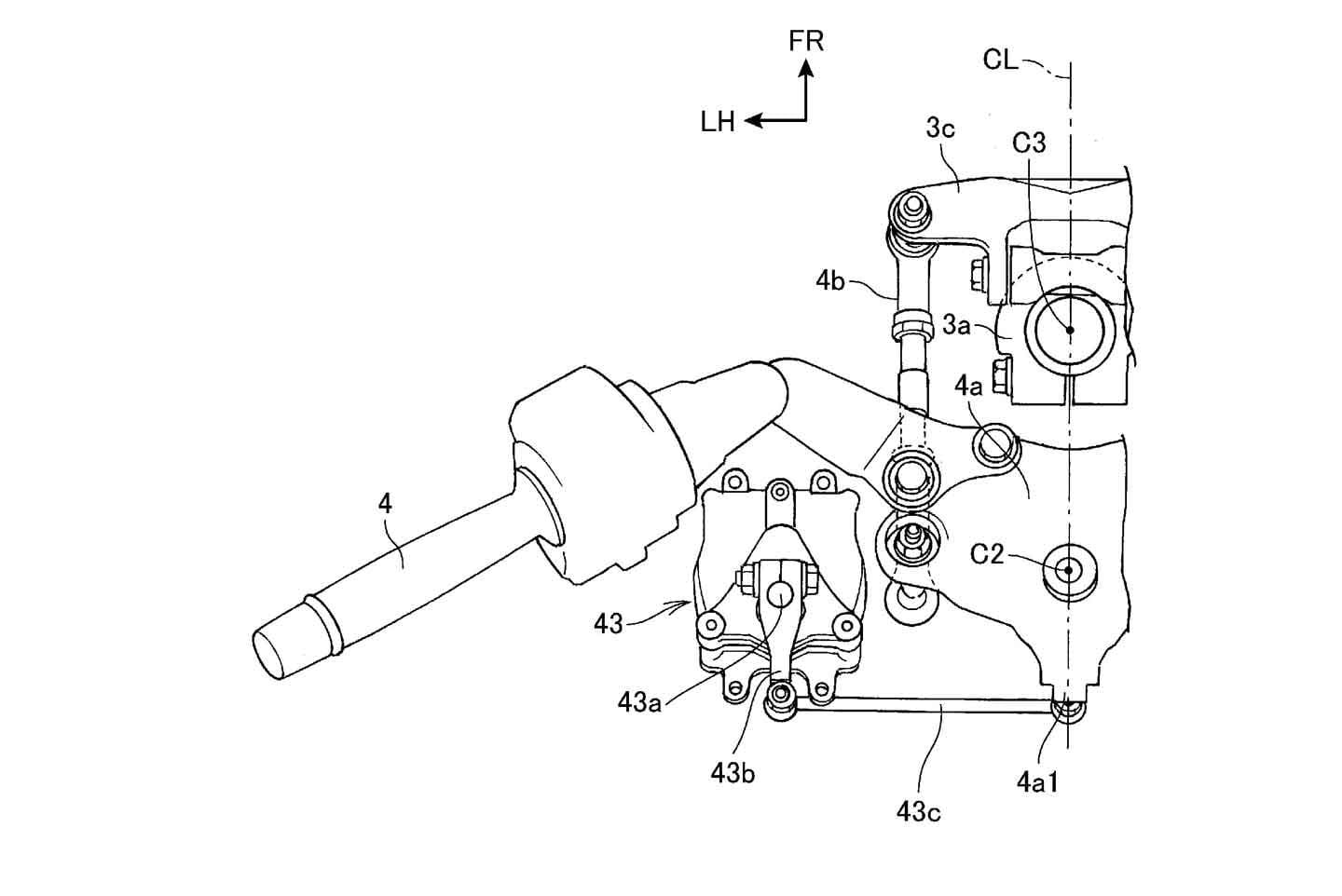

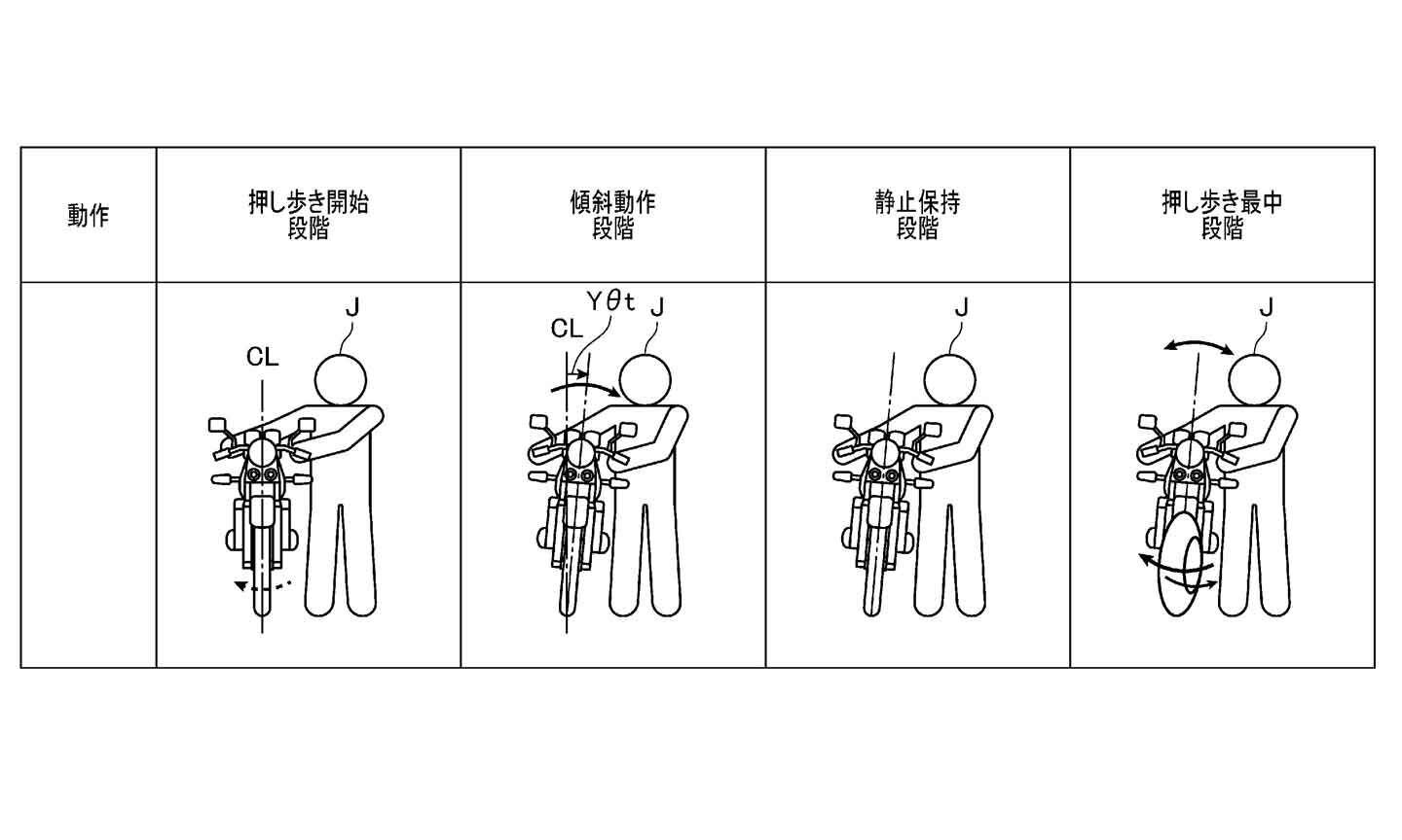

With a rider standing on the left of the bike, as you would normally when pushing it around, the system aims to keep it tilted slightly toward them while preventing it from getting out of control. The steering actuator, identical to the one seen in other Honda patents, is connected to a computer that takes signals from an on-board tilt sensor. If the bike begins to lean too much toward the pusher, it will steer closer to them, making itself more upright to reduce the weight they’re having to hold up. If it gets completely vertical, where there’s a risk that the bike could fall away from the pusher, the steering turns the other way to stop that from happening.
A steering actuator is used to lean the bike slightly into the rider while pushing it. If it leans too much the actuator steers the bike closer to the rider to stand it up more.
A steering actuator is used to lean the bike slightly into the rider while pushing it. If it leans too much the actuator steers the bike closer to the rider to stand it up more. (Honda /)
The DCT version of the Gold Wing already has a “walking speed mode,” using the “shift up” and “shift down” switches on the bars to trundle forward or backward at low speed under its own power while maneuvering, so the addition of a steering assist in the same mode that stops the bike from tilting too far makes a lot of sense. The existing sensors and computers used for traction control and ABS systems can already monitor the bike’s lean angle, so simply adding the steering servo to the system to help prevent low-speed toppling would be easy to adopt.
The steering actuator is located at or near the steering head.
