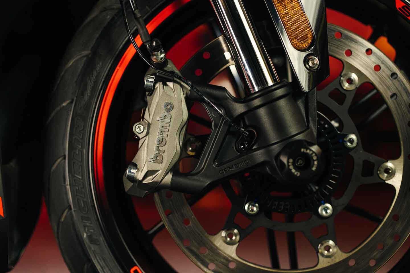

CFMoto equipped the 450SS with Brembo brakes.
CFMoto equipped the 450SS with Brembo brakes. (CFMoto/)
Damping is achieved with a non adjustable upside-down telescopic fork and a multi-link suspension with a preload adjustable shock is fitted in the rear. The chassis also features a full fairing with an integrated windscreen, a 3.7-gallon fuel tank, aluminum alloy wheels, and a radially mounted Brembo M40 four-piston caliper with a 320mm single disc up front and a 220mm disc with a single-piston caliper for the rear.
