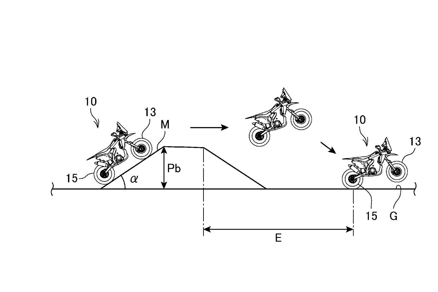

The system is illustrated on a bike that looks like the Dakar-oriented CRF450 Rally, and it’s perhaps in rally-raid racing, where riders face mile after mile of dunes and fatigue, that it would come into its own. It’s largely based on familiar systems like ride-by-wire throttle, ABS, and lean sensors, but adds one less common one, a nose-mounted camera, into the mix along with an image-processing computer.
In operation, the camera “sees” slopes as you approach them, using the bike’s lean sensors to work out their orientation, so even if you’re in a corner as you approach the slope it can assess its height and distance. From there, the system operates a bit like traction control and the other rider aids we’re familiar with, using presets to decide how much it should intervene.

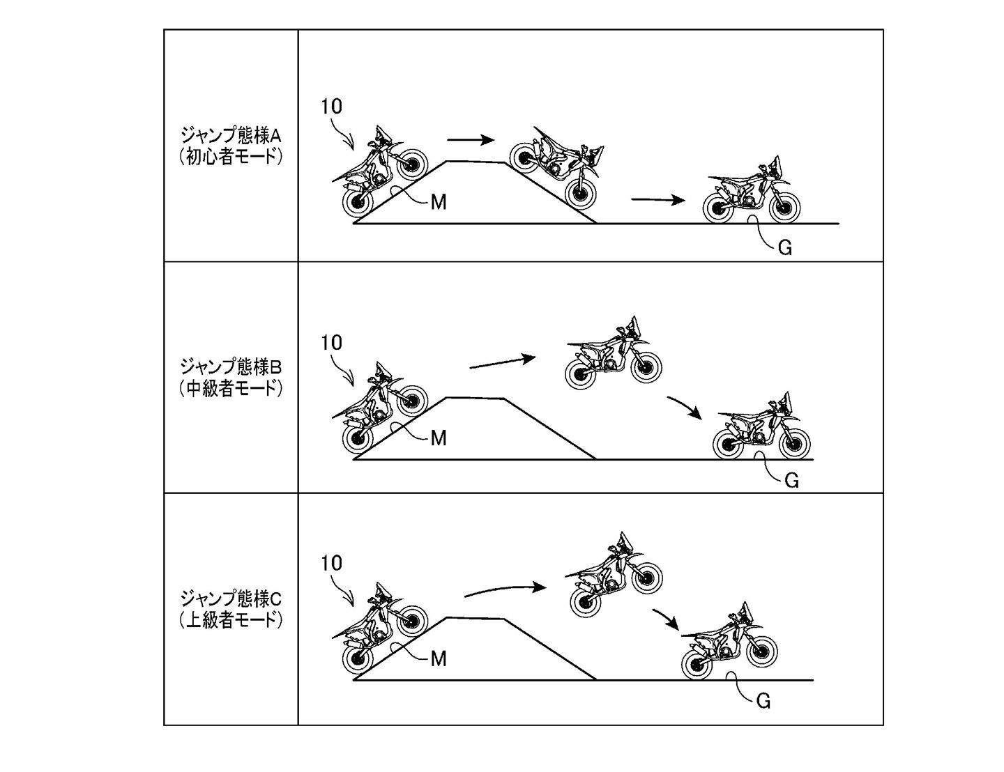

The proposed system has three modes. Mode A would keep the motorcycle on the ground altogether, B would allow the bike to fly, but control the bike in the air to ensure a level landing, while C would allow the front of the bike to be elevated for a rear-wheel landing.
The proposed system has three modes. Mode A would keep the motorcycle on the ground altogether, B would allow the bike to fly, but control the bike in the air to ensure a level landing, while C would allow the front of the bike to be elevated for a rear-wheel landing. (Honda/)
In Jump Mode A the system intervenes the most, reducing the bike’s speed as you approach the top of the slope to ensure the wheels never leave the ground at all, using throttle and, if necessary, brakes to do so. Essentially, then, it’s a jump-prevention system, rather like the wheelie-prevention systems that are already used on many bikes. Suspension stroke sensors and front and rear wheel speed sensors will tell the system whether the bike is on the ground or not.
For more advanced riders, there’s Jump Mode B. which enables moderate jumps and helps you keep control in the air. The system has a target-flight distance and, depending on the angle of the jump slope, can reduce throttle to make sure you don’t exceed it. As with modern traction-control and slide-control systems, the chances are that there would be sub-menus allowing the target-flight distance to be modified.
Jump Mode C allows the least intervention.
Jump Mode C allows the least intervention. (Honda/)
Once in the air, the system uses the throttle and rear brake to control the bike’s attitude. More throttle tends to make the front rise, dabbing the rear brake will bring it down—that’s something experienced off-road riders will do anyway, but Honda’s system automates it to keep the bike’s flight angle under control. In Jump Mode B, the system aims to keep the bike close to horizontal and achieve a two-wheel landing. The patent also shows a more advanced Jump Mode C that still gives the computer control over the bike’s attitude and the overall distance of the jump but adopts a more nose-up posture during flight and aims to land on the rear wheel first. Jump Mode C would also be likely to allow higher takeoff speeds and longer flight distances.
