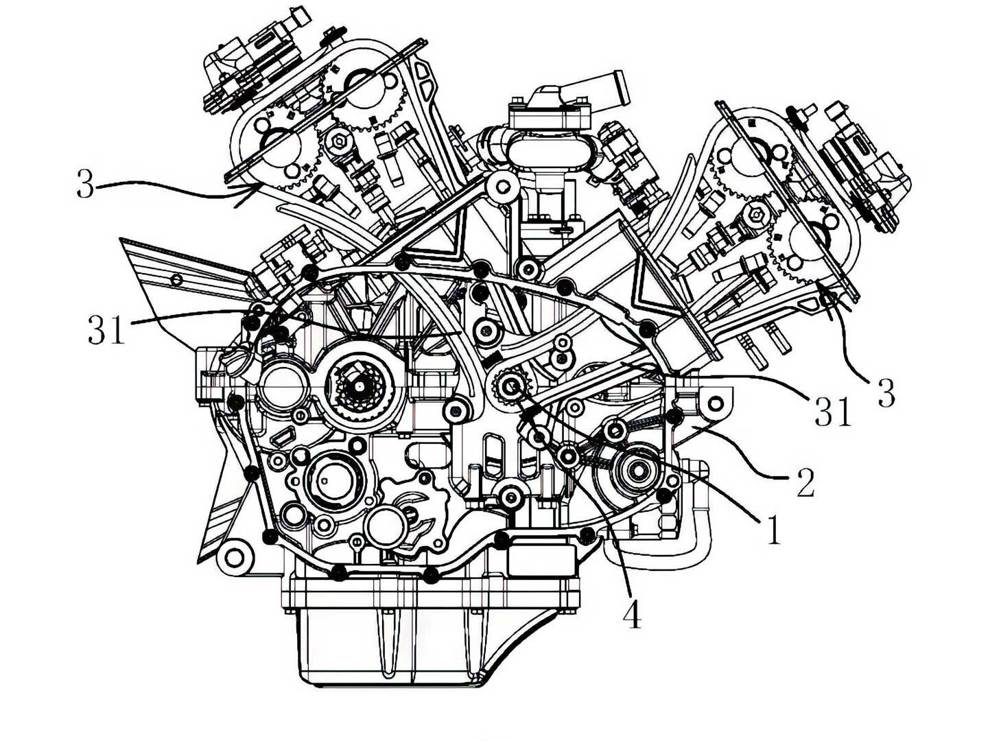

Benelli’s parent company Qianjiang (that has owned the Italian company since 2005) is developing a new V-4 engine for future motorcycle models that could finally open the door to a high-performance Benelli for the first time since the demise of the Tornado 1130.

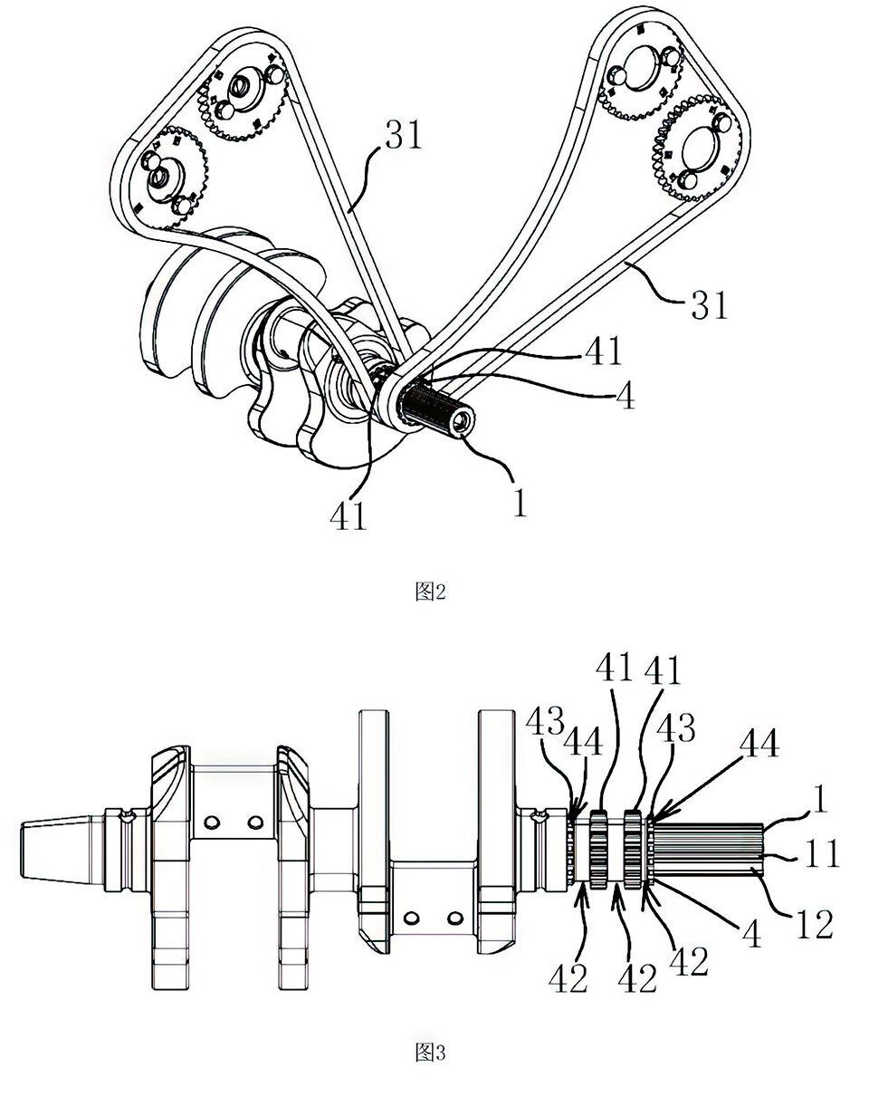

The engine has appeared in multiple patent applications published in China over the last few weeks, revealing it to be a 90-degree V-4 somewhere around the 1-liter mark, with chain-driven double overhead camshafts and four valves per cylinder. While there are some general similarities between the engine’s design and that of Honda’s late-model VFR800 motor, it doesn’t appear to be a “clone.” In fact, the very existence of patent applications shows that the engine adopts ideas that haven’t been used in the past.
Related: The Chinese Connection
Chain-driven double overhead cams and four valves per cylinder will be used on the new V-4.
Chain-driven double overhead cams and four valves per cylinder will be used on the new V-4. (Qianjiang/)
Most of the patents are related to mundane elements of the design—oil return feeds from the cylinder head, the lubrication of the transmission, and the way the timing-chain sprockets are mounted to the crankshaft—but the result of the multiple documents means we get a good look at the engine, both internally and externally. While not a radical design, it appears to be on par with other modern V-4s, even if the 90-degree angle means it’s not as compact as Aprilia’s RSV4 engine.
