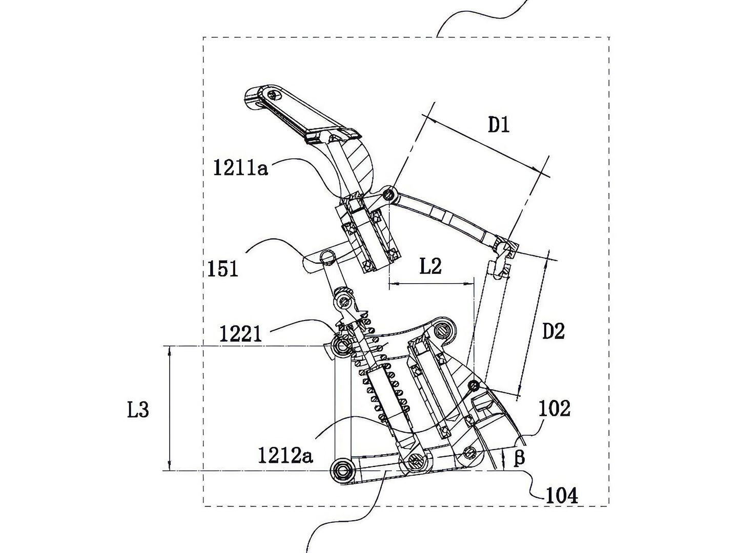

Similar to BMW’s Duolever, CFMoto’s Hossack-style fork uses a monoshock, allowing for easier integration of electronic suspension adjustment systems.
Similar to BMW’s Duolever, CFMoto’s Hossack-style fork uses a monoshock, allowing for easier integration of electronic suspension adjustment systems. (CFMoto Patent Drawings/)
Now it looks like CFMoto—the Chinese brand that’s increasingly standing out as a leader in that fast-expanding part of the industry, and one that’s rapidly narrowing the gaps in quality and technology held by more established Japanese, European, and American brands—is also heading down the Hossack route.
The company has filed a patent application for a front end that’s very similar to the BMW Duolever, itself very much a replica of the old Hossack setup with a cast alloy girder fork suspended by two car-style wishbones and a single coilover shock. The CFMoto patent itself relates to a mundane part of the design: a ball-joint used in the steering linkage; but the illustrations clearly show the whole suspension setup and a large chunk of the bike it’s attached to.

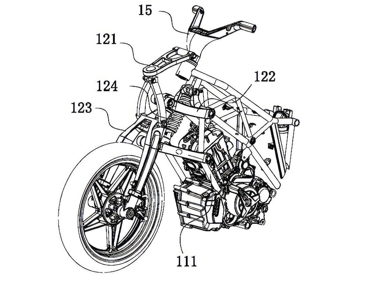

That bike is a development of CFMoto’s largest machine yet, the 1250TR-G. Currently sold only in China, the 1250TR-G uses a 140 hp, 1,279cc V-twin engine that’s derived from a KTM design but heavily altered by CFMoto. At first glance the new patent drawings appear to show a single-cylinder engine but in fact it’s the 1,279cc V-twin; the rear cylinder has been omitted from the drawings along with several other components like the cooling and fuel systems.
The frame is like the 1250TR-G’s steel tube chassis but gains an added set of front downtubes to mount the two wishbones that hold the cast alloy fork. The monoshock is mounted between the lower wishbone and the frame, where the original steering headtube is partially removed to accommodate it. The bars are mounted just as they are on the current, conventionally suspended 1250TR-G, but with a hinged linkage to transfer steering movements to the girder fork.

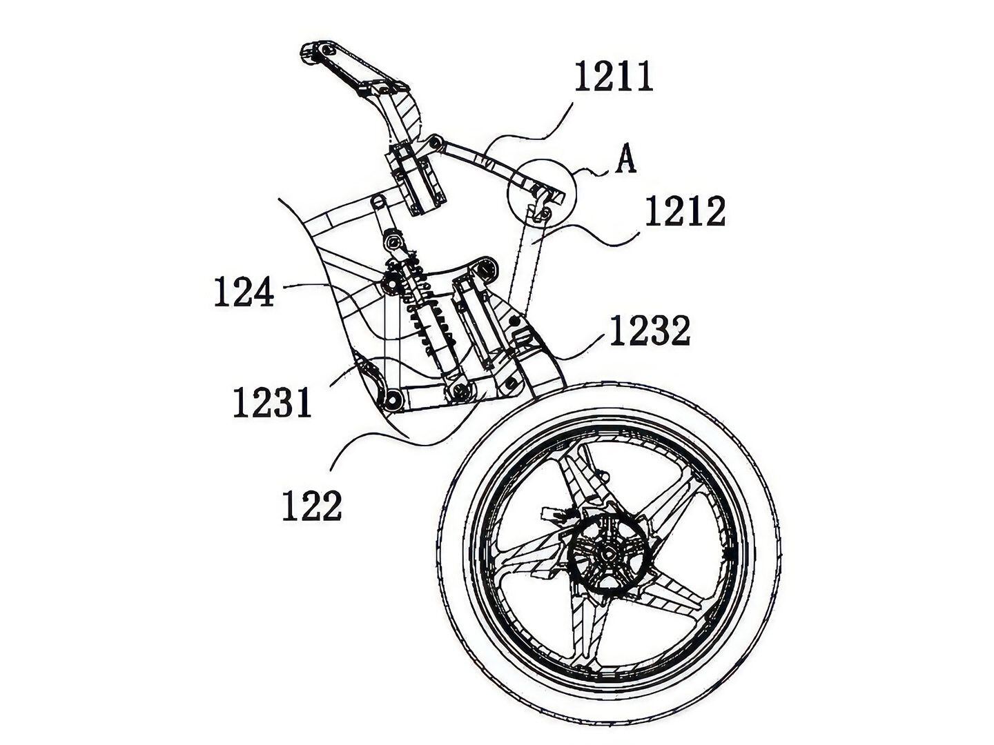

CFMoto’s patent for its girder fork relates to a ball-joint used for steering (labeled A).
CFMoto’s patent for its girder fork relates to a ball-joint used for steering (labeled A). (CFMoto Patent Drawings/)
Just as on the Gold Wing and the BMW models that use Hossack-style suspension, the benefit comes from the broader spread of suspension geometry that the system allows. It can separate braking and suspension forces, allowing relatively soft suspension without suffering from too much dive during braking. The use of a single shock absorber, essentially the same as the rear shock on a normal bike, also makes it easier to adopt technology like adaptive damping or electronic control preload adjustment.
