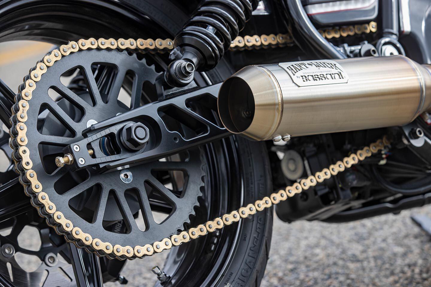

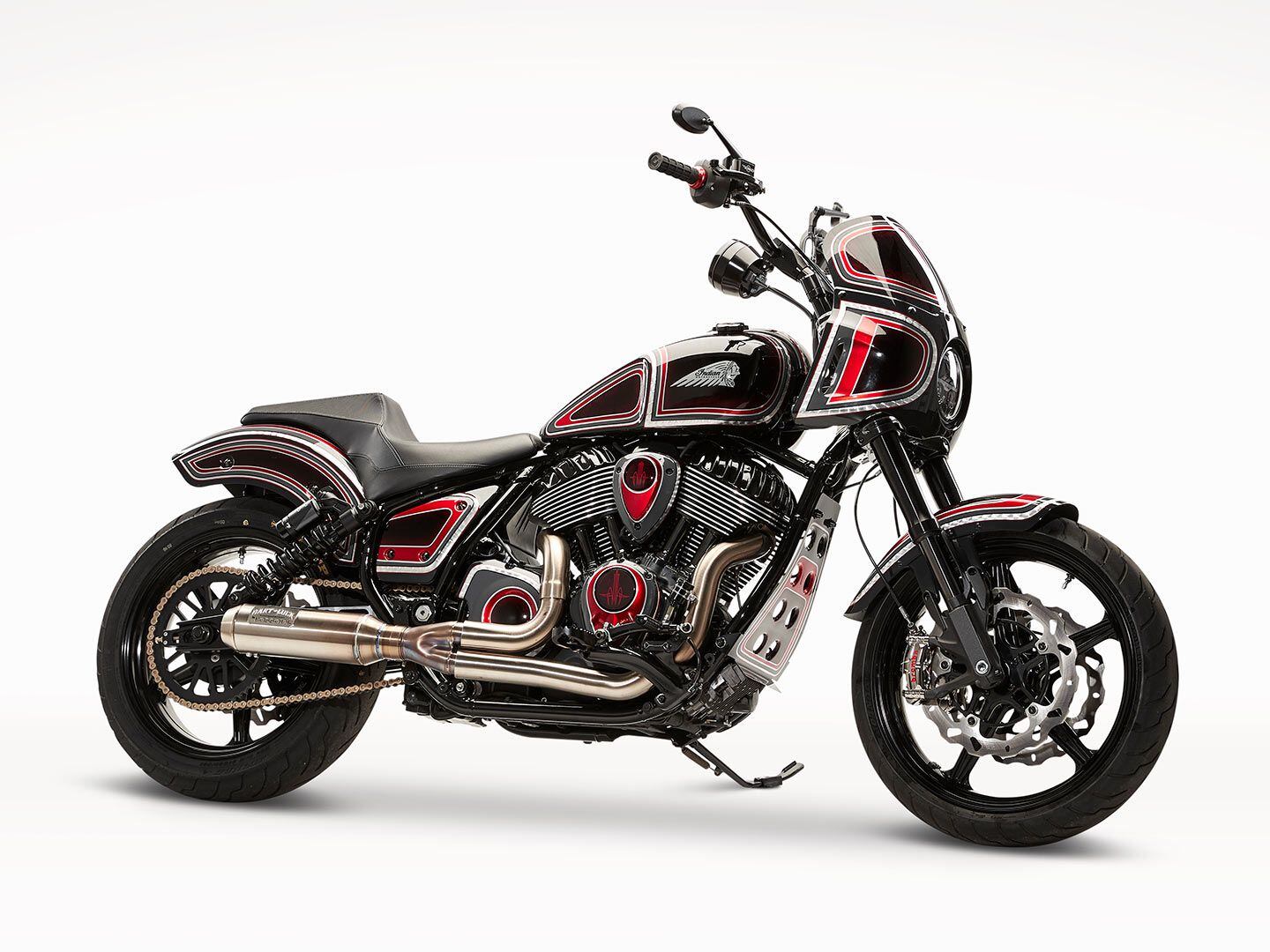

And the worries are well founded. Hart took the Sport Chief down to the frame before building a club-style custom that enhances the performance of Indian’s latest Chief model. The list of parts and mods is extensive including a machined billet-aluminum Trac Dynamics swingarm, Fox rear shocks, Brembo Monoblock calipers, Beringer controls, knee cutouts on the fuel tanks, and paint by Schultz Designz.

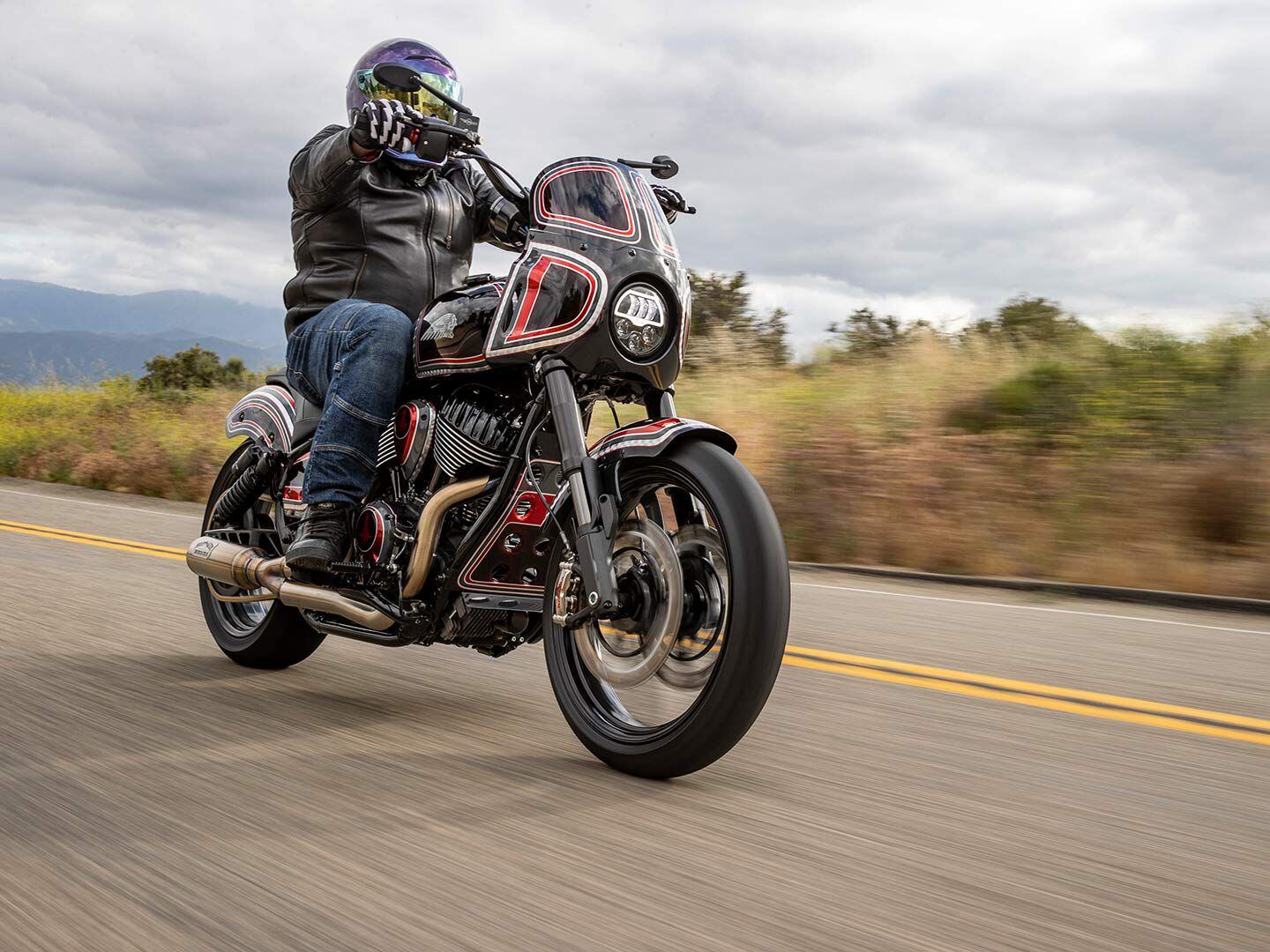

On the road, the Hart-Luck Bassani exhaust is raspy as you roll on and off the power in Temecula’s hillsides and canyons. While the overall power hasn’t increased much, the lighter chassis and stiffer suspension reacts quicker to throttle inputs. Although the bike has more snap, final gearing through the Barnstorm Cycles chain conversion is identical to stock.
While it may look like a showpiece, Twitch’s Indian Sport Chief is more about having fun and going fast.
While it may look like a showpiece, Twitch’s Indian Sport Chief is more about having fun and going fast. (Jeff Allen/)

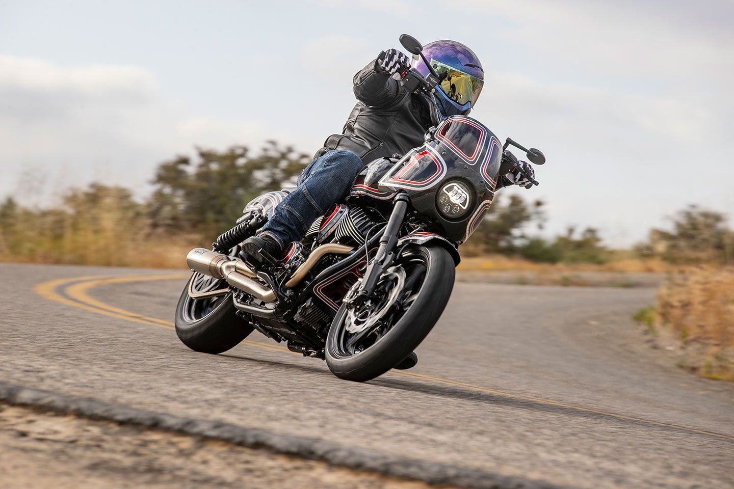

Where Hart’s creation really shines is in handling. Hart-Luck five-spoke wheels wrapped in Dunlop American Elite tires allow the Sport Chief to change directions and drop into corners quicker than the bulkier stock mags. The 1.5-inch-longer fork with GP Suspension  valving, springs, and DLC coating raises Twitch’s ride for increased cornering clearance. Overall, the ride is much sharper and responsive.
Cornering clearance is increased, adding more sportiness to the Sport Chief.
Cornering clearance is increased, adding more sportiness to the Sport Chief. (Jeff Allen/)

Hart-Luck Indian Sport Chief Parts List
Paint: Schultz Designz
Tires: Dunlop American Elite
Wheels: Hart-Luck 5-spoke
Fork: GP Suspension w/ 1.5 in. longer, coated lower tubes, spring, and valving
Shocks: Dual Fox Factory 13-in. piggyback shocks
Swingarm: Trac Dynamics billet aluminum
Front brake calipers: Brembo Monoblock
Rear caliper and hanger: Beringer
Rotors: Galfer Wave
Brake lines: Galfer
Shift/brake levers: San Diego Customs
Chain conversion: Barnstorm Cycles
Air intake: Indian high flow
Clutch cable: Barnett
ECU program: Dynojet
Exhaust: Bassani/Hart-Luck
License plate mount: Drag Specialties
Pegs: San Diego Customs
Lower frame cover: Hart-Luck custom
Hardware: Pro-Bolt black anodized titanium
Bar clamps and risers: Kraus Motor Co.
Bars and grips: ODI/Hart-Luck
Gauge bucket: Kraus Motor Co.
Clutch perch and front master: Beringer
Seat: Saddlemen/Hart-Luck
Front and rear indicators: Rizoma
Rear master: Beringer
Rear master reservoir: Rizoma

Knee cutouts on the tank create a slimmer cockpit for the rider. (Jeff Allen/)Trac Dynamics billet swingarm, Bassani exhaust, and Barnstorm chain conversion.
Trac Dynamics billet swingarm, Bassani exhaust, and Barnstorm chain conversion. (Jeff Allen/)Handling on Twitch’s custom Sport Chief is greatly improved over stock.
Handling on Twitch’s custom Sport Chief is greatly improved over stock. (Jeff Allen/)
