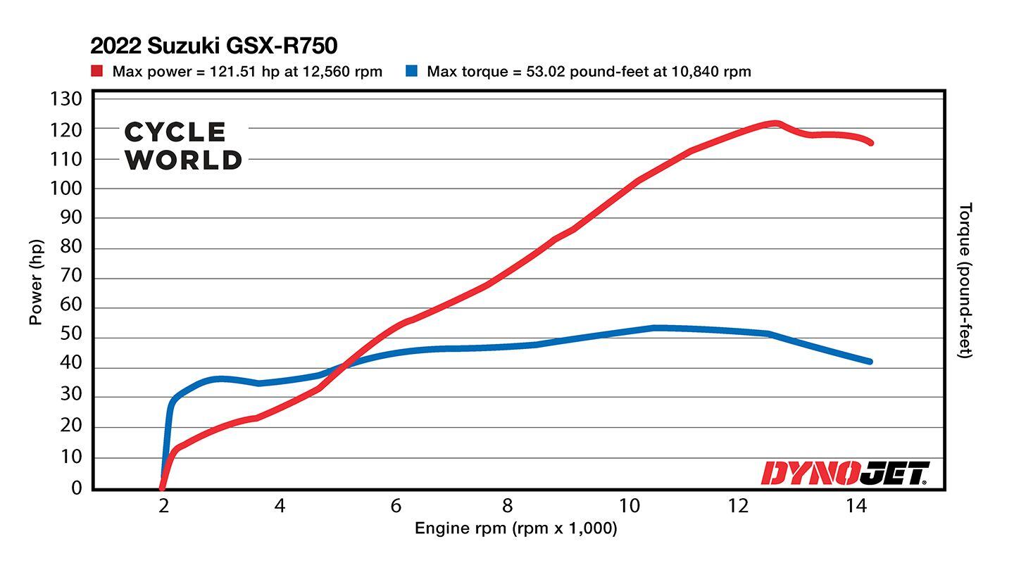

The 750cc DOHC liquid-cooled inline-four engine has been a Cycle World favorite for years due to its ability to rev like a 600, but offers usable bottom-end like a literbike. Although the Suzuki GSX-R750 hasn’t seen any updates since 2011, we wanted to run the inline-four on our inhouse Dynojet 250i dynamometer to see how much power this iconic Japanese sportbike can make 11 years later.
2022 Suzuki GSX-R750 Dyno Chart.
2022 Suzuki GSX-R750 Dyno Chart. (Robert Martin/)
After coming off our automotive scales with a curb weight of 428 pounds, the 2022 Suzuki GSX-R750 produced 121.5 hp at 12,560 rpm and 53.0 lb.-ft. of torque 10,840 rpm. A linear power delivery and relatively flat torque curve make the Suzuki GSX-R750 a highly competitive racetrack motorcycle from a club level all the way up to World Supersport competition.
