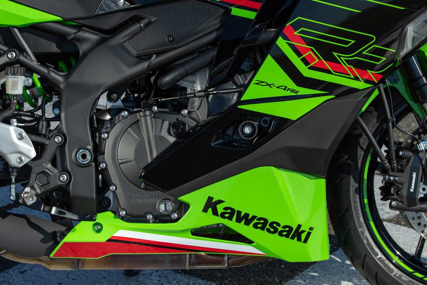

The jewel at the heart of the Ninja ZX-4RR is undoubtedly the engine. The liquid-cooled DOHC 16-valve inline-four displaces 399cc and has a 57.0 x 39.2mm bore and stroke. Inside that engine is a lot of technology that Kawasaki has learned racing its ZX-6R and ZX-10R platforms. The aluminum die-cast cylinders have bores that are chrome-composite plated for reduced friction and better durability. The oversquare bores allow the use of large 22.1mm intake and 19mm exhaust valves for good airflow, while the short 39mm stroke allows high-rpm performance with a near-16,000 rpm redline. Forged camshafts actuate valves with triple-rate springs capable of dealing with the high rpm attainable by the engine.
The 399cc inline-four that powers the ZX-4RR revs to 16,000 rpm and makes peak torque at 11,000. US models have reduced peak power due to sound emission restrictions. Boo!
The 399cc inline-four that powers the ZX-4RR revs to 16,000 rpm and makes peak torque at 11,000. US models have reduced peak power due to sound emission restrictions. Boo! (Kawasaki/)
Lightweight cast-aluminum pistons and case-hardened connecting rods contribute to quicker-climbing revs as does a lightweight flywheel. The compression ratio is set at 12.4:1. Like its big brother the 10R, the 4RR gets two-stage machining on the fine-sand cast intake ports for straighter more efficient airflow into the combustion chamber. Precision machined combustion chambers and narrow included valve angles ensure high-performance efficiency. Ram induction jams pressurized air into the airbox and then through dual-length intake funnels (that help flatten the torque curve) before passing into a bank of 34mm electronic throttle valve throttle bodies.

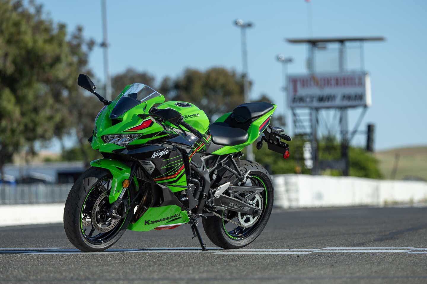

There is virtually nothing in this displacement category that compares to the Ninja ZX-4RR.
There is virtually nothing in this displacement category that compares to the Ninja ZX-4RR. (Kevin Wing/)

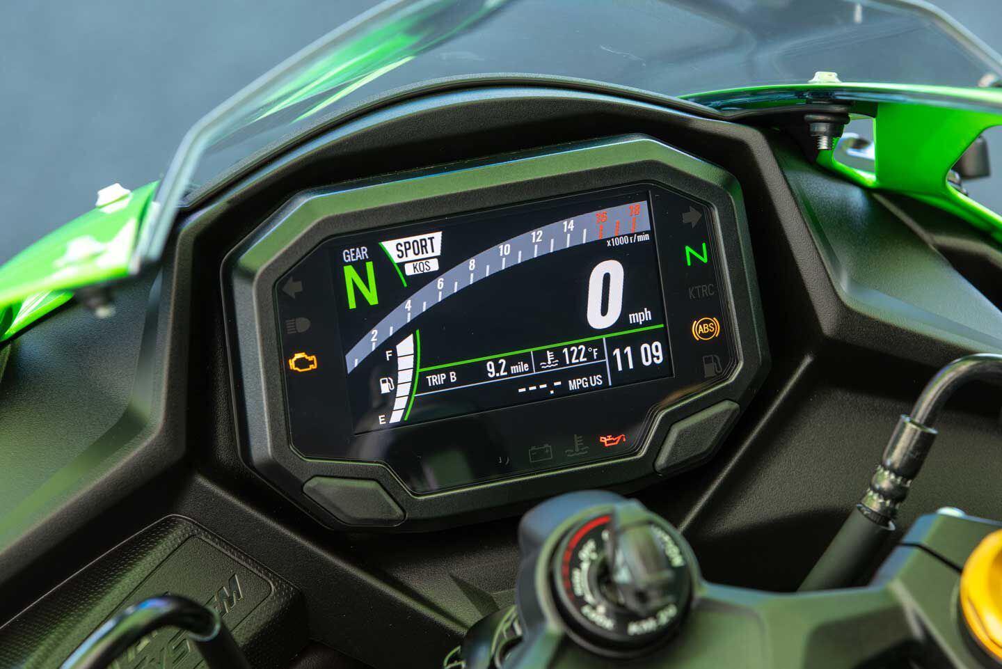

The 4.3-inch TFT display has multiple modes, including Street, Track, Black, or White options. |
The 4.3-inch TFT display has multiple modes, including Street, Track, Black, or White options. | (Kevin Wing/)
The rider interface to access these settings is anchored by a 4.3-inch full-color TFT display that allows the rider to choose between two modes, either a more road-oriented view or a circuit mode that also can display a lap timer. The user can also choose between a black or white background, while the screen automatically adjusts its brightness based on ambient lighting conditions.

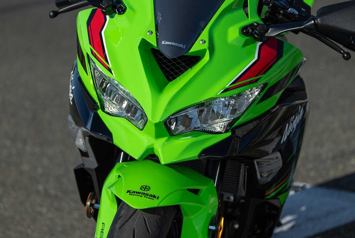

LED headlights, and front-fairing embedded turn signals are used up front, while slim LED rear signals are clean and attractive. Another electronic feature is smartphone connectivity via Kawasaki’s Rideology app, that allows users to tether to the bike via Bluetooth and access things like GPS route information, call notifications, vehicle info and even change settings from the phone.
LED headlights and fairing integrated turn signals keep the front clean.
LED headlights and fairing integrated turn signals keep the front clean. (Kevin Wing/)

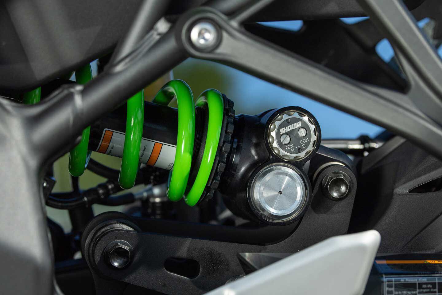

Like the fork, the Showa Balance Free Rear Cushion (BFRC) shock is fully adjustable, with rebound, compression and preload. Its Horizontal Back-link design features a linkage on top of the swingarm, which Kawasaki says helps keep the shock away from the exhaust and engine to reduce the chance of it getting cooked and affecting performance.

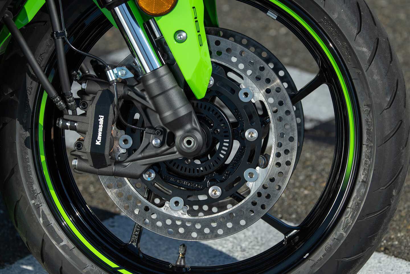

The Ninja ZX-4RR has some serious hardware up front, with a fully adjustable Showa SFF-BP fork, and serious brake hardware.
The Ninja ZX-4RR has some serious hardware up front, with a fully adjustable Showa SFF-BP fork, and serious brake hardware. (Kevin Wing/)

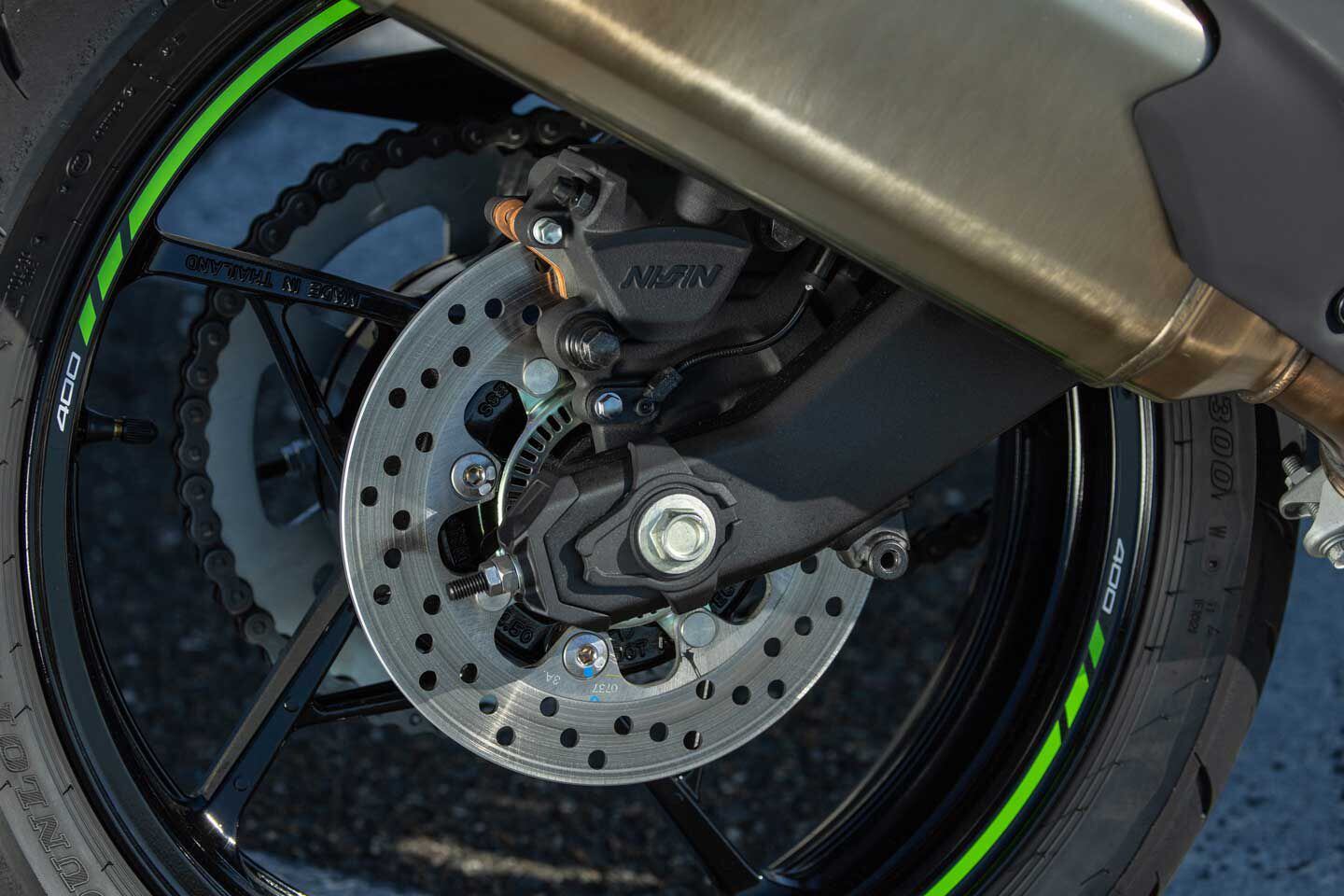

A quick glance at the front end reveals a pair of Nissin four-piston radial-mount Monoblock calipers and 290mm discs, while a single-piston Nissin caliper and 220mm disc reside at the rear. The bike comes standard with Nissin ABS. Almost every other motorcycle on the market in this displacement category relies on a single caliper and disc up front. Five-spoke cast aluminum wheels are mounted with 120/70-17 and 160/60-17 Dunlop Sportmax GPR-300 rubber.
A fully adjustable Balance Free Rear Cushion shock is mounted to a link above the swingarm, which keeps it away from engine and exhaust heat.
A fully adjustable Balance Free Rear Cushion shock is mounted to a link above the swingarm, which keeps it away from engine and exhaust heat. (Kevin Wing/)

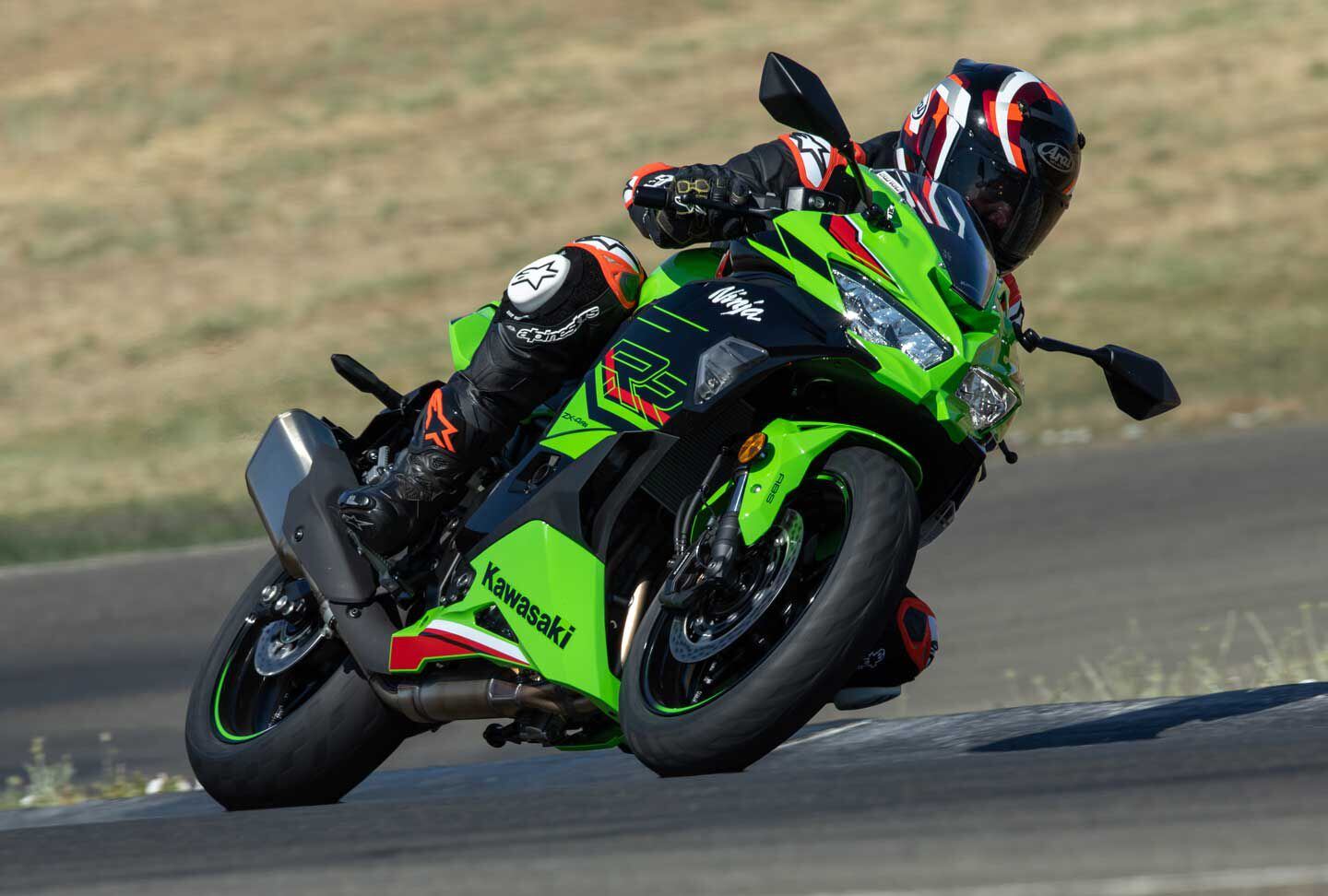

The great thing about lapping a 400 like the Ninja ZX-4RR is that you can ride all day and never get tired!
The great thing about lapping a 400 like the Ninja ZX-4RR is that you can ride all day and never get tired! (Kevin Wing/)
With the layout locked into memory and references burned into the brain, concentrating on the bike became easier. The first thing that leaps out at you is how good the brakes are. They honestly have the bite and feel of much more expensive Brembos that are found on most European sportbikes. There are only a handful of hardish braking zones at Thunderhill, and with the much slower speeds generated on the 4RR you don’t exactly hit your markers at warp speed, but one- and two-finger braking was no big deal getting it slowed from 120 to 125 mph.
Of course, the next most notable attribute of the little Ninja is the handling. In this regard, T-Hill was an ideal choice of venue for the bike to strut its stuff. Flicking the bike through the tighter corners makes you really appreciate what riding a small-displacement sportbike is all about, with very easy transitions side to side and the ability to alter your lines as needed midcorner. But what’s even more fun is being absolutely tapped through fast sweepers and yet not carrying so much speed as to have to worry about going into a lunar orbit if it all goes wrong. It’s here that we have to give a serious shoutout to the stock Dunlops, which even at the end of the day had proven to hold up quite well. For sure, running standard street tires makes you keep a bit in reserve, but the fact that they held up to three and a half hours of track time on a near-90-degree day further strengthens the argument for making a 4RR your trackday bike. It’ll save money on the tire bill for sure.

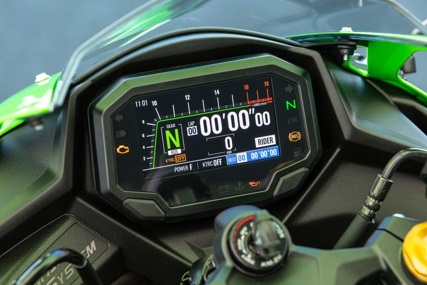

The TFT display has a track mode that also incorporates a lap timer and displays just the info you really need at a glance while riding on the track.
The TFT display has a track mode that also incorporates a lap timer and displays just the info you really need at a glance while riding on the track. (Kevin Wing/)

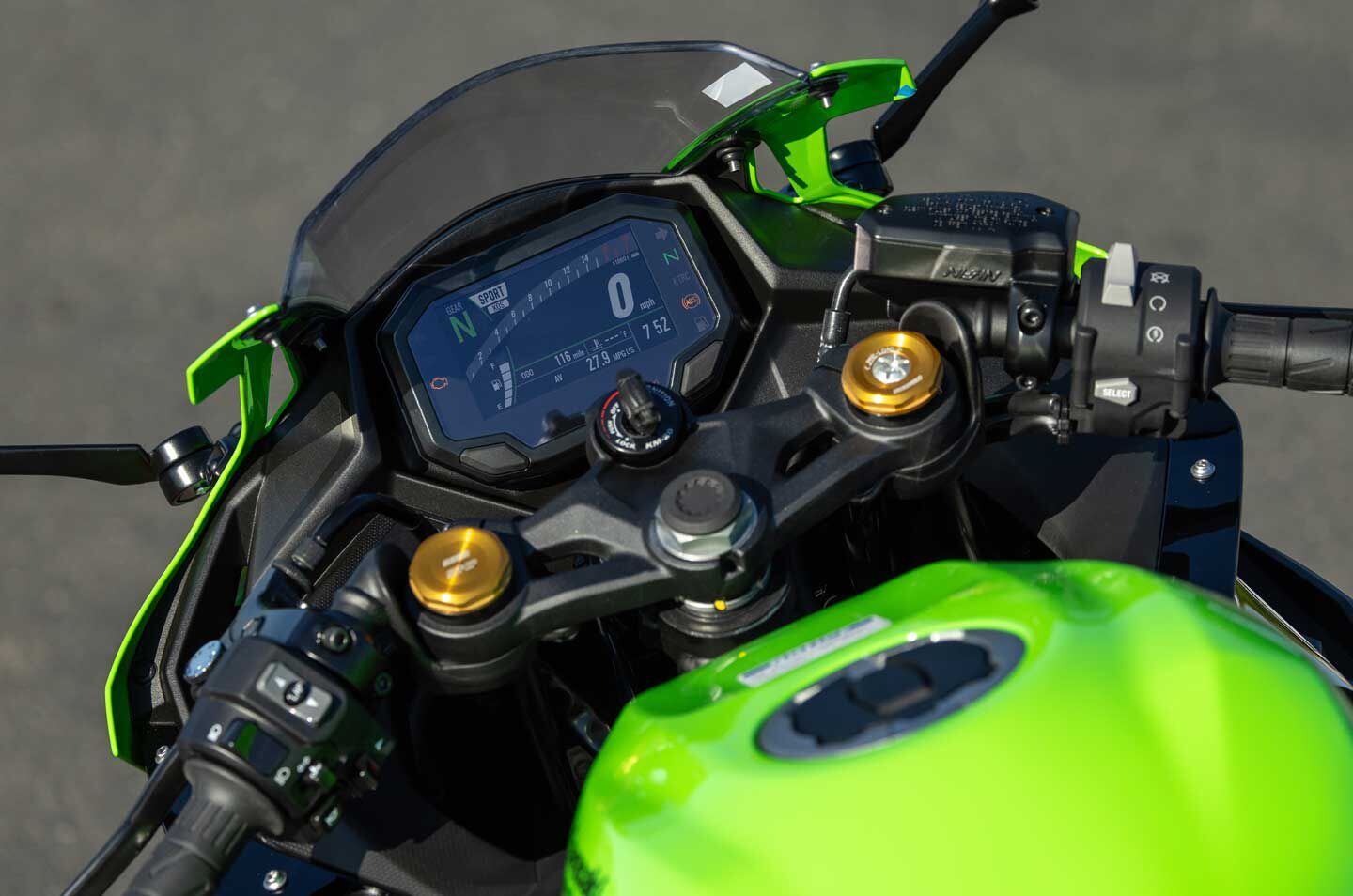

In this cockpit view, you can see the easy to access adjusters on top of the fork tubes.
In this cockpit view, you can see the easy to access adjusters on top of the fork tubes. (Kevin Wing/)

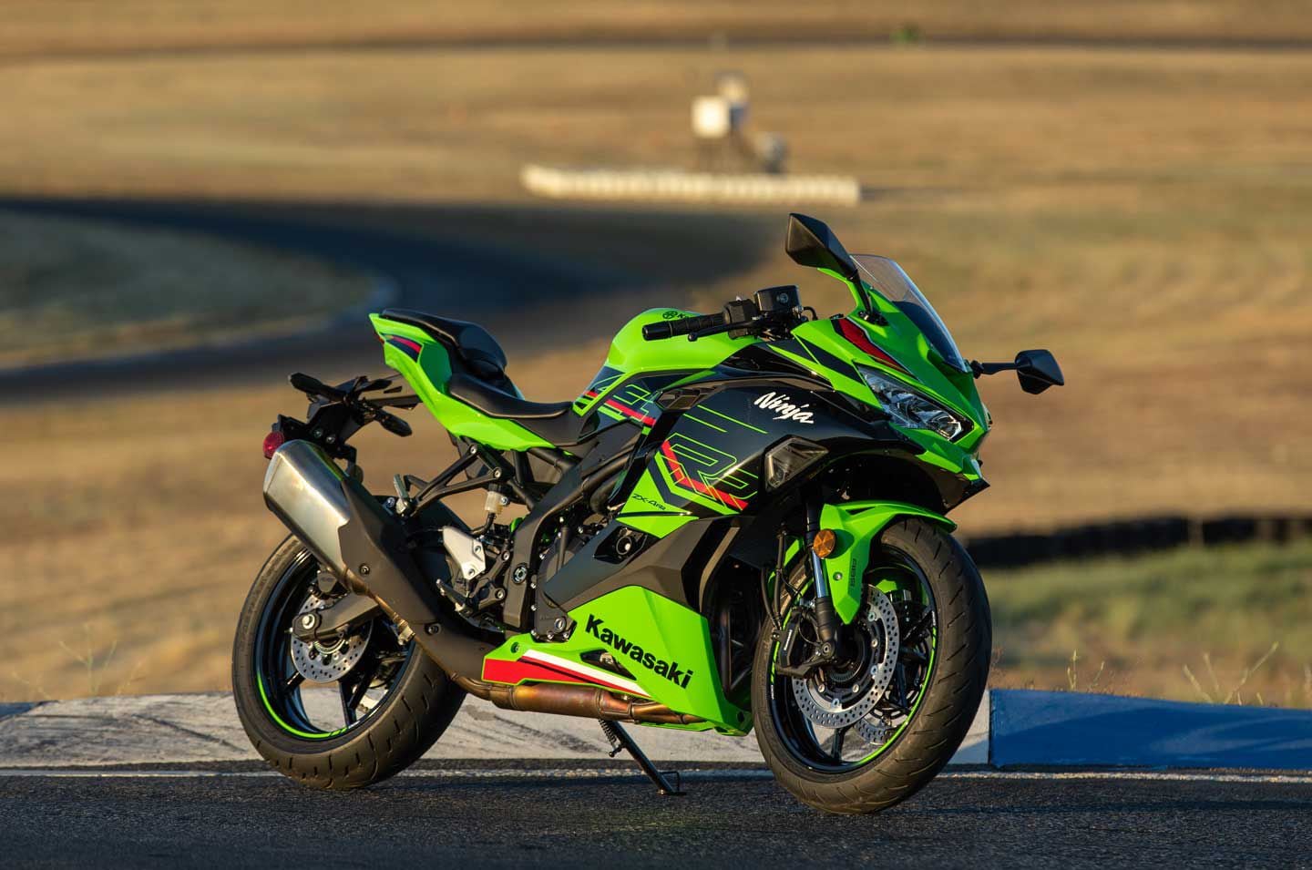

As rare as 400cc sportbikes were in the ‘80 and ‘90s, they were thought to be completely extinct until Kawasaki’s Ninja ZX-4RR rose from the ashes.
As rare as 400cc sportbikes were in the ‘80 and ‘90s, they were thought to be completely extinct until Kawasaki’s Ninja ZX-4RR rose from the ashes. (Kevin Wing/)
From a performance standpoint, the Ninja ZX-4RR is an absolute blast on a racetrack, for sure it’s a shame that it had to be choked back by sound-emission regulations in the US market, but instead of holding that against Kawasaki, we’d prefer to give the green team kudos for reviving what was a long-lost formula to fun. And besides, like we said, restoring the top-end is a quick ECU flash away for those who plan to ride the bike at trackdays or plan on racing it.

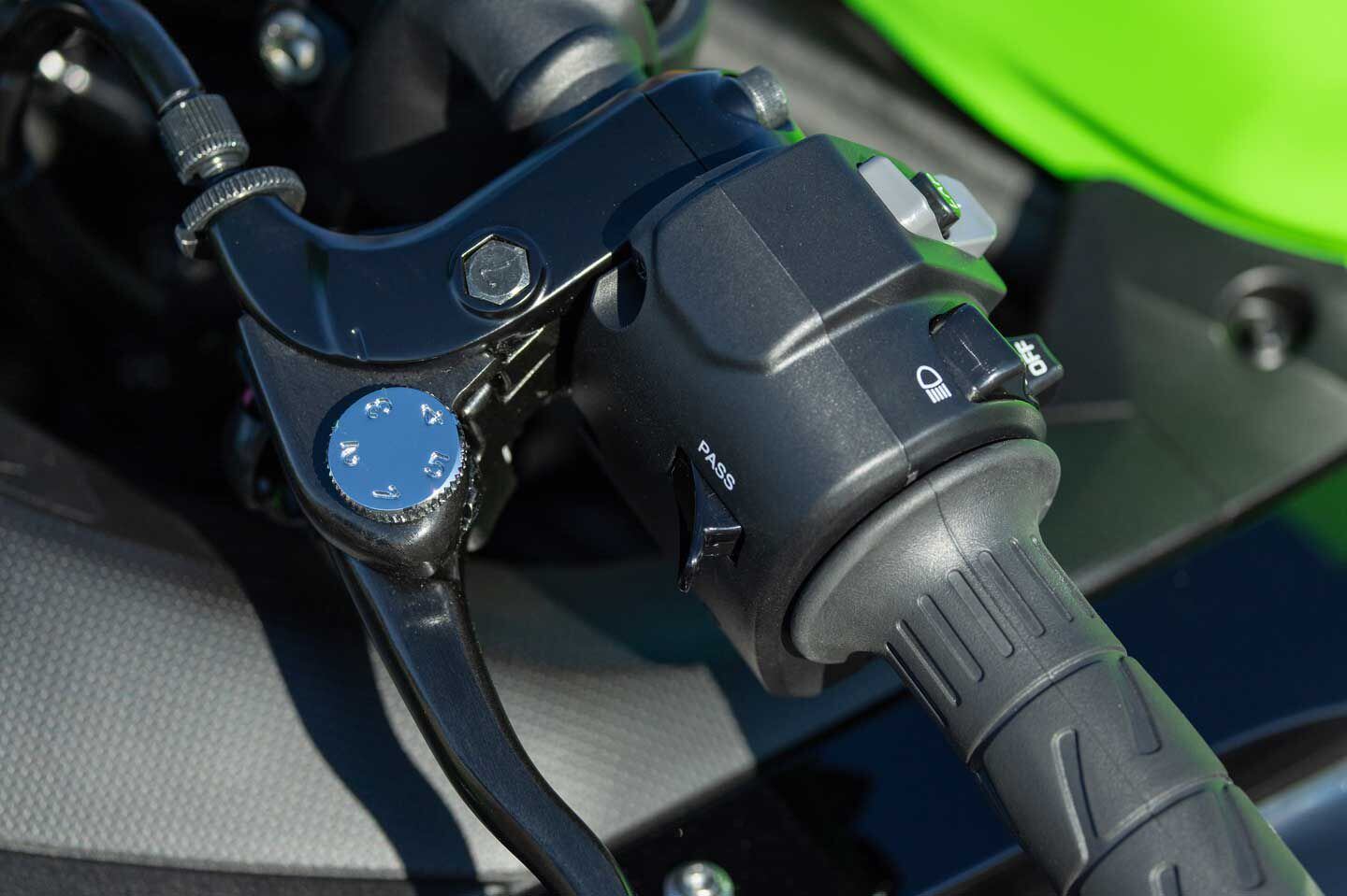

Nice touches like the five-position adjustable brake and clutch levers are welcome.
Nice touches like the five-position adjustable brake and clutch levers are welcome. (Kevin Wing/)
A single-piston Nissin caliper and 220mm disc handle braking at the rear.
A single-piston Nissin caliper and 220mm disc handle braking at the rear. (Kevin Wing/)

Rear Brake: 1-piston caliper, 220mm disc w/ ABS
