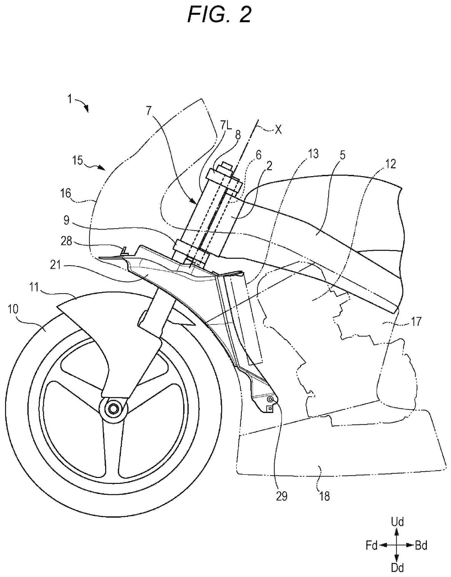

A new fairing design will help divert air into the radiator instead of up through the gap that the fork passes through.
A new fairing design will help divert air into the radiator instead of up through the gap that the fork passes through. (Suzuki/)

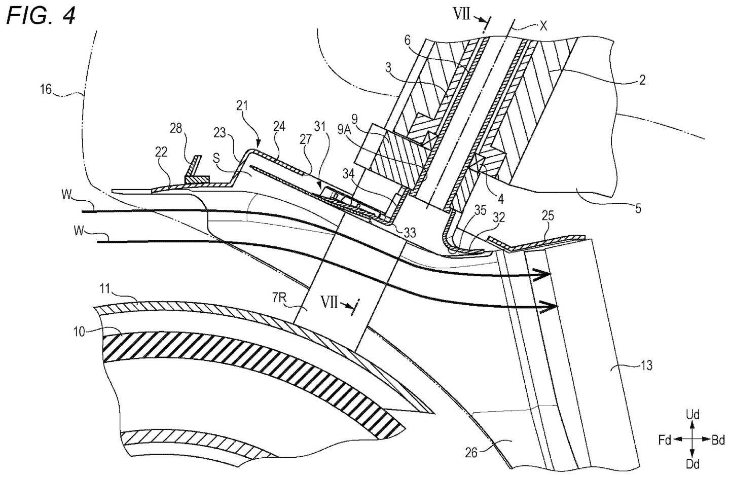

A new patent application from Suzuki shows that while the company’s interest in racing appears to be at an all-time low, engineers are still developing new technology for its superbike model. The design specifically shows an innovative fairing concept that promises to improve cooling and reduce drag, and while the drawings don’t include much detail of the bike the idea is applied to, the shape of the engine and frame match those of the GSX-R1000.
By plugging up the gap, air is diverted more efficiently into the radiator.
By plugging up the gap, air is diverted more efficiently into the radiator. (Suzuki/)
The new idea is to improve airflow into the radiator, just behind the front wheel, by cleaning up its passage between the upper side of the front fender and the lower surface of the nose fairing. On any conventional, faired bike, the surface under the nose, behind the headlight, inevitably has a gaping hole in it where the fork passes through. This void must be large enough for the steering to turn, and that means some of the air passing over the front wheel will get sucked through there instead of being directed to the radiator.

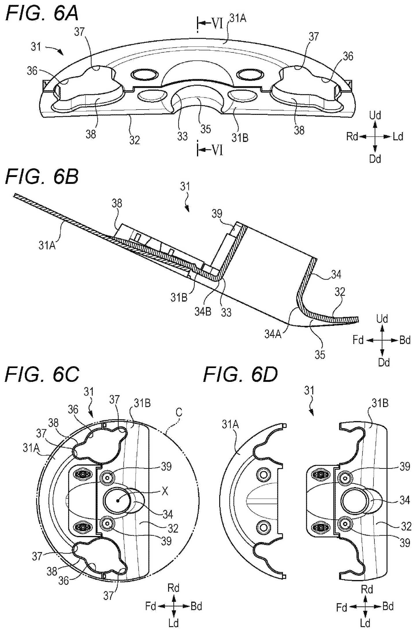

Multiple views of the diffuser that clamps on the front and rear of the fork and keeps air from passing up into the cockpit.
Multiple views of the diffuser that clamps on the front and rear of the fork and keeps air from passing up into the cockpit. (Suzuki/)
Suzuki’s solution to the problem is simply to plug that hole with a disc-shaped section of bodywork, made in two parts so it can be clamped around the fork legs, and with brackets allowing it to be bolted to the bottom yokes so the whole thing turns with the steering. This circular plug fits neatly into a matching hole in the lower surface of the nose, creating a smooth channel to direct the air down toward the radiator.
