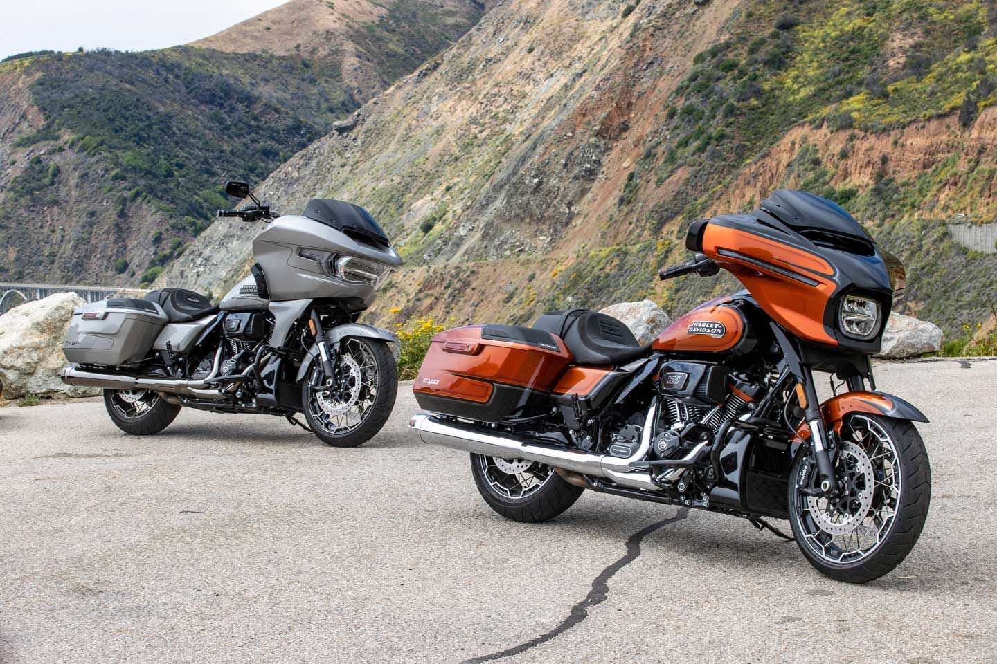

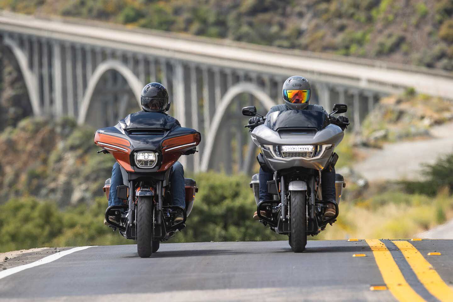

Although the fairings are all new, you know immediately you are looking at Harley’s CVO Road and Street Glide.
Although the fairings are all new, you know immediately you are looking at Harley’s CVO Road and Street Glide. (Jeff Allen/)
In terms of volume and type, Harley-Davidson’s biggest competitor is itself—in the used market. Since 2000, Harley-Davidson has sold well more than 2 million touring models. That’s your Street Glide, Road Glide, Ultra, and similar bikes, not cruisers like the Softail Fat Boy or old Dynas, which also have sold in similar numbers over the same time period. The now-discontinued air-cooled Sportster sold nearly 1.2 million during that period. Harley-Davidson motorcycle shipments from 2000 through 2022, as published by Harley-Davidson, total 5,808,881 units.
That, folks, is a lotta potatoes.
So keeping the Grand American Touring line (Harley’s official name for the platform) attractive—more attractive than last year’s Road Glide and the rest—is exceedingly important.
Which is why Harley-Davidson introduced the 2023 CVO Road Glide and CVO Street Glide with significant changes to the traditional 45-degree V-twin, upgraded suspension, new infotainment, and heavily reworked styling.
Every crease, contour, and edge of the redone fairings is new, and yet the world knows exactly what two bikes it is looking at.

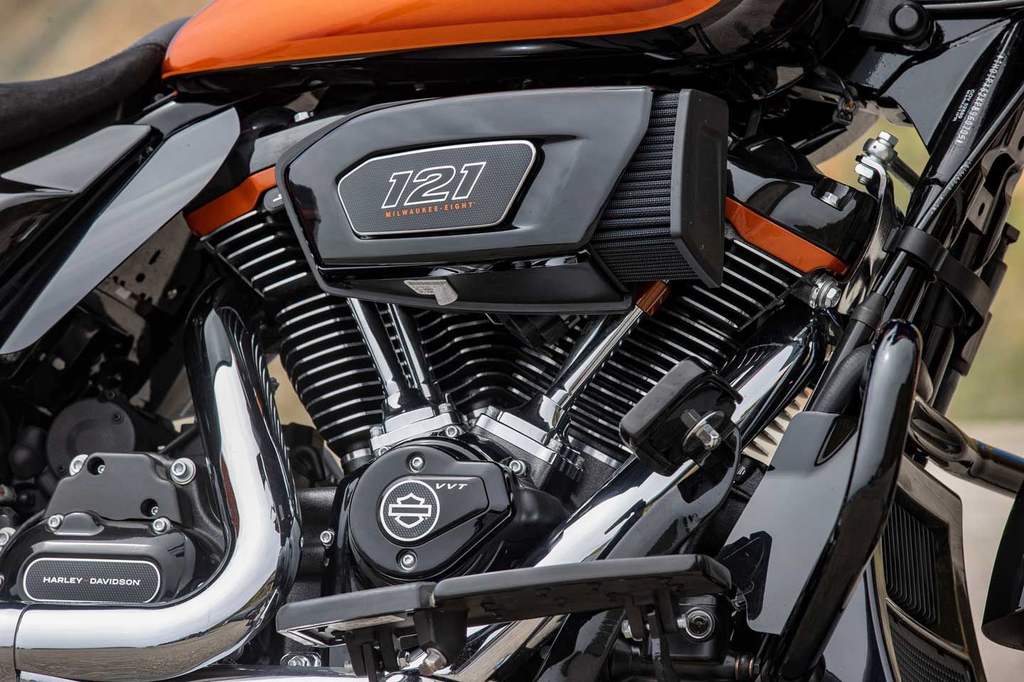

CVO 121 VVT Engine
When the new engine fires up, the world also knows exactly what it’s hearing. Well, you’ll recognize the potato-potato sound as a 45-degree V-twin, but please notice the “VVT” on the side of this 121ci Milwaukee-Eight engine. At long last, a Big Twin finally has variable valve timing.
A new 121ci (1,977cc) Milwaukee-Eight with VVT powers both the 2023 CVO Street Glide and CVO Road Glide.
A new 121ci (1,977cc) Milwaukee-Eight with VVT powers both the 2023 CVO Street Glide and CVO Road Glide. (Jeff Allen/)

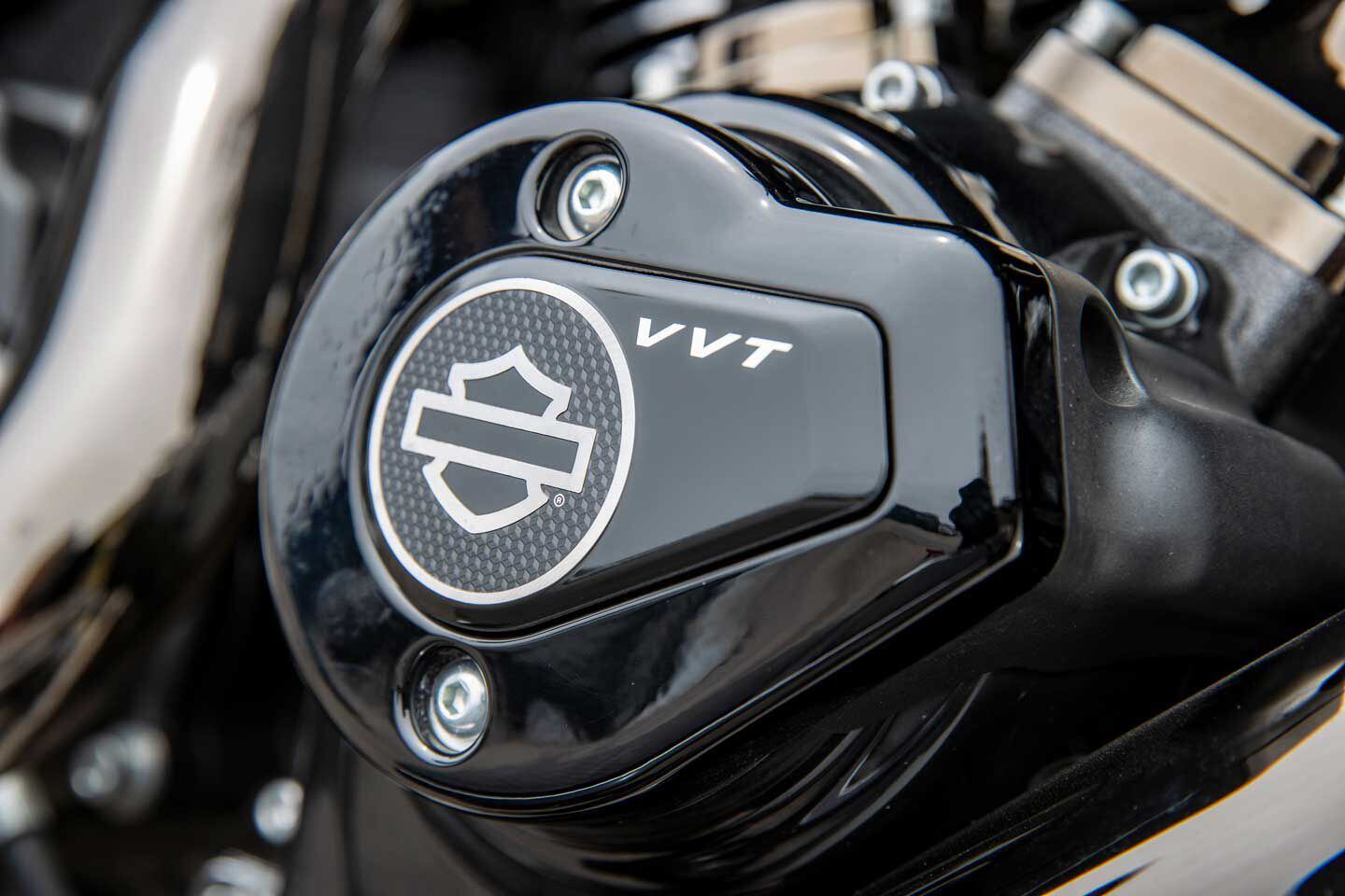

The VVT moves the single higher-lift and longer-duration cam through 40 degrees of adjustment (relative to the crankshaft), smoothing and increasing power across the rev range. VVT can be more effective working on separate intake and exhaust cams to control overlap (reducing it at low rpm smooths idle and reduces emissions, increasing it boosts high-rpm output), but because Harley-Davidson’s cams are generally turned for torque and use less overlap than your average Ducati, working on a single cam where the relative position of the intake and exhaust valves is fixed isn’t a big deal.
VVT works with a larger 4-liter airbox that feeds a 58mm (up from 55mm) throttle body and straighter, freer-flowing ports for the four-valve heads. Valve seats and combustion chamber are reshaped, the former providing better flow and the latter giving more squish and improved combustion. Combustion chamber changes and revised strategic liquid-cooling allowed a significant bump in compression from 10.2:1 to 11.4:1 versus the 117.
Piston diameter is the same as the 117ci Big Twin at 4.075 inches, but a very long 4.625-inch stroke helps this 1,977cc engine produce a claimed 139 lb.-ft. of torque at 3,000 rpm, and 115 hp at 4,500 rpm. This compares favorably to the non-VVT 117′s claimed numbers of 103 hp at 4,750 and 126 lb.-ft. at 3,500. For reference, the recent Breakout 117 we ran on the dyno made 118 lb.-ft. and 94 hp at the rear wheel (measured rwhp is usually about 7–15 percent lower than any factory’s claimed numbers). Claimed peak output increases for both horsepower and torque tracks with the roughly 4 percent increase in displacement between the 117 and 121, but the bigger engine feels like it has more area under these curves, meaning a broader spread of power. We will dyno the 121 VVT and get rear-wheel numbers as soon as a testbike is available. Harley-Davidson claims a potential 3–5 percent increase in fuel economy as well.
Harley’s new VVT system moves the higher-lift and longer-duration cam through 40 degrees of adjustment relative to the crankshaft.
Harley’s new VVT system moves the higher-lift and longer-duration cam through 40 degrees of adjustment relative to the crankshaft. (Jeff Allen/)

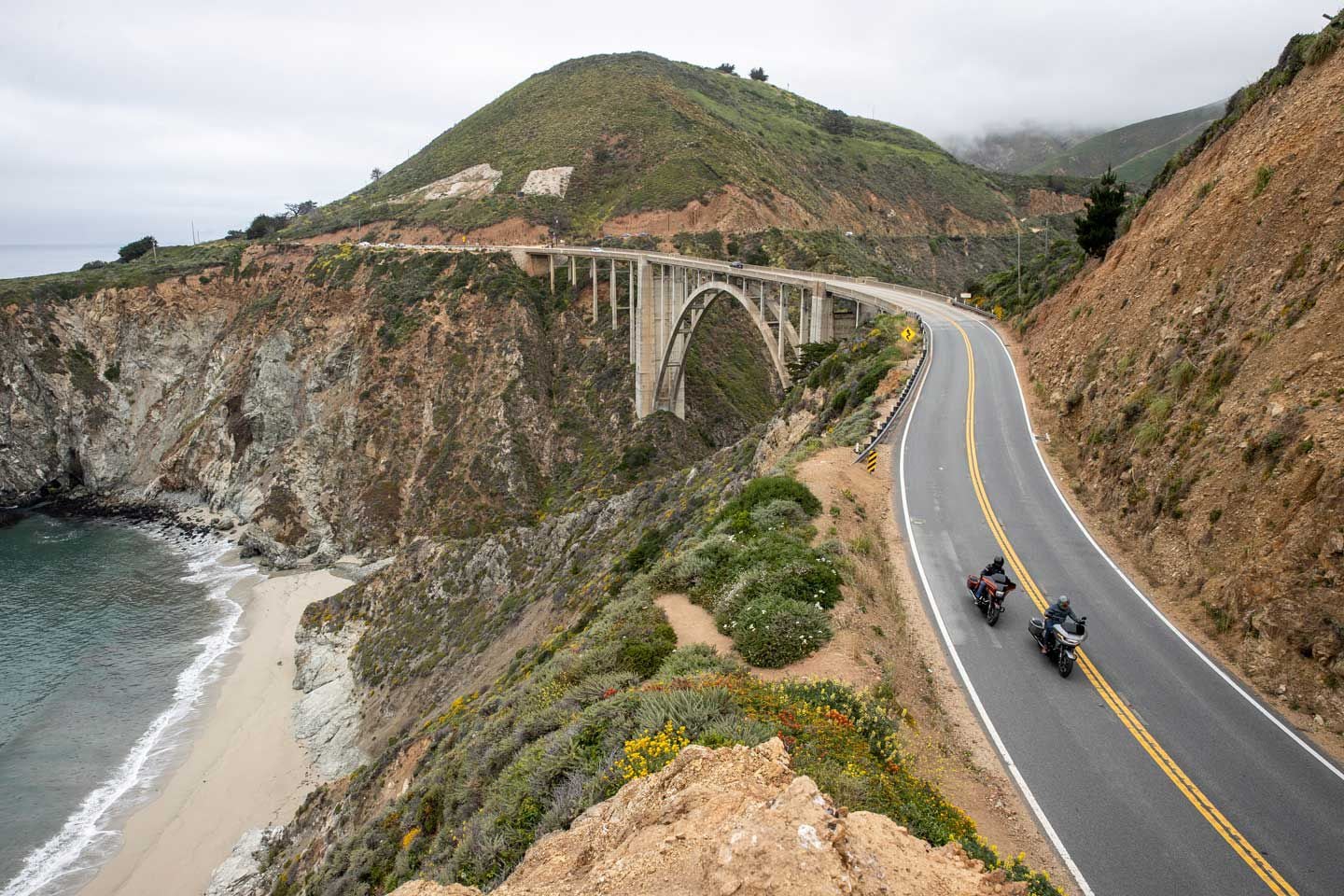

As we rode on California Highway 1 from Monterey south through Big Sur and to Lucia on our early first ride of the CVO Road Glide and Street Glide, we got an excellent mix of slow corners and 80-plus-mph straightaways, and it makes you think you’d like to see a 121 VVT in all the Big Twin bikes.
There are few roads better than California Highway 1 for testing touring cruisers.
There are few roads better than California Highway 1 for testing touring cruisers. (Jeff Allen/)

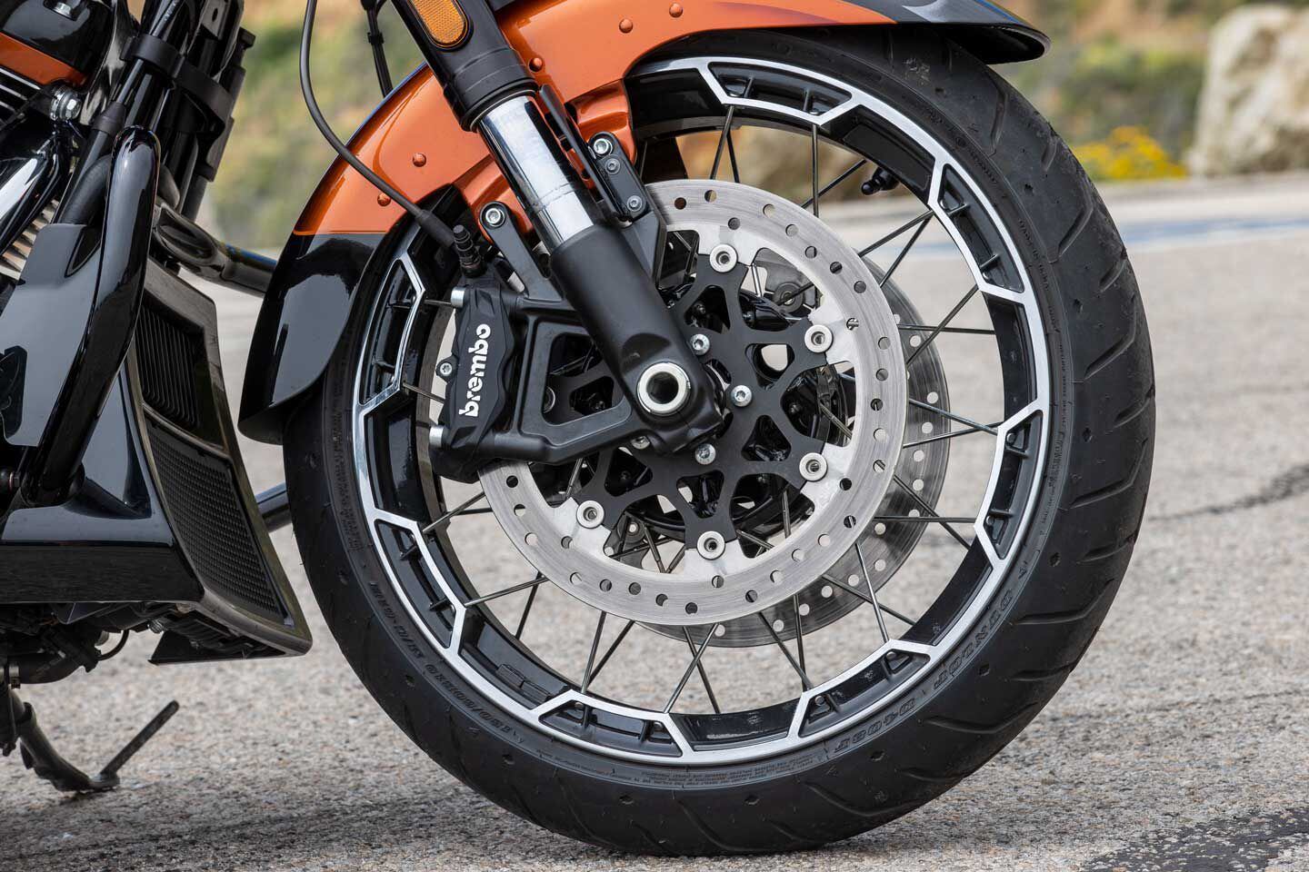

While the main frame with rubber-mounted engine is largely unchanged from the significantly upgraded 2009 Touring line, the CVO Road Glide and Street Glide have a new inverted 47mm Showa fork with 4.6 inches of travel, larger 320mm Brembo front floating disc brakes (up from 300), and Brembo-branded radial-mount calipers.
Brembo radial-mount calipers and 320mm discs increase the CVO Glides’ braking performance.
Brembo radial-mount calipers and 320mm discs increase the CVO Glides’ braking performance. (Jeff Allen/)

Front braking is lower effort and with better feel, these qualities combining with the stiffer fork to make for improved turn-in response, particularly when trail-braking into corners.

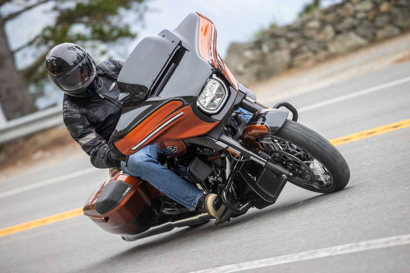

The CVO Glides lean a claimed 32 degrees left and right, where the previous version only gave you 31 degrees in left turns. Party in the engineering house! Kidding aside, the Softail Fat Bob offers 32 right/31 left, so the CVO Glides are officially the lean kings of the traditional Harley-Davidson models. For reference, LiveWire has 45 and Pan America has 42 degrees of stated lean angle.
Available lean angle is essentially the same as on previous touring models.
Available lean angle is essentially the same as on previous touring models. (Jeff Allen/)

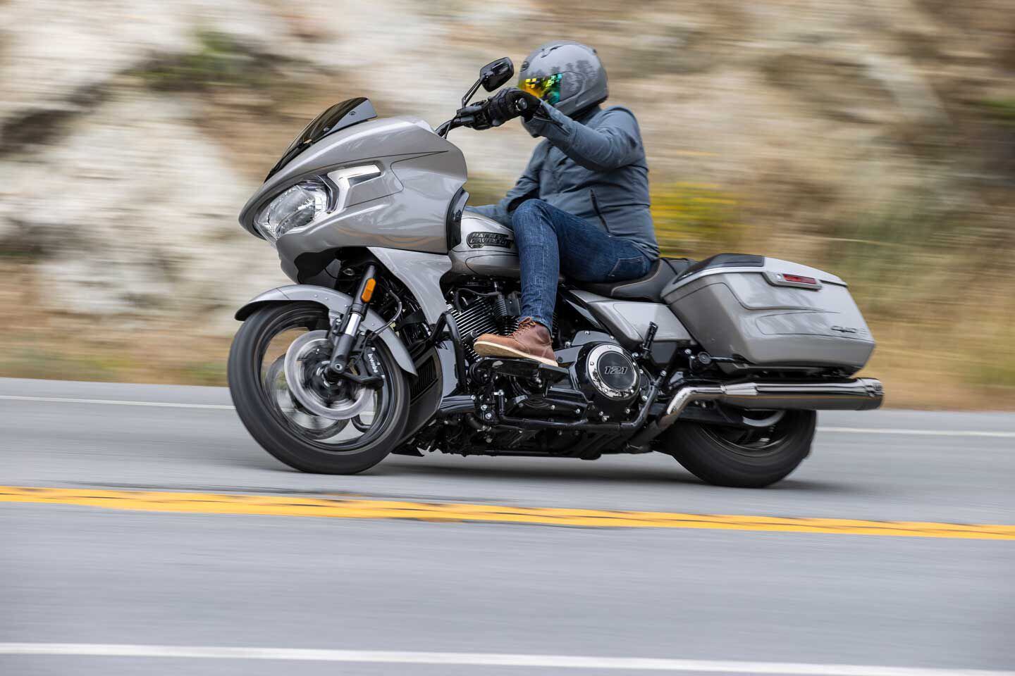

Although the Road Glide “rides bigger” thanks to the physical presence of that large dash and fixed fairing, its steering is lighter and more precise because that fairing is not attached to the fork. You are therefore steering only the mass of the fork and front wheel. Its riding position is also more open thanks to the sort of mini-ape handlebar.
Although the CVO Road Glide weighs more and has a more spacious cockpit, it steers lighter and is more planted in corners than the Street Glide.
Although the CVO Road Glide weighs more and has a more spacious cockpit, it steers lighter and is more planted in corners than the Street Glide. (Jeff Allen/)

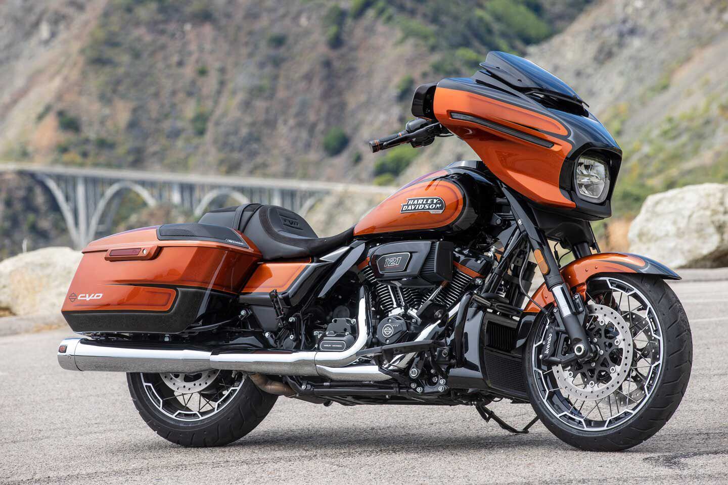

At high speeds, the CVO Street Glide’s fork-mounted batwing fairing affects steering and effort as well as front-end feel, making it less planted and slightly heavier-steering than the Road Glide.
At high speeds, the CVO Street Glide’s fork-mounted batwing fairing affects steering and effort as well as front-end feel, making it less planted and slightly heavier-steering than the Road Glide. (Jeff Allen/)

The Street Glide’s batwing fairing and the Road Glide’s fixed fairing are heavily reworked yet also instantly recognizable. Same goes for the reshaped 6.0-gallon fuel tank (expect 240-mile range based on our early fuel economy number) and slightly larger saddlebags. The 500-mile day on the previous Street Glide I mentioned reminded me that the fairing works pretty well up to about 60–65 mph, but buffeting and wind noise increase dramatically at speeds above this. Especially in the presence of trucks and/or under the influence of crosswinds.
The new Street Glide fairing is a big improvement in all regards, providing more still air at helmet level with reduced buffeting and lower wind noise.
Being behind the CVO Street Glide’s new batwing fairing is a nicer place to be than that of the previous generation.
Being behind the CVO Street Glide’s new batwing fairing is a nicer place to be than that of the previous generation. (Jeff Allen/)

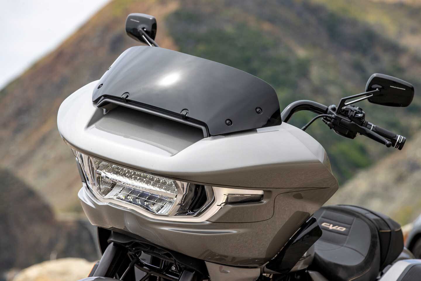

Same for the Road Glide. The fairing appears closer to the rider, which with changes in shape and windscreen design have resulted in smoother air. New taller flatter bars are surprisingly comfortable and I found them an improvement over the buckhorn design of the older Road Glide design.
Both bikes benefit from movable wind deflectors. The Street Glide’s are on the fork lowers and can be folded flat to let more air flow into the rider cockpit. The Street Glide gets adjustable “Willie Wings” that function similarly, and are particularly effective.
Just like the CVO Street Glide, the Road Glide’s new frame-mounted fairing provides improved air management.
Just like the CVO Street Glide, the Road Glide’s new frame-mounted fairing provides improved air management. (Jeff Allen/)

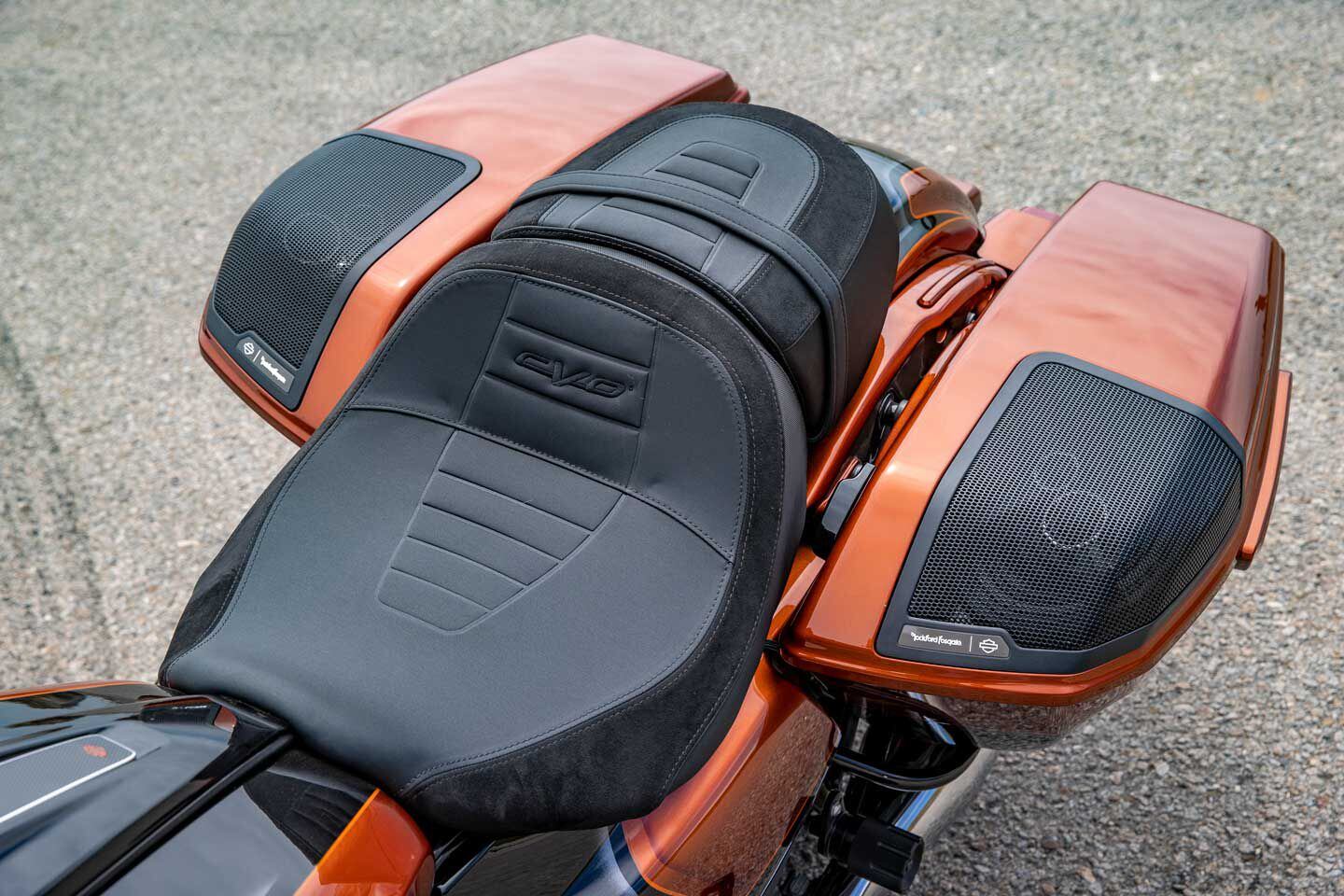

I did not think of the reshaped seat once during our long day in the saddle. Harley says the new contour results in a more “neutral” back position, and not thinking of the seat is an indication of success.
A good seat is one you don’t think about, and this was the case for the reshaped piece on both the CVO Road and Street Glide.
A good seat is one you don’t think about, and this was the case for the reshaped piece on both the CVO Road and Street Glide. (Jeff Allen/)

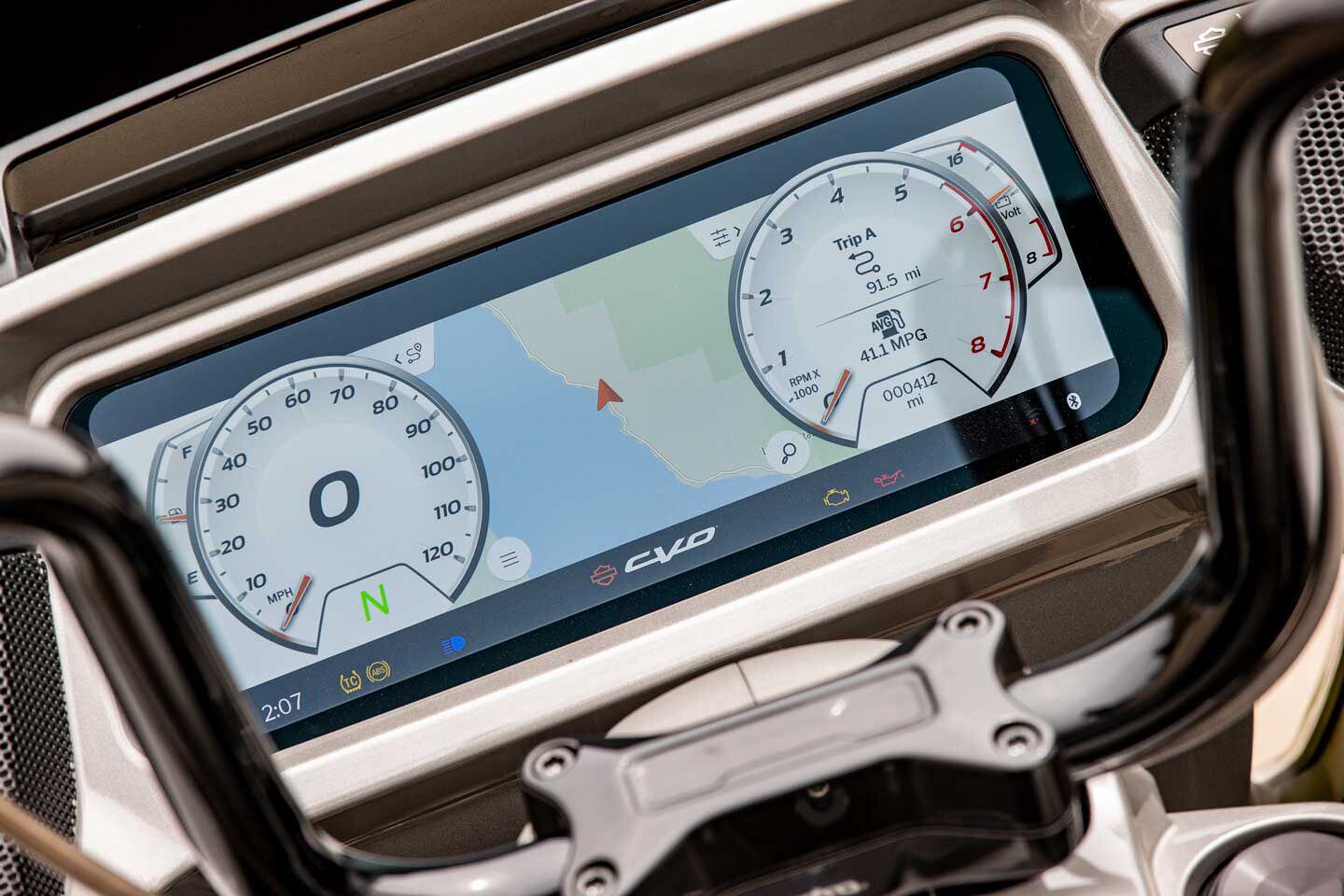

Ride modes and nearly everything else on the 2023 CVO Road Glide and Street Glide is accessed using the very wide 12.8-inch diagonal TFT touchscreen.
A 12.8-inch TFT touchscreen is the command center of the new CVO Glides’ electronics and infotainment.
A 12.8-inch TFT touchscreen is the command center of the new CVO Glides’ electronics and infotainment. (Jeff Allen/)
Functionality during our one-day ride was good, and gloved hands worked just fine for poking through (many) options. There are also screen-navigation buttons on both of the new switch-gear pods that allow for most functions to be controlled by the rider without removing hands from grips. I found using the nav buttons a bit more challenging than just straight up poking things on the screen with my finger, but it was just a day ride, so we’ll revisit this when we get more seat time.

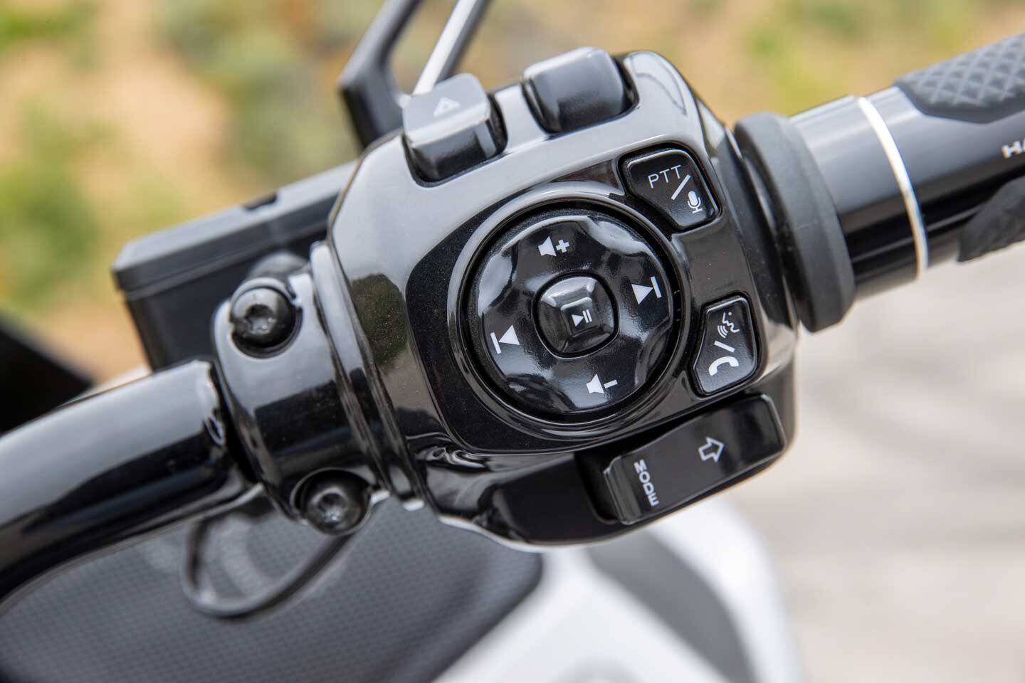

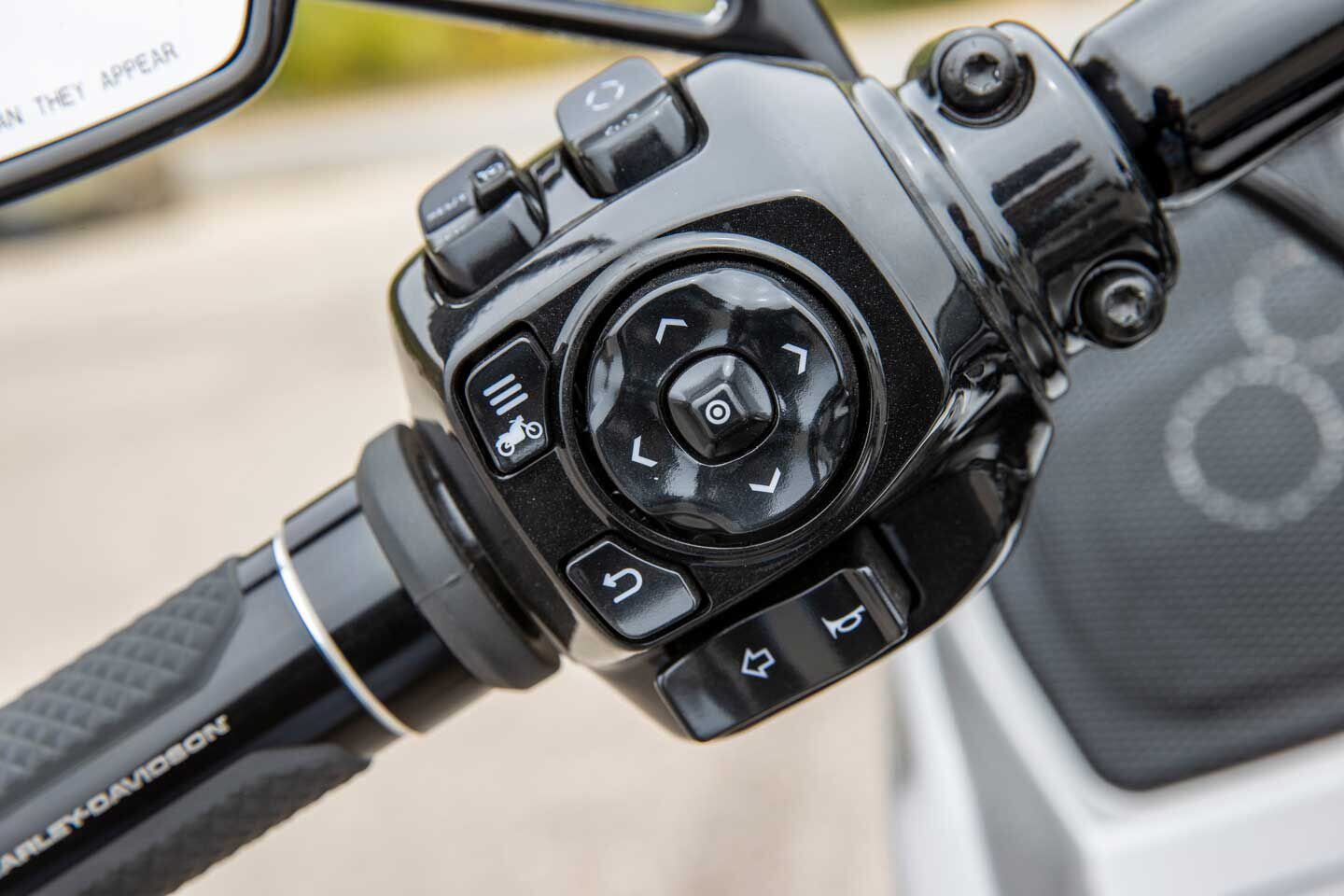

It will take some time to commit all of the switch gear on the 2023 CVO Road Glide and Street Glide to memory. This is roughly half of them.
It will take some time to commit all of the switch gear on the 2023 CVO Road Glide and Street Glide to memory. This is roughly half of them. (Jeff Allen/)And here’s the other half.
And here’s the other half. (Jeff Allen/)
It was clear Harley-Davidson was still working out a few coding quirks in this complex system as we would sometimes lose one of the widgets (tire pressure/engine temp block and the like) in one of the three display modes: Cruise, Sport, and Tour. Each display mode organizes the gauges, apps, and widgets differently to suit the intended riding. There are no mechanical gauges—tachometer, speedometer, and the rest is all fully digital on the screen.

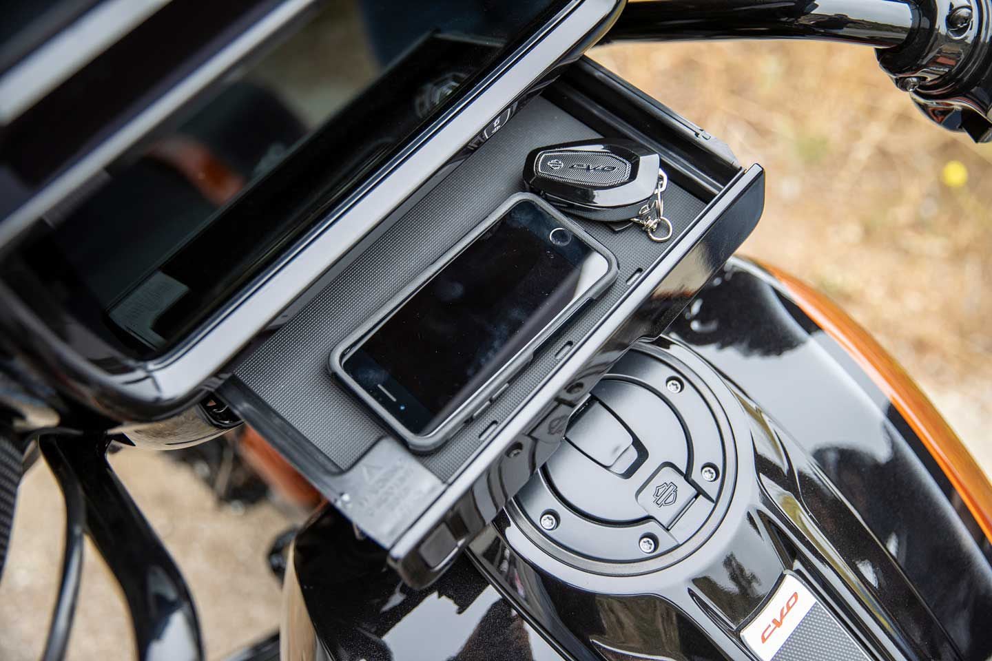

A massive slide-out drawer in the CVO Street Glide’s fairing has room for all the phones.
A massive slide-out drawer in the CVO Street Glide’s fairing has room for all the phones. (Jeff Allen/)
