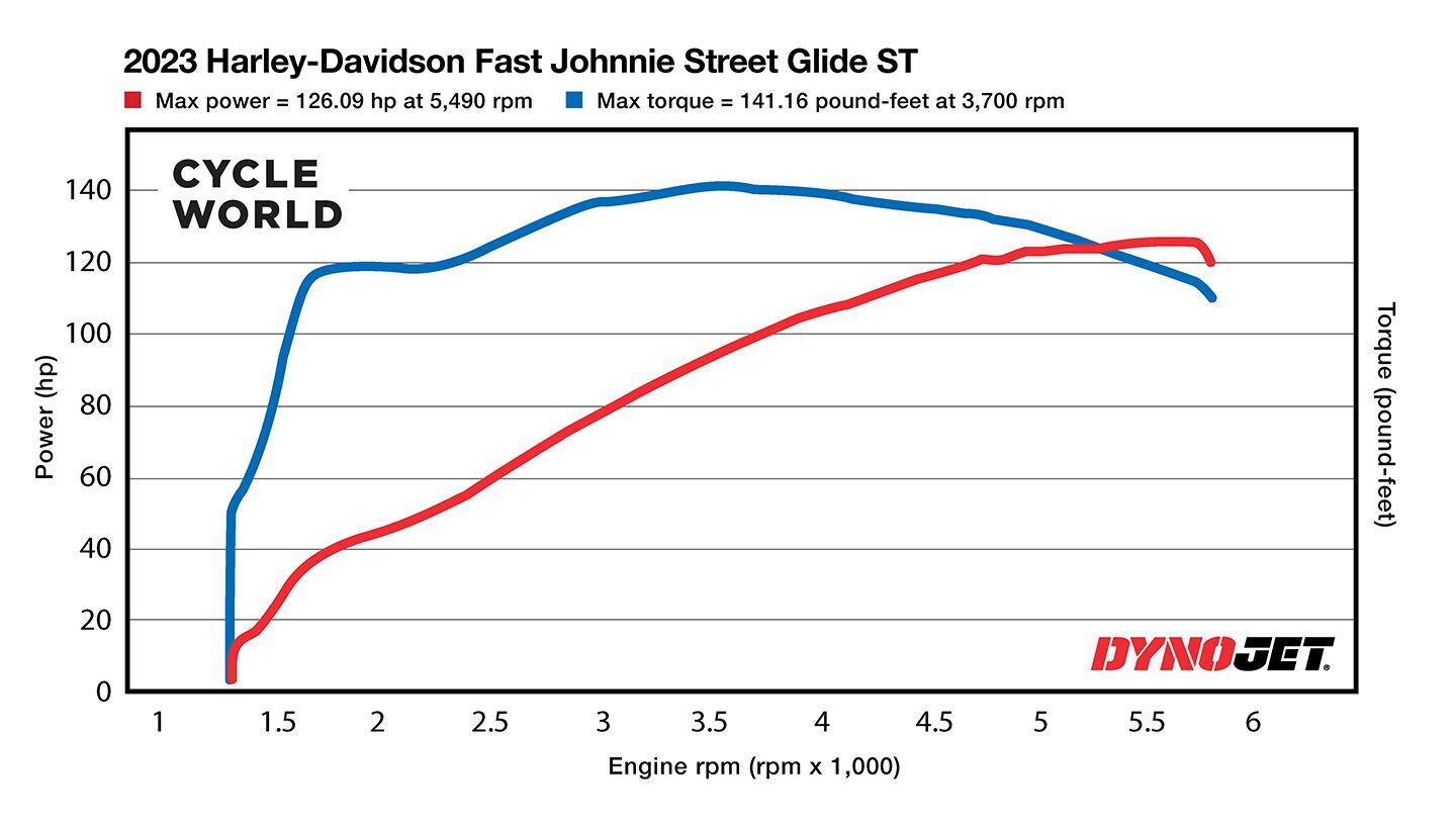

2023 Harley-Davidson Fast Johnnie Street Glide ST With 135 Crate Engine Dyno Chart.
2023 Harley-Davidson Fast Johnnie Street Glide ST With 135 Crate Engine Dyno Chart. (Robert Martin/)
On the Cycle World Dynojet 250i dynamometer, the 2023 Fast Johnnie Street Glide ST with 135 crate engine produced 126.1 hp at 5,490 rpm and 141.2 lb.-ft. of torque at 3,700 rpm. That’s 34.1 percent more hp and 19.7 percent more torque at the rear tire than the 117ci mill in the Breakout. For those wanting the most powerful street-legal Harley-Davidson engine available, it will cost you $7,999.95. But there is one stipulation: It’s 49-state US EPA compliant, meaning it’s not for sale in California for use on public roads.
