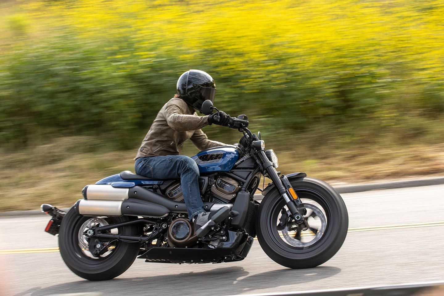

The Sportster S feels right at home on city streets. The real fun comes when you can crack the throttle on the Revolution Max 1250T engine.
The Sportster S feels right at home on city streets. The real fun comes when you can crack the throttle on the Revolution Max 1250T engine. (Jeff Allen/)
It might feel strange reading about “going farther” on the Sportster S and “tackling the canyons,” but that’s what happens when you have an engine that’s as capable and fun as the Revolution Max 1250T, which is in many ways the best part of this bike.
VVT makes all the difference, allowing the engine to be smooth and controllable off idle but open up as the digital rev counter sweeps past 4,000 rpm. This is an extremely free-revving powerplant that isn’t limited in any situation, with a usable spread of power and enough over-rev past 7,000 rpm to keep you from constantly shifting. There’s very little heat from the engine or high-mount exhaust. The only real component we don’t love is the clutch, which has a light pull but limited feel through the lever travel. This can make it tough to launch the Sportster S when leaving a stoplight, especially if you’re using one of the less-responsive riding modes.
