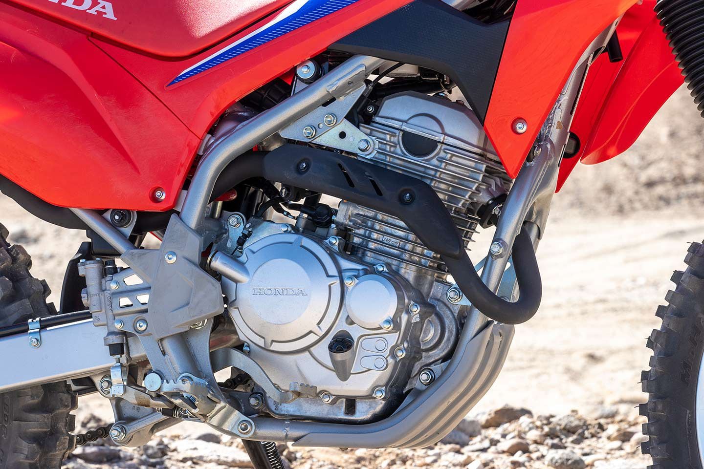

Featuring a larger engine than its predecessor along with electronic fuel injection (EFI) and electric start, the CRF250F is ready for the roaring twenties (2020s, that is). On our in-house Dynojet 250i rear-wheel dynamometer, the quarter-liter Honda made 20.1 hp at 7,500 rpm and 15.5 lb.-ft. of torque at 6,000 rpm. The rev limiter kicked in at 9,100 rpm.
Honda’s 249cc air-cooled single-cylinder engine produces 20.1 hp at 7,500 rpm and 15.5 lb.-ft. of torque at 6,000 rpm.
Honda’s 249cc air-cooled single-cylinder engine produces 20.1 hp at 7,500 rpm and 15.5 lb.-ft. of torque at 6,000 rpm. (Jeff Allen/)
The CRF’s SOHC four-valve powerplant impressed with its linear powerband and quick-revving nature. It has good, usable power throughout the entire rpm range. A large part of our time testing this model was on tight single-track and picking our way through rock gardens, where lugging the bike around in second gear wasn’t a problem. With plenty of bottom-end to blip the bike out of corners or up over rocks, the CRF250F was easy to ride in tight and technical terrain.

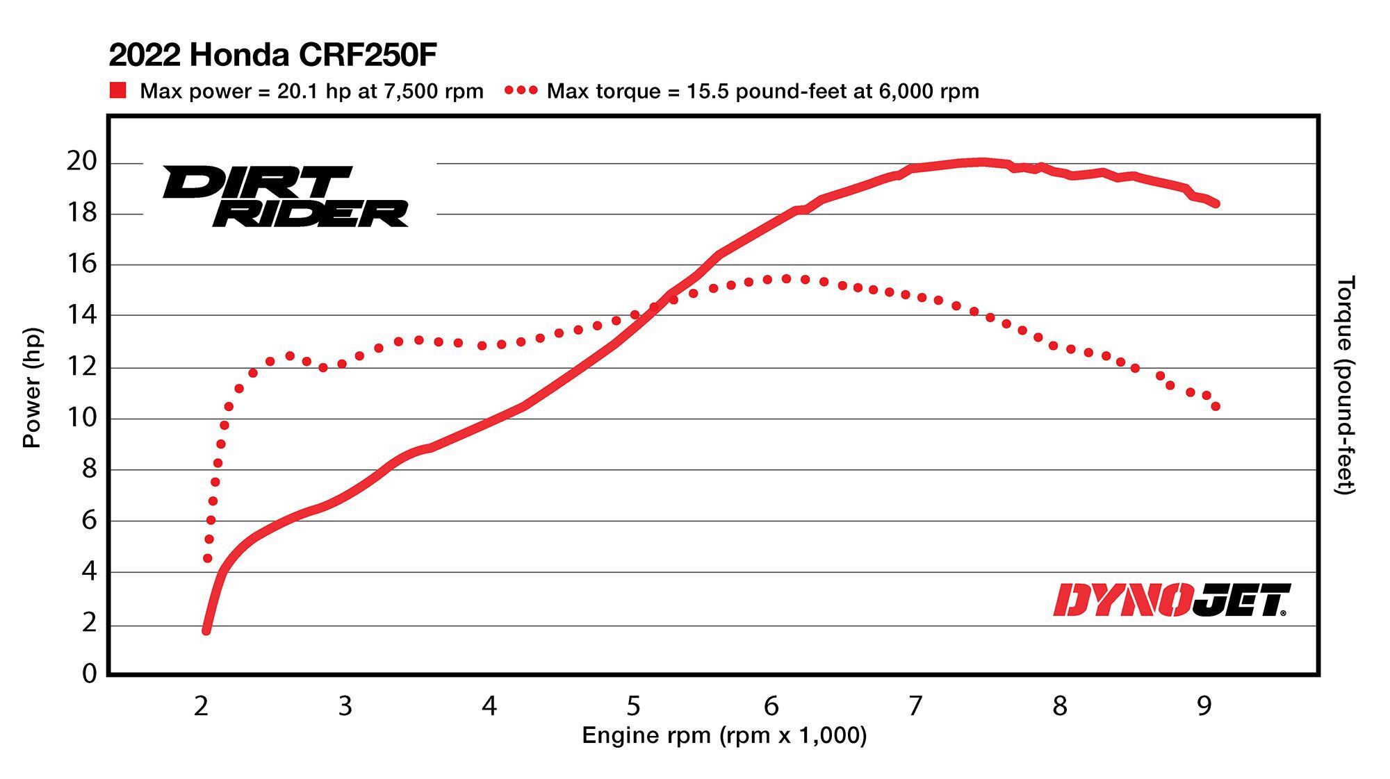

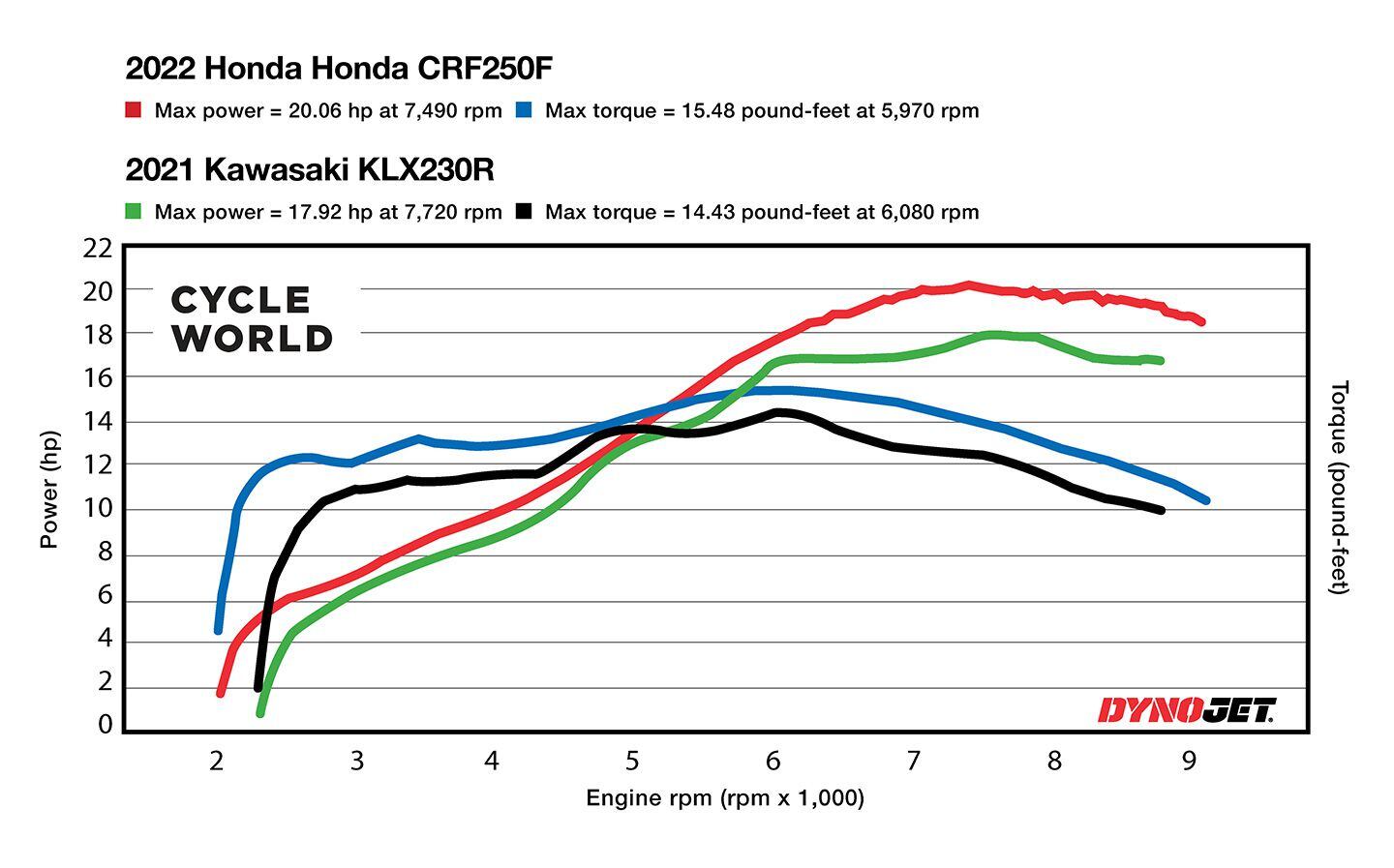

With a 17cc (6 percent) displacement advantage and larger throttle body, the Honda CRF250F produces more power than the Kawasaki KL230R throughout the entire rev range.
With a 17cc (6 percent) displacement advantage and larger throttle body, the Honda CRF250F produces more power than the Kawasaki KL230R throughout the entire rev range. (Robert Martin/)2022 Honda CRF250F Dyno Chart.
2022 Honda CRF250F Dyno Chart. (Robert Martin Jr./)

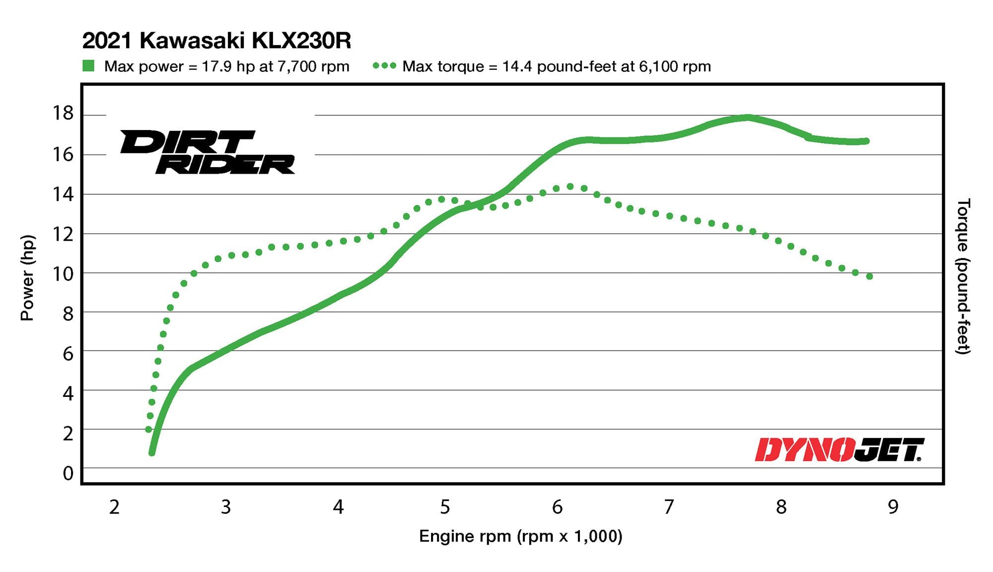

Team Green’s KLX230R is slightly down on power compared to its red rival, as would be expected given its 17cc (6 percent) displacement disadvantage. The green machine’s fuel-injected SOHC engine produced 17.9 hp at 7,700 rpm and 14.4 lb.-ft. of torque at 6,100 rpm on our dyno. At peak, that’s 2.2 hp and 1.1 lb.-ft. of torque less than the CRF250F, which is 11 percent less horsepower and 8 percent less torque. That’s not insignificant, but it also comes down to how the power is delivered.
The 2022 Kawasaki KLX230R is powered by a 233cc four-stroke, air-cooled single-cylinder engine.
The 2022 Kawasaki KLX230R is powered by a 233cc four-stroke, air-cooled single-cylinder engine. (Jeff Allen/)
From the seat of the pants the KLX230 seems to have a stronger midrange pull than the CRF250F, but after reviewing the dyno curves, it’s clear the Honda produces more horsepower and torque throughout the entire rpm range. That seat-of-the-pants midrange pull feeling? It comes from the fact that the Kawasaki’s torque curve is not as linear as the Honda’s. The Kawasaki has a sudden spike in torque around 4,400 rpm that makes the midrange feel stronger than it actually is because of how rapidly output rises. Power delivery is a little flat down low and doesn’t hang on as long on top as does the Honda, but the Kawasaki KLX230R feels perky and fun (partly because of that initial spike) in the midrange. Peak horsepower occurs roughly 1,000 rpm before the 8,800 rpm rev limit.
2021 Kawasaki KLX230R Dyno Chart.
2021 Kawasaki KLX230R Dyno Chart. (Robert Martin Jr./)Trail bikes’ friendly nature encourages riders to take alternative lines.

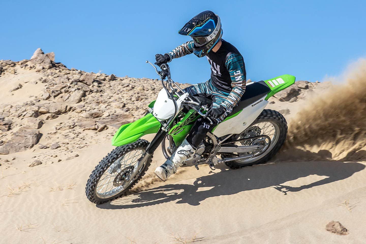

The short 53.5-inch wheelbase of the KLX230R aided in quick turns when sand surfing.
The short 53.5-inch wheelbase of the KLX230R aided in quick turns when sand surfing. (Jeff Allen/)
