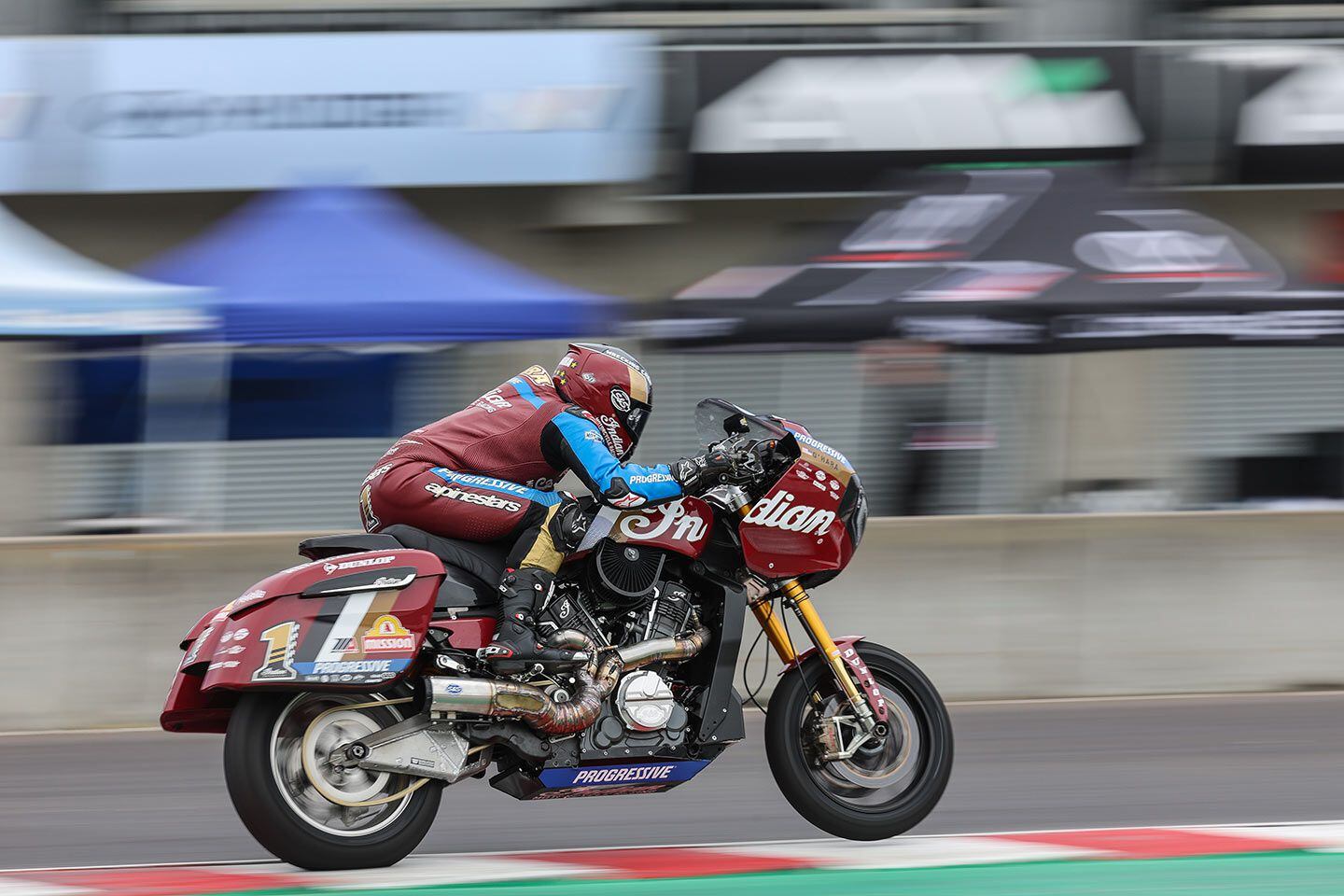

Looking at Indian’s KOTB bike back in the work area, I could see a modern Öhlins fork, mounted in 2-inch-dropped S&S crowns (that means that the tops of the fork tubes were 2 inches below the top of the crown’s center). At the rear, a similar jack-up is accomplished by giving the braced swingarm a pronounced droop angle. Rear suspension is by a single Öhlins unit and linkage located to left of center. My tape measure told me the pegs are 20 inches off the pavement.

In order to achieve the greatest amount of cornering clearance while adhering to KOTB rules regarding frames the Challenger’s ride height is raised.
In order to achieve the greatest amount of cornering clearance while adhering to KOTB rules regarding frames the Challenger’s ride height is raised. (Brian J. Nelson/Indian Motorcycle/)
At least part of the reason these bikes change direction so fast may be their increased height: With both tire footprints effectively at the ends of long levers, steering the wheels out from under the bike is highly effective (countersteering).

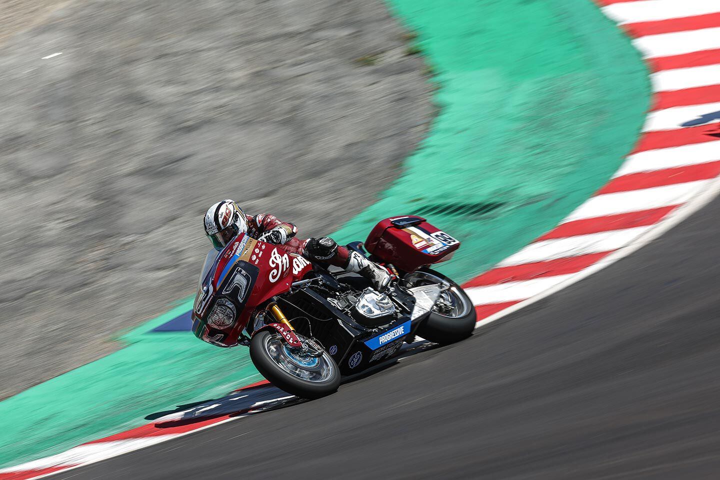

Tyler O’Hara’s crew chief Al Ludington told me the raised Challenger can now reach a 55-degree lean angle but he believes the tires will allow another five degrees, but only if the front engine hangers can be kept from hitting the pavement.
Harley’s KOTB bikes appear to have their engines a bit higher and farther forward, but Indian’s problem-of-the-moment is grounding of the forward engine mount struts (this brought McWilliams down once in practice, leaving a long gouge in the pavement). Those vertical struts enclose the coolant radiator between them, with the battery and related parts carried under the radiator.

Indian’s KOTB Challenger could achieve another five degrees of lean angle if not for the front engine hangers.
Indian’s KOTB Challenger could achieve another five degrees of lean angle if not for the front engine hangers. (Brian J. Nelson/Indian Motorcycle/)
Raise the bike even more? The problem here is that McWilliams’ bike is already at the limit of his height, slid to an extreme side-saddle position to hold the bike upright on the starting grid. O’Hara’s bike was raised a bit more because he’s taller. Three-inch boot soles, anyone? Seriously, some riders have resorted to this!

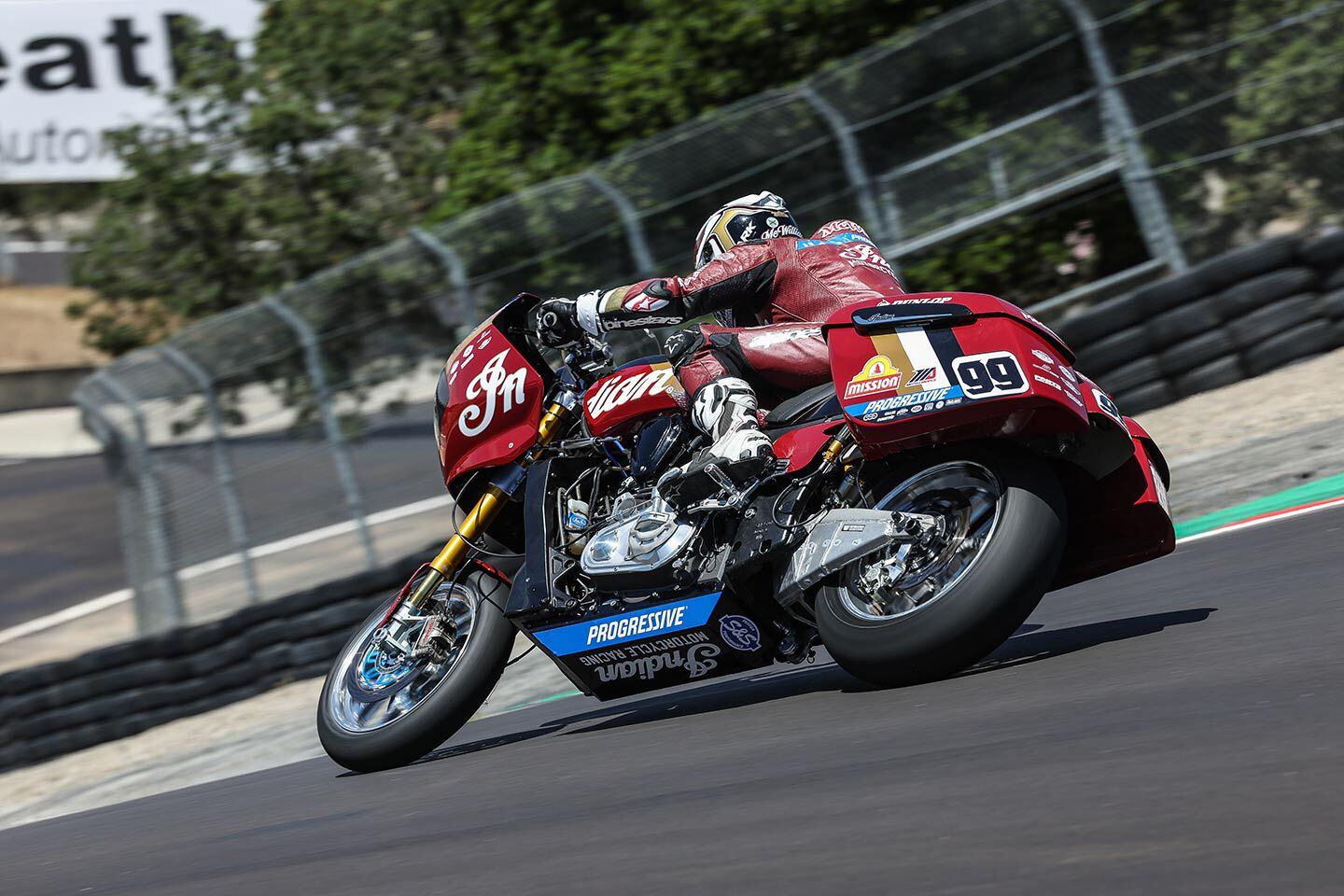

Watching O’Hara and McWIlliams exit corners accelerating hard, engines bellowing, with back tires visibly and smoothly drifting sideways persuaded me that these bikes have excellent grip. This is despite the fact that their Dunlop slicks were made for much lighter bikes. How could this be?

There’s no shortage of grip on the KOTB Challengers.
There’s no shortage of grip on the KOTB Challengers. (Brian J. Nelson/Indian Motorcycle/)
Then I thought of sprung/unsprung weight ratio. Just as in the case of trying to make valves and tappets follow a cam profile, the normal way to improve this is by making the moving parts (valves and tappets, or wheels and tires) lighter. But in the case of KOTB’s 620-pound minimum weight, this ratio is improved by the large sprung weight—about 75 percent greater than that of a MotoGP bike.
And in Superbike and MotoGP there is always a compromise between suspension soft enough to generate mechanical grip (the ability of the wheels to track over pavement irregularities without upsetting the vehicle or getting air) and stiff enough not to bottom during hard braking or cornering. Stiff enough also to allow the rider to launch sudden maneuvers with little suspension delay.
The result of this compromise can be that point-and-shoot riders may do their best lap times on bikes set up stiff enough to lose some midcorner grip to skating because they need stiff suspension for stable braking and prompt corner entry.
No skating was interfering with the Indians’ grip!

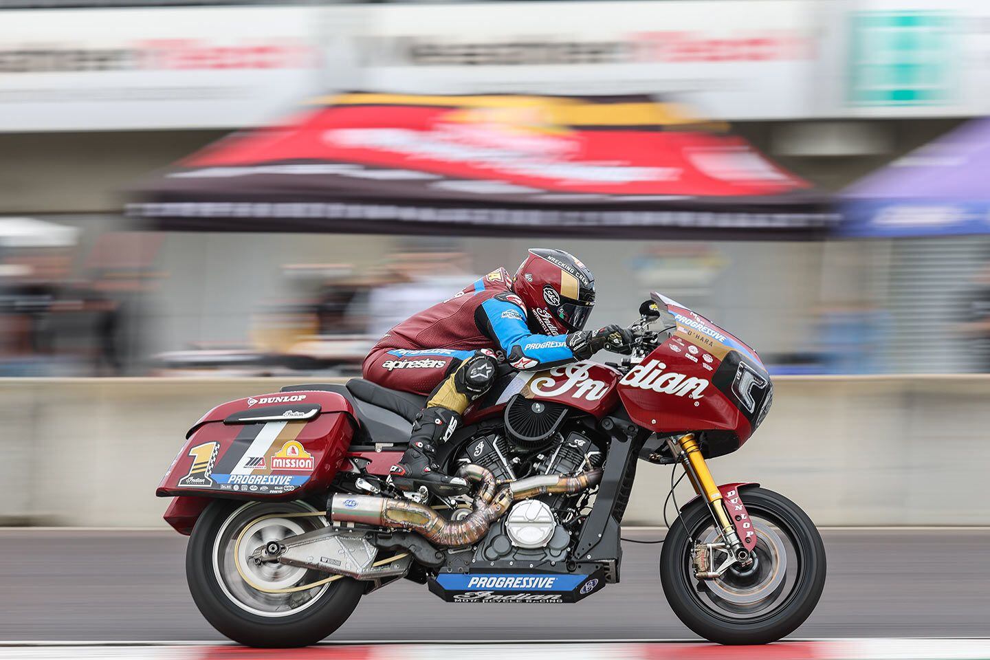

The swingarm begins life as the cast aluminum stock part, but for racing it has precisely cut welded-on sheet under-bracing to stiffen it. The left beam looks to be about 20mm thick: the right, more like 30. Bailey says a CNC-machined arm may be next (just as a proper slipper clutch is coming to help with engine-braking issues).
Watching the rapid development of Indian’s KOTB’s racebikes has been exciting—much like the early days of Superbike racing.
Watching the rapid development of Indian’s KOTB’s racebikes has been exciting—much like the early days of Superbike racing. (Brian J. Nelson/Indian Motorcycle/)
