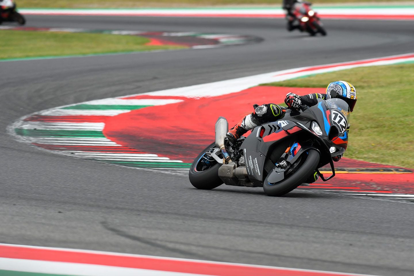

We were invited to test the M 1000 RR at the breathtaking Mugello MotoGP circuit in northern Italy. Not only did we have the Tuscany circuit’s sublime asphalt to help us test all this aero theory, but also two-time World Superbike champion Troy Corser to show us how to extract the best from the beast.
As a homologation special, the M lacks the DDC semi-active suspension found on a stock S 1000 RR, so we had first to spend a little time setting up both ends to match the track and Bridgestone slick tires. Once done, with help from Racing School Europe and Troy, there was the opportunity to push the limits in safety over the three days of intensive testing.
I’ve ridden Mugello many times before, but I don’t think I’ve ever lapped so quickly and with such ease. While the M looks angry enough to scare your pants off in the pit lane, out on track it carries lots of calm and composed corner speed, fueling its rider with the self-confidence of a race pro.
BMW’s M 1000 RR allows the rider to ride harder with less effort than the S 1000 RR it’s based on.
BMW’s M 1000 RR allows the rider to ride harder with less effort than the S 1000 RR it’s based on. (BMW/)
The combination of chassis, suspension, and new aero package gives you the minerals to seriously attack corners. Even after three days of fast testing the M was still a surprise as it ran ever faster into the apex. At what would be considered extreme lean angles it felt consistently planted and controlled, still nowhere near the limit despite elbow sliders skimming across the painted historic curbs of Mugello.

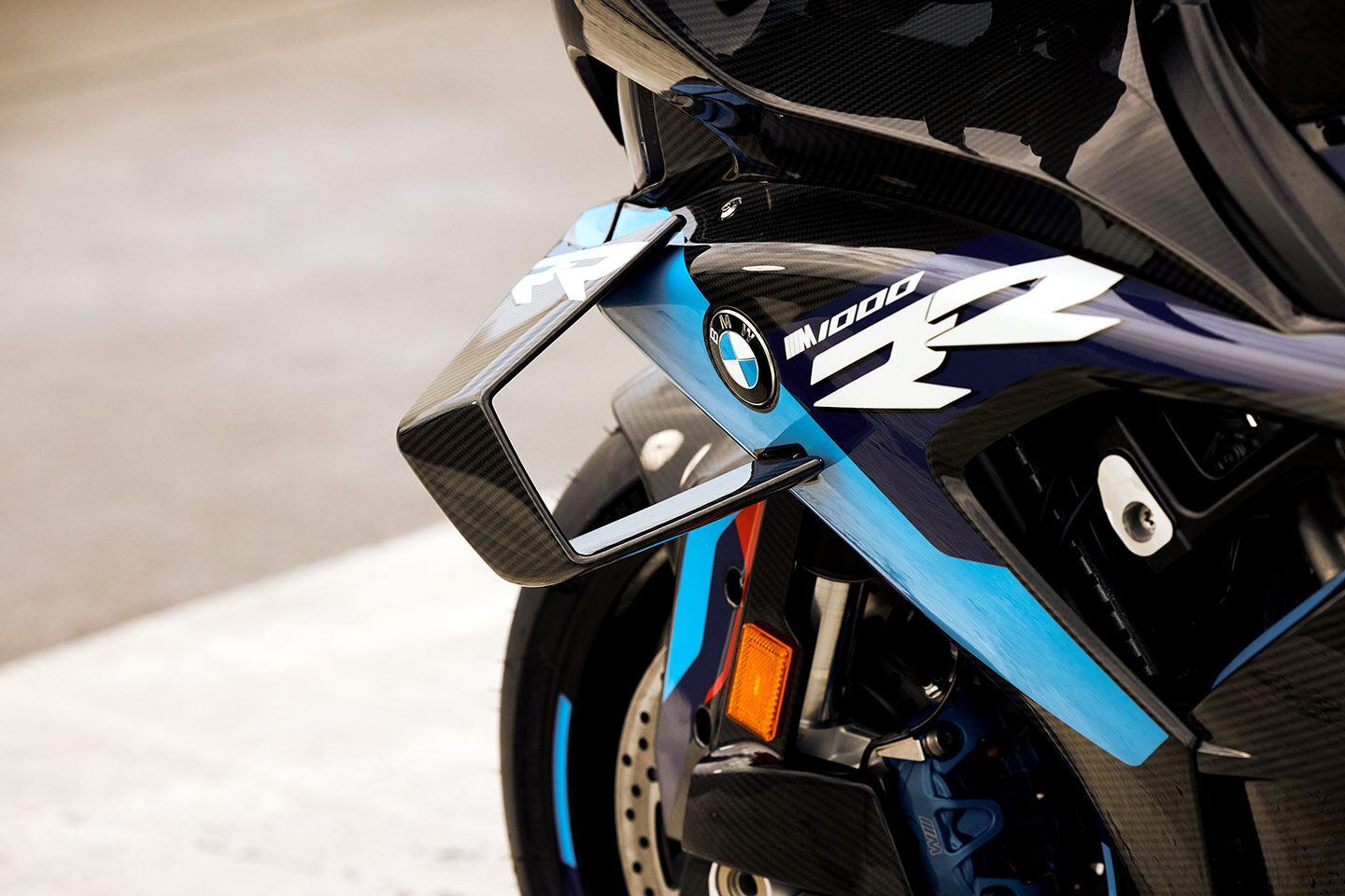

Nearly 50 pounds of downforce are produced by the M 1000 RR’s winglets at 186 mph.
Nearly 50 pounds of downforce are produced by the M 1000 RR’s winglets at 186 mph. (BMW/)
It’s hard to quantify how much the wings improve the riding experience or cut lap times for each rider, but the M’s feel, feedback, and stability at the front end are intoxicating, lifting normal track riders like me to a level never experienced beyond a video game. According to BMW the new wings produce 3.5 pounds more downforce at 93 mph than the 2022 M 1000 RR; 6.2 pounds more at 124 mph; and 9.5 pounds more at 155 mph. At 186 mph, which was hit almost every lap on the home straightaway, the new M produces 49.8 pounds of downforce, 13.9 pounds more than before.
Fact is, when the M hit the notorious crest at the end of the straight, it remained planted at 186 mph. So stable and predictable, in fact, that I could in theory have taken one hand off the bars to wave at our photographer had there not been some heavy braking to be done for turn 1.

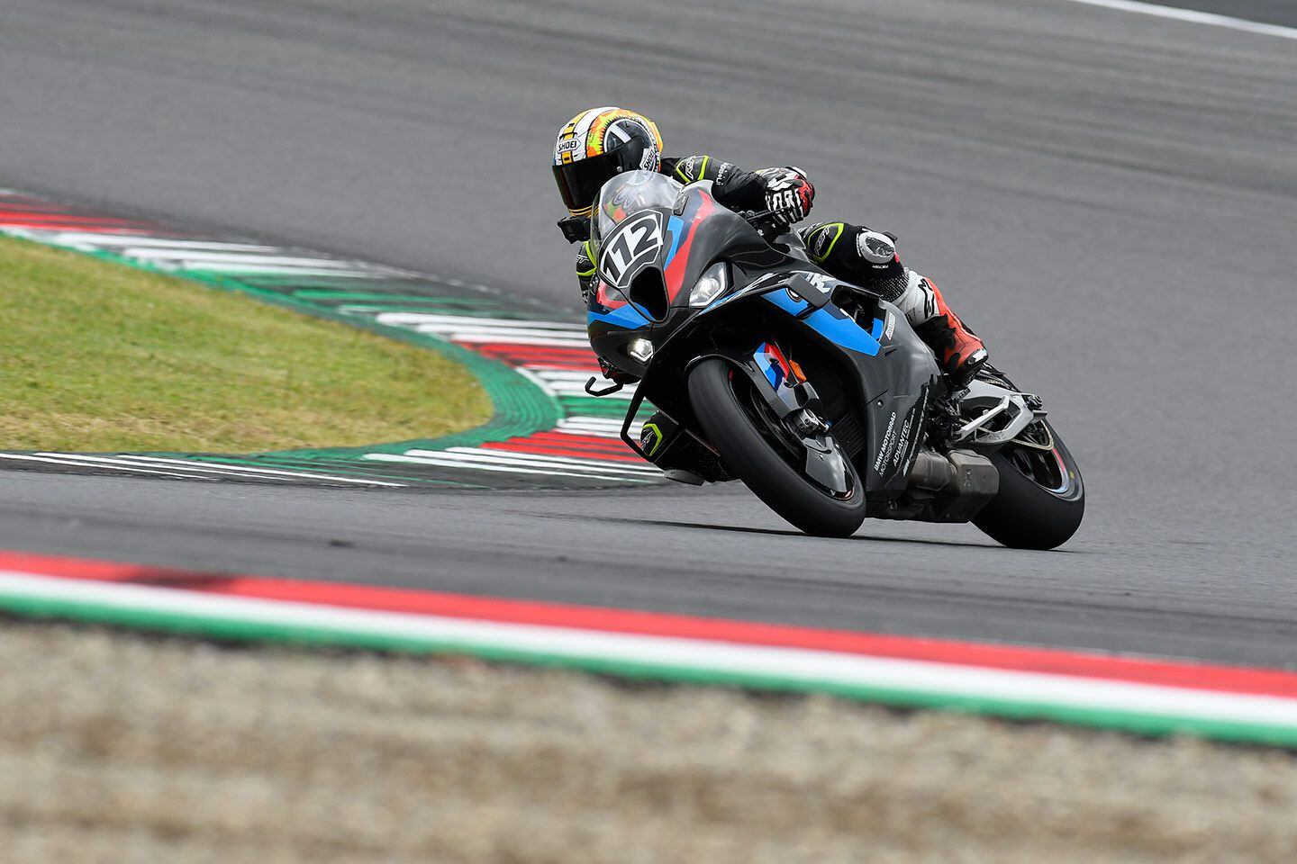

Yes, the M’s inline-four loves to rev, and revs on happily to 15,000 rpm, and I was told by Troy to make use of every last rpm. According to the experts, it’s preferable to take the final turn at Mugello in second gear, to go deep, then cut back, pick the bike up, and get on the power early. Then it’s a matter of holding the throttle wide open and snicking through the gears on the smooth and, for this test, reverse-pattern quickshifter.
At which point the M blows your mind. Over that crest at the end of the straight, the M’s digital speedo passed 186 mph every lap. So long as there was a good drive out of the final turn while staying tucked, it’s relatively easy to reach that speed. Try not to miss your braking marker…
Some laps the M hit over 189 mph before I hit the stoppers. What’s more, this road-legal bike, remember, was still accelerating—all while the tach showed 14,000 rpm and still not reaching peak power, let alone the rev limiter at 15,100 rpm.
The S 1000 RR is a superbike capable of seriously quick lap times, but the M was noticeably quicker off the turns and revs freer too. Despite my best efforts, I couldn’t coax the S 1000 RR to the magic 186 mph (300 kph) at the end of the Mugello straight. Ride the two machines back to back, and the way the M accelerates between Mugello’s chicanes is pure racebike. You can feel the electronic rider aids working overtime, balancing low, hovering wheelies with relentless traction—hundredths, tenths, even whole seconds falling away from your normal lap time.

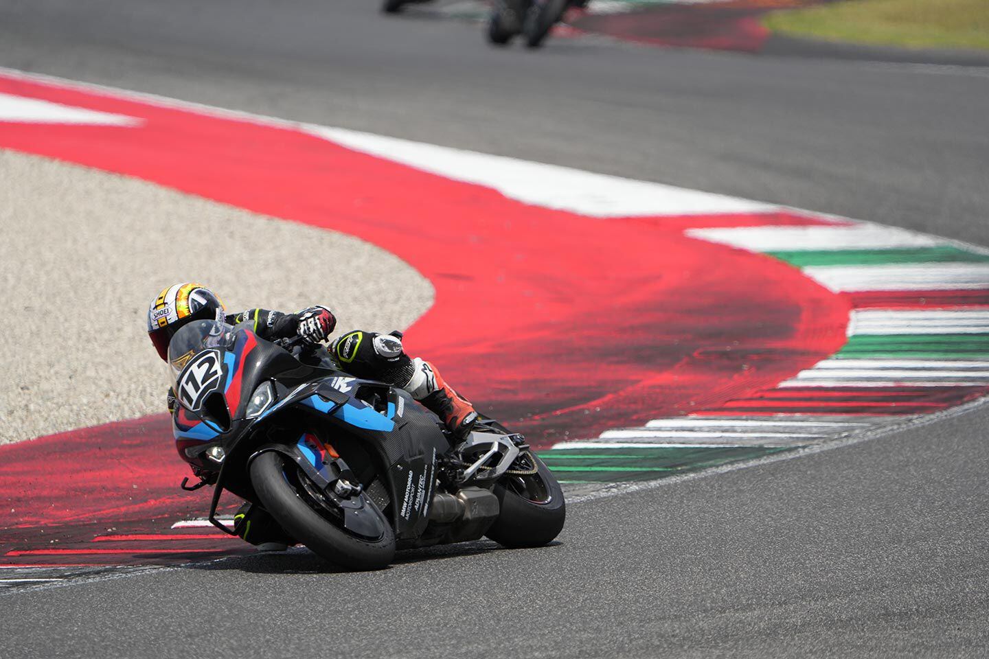

The 2023 M 1000 RR’s brake setup remains the same as the previous M’s, but in theory has to do so from a higher top speed. Mugello is very hard on the brakes. Slowing from 186 mph in sixth gear to a second-gear hairpin is a big ask lap after lap, but the M-stoppers stayed free of fade and were consistent, allowing us to push the brake marker further down the track with confidence. This could be attributed to the new ducts which cut the temperature of the radially mounted M brake calipers and disc by 50 degrees Fahrenheit under track conditions.
Despite its ferocious power and speed, the M is focused on making life as easy and stress-free for the rider as possible. Lightness, protective bodywork, and superlative electronic rider aids make a difference on track. Even when pushing for lap times in 30-degree-plus heat there’s less rider fatigue—the same should be true for the road. The sizable bodywork and tall screen give your upper body a relatively easy time, cocooned from turbulence once tucked.
