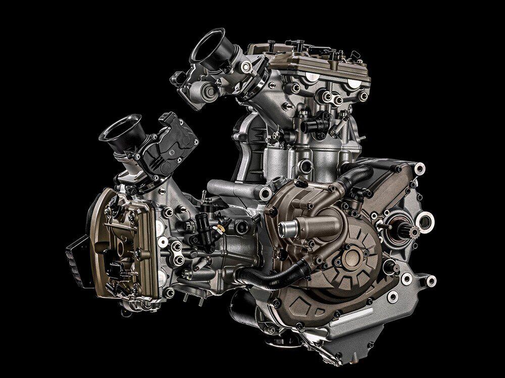

Ducati has been using VVT with its DVT system since 2014.
Ducati has been using VVT with its DVT system since 2014. (Ducati/)
The idea is that the intake cam timing can be retarded at low speed, reducing the amount of valve overlap—the period when the intake valves open in a cylinder before the exhaust valves have closed. To efficiently fill a cylinder with fresh intake charge at high rpm, lots of valve overlap is beneficial, but at low revs the same amount of overlap allows unburned mixture to escape into the exhaust, polluting catalytic converters, harming fuel economy, and increasing emissions. By altering the intake cam timing depending on revs, you can have the best of both worlds, with lots of high-rpm overlap but far less at low rpm.
Conventional cam phasers, as seen on Suzuki’s new patent, use oil pressure to change the cam timing. The cam phaser sits between the intake cam sprocket and the camshaft itself, allowing the camshaft to be rotated by a few degrees in relation to the sprocket when oil pressure is introduced to the phaser. An electric solenoid, activated by the engine management system, controls a valve to open or close the oil passage to the phaser.

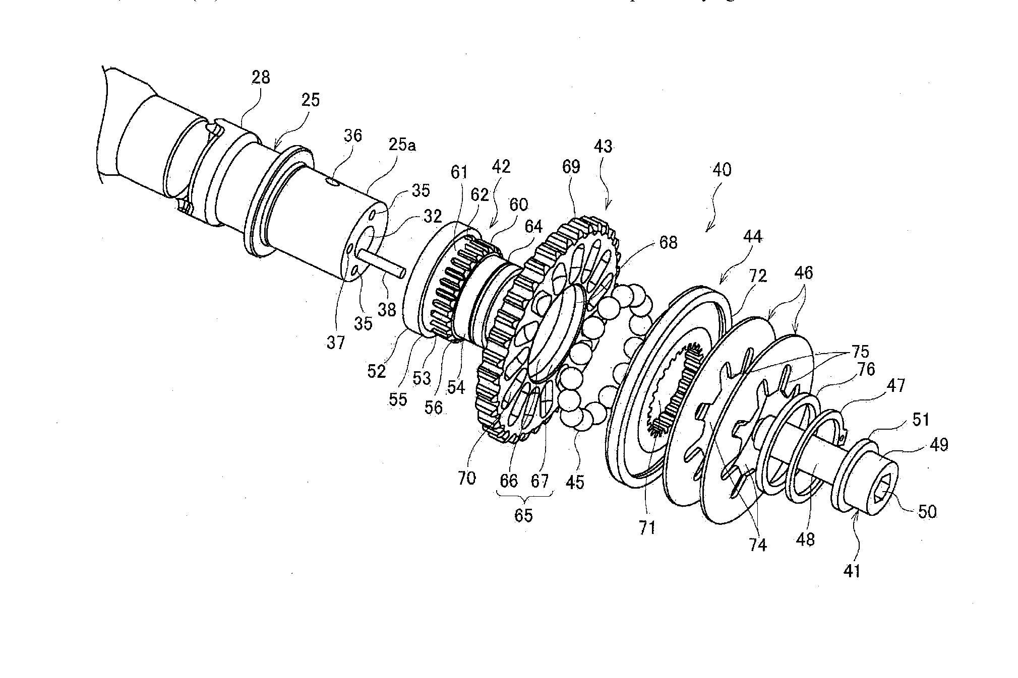

Back in 2017 Suzuki filed a patent for the GSX-R1000’s cam-phasing system. <i>Suzuki</i>
Suzuki itself already uses a cam-phasing system on the GSX-R1000, introduced in 2017. It does the same job, but instead of hydraulically changing the cam phasing by introducing oil pressure to chambers, it uses centrifugal force, pushing weighted balls outward as revs rise and using them to mechanically rotate the camshaft by a few degrees in relation to the sprocket. It’s a system that lacks the finer electronic control of a hydraulic cam phaser but was developed for the company’s title-winning MotoGP bike because electronic and hydraulic VVT is specifically banned in that championship. As long ago as 2019, Suzuki patents showed that the company is developing a hydraulic VVT system for the GSX-R1000, acting on both camshafts rather than just the intake, but a production version still hasn’t emerged.

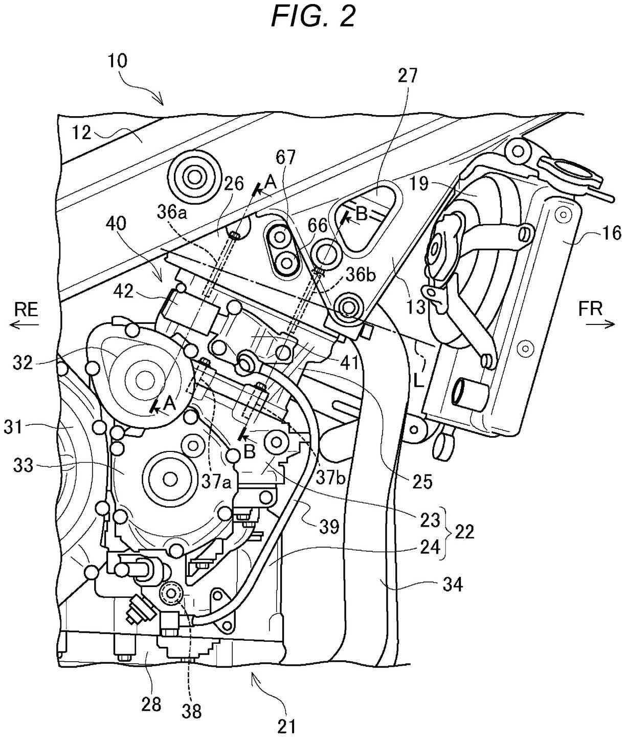

The actuator on the right side of the engine (41-42).
The actuator on the right side of the engine (41-42). (Suzuki/)

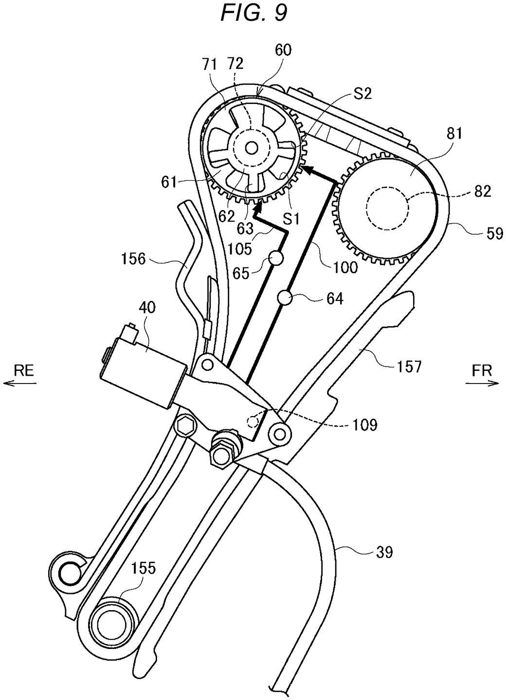

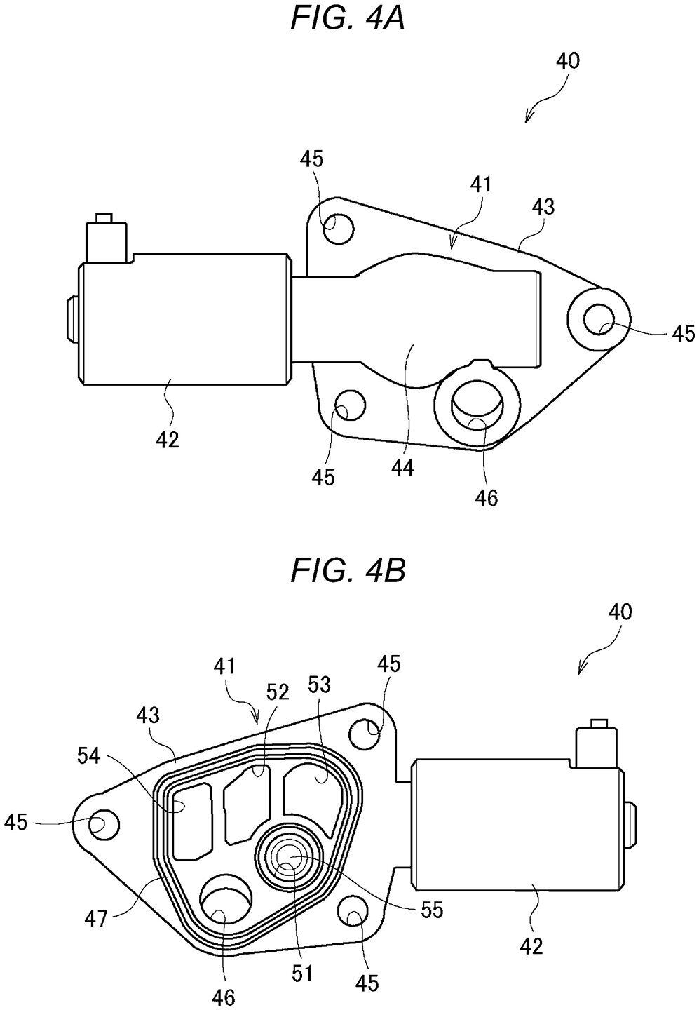

The new patents, filed in several countries, show a basic hydraulic VVT on the intake camshaft of the Hayabusa engine. Since that’s not a patentable idea, the focus of the documents is on the actuator that opens and closes the oil flow, and specifically its position—instead of being attached to the cylinder head, it’s mounted lower down on the side of the cylinder. The patent explains the move, giving several reasons for the change. Most importantly, perhaps, it means the additional width that the actuator introduces to the engine isn’t in a position where it would require alterations to the frame. Suzuki also says that shifting it closer to the engine’s center of mass—the crankshaft and crankcases—the effects of vibrations on the actuator are reduced to improve its reliability, and it’s moved away from the hot air expelled from the bike’s radiator, again giving a longevity benefit.
A close-up of the hydraulic actuator.
A close-up of the hydraulic actuator. (Suzuki/)

Side view of the actuator and cams on Hayabusa.
Side view of the actuator and cams on Hayabusa. (Suzuki/)
