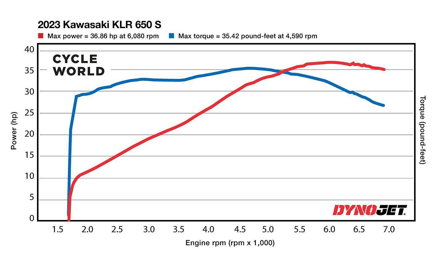

On our in-house Dynojet 250i dynamometer, the 2023 Kawasaki KLR650 S, weighing 464 pounds on our automotive scales, produced 36.9 hp at 6,100 rpm and 35.4 lb.-ft. of torque at 4,600 rpm. Those numbers put the S ahead of the 2021 KLR650 Adventure’s 34.6 hp and 33.5 lb.-ft. of torque figures.
2023 Kawasaki KLR650 S Dyno Chart.
2023 Kawasaki KLR650 S Dyno Chart. (Robert Martin/)
