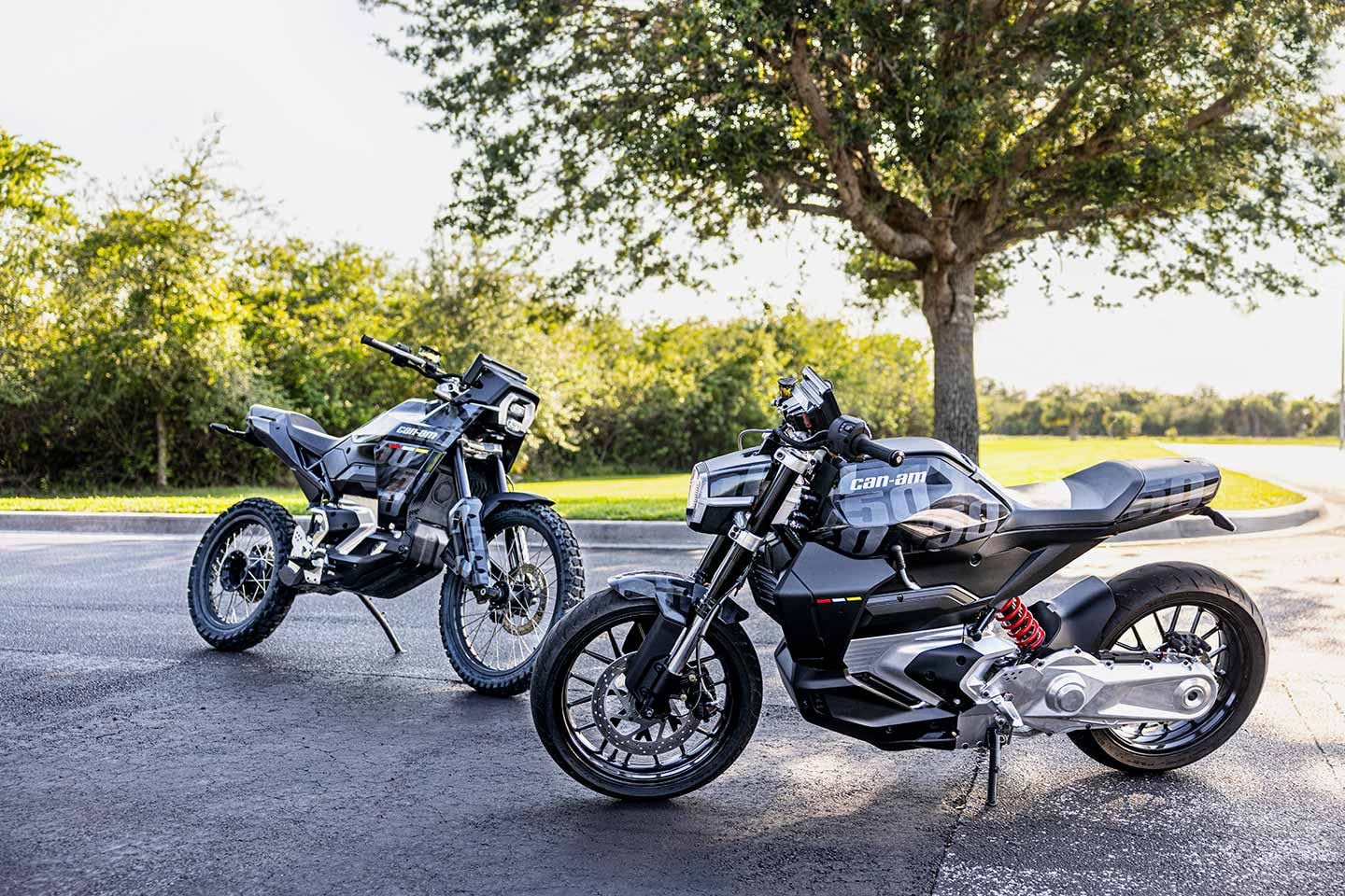

It was a year ago that Can-Am officially confirmed its plans to return to the motorcycle market with a pair of electric two-wheelers due to reach customers in 2024. An update on the project reveals that testing is well underway and bikes should be in the hands of customers by the end of 2024.
Although Can-Am is remaining silent on specifics of the range and performance targets for the Pulse roadster and Origin adventure bike, both built around a shared chassis and powertrain, the company says that test riders have been impressed so far. It has also released images of real-world prototypes that, while still looking very much like last year’s show bikes, give a dose of reality that was previously missing from the project.

And while the company isn’t talking about performance, there’s an intriguing hint in titles given to some of the photographs accompanying the release. In some of the picture’s names, the bikes are titled “Pulse-35kWh” and “Origin-35kWh.” We’re all having to learn a new vocabulary as electric bikes become more commonplace and “kWh” is immediately familiar, meaning kilowatt-hours and relating to the capacity of a battery.
The Can-Am Pulse roadster.
The Can-Am Pulse roadster. (Can-Am/)
It seems unlikely, but if that 35kWh figure refers to the batteries in the Pulse and Origin, then they’re a quantum leap ahead of the current state of the art for electric bikes. At the moment, the biggest battery you’ll find in a Zero has a capacity of just under 21kWh, including the optional Power Tank upgrade, while the Energica Experia has a maximum capacity of 22.5kW. The Ducati V21L prototypes used in MotoE competition have 18kWh batteries.
