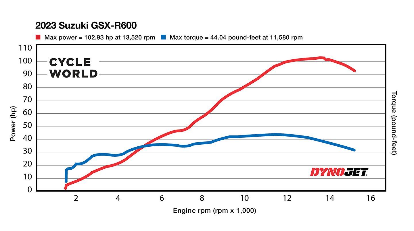

2023 Suzuki GSX-R600 Dyno Chart.
2023 Suzuki GSX-R600 Dyno Chart. (Robert Martin/)
On the in-house Dynojet 250i dynamometer, the 2023 Suzuki GSX-R600 produced 102.9 hp at 13,500 rpm and 44.0 lb.-ft. of torque at 11,600 rpm. Weighing 419 pounds on our automotive scales, the Suzuki has a similar power-to-weight ratio as its biggest competitor, the Kawasaki Ninja ZX-6R with 108.4 hp and a curb weight of 432 pounds. Suzuki’s 599cc inline-four has a linear power curve that delivers a consistent response through the entire rpm range. Its lackluster bottom-end torque requires the rider to manage the revs more than its competitors, but its stable chassis makes up for it through the corners.
