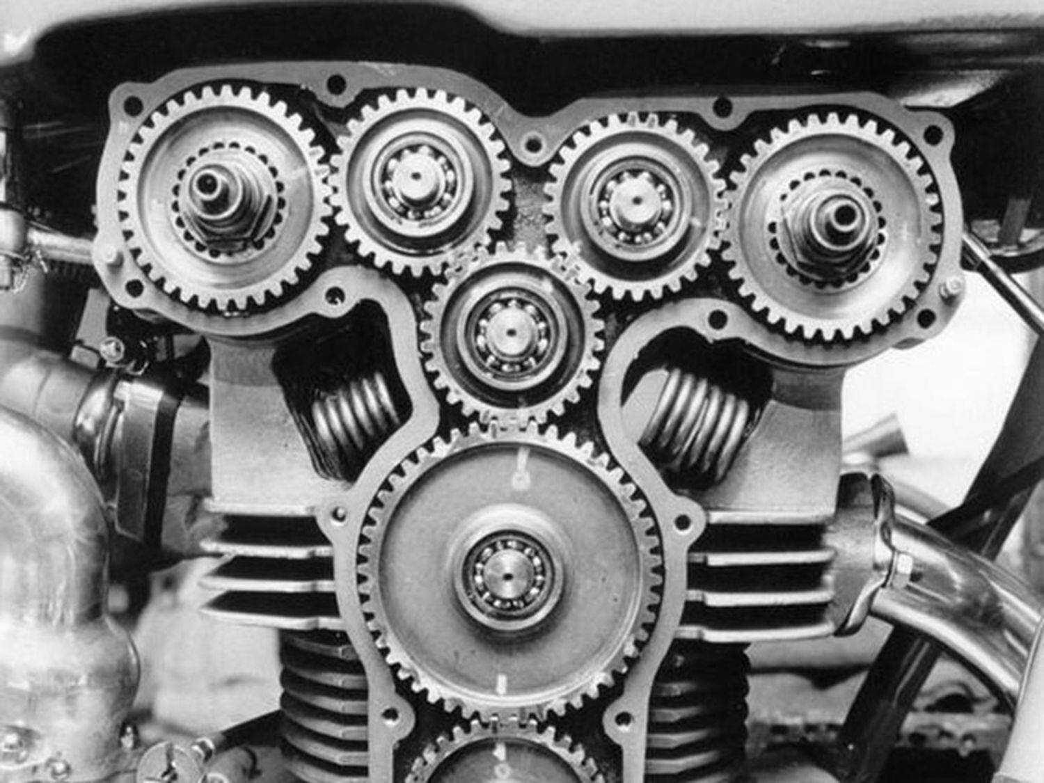

In the 1983 process of switching Superbike from 1,000cc down to 750, one detail that was researched was the effect of cam-chain wear on valve timing. Chains are surely better now, but back then there was some change in performance through a race from chain “stretch” (chains don’t stretch—they wear. Ever hear of a frame stretching?). Quick as a wink, here came gear-drive conversions to keep valve timing where it had been so carefully set. Gear drives made a satisfying whine that was quite different from a stock chain. Hearing it was a pleasure.
Gear-driven camshafts make a wonderful whine.
Gear-driven camshafts make a wonderful whine. (Benelli/)
