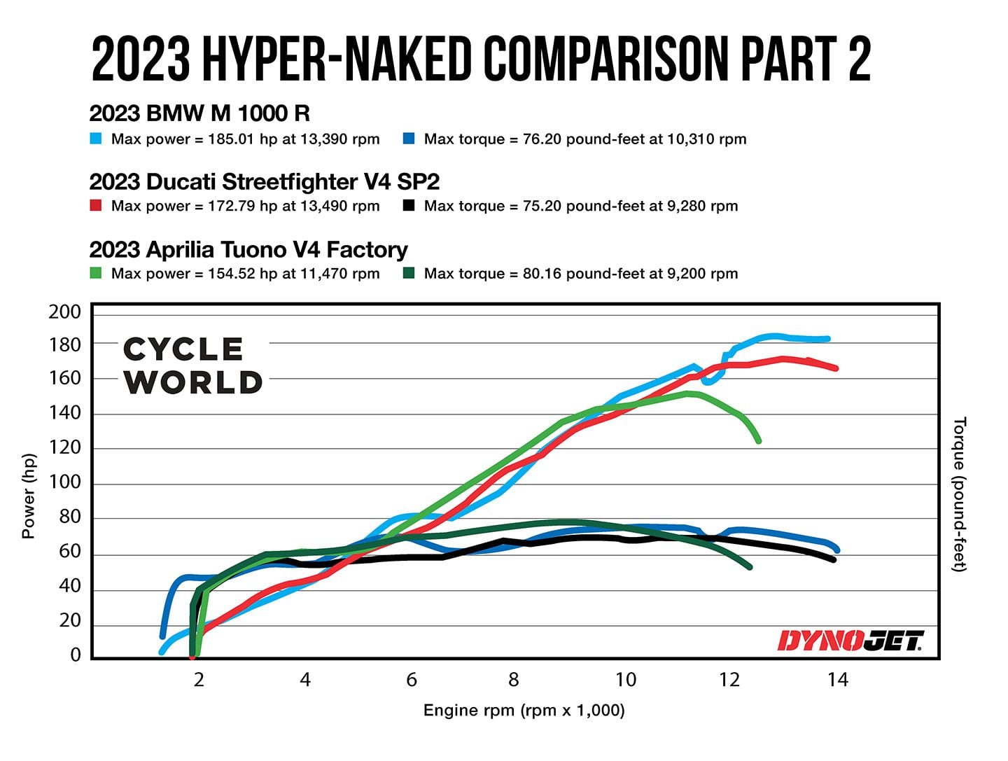

The overlaid dyno graphs show the contrast between the three contenders.
The overlaid dyno graphs show the contrast between the three contenders. (Dynojet/)
Before the street and track we found out how the rear-wheel horsepower stacked up on the Cycle World Dynojet dyno. Aprilia’s V-4 produced a solid 154 hp pull at 11,500 rpm with 80.2 lb.-ft. of peak torque at 9,200 rpm. While the curves look really nice, there is a little dip between 5,000 and 6,000 rpm. Ducati’s SP2 (identical to all the engines in the Streetfighter V4 lineup in terms of performance) generated 173 hp at 13,500 rpm and 75 lb.-ft. of peak torque at 9,300 rpm. Like the Aprilia, the SP2 lays down a bit between 4,000 and 6,000 rpm and then is linear to redline. But the real difference is that the Desmosedici Stradale just keeps on pulling up top, blowing the Tuono into the gravel trap. On the dyno charts, the BMW’s power and torque curves are a bit messy. The M makes 185 hp at 13,400 rpm and 76.2 lb.-ft. at 10,300 rpm, but those curves look like a supercross whoop section with dips and spikes all over the place, especially through the midrange where the two V-4s are more linear. Sound emissions requirements demanded electronic intervention.

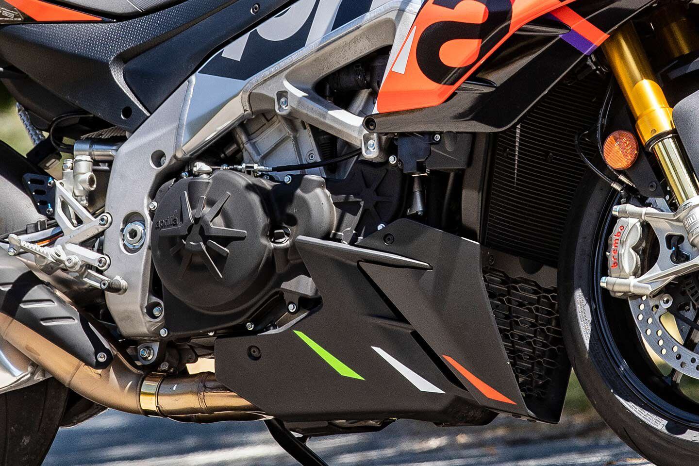

Aprilia’s 1,077cc 65-degree V-4.
Aprilia’s 1,077cc 65-degree V-4. (Jeff Allen/)
“It only takes a few corners behind the Streetfighter V4 or M 1000 R to realize that the Aprilia is missing something getting off the corner,” In-Market-Editor Bradley Adams said.
A deeper dive reveals that the Tuono has taller overall gearing, which means that you aren’t always in the ideal part of the rev range and stuck between gears, so to speak.
“Yes, this is still an incredibly potent engine that’s plenty fast for spirited track riding, but less snap off the corners and a sizable top-end horsepower deficit means it’s tough to keep the Ducati and BMW in your sights at either end of a straightaway,” Adams added.

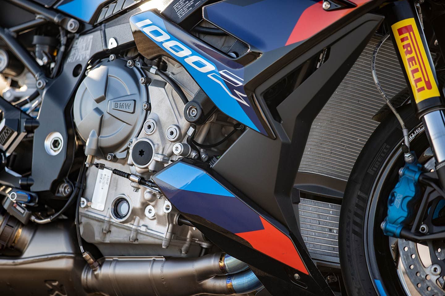

BMW’s M 1000 R utilizes the exact same inline-four engine from the latest S 1000 RR and M 1000 RR.
BMW’s M 1000 R utilizes the exact same inline-four engine from the latest S 1000 RR and M 1000 RR. (Jeff Allen/)
“BMW’s inline-four impresses on the dyno in terms of peak power, but despite the 185 hp figure it doesn’t translate to real-world performance,” Adams said. “The engine is hindered by electronic mapping that BMW is using to meet emissions standards. The big issue here is a giant flat spot between 6,000 and 8,500 rpm that’s nearly impossible to ignore on the track or the street.”
At 7,000 rpm (the bottom of the M’s dip), the Aprilia is making 15 more horsepower and the Ducati almost 10 more. The smooth nature of this inline-four and the familiar and crisp bark of the exhaust note coming from the Ti Akrapovič pipe are awesome, but the extra work required both on the track and street is disappointing.
The M 1000 R might have the highest peak horsepower of the trio, but that doesn’t tell the full story about how the engine works in the real world.
The M 1000 R might have the highest peak horsepower of the trio, but that doesn’t tell the full story about how the engine works in the real world. (Jeff Allen/)
“It’s as if you’re riding a different bike depending on what rpm you’re at,” Adams added. “This isn’t limited to track riding either, as even on the street you have to be careful to avoid the flat spot. Oftentimes that means going down to first gear for tight corners, where even on the tall-geared Aprilia you can use second.”

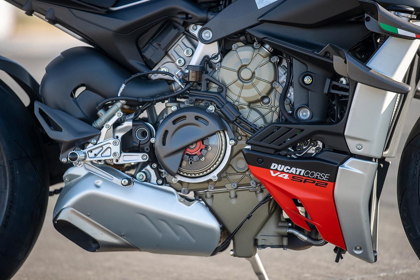

Ducati’s Desmosedici Stradale V-4 can be found in every tier of the Streetfighter lineup. The biggest difference is that our SP2 comes with an STM dry clutch.
Ducati’s Desmosedici Stradale V-4 can be found in every tier of the Streetfighter lineup. The biggest difference is that our SP2 comes with an STM dry clutch. (Jeff Allen/)
“Ducati’s Desmosedici Stradale V-4 has earned a spot in any conversation about the all-time best engines in motorcycling,” an enthused Adams said. “Every other engine we’ve tested, in either part of this two-phase comparison, makes some kind of sacrifice. That’s not the case with Ducati’s V-4 though. It has tons of low-end grunt, pulls hard through the midrange, and is still wickedly strong on top.”
If you were to only look at the peak performance numbers, you could easily be bamboozled into believing that the M 1000 R puts a whooping on the Streetfighter. It might not make as much peak power as the BMW, but it’s an extremely flexible engine with power everywhere, allowing you to make fewer shifts per lap, which ultimately makes for a less physically and mentally demanding ride on the track.

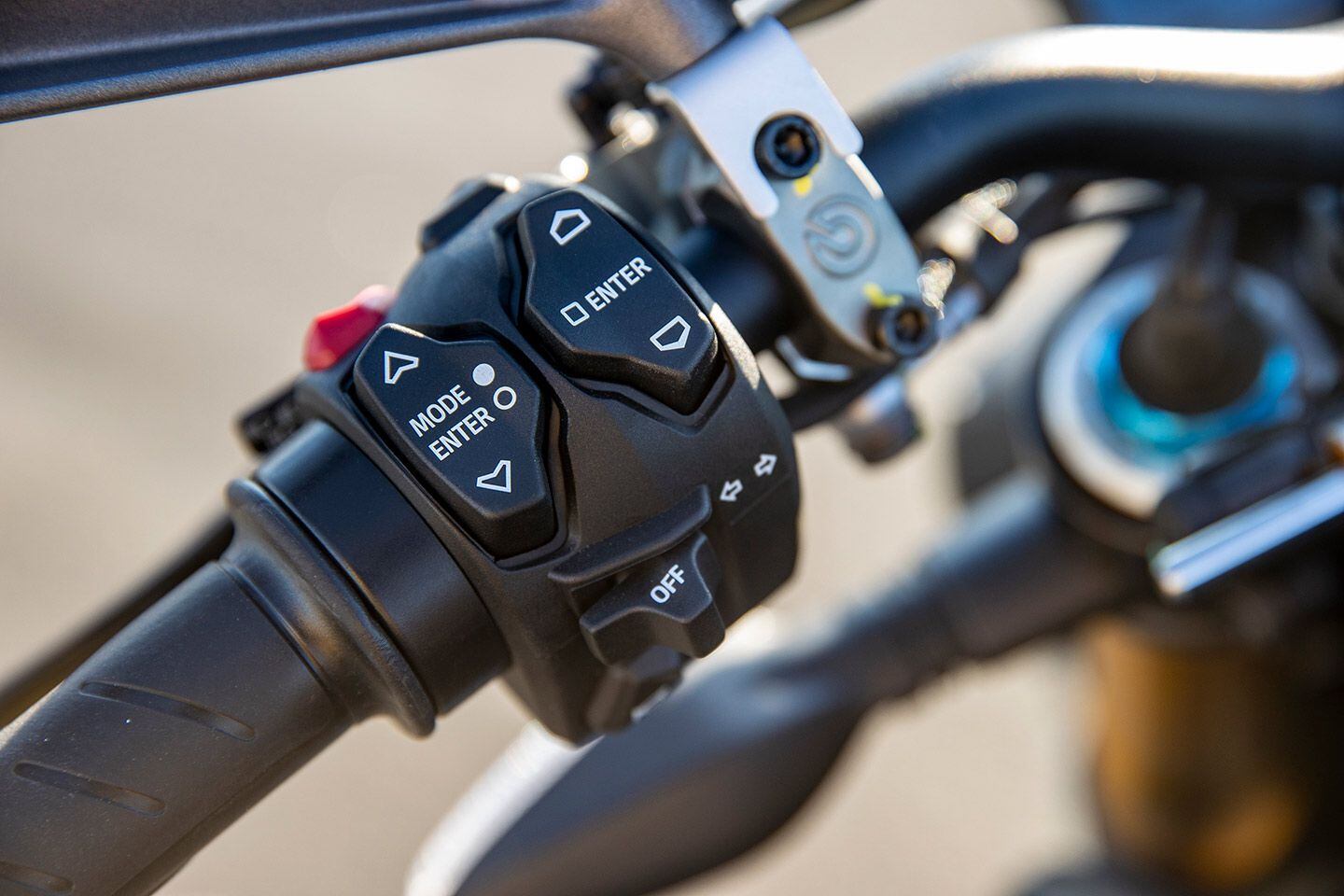

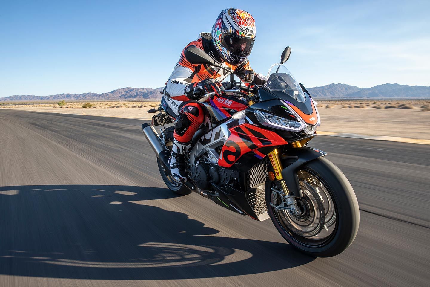

The Aprilia’s suite of rider aids and settings are organized into two categories for road and track, which alters what is displayed and also what you can customize. We really like this strategy.
The Aprilia’s suite of rider aids and settings are organized into two categories for road and track, which alters what is displayed and also what you can customize. We really like this strategy. (Jeff Allen/)
All three of these hyper-nakeds are pumping out a level of horsepower that really begs for electronic intervention to make them livable on the street and useful on the track. Aprilia’s Performance Ride Control system gives the option to adjust the engine maps (AEM), engine-brake control (AEB), eight levels of traction control (ATC), three levels of wheelie control (AWC), launch control (ALC), speed limiter (APT), and a choice between six ride modes (three road-based modes, three track-based modes). In the Road modes you have a fully customizable User mode, and in the Track modes two out of three can be fully personalized. It also has a six-axis IMU with cornering ABS (three settings), a standard up/down quickshifter, cruise control, and Öhlins Smart EC 2.0 electronically managed suspension.

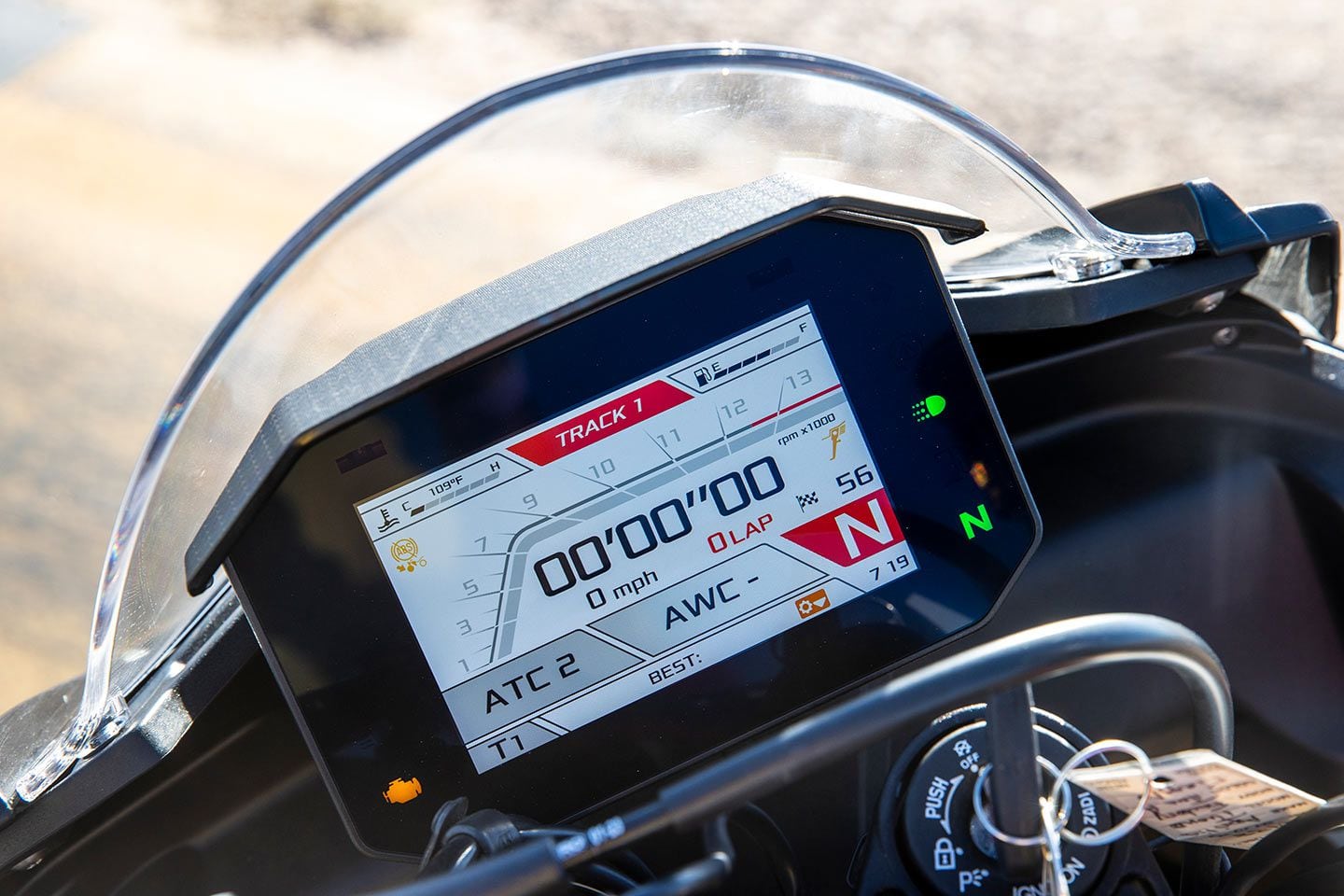

“Aprilia has done an excellent job organizing the electronic rider aids on the Tuono,” Adams said. “Giving the rider just enough options without making them overwhelmed, thanks mostly to the Road and Track screen/ride modes. We liked this feature in the previous test, but it made even more sense here when we tested the bike on track and street back to back.”
The Aprilia’s large TFT display is easy to navigate, the right handlebar cluster features a dedicated mode button for on-the-fly changes, and the TC can be adjusted on the fly from the paddles on the left bar when you’re in the Track modes.
The Tuono’s electronics switch gear takes some practice, but once you get it down it allows for an abundance of logical customization.
The Tuono’s electronics switch gear takes some practice, but once you get it down it allows for an abundance of logical customization. (Jeff Allen/)
Aprilia’s rider aids get the job done, but the intervention is very much in the foreground. You can sense when TC or wheelie control is intervening, and they aren’t as quick as the Ducati at jumping in and taking action. On the positive side, the Tuono’s bar-mounted switch gear and dash navigation is the most intuitive in this trio, making it easy to get into the weeds to make precise adjustments and customize settings. We really like how Aprilia numerically displays the base setting so you always have a reference when you’re making changes. Overall we’ll give the Tuono an A for organization and a B for effectiveness.

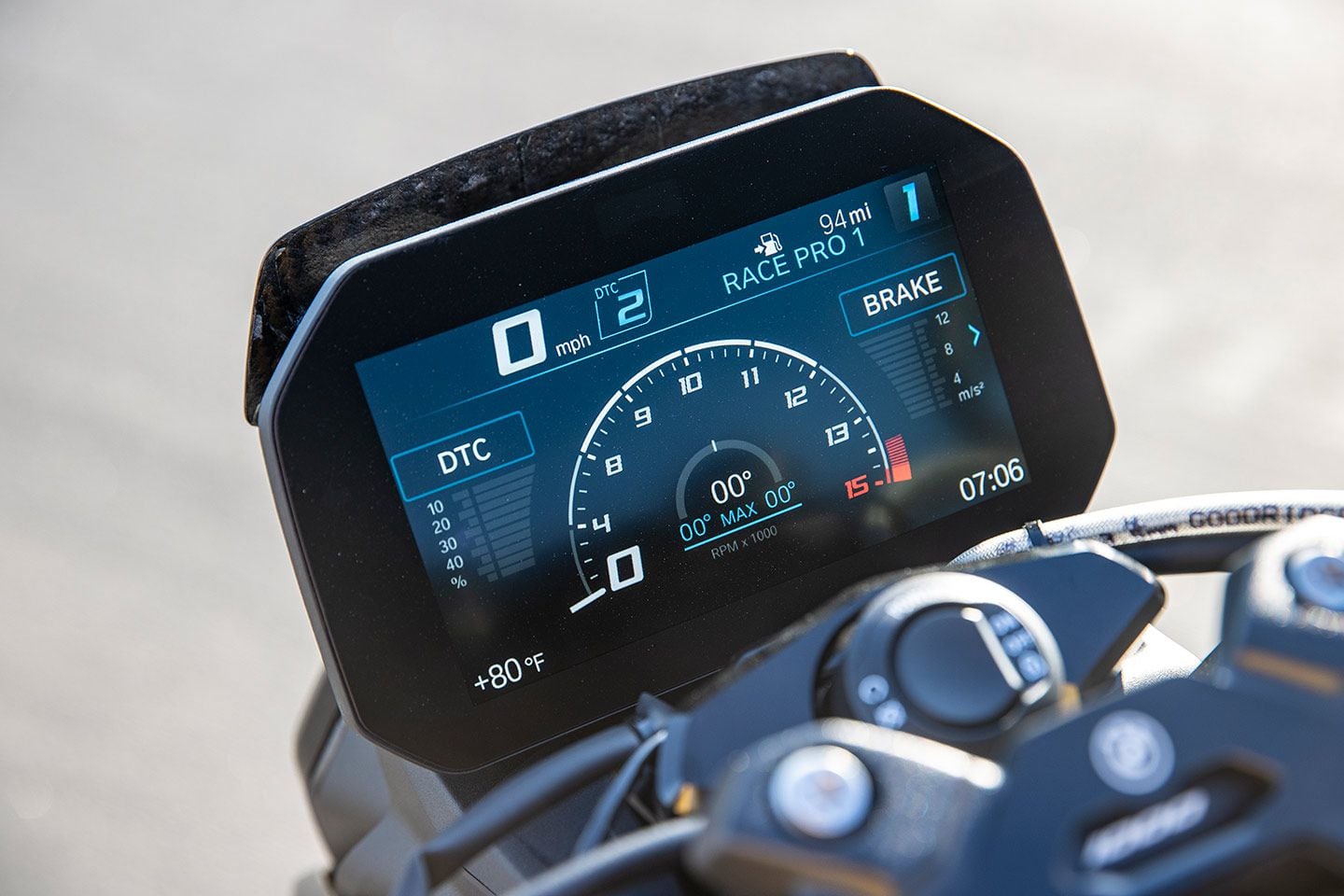

We really like the clean layout of the BMW dash, but wish it displayed more information in terms of rider aids other than DTC, and where they are set. This would give the rider confidence at a glance.
We really like the clean layout of the BMW dash, but wish it displayed more information in terms of rider aids other than DTC, and where they are set. This would give the rider confidence at a glance. (Jeff Allen/)

The BMW has a large TFT display that’s clean and simple in appearance and offers multiple display styles, but with all the screen space we wish we could see where other rider-aid settings were set other than just the mode and the TC setting. A dedicated TC button allows you to toggle traction control on or off, however, if you just want to change the preset setting in a particular ride mode, you can only do that in one of the Race Pro modes.

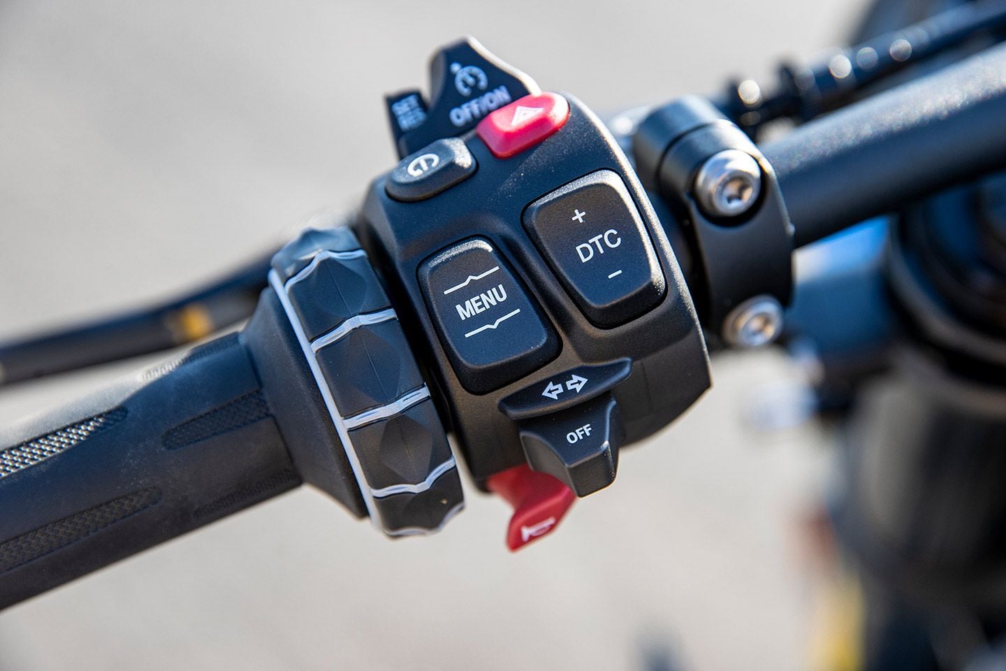

BMW definitely does its own thing when it comes to menu logic. Not everyone likes BMW’s -7 to +7 range for DTC and some other rider aids.
BMW definitely does its own thing when it comes to menu logic. Not everyone likes BMW’s -7 to +7 range for DTC and some other rider aids. (Jeff Allen/)
“Why have such an odd range of -7 to +7?” Adams asked of BMW’s numbering system for the traction-control system. “I understand that this technically enables finer adjustment of the systems, but I found it hard to feel a difference between individual levels. And it’s so different from anything else that other manufacturers are using that it’s hard to wrap your head around.” A tighter set of levels like the other two bikes (each offers eight) allows more noticeable differences.
The electronics play such a heavy role in your experience with the BMW. Even with all of the rider aids turned off, you still seem to be fighting some form of electronic control. From the way the ride-by-wire throttle doles out power, to how the ECU controls the fuel mapping (with that nasty dip), you are aware of everything the M is doing to meter power, for good or bad.

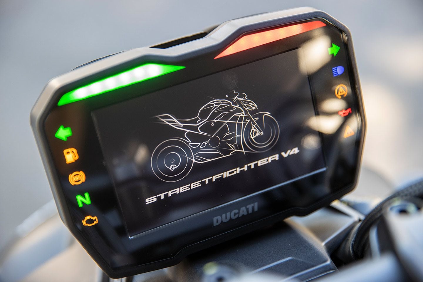

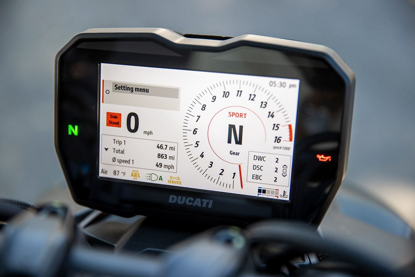

Overall, Ducati has done a good job organizing and displaying its dash, and we really like how you can see where many of your rider aids are set at a glance.
Overall, Ducati has done a good job organizing and displaying its dash, and we really like how you can see where many of your rider aids are set at a glance. (Jeff Allen/)
Ducati has a comprehensive suite of electronic aids for the SP2, as well. There are four ride modes including Race, Sport, Road, and Wet. Then you have multiple power modes (Full, High, Medium, and Low) with smooth and dynamic response options. There is a three-level Bosch Cornering ABS Evo, eight-level Ducati Traction Control (DTC) Evo 2, eight-level Ducati Wheelie Control (DWC), two-level Ducati Slide Control (DSC), three-level Engine Brake Control (EBC) Evo 2, Ducati Quick Shift (DQS), Ducati Power Launch (DPL), auto tire calibration, and Öhlins EC 2.0 smart suspension.

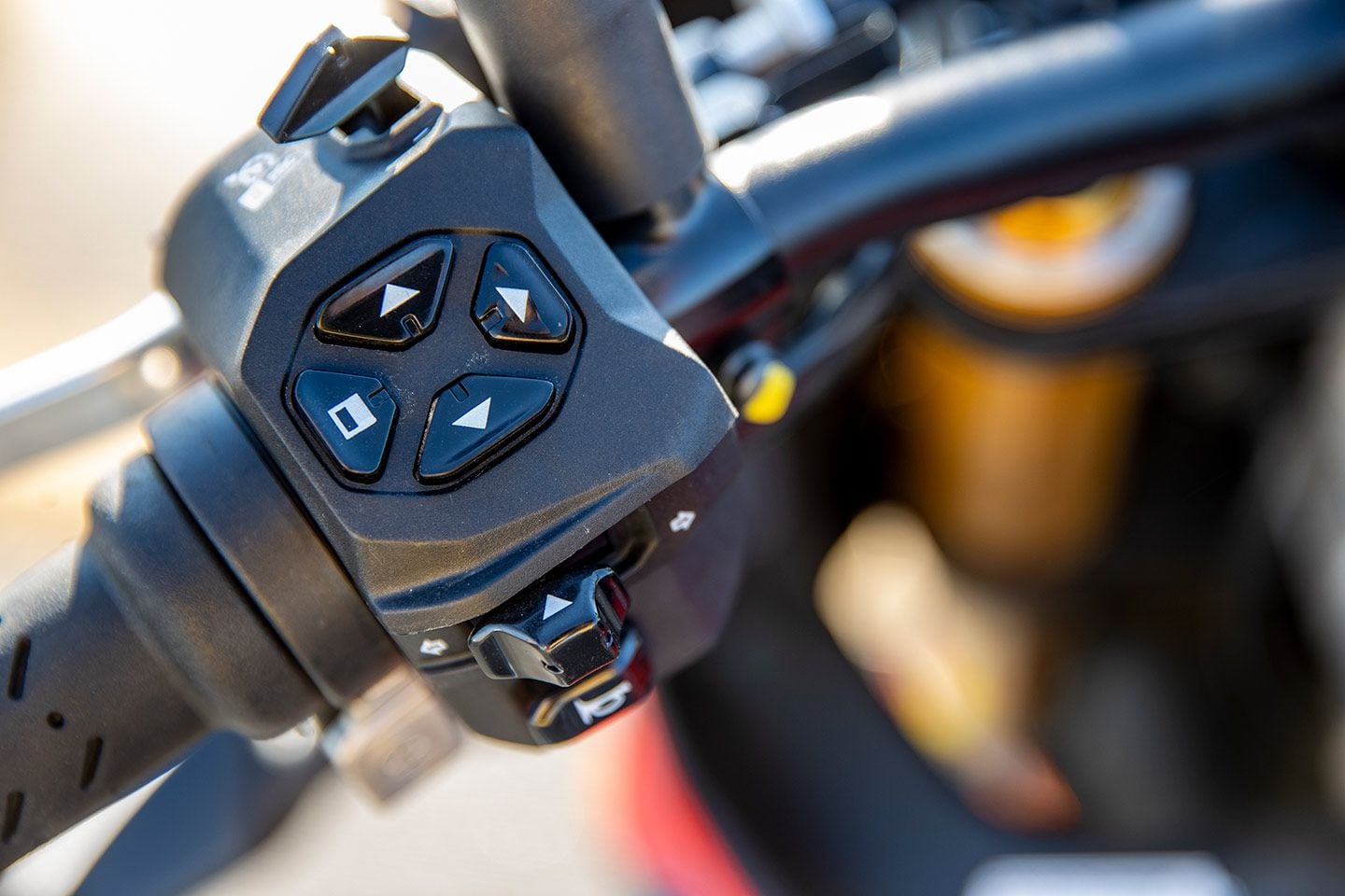

Ducati’s left-bar control pod isn’t as intuitive as on the new Multistrada, but is still logical with some practice. Where is cruise control Ducati?
Ducati’s left-bar control pod isn’t as intuitive as on the new Multistrada, but is still logical with some practice. Where is cruise control Ducati? (Jeff Allen/)

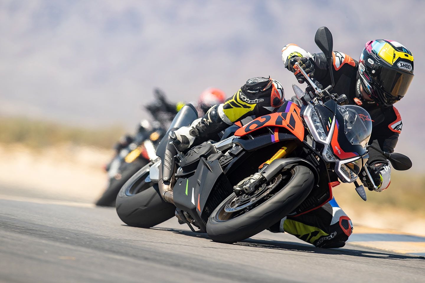

“The beauty of the Tuono’s chassis is how much feedback it has when you’re on the side of the tire,” Adams said. “The feedback from the contact patch gives you the confidence to carry more lean angle and corner speed, and ultimately enables you to muscle the bike around the racetrack at a pace not far off the Ducati.”
The Aprilia’s stability comes at the expense of agility, however. Especially on the street, where you get a serious upper-body workout compared to the other two during an afternoon of riding. The Aprilia could benefit from ultralightweight carbon fiber wheels like the other two bikes have.
While the Tuono offers amazing midcorner stability, it also isn’t as agile as the other two bikes.
While the Tuono offers amazing midcorner stability, it also isn’t as agile as the other two bikes. (Jeff Allen/)
On the track we felt like the Tuono was a bit unbalanced front to rear, which required us to tweak the electronic suspension settings more than on the other two bikes to find the window where it was happy. It’s very easy to go into the dash menus and change settings, and we love how the interface lets you know where the base setting is, so that you don’t get lost while making alterations. As for the street, the Tuono’s midcorner stability is excellent, and its suspension sucks up rough patches that give the other two bikes fits.

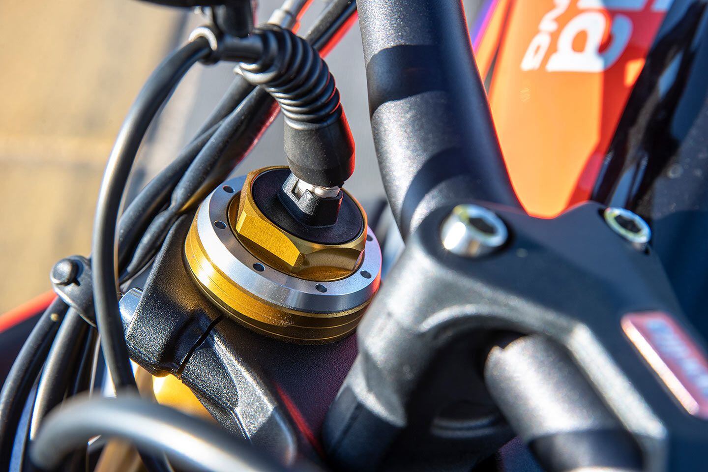

The Tuono uses Öhlins hardware and software for the suspension and Brembo brakes.
The Tuono uses Öhlins hardware and software for the suspension and Brembo brakes. (Jeff Allen/)
Considering the tight setup window, and less agile front-end geometry, the Aprila still has a level of balance between the chassis, engine, and braking that was able to outshine the BMW (in terms of lap time) at the track. The Aprilia’s brakes, when thrown up against the Yamaha MT-10 SP and KTM 1290 Super Duke R Evo, seemed so good, but definitely met their match in this company. The hardware consists of Brembo M50 Monoblock calipers and 330mm discs up front. Don’t get us wrong, these are amazing brakes, but the other two simply outperform them.

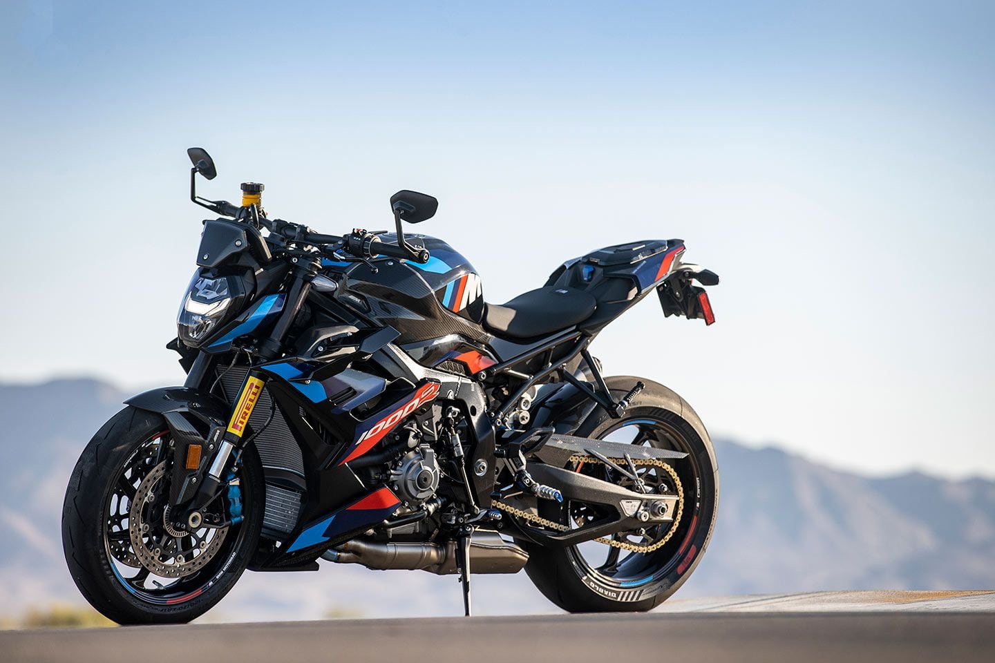

Street or track, the BMW M 1000 R was a favorite in terms of agility and handling.
Street or track, the BMW M 1000 R was a favorite in terms of agility and handling. (Kevin Wing/)
If there is a bike that got kudos both on the street and on the track in terms of chassis performance, it’s the BMW. We all loved hopping onto the M when we were in Malibu and rotating from bike to bike, and the same can be said on the track.
“The BMW is by far the lightest steering, requiring the least effort for directional changes of the three,” Toland said. “However, the trade-off is stability when things get in the upper rpm range. The BMW’s power hits so hard up top on the street that it’s almost like you need a different suspension setting to handle it, because it loads the chassis very differently.”
“The M 1000 R is the easiest bike to rush into a corner on, as it’s more composed under load than the Streetfighter, but steers much lighter than the Aprilia,” Adams commented. “And it’s the easiest bike to make midcorner adjustments on, thanks to the aforementioned composure and increased agility over the Aprilia.”

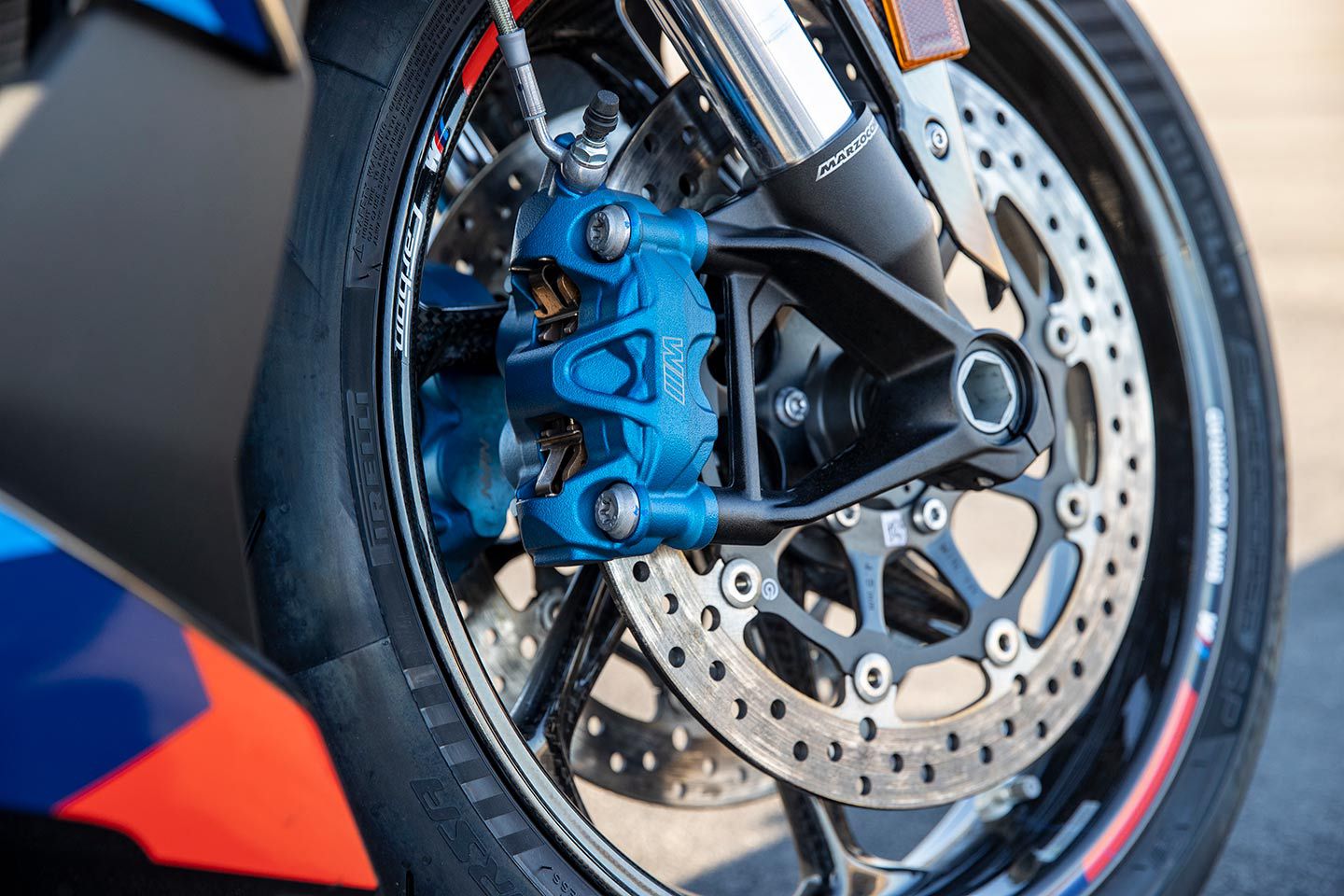

Unlike the other two bikes, the BMW uses Marzocchi suspension and Nissin brakes. Both performed amazingly.
Unlike the other two bikes, the BMW uses Marzocchi suspension and Nissin brakes. Both performed amazingly. (Jeff Allen/)

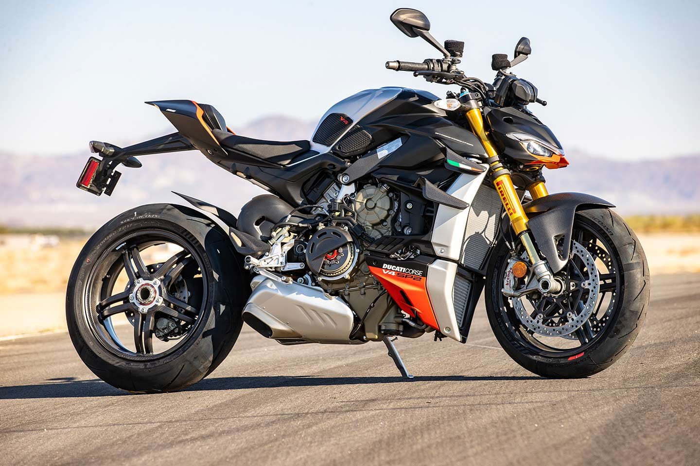

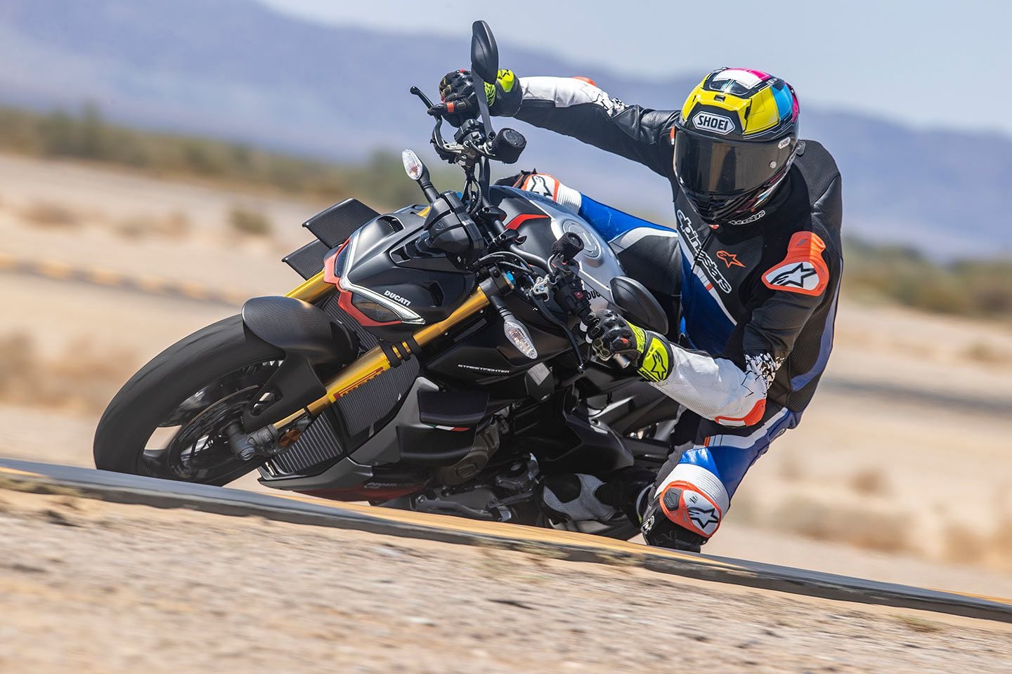

Ducati has gone a different route with its chassis design, and it definitely communicates feedback differently than the other two bikes. It splits the difference between its two competitors here in terms of agility.
Ducati has gone a different route with its chassis design, and it definitely communicates feedback differently than the other two bikes. It splits the difference between its two competitors here in terms of agility. (Jeff Allen/)
“The Streetfighter’s front frame design and its use of the engine as a load-bearing element contributes to a completely different chassis sensation compared to the other bikes in this test, and that takes time to get used to,” Adams said.
The chassis is stiff and doesn’t absorb lateral bumps as well as the more traditional twin-spar frames. This is especially noticeable as you’re trail-braking into a corner and increasing side load on the frame; a lack of compliance from the actual frame leads to more front-end movement over imperfect pavement, and gives you less confidence as you tip into the corner.
On the other hand, the Streetfighter is very balanced front to rear allowing aggressive input from the rider. Another thing we noticed is how much outright grip the Streetfighter has.
“From the second you roll the throttle on, the tires bite into the tarmac and the bike begins driving forward,” Adams said. “There’s no pumping or wallowing.”

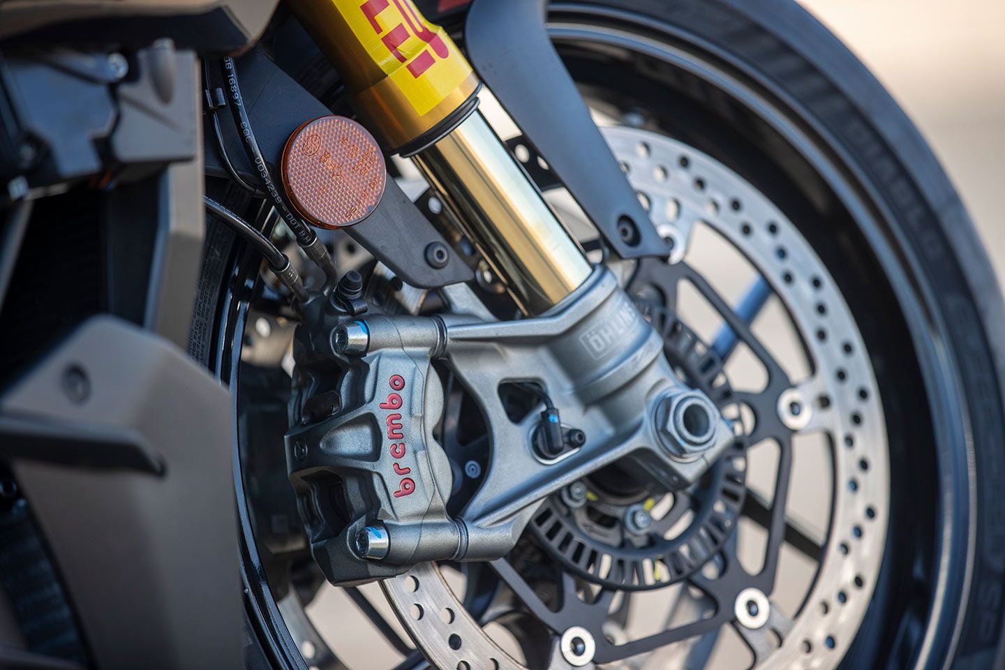

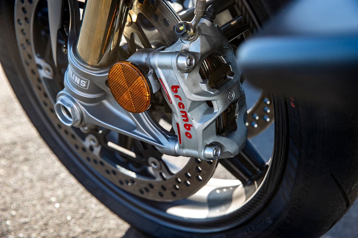

You want exotic? Top-of-the-line Brembo Stylema R brakes, Öhlins electronic suspension, and carbon fiber wheels deliver performance and bling.
You want exotic? Top-of-the-line Brembo Stylema R brakes, Öhlins electronic suspension, and carbon fiber wheels deliver performance and bling. (Jeff Allen/)
The Ducati splits the difference between the other two bikes: It’s not as razor sharp on turn-in as the BMW, but is quicker steering than the comparatively sluggish Aprilia. When you hop between the Tuono and the Ducati there is almost an adjustment period, as the Ducati’s ultra-light carbon-fiber wheels help provide instant steering response. While the chassis feels very rigid and stiff at times, thankfully that can all be tuned with the Öhlins electronic suspension. This is another prime example of why we love semi-active suspension. You can adjust Ducati’s damping manually to the point that it actually became plush on LA’s horrible concrete freeways. Then at Chuckwalla select the Race mode, and voilà, it firms up and is ready to attack the racetrack.
The Ducati’s Brembo Stylema R brake calipers are incredibly good, with amazing stopping power that progressively builds with pressure and can be operated confidently with just a single digit on the lever. We did prefer the BMW’s slightly more forgiving initial bite, particularly at the track, but overall, it’s almost impossible to fault the Ducati’s excellent brakes.

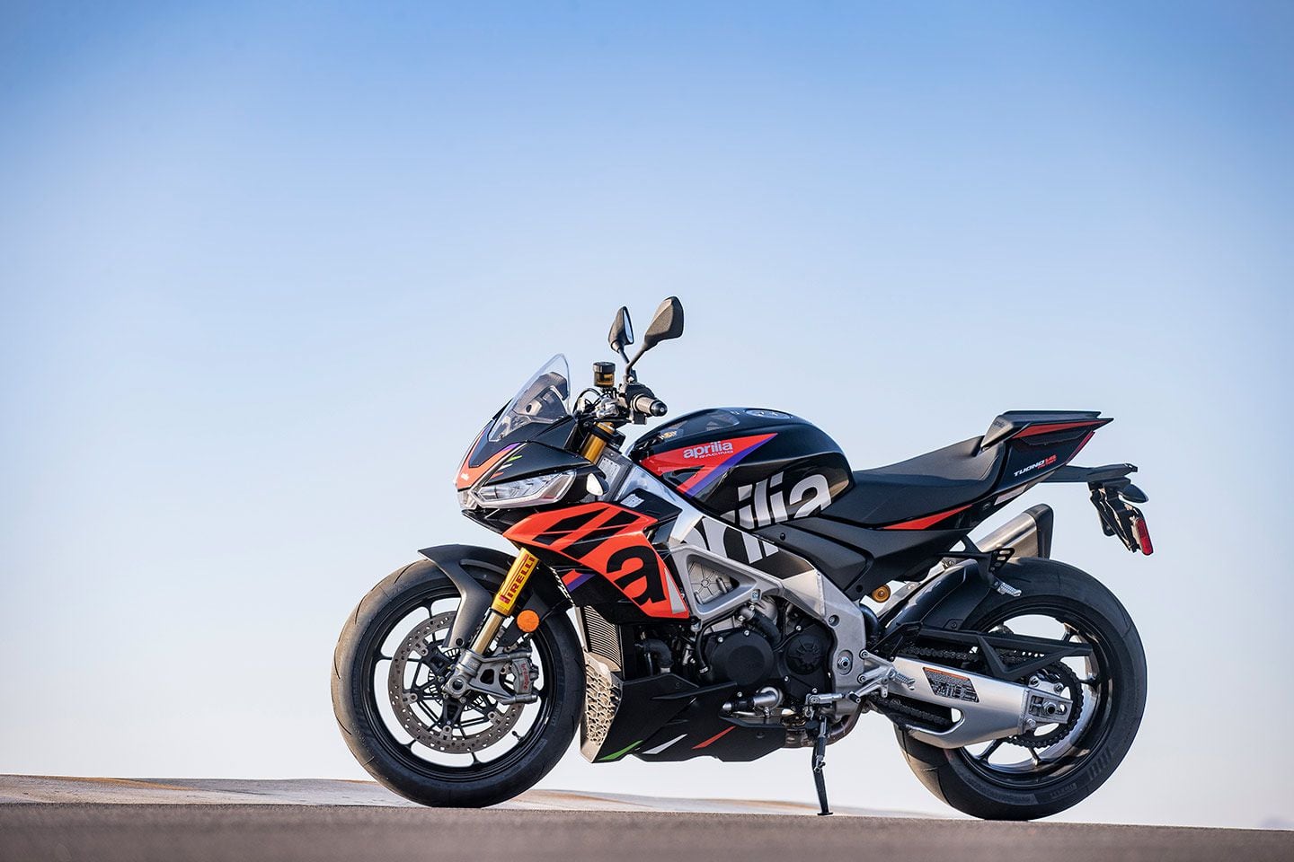

Aprilia’s Tuono V4 Factory offers the most extreme riding position of the trio.
Aprilia’s Tuono V4 Factory offers the most extreme riding position of the trio. (Jeff Allen/)
The Tuono’s riding position is the most cramped and aggressive. The high footpeg position and sloping seat are right off the RSV4, and yet it has the high handlebar. On the street, this can be a killer after a long day in the saddle, especially because the locked-in cockpit doesn’t allow you to move around very much, but it makes more sense on the racetrack. In a contradictory twist, the Tuono’s bikini fairing offers the best protection from the wind.

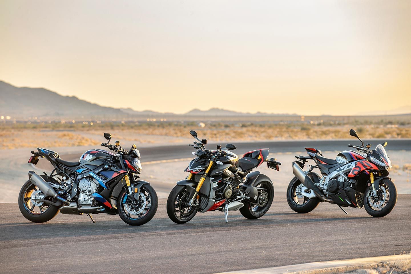

Conclusion
The hyper-naked landscape has been permanently changed by two of the bikes in this test, while the other has been the benchmark that all nakeds have been judged by for more than a decade. There has never been a duo with such raw performance as the BMW M 1000 R and Ducati Streetfighter V4 SP2. Unlike pretty much every other naked on the market, both companies delivered bikes that have in no way been dumbed down compared to the sportbikes they are based on. However, the Tuono gives up 35 hp to the RSV4.
Two of these three bikes have changed everything we know about naked sportbikes, while the third was the bike that set the tone for a decade.
Two of these three bikes have changed everything we know about naked sportbikes, while the third was the bike that set the tone for a decade. (Kevin Wing/)
Aprilia’s Tuono V4 Factory 1100 is still an amazing motorcycle that has stood the test of time and delivers a lot of smiles per mile. When we originally posed the question if the winner of our first part of the test, with bikes in the $20,000 range, could go head-to-head against the more expensive BMW and Ducati, we really didn’t know what the outcome would be. As it turns out, the answer is yes and no. The Tuono held its head high and was in no way embarrassed by its performance on the street and track. And it actually bested the BMW’s lap time at the track. But there’s a lot more to these bikes than on-track lap times. There are three things that hurt the Tuono: less comfort, less overall performance, and less-refined electronics that are falling behind the latest breed of sportbikes. Are those things that you can live with considering the fact that you can almost buy two Tuonos for the price of the Ducati?
In the end, the Aprilia proved to be worthy of going head-to-head with the others, but ultimately came up just a bit short.
In the end, the Aprilia proved to be worthy of going head-to-head with the others, but ultimately came up just a bit short. (Jeff Allen/)
Of all the bikes we’ve tested over the past few months, the BMW is perhaps the most frustrating. We should actually say the BMW’s engine as sold in the US disappointed us. The M has a sublime chassis both on the street and on the track. It’s the easiest bike to hop onto and be instantly at home from a handling perspective. And when you get the engine wound up into the top-end power the thing absolutely freaking rips. But the problem is that you have to get through the peaks and valleys of its power curves to find that incredible top-end. We hope to get our testbike back and try out the torque-optimization map, as that might be the solution we’re looking for. But as delivered, it’s the engine that held the M 1000 R back on the track and on the street as well. This bike has so much potential, and clearly there are solutions both at the dealership and aftermarket, but in bone-stock configuration, it comes up short in overall performance.
BMW’s M 1000 R has so many positive attributes, but ultimately was let down by the tuning of its engine.
BMW’s M 1000 R has so many positive attributes, but ultimately was let down by the tuning of its engine. (Jeff Allen/)
When we set out to find the best hyper-naked sportbike around, we really didn’t know what to expect. Part of the attraction to a naked like these is the added comfort that they offer over a sportbike, but to say that we were surprised by the Ducati’s comfort and practicality is a huge understatement. Never in a million years would we have guessed that the bike with the best overall engine performance, electronics package, and near-best chassis would also be the most practical and comfortable on a day-to-day basis. It’s a lot more than just icing on the cake. You may be able to buy two Tuonos for the price of the SP2, but don’t forget that the standard $22,095 Streetfighter V4 and $27,595 Streetfighter V4 S have the exact same engine and electronics. The key differences across the lineup is that the standard V4 doesn’t have the dry clutch, carbon wheels, and Öhlins semi-active suspension.
If you’re looking for the most potent, comfortable, refined, and amazing performing hyper-naked sportbike on the market, it’s the Ducati Streetfighter V4 SP2.
If you’re looking for the most potent, comfortable, refined, and amazing performing hyper-naked sportbike on the market, it’s the Ducati Streetfighter V4 SP2. (Jeff Allen/)
Our task, however, was always to find the most potent hyper-naked on the market today, and that bike without question is Ducati’s Streetfighter V4 SP2.

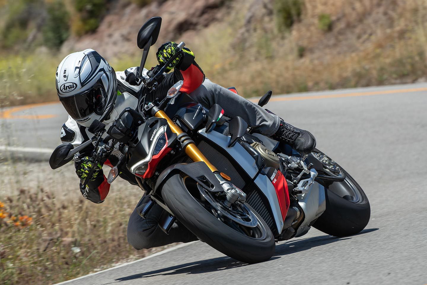

It was a good battle, but the Ducati clearly outshined the other contenders.
It was a good battle, but the Ducati clearly outshined the other contenders. (Jeff Allen/)The Aprilia is basically a RSV4 with an upright bar and mellower engine tuning.
The Aprilia is basically a RSV4 with an upright bar and mellower engine tuning. (Jeff Allen/)If you care if your “naked” has wind protection, the Tuono’s is the best.

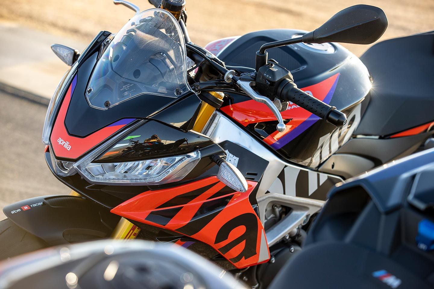

If you care if your “naked” has wind protection, the Tuono’s is the best. (Jeff Allen/)Aprilia’s Öhlins semi-active suspension.

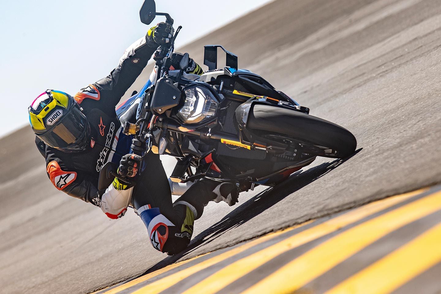

Aprilia’s Öhlins semi-active suspension. (Jeff Allen/)We all agreed that the BMW chassis was our favorite.
We all agreed that the BMW chassis was our favorite. (Jeff Allen/)Winglets have found their way onto the M 1000 R. Which is the reason BMW hasn’t reduced the peak power of the R versus the RR donor bike.

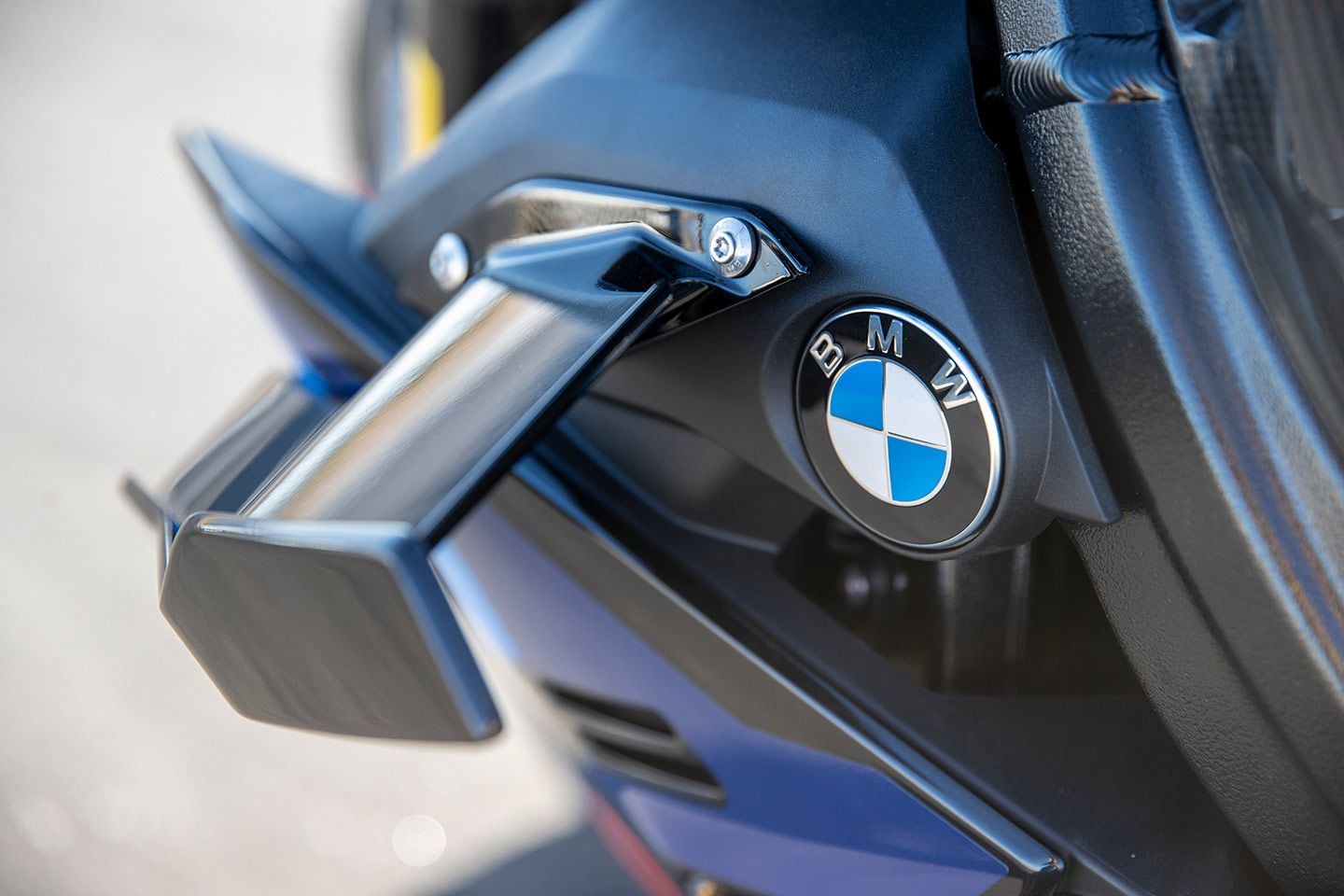

Winglets have found their way onto the M 1000 R. Which is the reason BMW hasn’t reduced the peak power of the R versus the RR donor bike. (Jeff Allen/)The M comes with trick and easily adjustable rearsets.

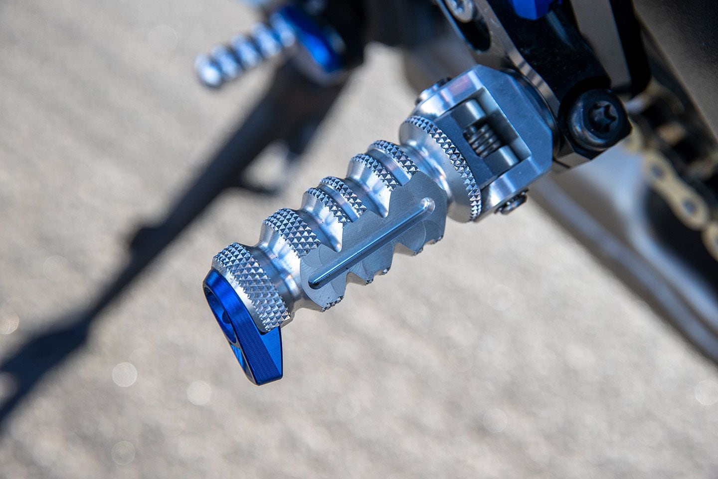

The M comes with trick and easily adjustable rearsets. (Jeff Allen/)The Ducati proves that you don’t have to sacrifice comfort to get performance. This is the best seat of the batch.

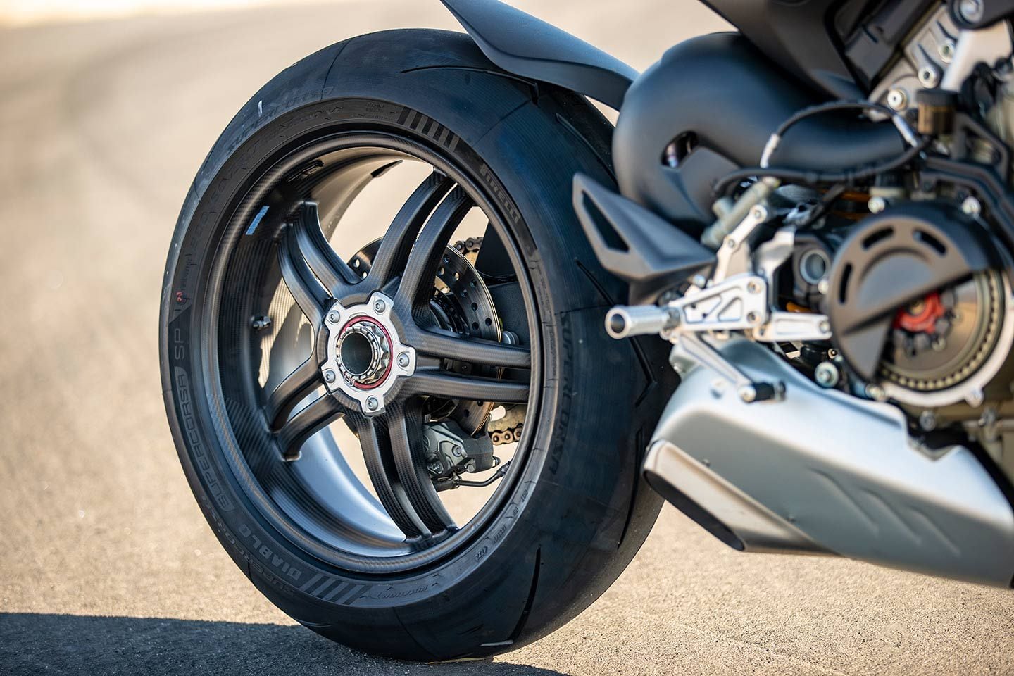

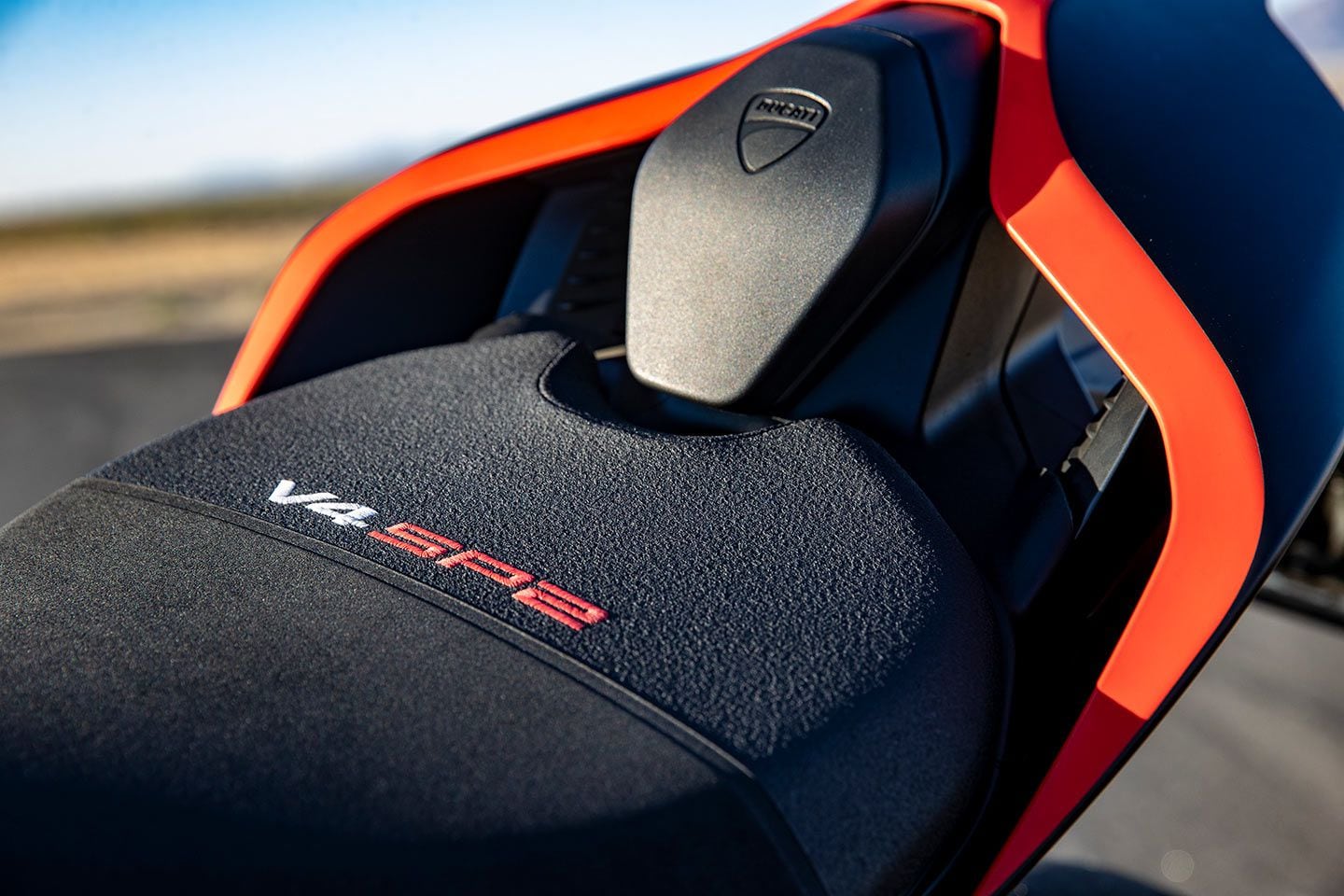

These beautiful carbon fiber wheels come standard on the SP2. (Jeff Allen/)The Ducati took no prisoners by setting the fastest time of the test in a single flying lap.
The Ducati took no prisoners by setting the fastest time of the test in a single flying lap. (Jeff Allen/)That’s all, folks, we’re outta here.

Cycle World Measured Horsepower: 154.5 hp @ 11,500 rpm 185.1 hp @ 13,400 rpm 172.8 hp @ 13,500 rpm
Cycle World Measured Torque: 80.2 lb.-ft. @ 9,200 rpm 76.2 lb.-ft. @ 10,300 rpm 75.2 lb.-ft. @ 9,300 rpm
