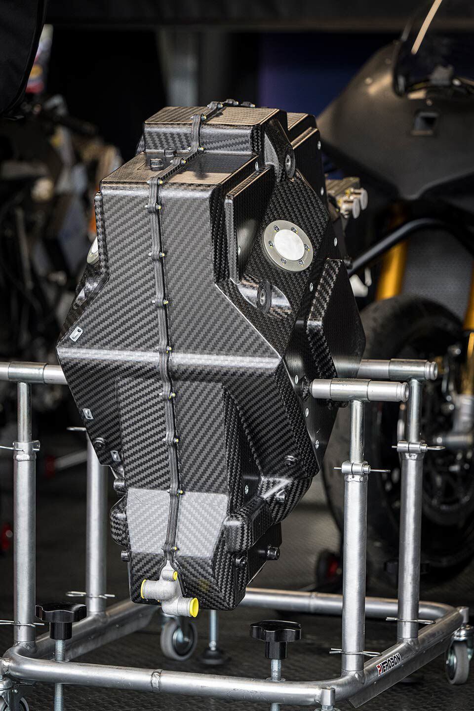

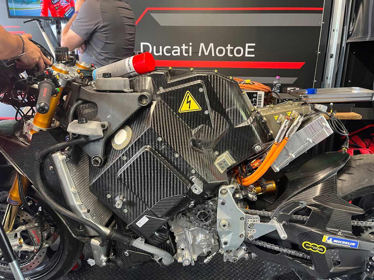

The Ducati V21L’s battery pack.
The Ducati V21L’s battery pack. (Alex Photo/)
The Ducati V21L prototype is powered by 1,152 21 x 17mm cylindrical battery cells (6 cells in parallel x 192 in series) that produce 110kW (150 hp) and 140 Nm (103 lb.-ft.) of torque. The motor, Ducati’s own design, save for the rotor and stator, which were designed in collaboration with its suppliers, spins up to 18,000 rpm. There are 96 temperature sensors in the battery pack alone to provide Ducati with as much data as possible.
Claudio Domenicali, Ducati president and CEO, says: “Our MotoE technology is more similar to [Audi’s RS Q e-tron] Dakar buggy. The battery cell they use is similar. The advantage of the cylindrical cell is you can place them as you like. The big problem with batteries is cooling. Keeping the performance is about cooling the battery and the motor. The more you use power the more you produce heat. With 150 hp that’s draining current from the battery, it gets super hot. The battery starts to scream above 60 degrees [Celsius].”
The V21L uses separate liquid-cooling circuits for the battery and the motor and inverter. The battery pack, surrounded by a carbon fiber shell that acts as a stressed member of the chassis, weighs 110 kilograms (242 pounds), or about half the weight of the entire motorcycle

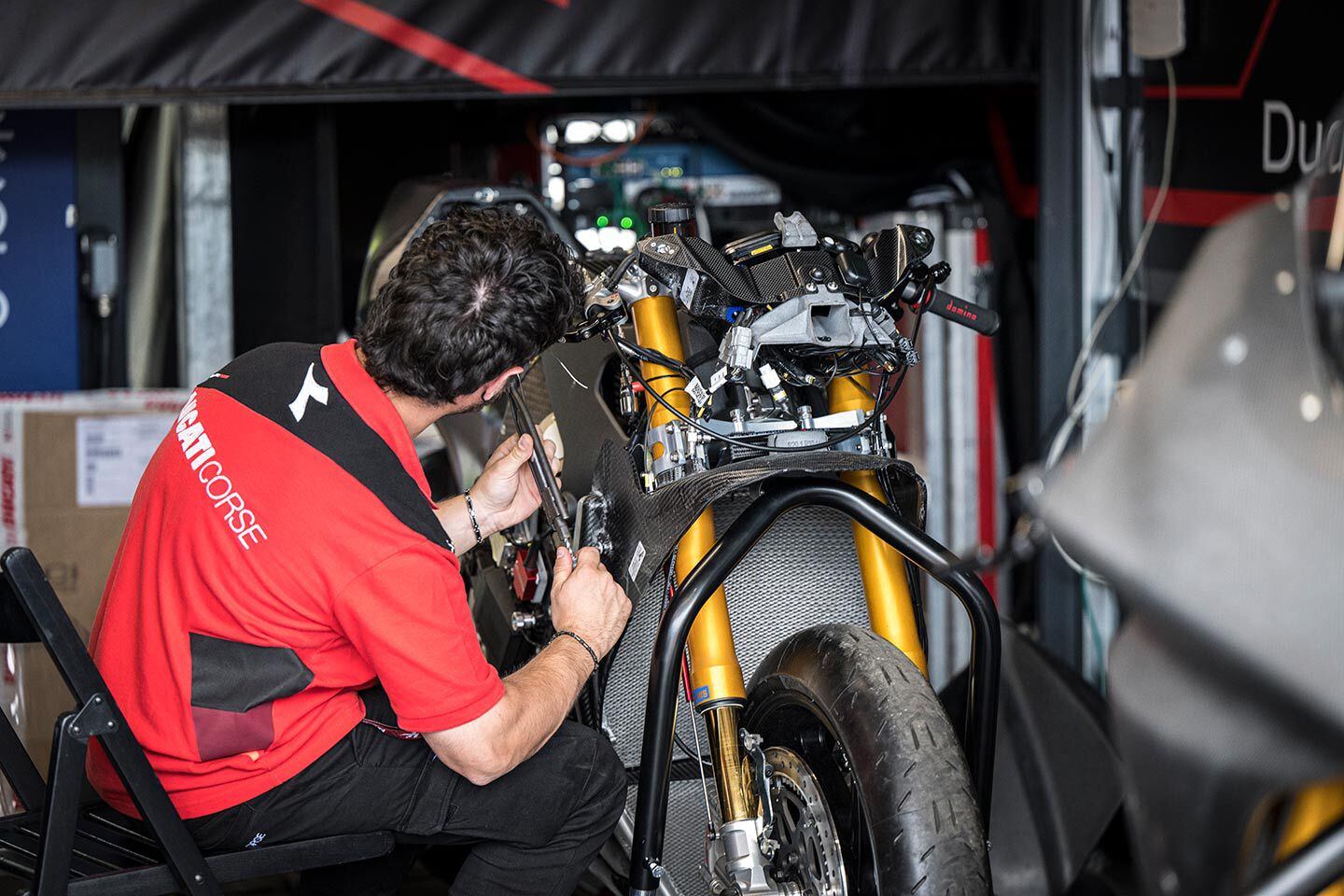

The V21L stripped of its fairings. Note the minimal “front frame,” reminiscent of Ducati’s production machines.
The V21L stripped of its fairings. Note the minimal “front frame,” reminiscent of Ducati’s production machines. (Seth Richards/)
Canè says, “If you compare this battery pack with other motorcycle or car battery packs, it’s lightweight. It’s unbelievable. Different motorcycles or cars have battery packs of the same quantity of energy that weigh double this one.”

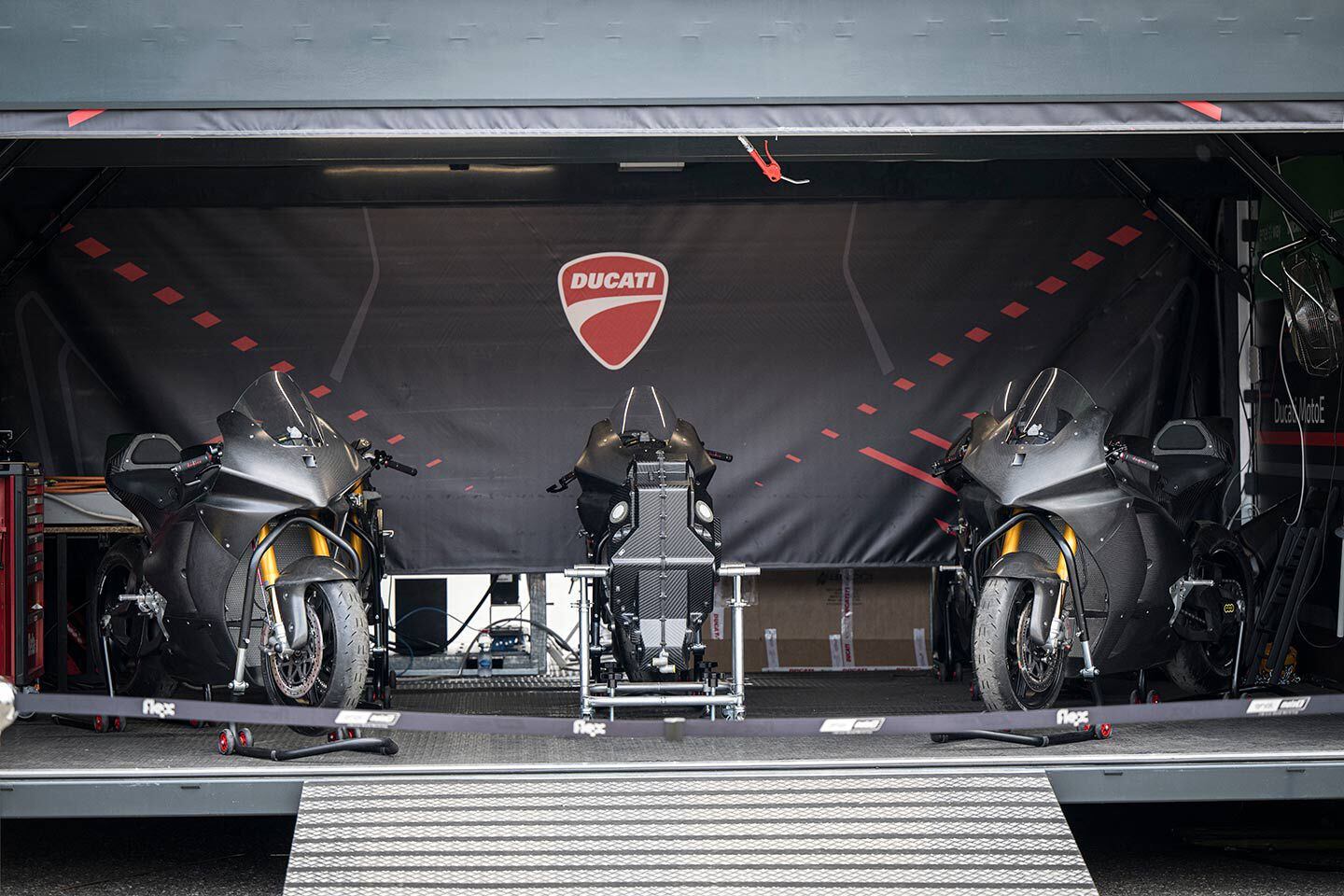

Ducati provides spare bikes for teams.
Ducati provides spare bikes for teams. (Alex Photo/)
