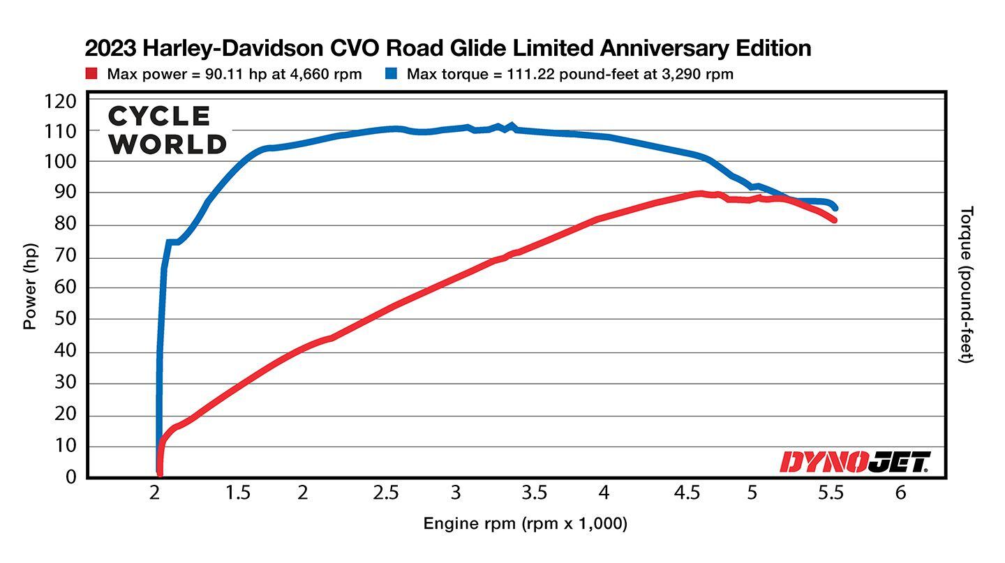

On our in-house Dynojet 250i dynamometer, the 2023 Harley-Davidson CVO Road Glide Limited Anniversary Edition produced 90.1 hp at 4,660 rpm and 111.2 lb.-ft. of torque at 3,290 rpm. Pumping out less peak horsepower and torque than the Breakout 117 as well as weighing 963 pounds on the Cycle World automotive scales (281 pounds more than the Breakout) the CVO Road Glide Limited is noticeably slower off the line from one stoplight to the next.
2023 Harley-Davidson CVO Road Glide Limited Anniversary Edition Dyno Chart.
2023 Harley-Davidson CVO Road Glide Limited Anniversary Edition Dyno Chart. (Robert Martin/)
