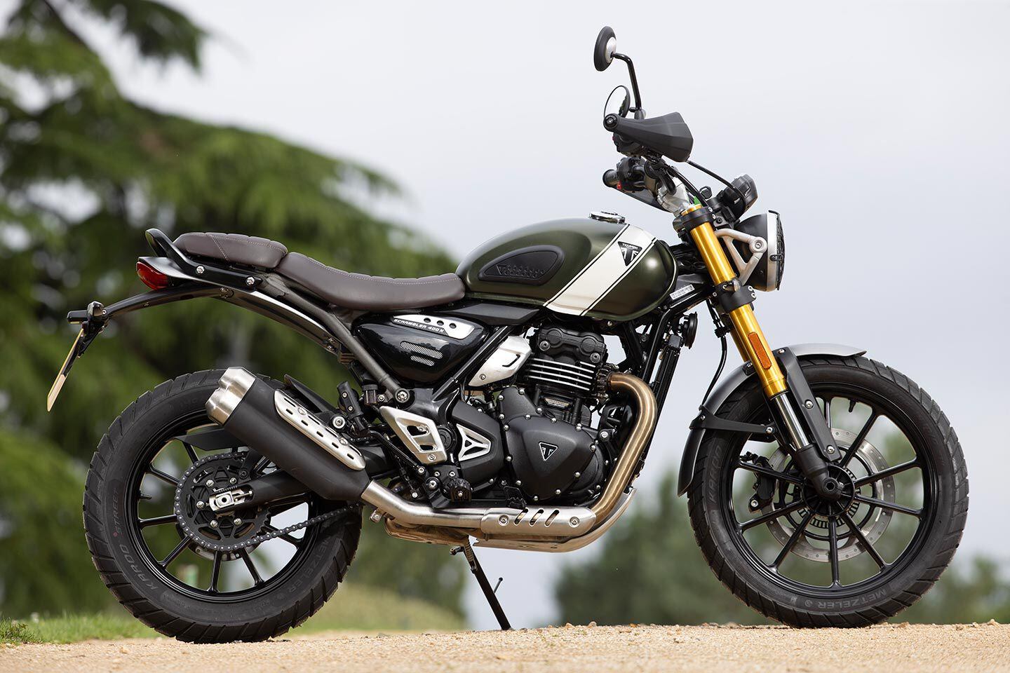

This July, Cycle World was handed the keys to Triumph’s entry-level modern classic: the new Speed 400. Now, we follow that up with another exclusive first ride for the US market—this time on the new Scrambler 400 X, which shares the same single-cylinder platform.
Don’t be too hasty to judge. This is not simply a Speed 400 with a few trendy retro parts thrown at it. In fact, the pleasingly styled new Scrambler 400 X has its own frame, wheelbase, and chassis geometry, as well as a 19-inch off-road-biased front wheel and Metzeler Karoo rubber.

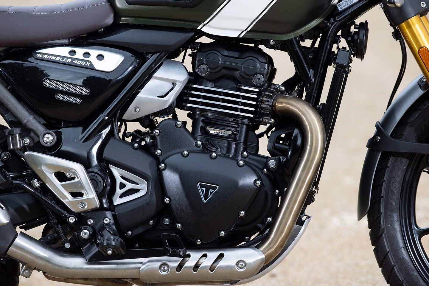

Yes, it does share the Speed’s TR Series 398cc single-cylinder engine and makes the same claimed 39.5 hp at 8,000 rpm and 37.5 lb.-ft. of torque at 6,500 rpm. Clocks, switch gear, and gas tank are off the same shelf too, but this sweetly proportioned, entry-level Scrambler is certainly more than a cosmetic rehash of the roadster. Its wheels (100/90-19 front and 140/80-17 rear compared to the Speed 400′s more conventional 110/70-17 front, 150/60-17 rear), riding stance, and suspension are completely different. And those differences are reflected in the prices of the two bikes; the Speed 400 will be priced at $4,995 and the Scrambler at $5,595.

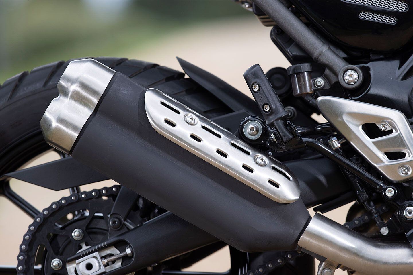

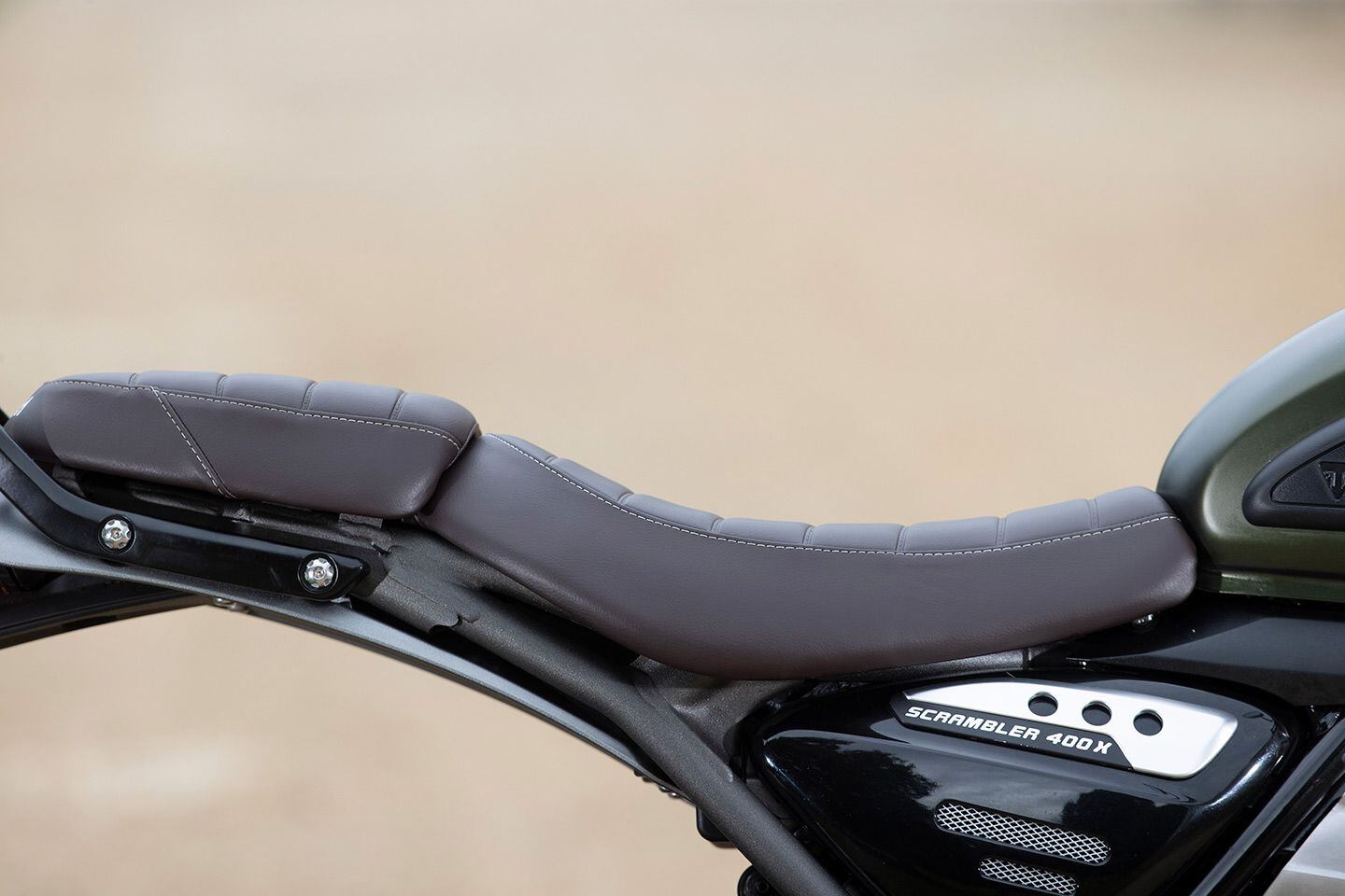

Of course, the most obvious point of difference is the styling. The new twin exhausts ooze scrambler appeal. A two-section ribbed bench seat delights the retro glands and looks class. Hand guards, taller and wider bars for a little off-asphalt exploration, plus that larger-diameter front wheel wrapped in dirt-biased rubber give this bike a powerful presence for a mere 400. The finish is premium; the price: basement. There are things here to like.
No scrambler is complete without twin exhaust outlets, even if it’s a single…
No scrambler is complete without twin exhaust outlets, even if it’s a single… (Chippy Wood/)
Once on board the X, those differences become as obvious. The 32.9-inch seat is noticeably higher than the Speed 400′s 31.1-incher. I’m just under 5 feet, 7 inches, and although I wouldn’t describe the new 400 X as intimidating, it is surprisingly high for a learner-friendly 400. After all, both Ducati’s next-gen Scrambler Icon (31.3 inches) and Honda’s new CL500 Scrambler (31.1 inches) have lower seats despite being larger-capacity machines.
The Scrambler 400 X’s 32.9-inch seat height is almost 2 inches higher than the Speed 400.
The Scrambler 400 X’s 32.9-inch seat height is almost 2 inches higher than the Speed 400. (Chippy Wood/)
